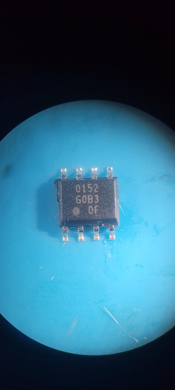

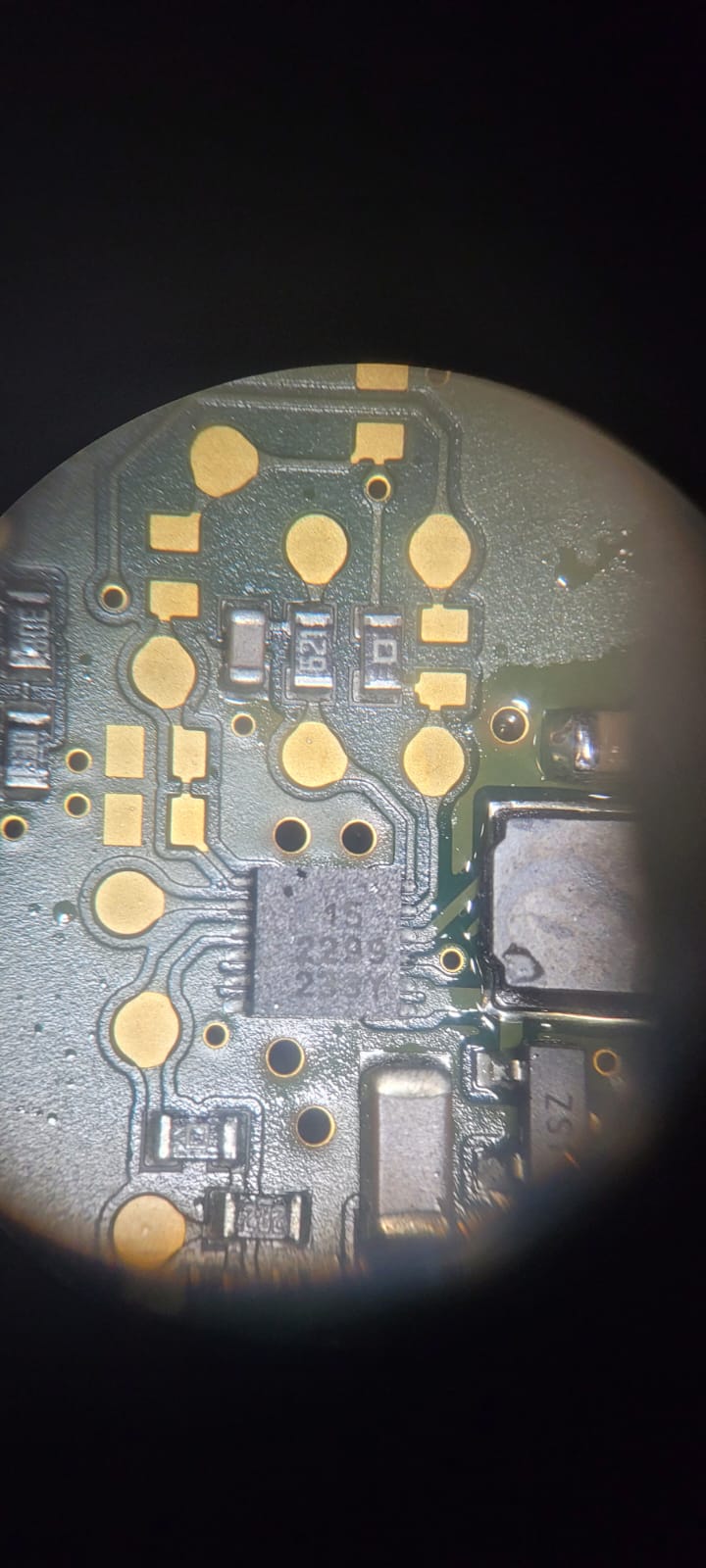

    Please help me to identify this 2 IC. Both is some pwm controller IC, but can't find any info. Thank you in advance.

      The one is a MIC2299-15YML-TR
        Thank you! Yes, this is the one.

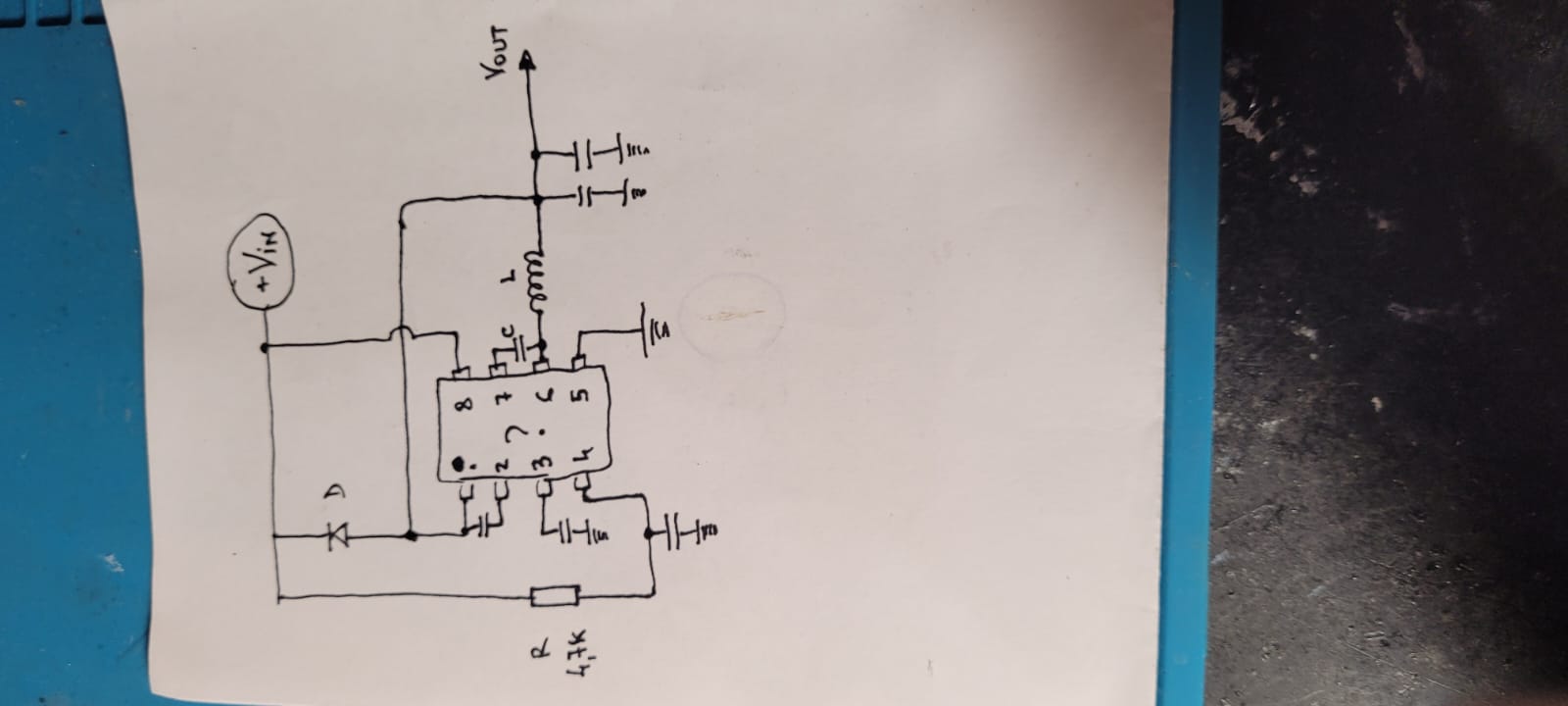

        About the second one, have some updates
        It is from a BRC1HHDAK - Daikin Madoka wired remote control.
        I was try to get some schematic from PCB - hope it help...
        It looks to be some buck converter (step-down) - fixed voltage
        Any info is wellcome.

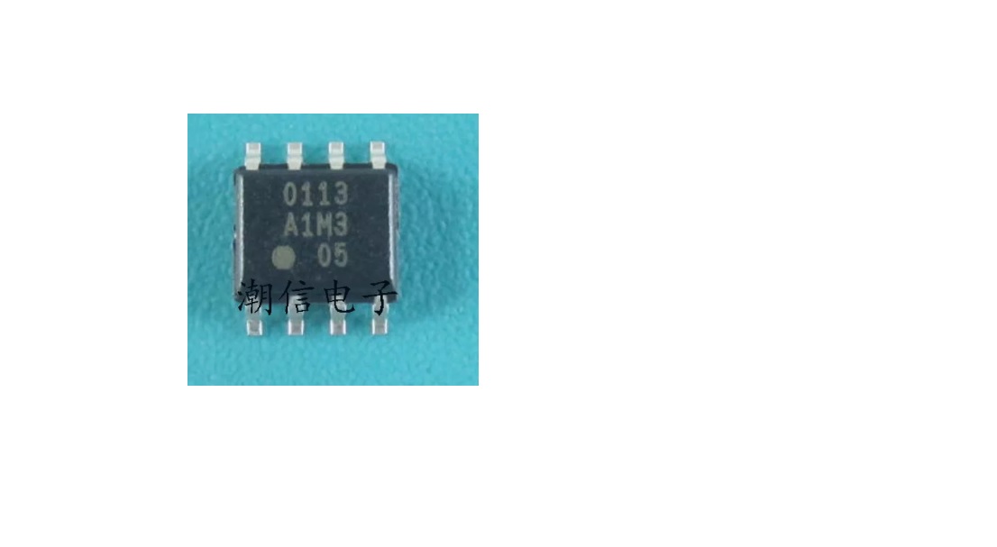

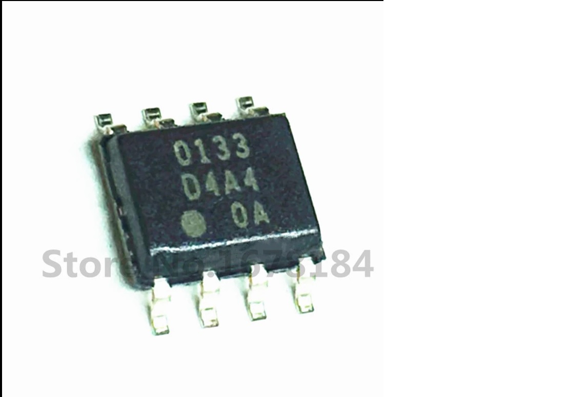

            The closest I can find that has "similar Markings" (as in not the same pinout etc) is the HXD0113
            Renesas also makes a similar marked ic R2A20133DSP
            Do you have a picture of the back of your ic?

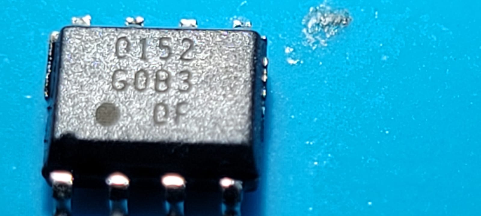

                I think is Renesas chip: RAA230152
                Now the problem is a source to buy
                Tonight will verify again the PCB according with that new info, then will search a provider for chip.

                  RAA230152GSB#HA0 (5v fixed output) https://www.chip1stop.com/view/dispD...t_RENE-0068885
                  This ic may be replaced by the RAA230153GSB#HA0 which is adjustable so you may need to add resistors to get the 5v output? (See page 18 for resistor values)
                  Maybe you can request a free sample from Renesas https://www.renesas.com/us/en/buy-sa...how_price=true
