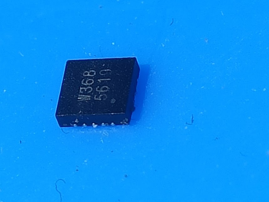

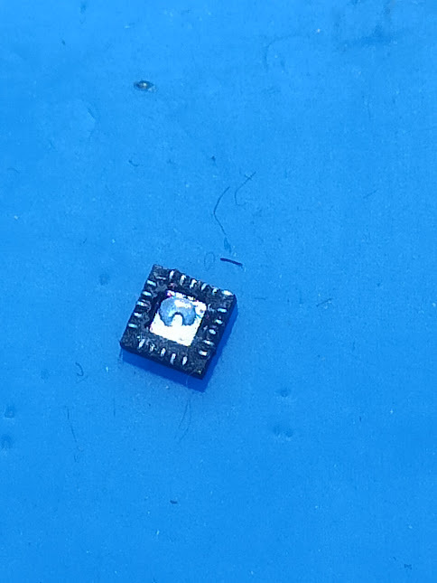

    Hello.
    Have this HP 16-a0023nc DAG3JCMBCE0 that have burned mosfet on i think memory power. both memory modules shorted. after remove mosfets i measure 10ohm on that line which is low so after remove ic i have normal reading. But i cannot identify this ic. can
    Looks like a G5619 https://www.aliexpress.com/item/4000597639300.html
    https://www.badcaps.net/forum/troubl...0z8gm8f0-rev-f

      Yes,its G5619

        Thanks guys.
        i order them and give feedback
