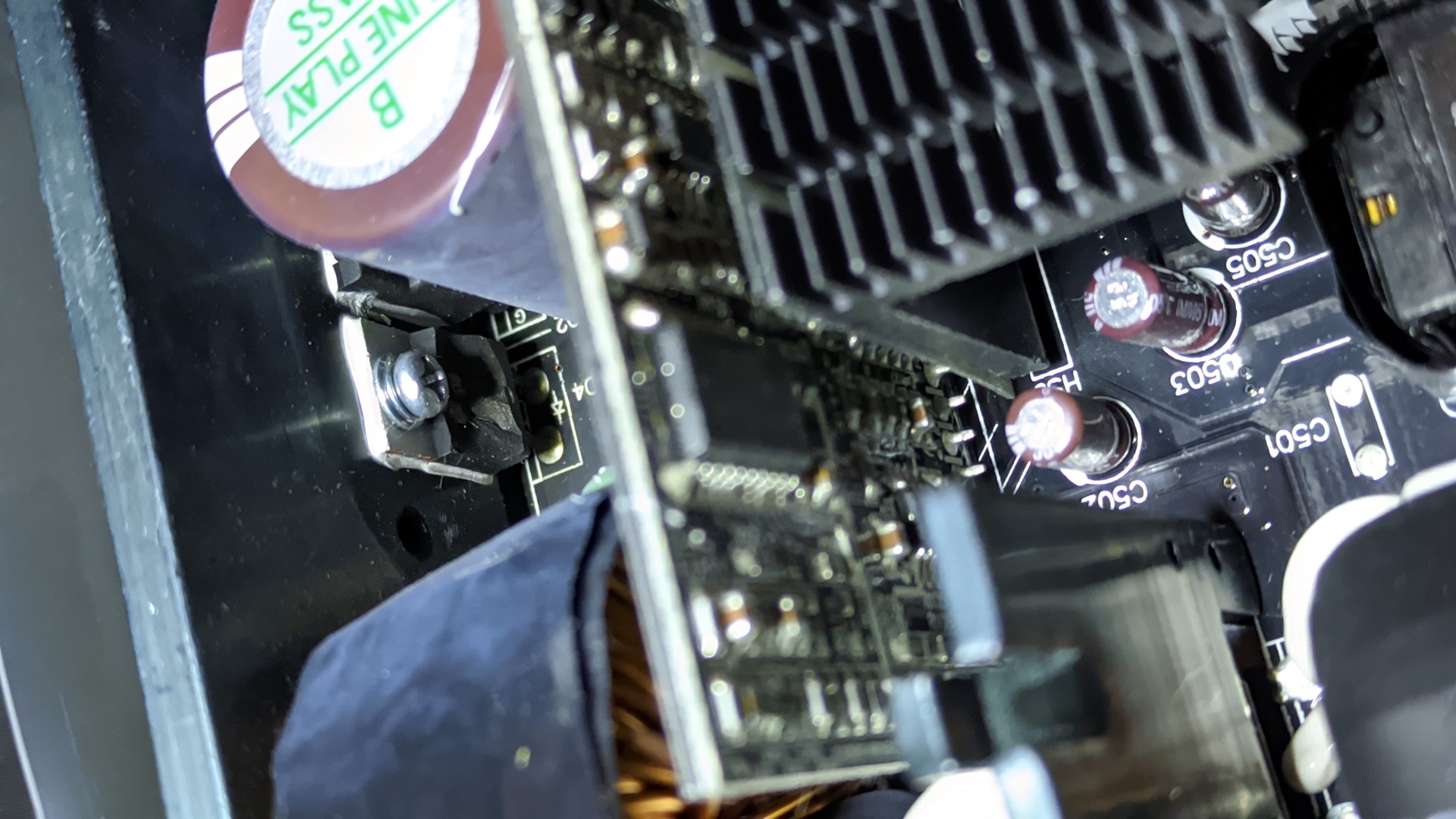

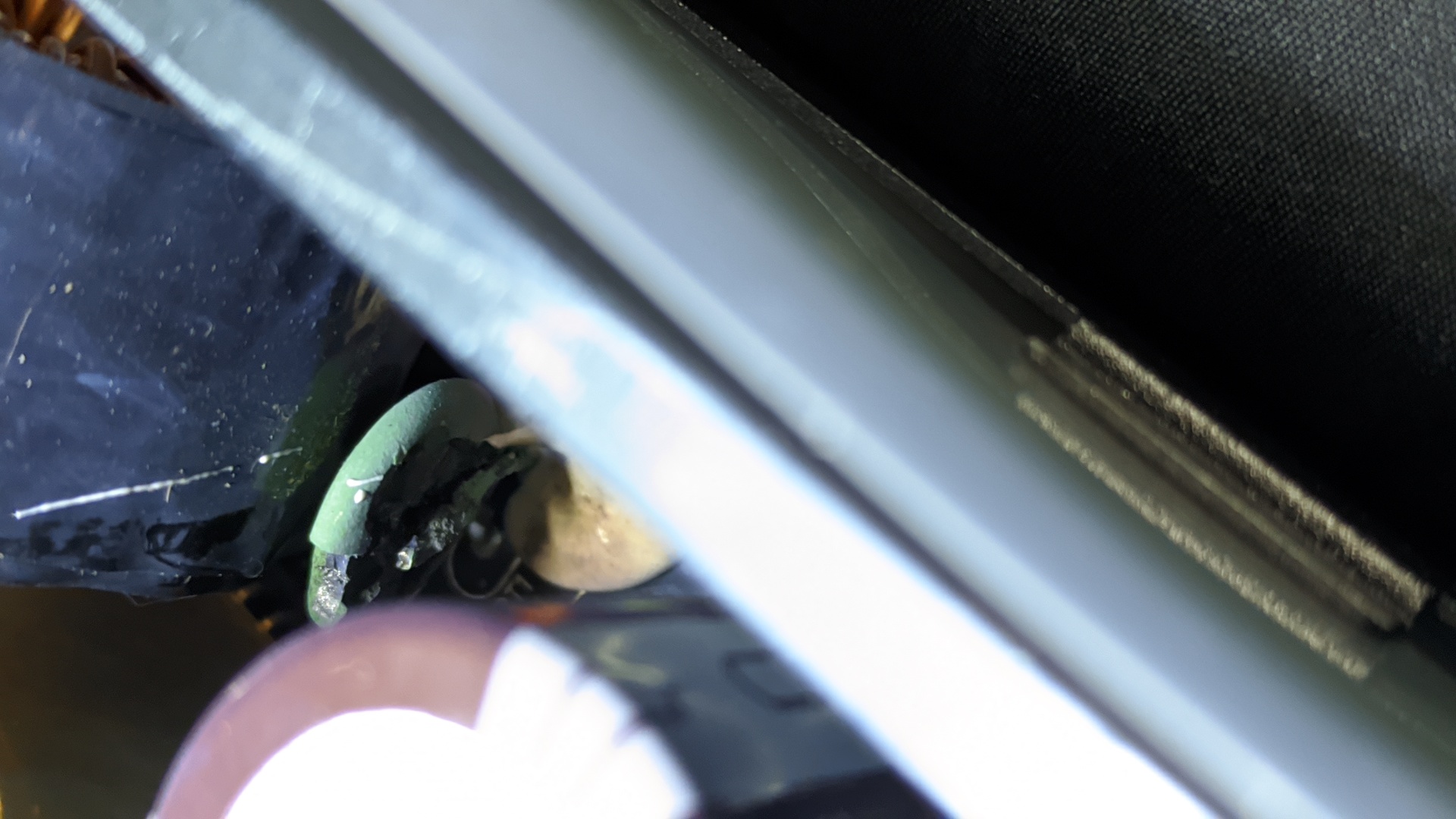

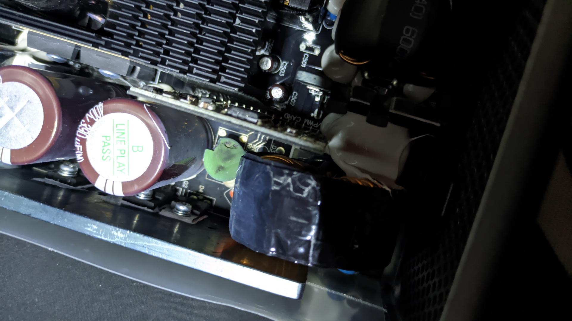

    Corsair RM750x help ID blown components
    Please help ID the Green varistor. I already have the diode part number found on the broken piece (QH08TZ600).

    Re: Corsair RM750x help ID blown components
    What is your incoming voltage to the switching power supply
      It's not a varistor, it's an NTC thermistor.
        It may be a SCK054 ntc. Measure the original's diameter.
          Originally posted by sam_sam_sam
          what is your incoming voltage to the switching power supply
          230v
            thanks for the correction.
              checking this review of the RM750x (2021), mine is (2018) they show NTC Thermistor SCK-037, which seems to be the same diameter (15mm) as the one on mine.
