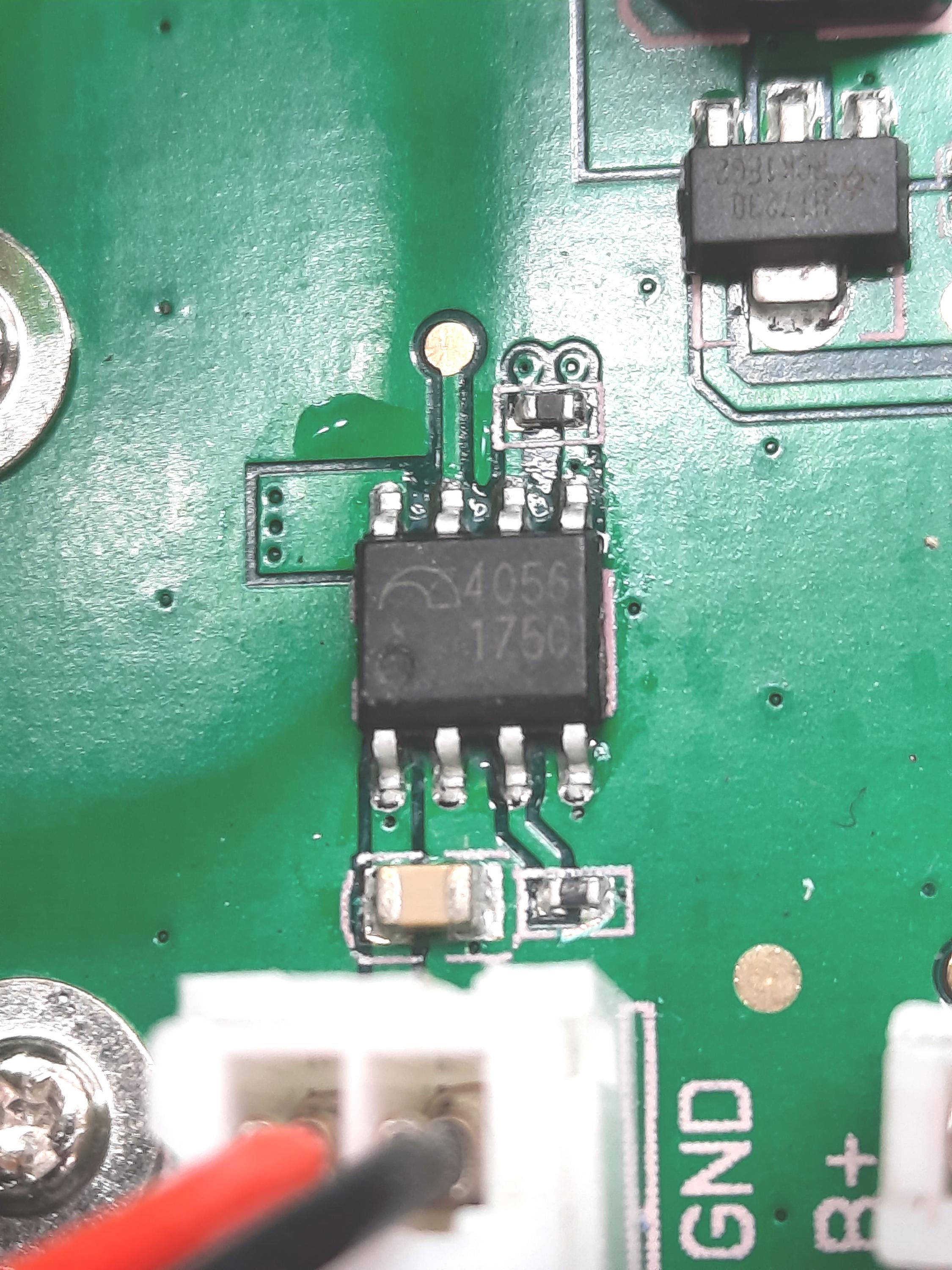

    remote control Part ID help please
    Hi all
    Part required is a charging chip from a small boat remote control .
    Anyone familiar with chip or manufacturer logo ?

    Re: remote control Part ID help please
    Looks like a TC or TP4056 lithium battery charge controller - For that IC pin 3 is GND, so why does this board have some tiny part on pin 3?

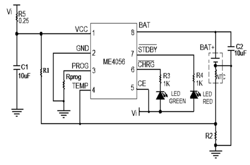

      It is a ME4056 by Microne
      Pin 2 is ground, pin3 is Program, the part off pin 3 is a resistor.
        That IC looks much better, matches OP's circuit and logo.
        The "4056" is widely copied in china but strange some have different pinouts. Note these have a thermal pad and need some extra heat to desolder.
          Cheers guys & spot on RJ , it is a Microne manufactured chip .
          Pin configuration varies from the TP version i initially tested .

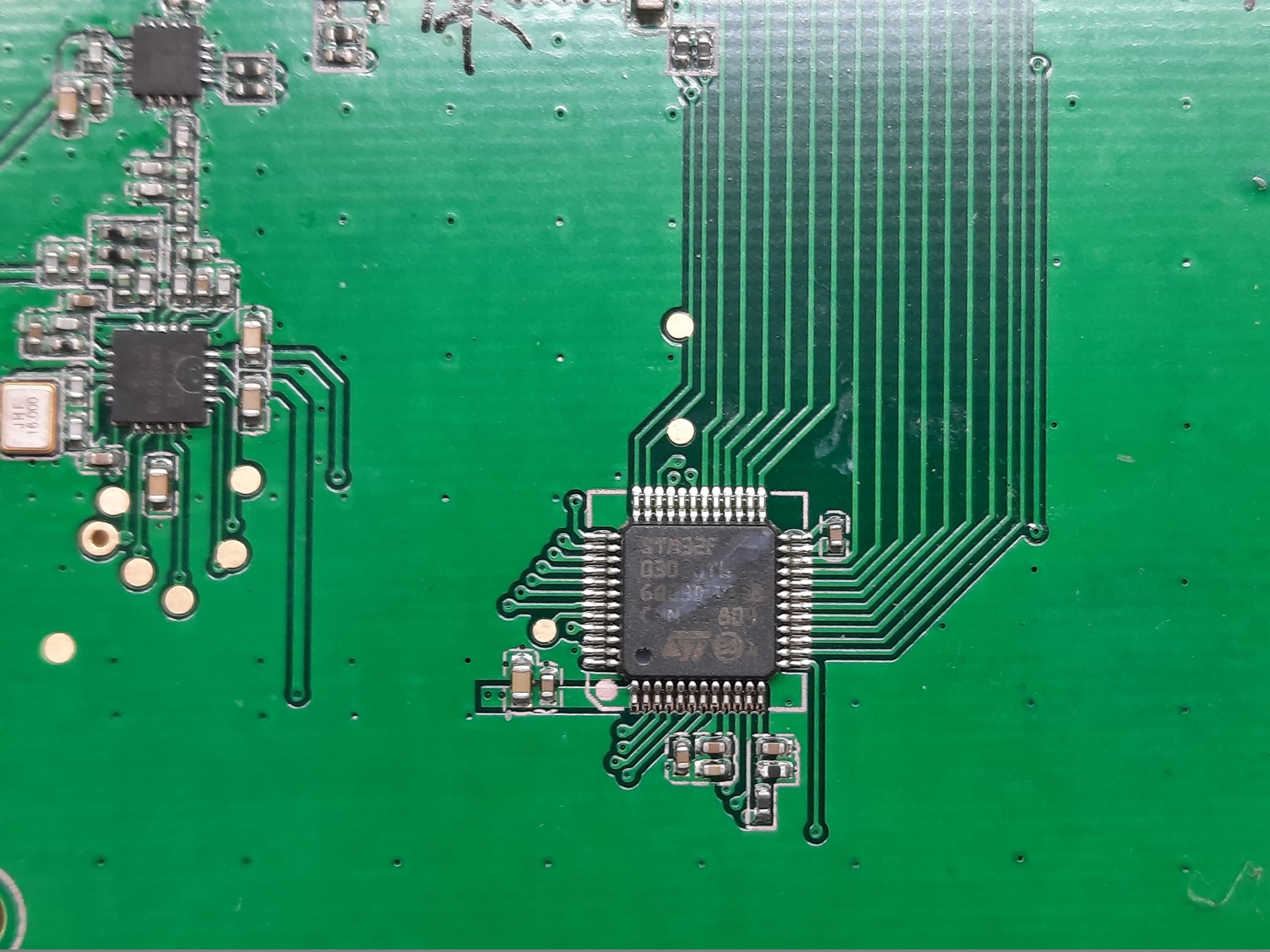

            Trying to repair 2 of these remotes , that have had a higher supply used .
            Charging chips mentioned faulty on both .
            One of them is now destined for the scrapyard in the sky , as main micro controller has an internal S/C .
            Type STM32F030C8T6 , which also has an internal 64K programmable flash .
              • 31304
              try to read the flash with an ST-Link or a 5v serial2usb adapter
              • zen
                • 511
                Cheers , but doubt it would be viable for me to spend more time on the one with micro failed .
                Will focus on the other as he only really needs one to work.
                • zen
                  • 511
                  Time to abort mission .
                  Customer must had supplied such high voltage input , that seems all the chips on board have faulted .
                  Not viable to continue on such a cheap device .
