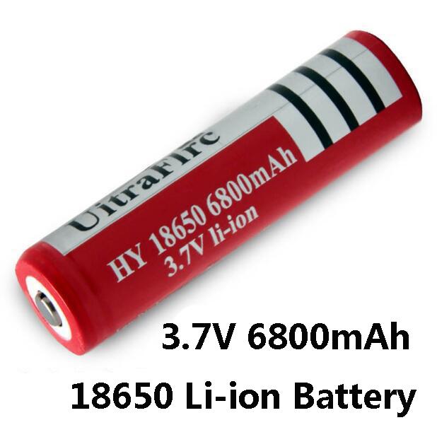

                      Re: equivalent for HT3582DM
                      the battery is separate and looks like this .
                        • 31068
                        6800mAh my ass, i'd love to throw that in my Li500 analyser
                        get a decent charger - they arent too expensive.

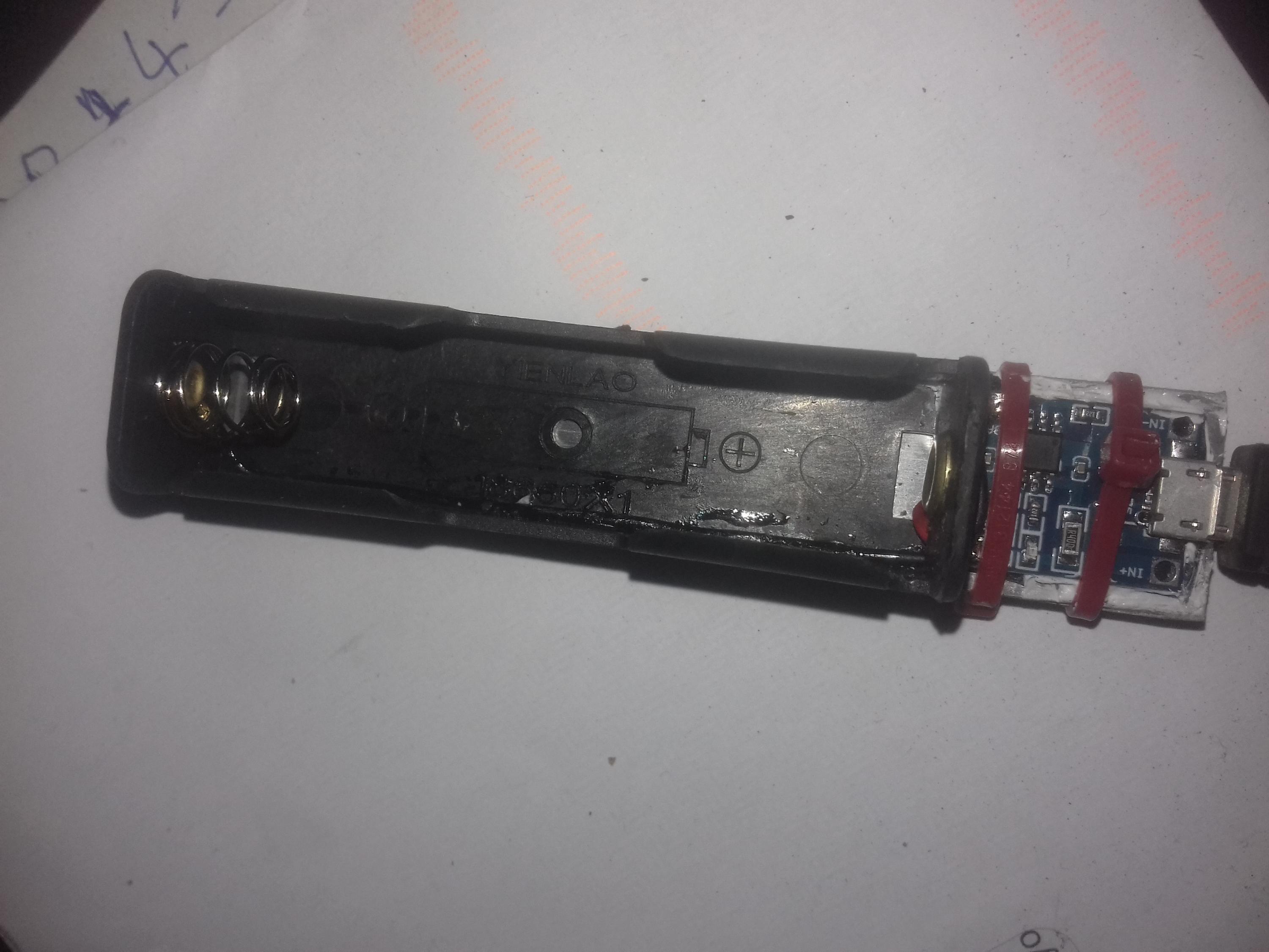

                              i thought of buying a holder and module then using a usb charger i already have . costs less than £4 to get my torch batteries charging for now . then go for something big and fancy with digital readouts later on for sorting cells for rebuilding/repairing 80v packs .
                              i am sure i have plenty of components here to build a 4.2v charger circuit with led lights included but cant really be bothered . modules can be had for about £1.50 . it would possibly cost more using parts from my stock .
                                • 31068
                                i can probably send you a module - i think i have some spare.
                                you have the holder already i presume?
                                • petehall347
                                  • Jan 2015
                                  • 4427
                                  • United Kingdom
                                  have just ordered a module and holder thanks .
                                  • petehall347
                                    • Jan 2015
                                    • 4427
                                    • United Kingdom

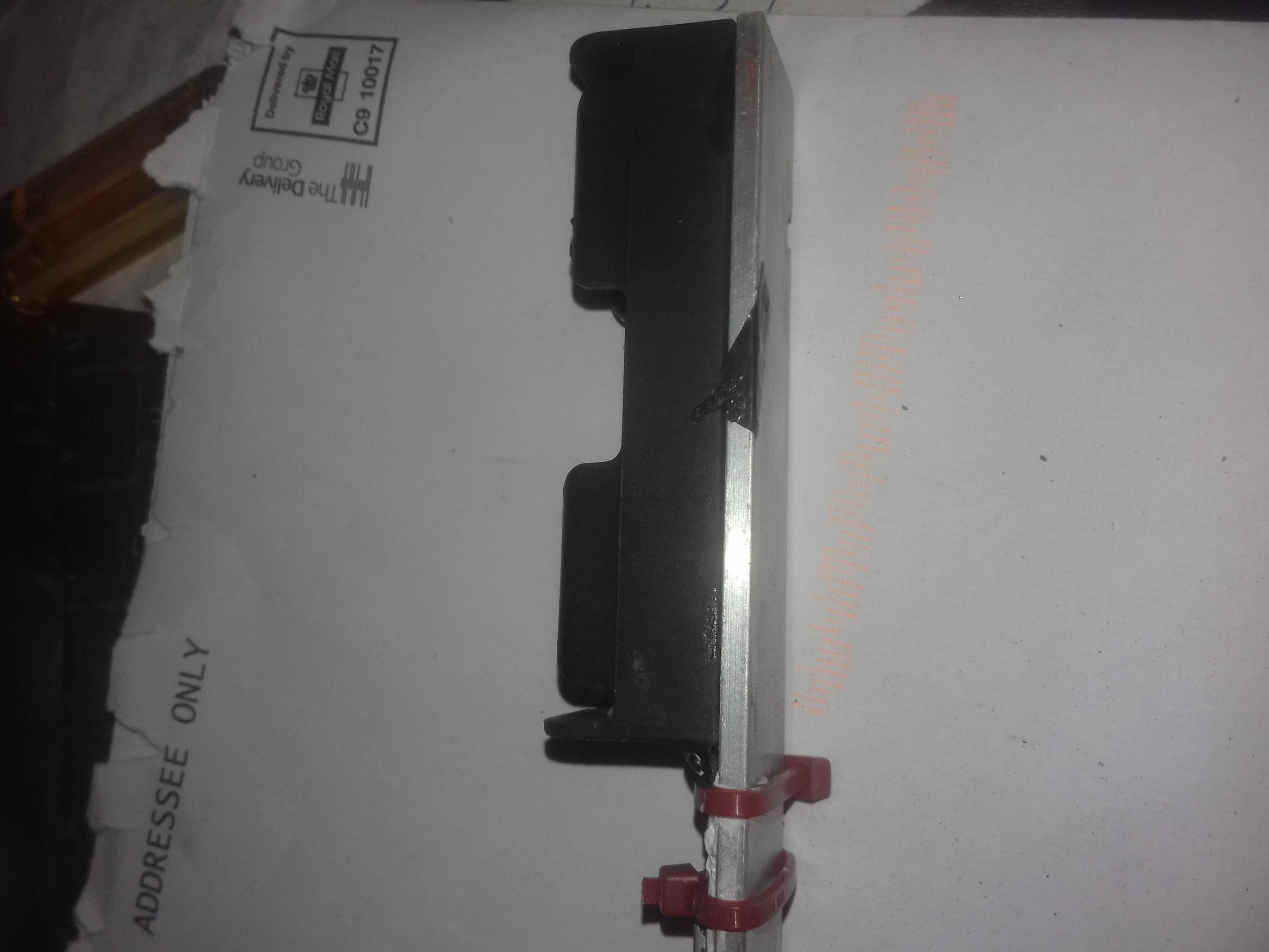

                                    built it up earlier .. rough and ready and working fine . glued to nice lump of aluminium just in case anything gets hot .
