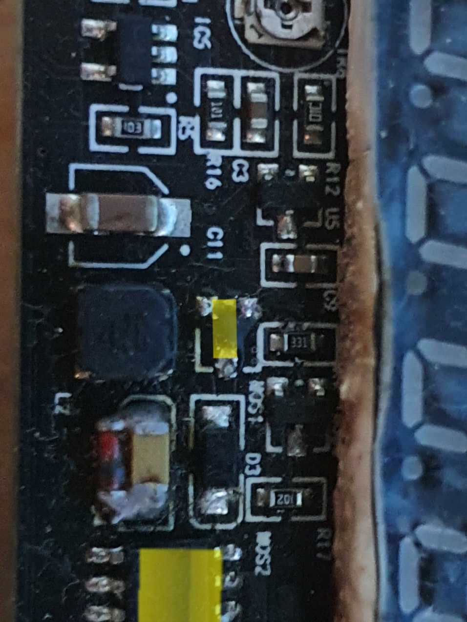

    Hello, i have a non functional shortkiller Mechanic
    VC04 which has 2 faulty components ( burned out).
    Can anyone identify these Components?
    Thanks.

    I've just looked up the components on my board, the component on the top has the marking A09T (https://www.sunrom.com/p/ao3400-a09t-sot-23-n-ch-mosfet) and the second one has VBA1206 (http://vbsemi.cn/index.php?id=7289). Maybe you can help me too, i need the resistor value on R26, its next to the usb-c port.

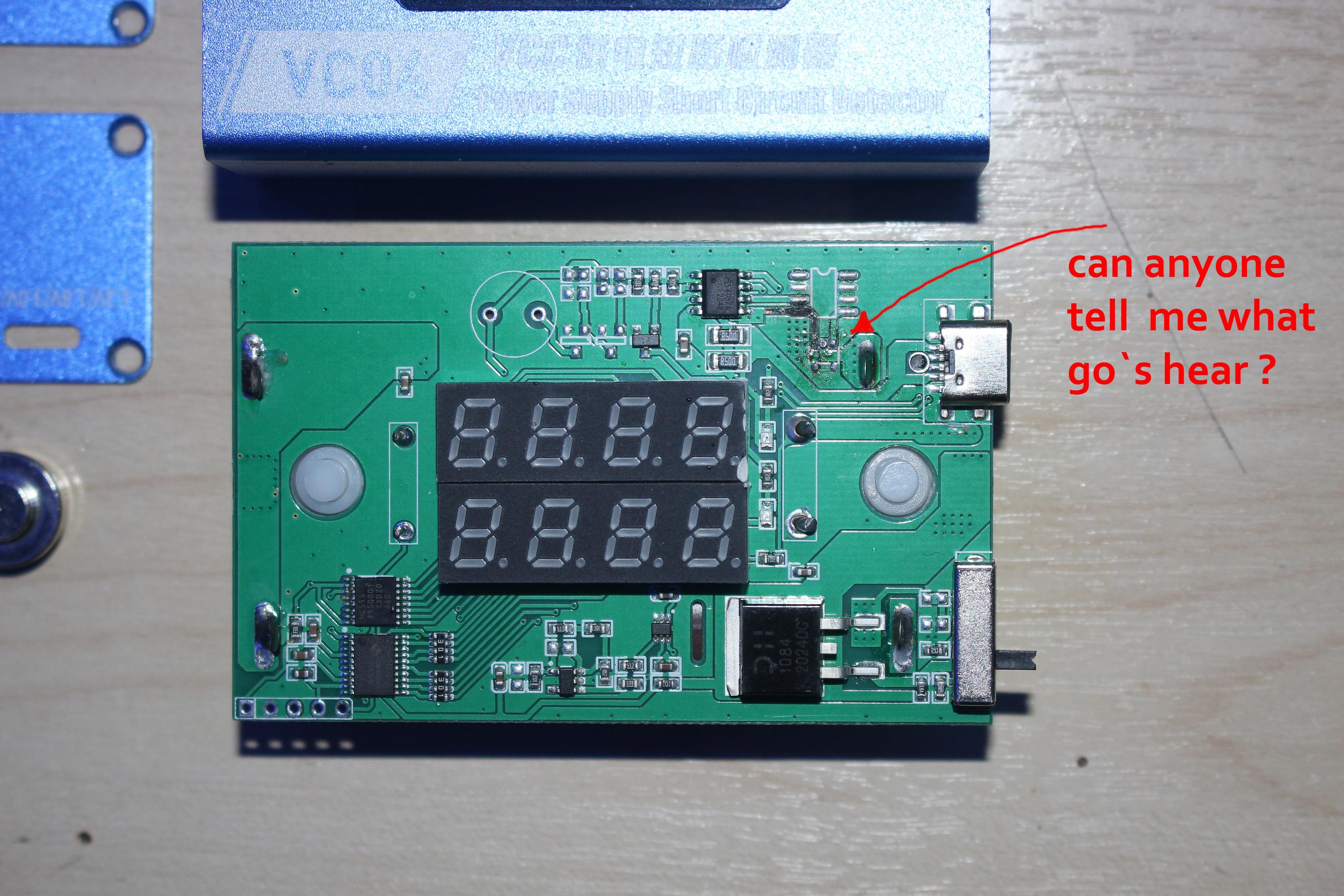

      i know this is an old post but just figured id ask anyways and add a pic of the board.
      Mechanic VC04
      plus can anyone help with this missing component.. the VC04 works from usb power but not from battery power.

        find datasheet for that shorted ic and it should have a circuit diagram so you can get clues as to what it was ,

          Where did the original part go? looks like someone removed it, some sort of battery protection?
          The ic is a Microne ME4057

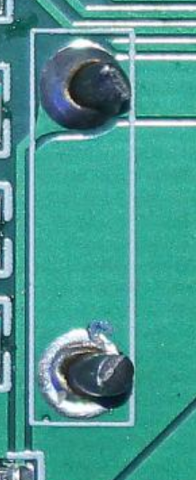

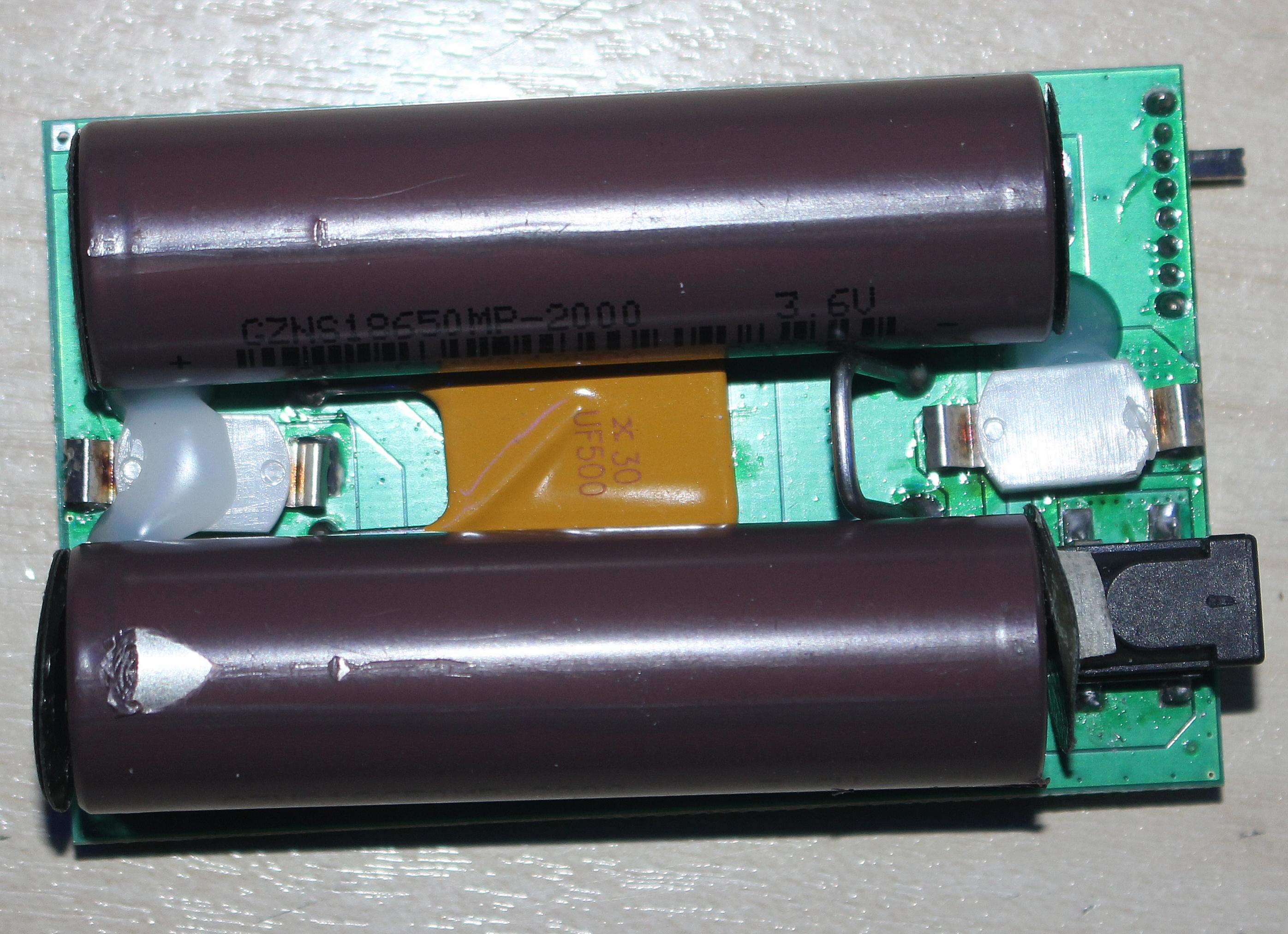

            what is behind here ?
            • CarlNGizmo
              • Nov 2023
              • 10
              • uk
              Re: Mechanic VC04 burned Component identify.
              thats the other side.
                i got it as a job lot, so dont know whats happen lol be nice to fix but like i say you can plug in the usb and it works.

                    cant make out what those soldered bits go but maybe solder them properly .
                      thanks petehall347 i did have a look at that datasheet. bit new to this and just learning but the part thats missing has 3 pads top and 2 pads bottom so will have todo a bit of google see if i can find anything.
                      them soldered bits just link together lol .... god knows
                      my VC04 board looks totally different to Ariu pic of his board... so im guessing its a copy or a older or newer board.

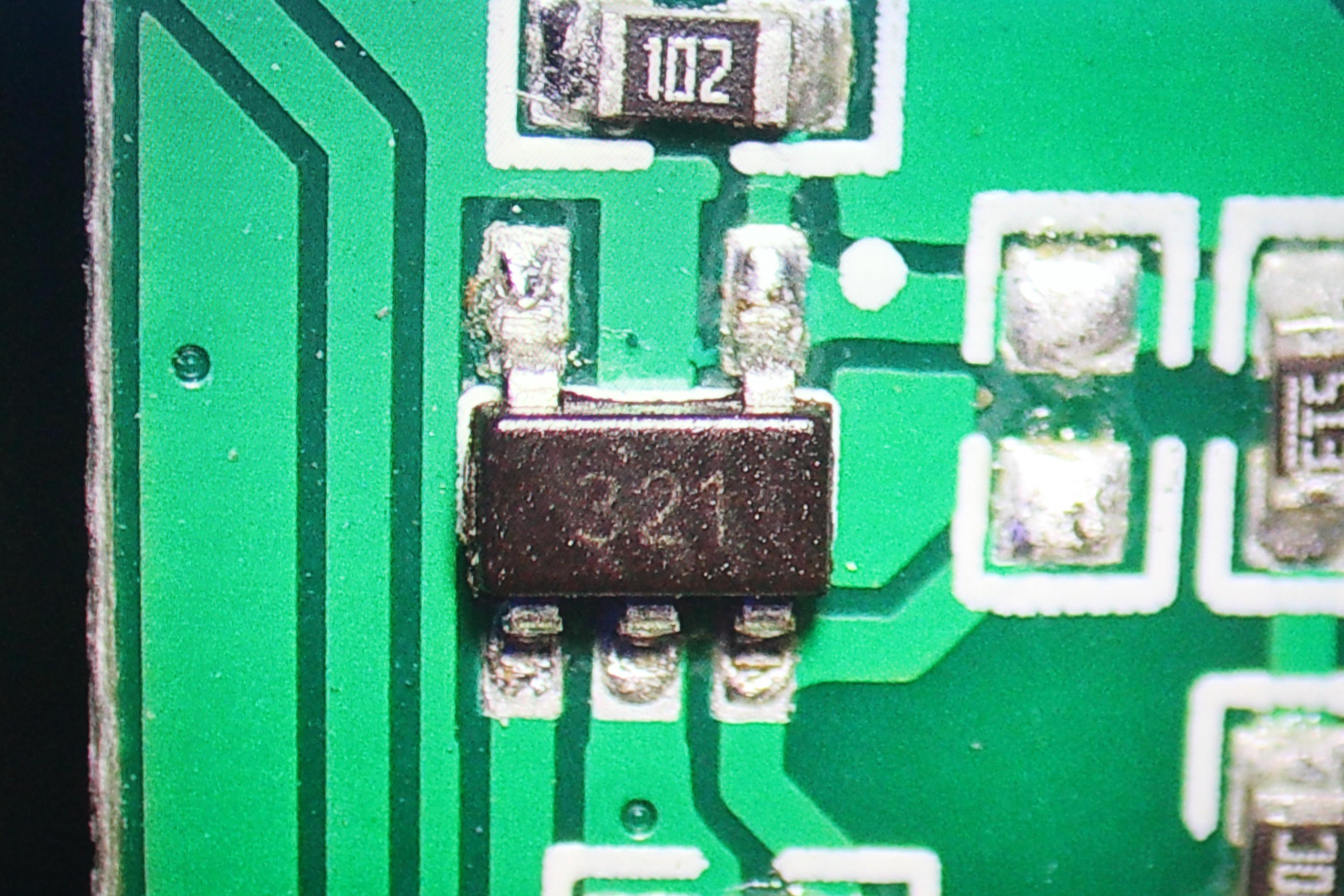

                      just looking on the board, cud it be one of them 321

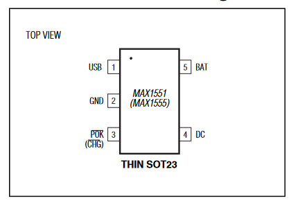

                        My guess is the missing 20t23-5 is something like a RY2201 or XB5353A
                        Can you trace the pins of the sot23-5 to see where they connect?
                          check this, when i short one of the 2 pads to the middle of the 3 pads it powers up and works LOL
                          maybe i shud stop befor i mess it totally.... thanks so much R J for the info i will go have a look..

                            Maybe something like a max1551
                              R J your prob right mate..... but i dont have a clue LOL
                              all i know is if it is a Max1551/1555 ive tryed this
                              pin 4 and pin 5 of where the max1551/55 is ment to be is connected together on my board!
                              so if i connect one of them..... pin 4 or 5 to pin 2 on my board it works lol and chargers the batts.
                              so im lost as to whats going on LOL
