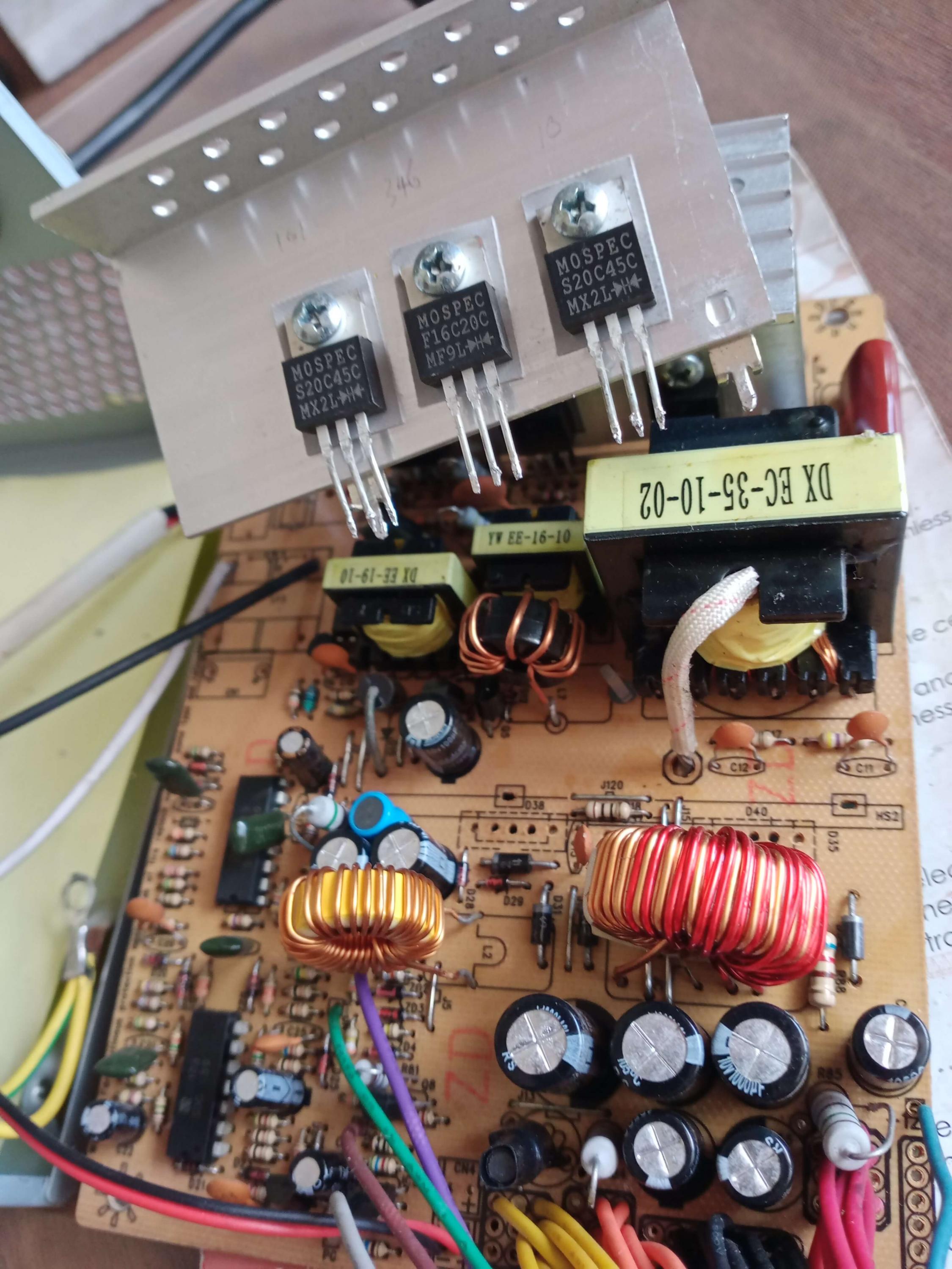

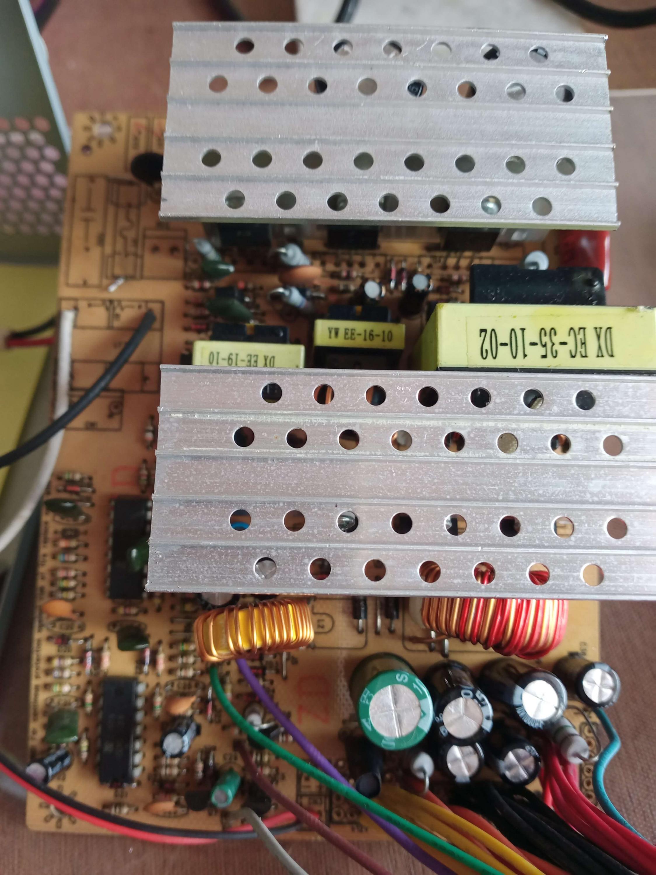

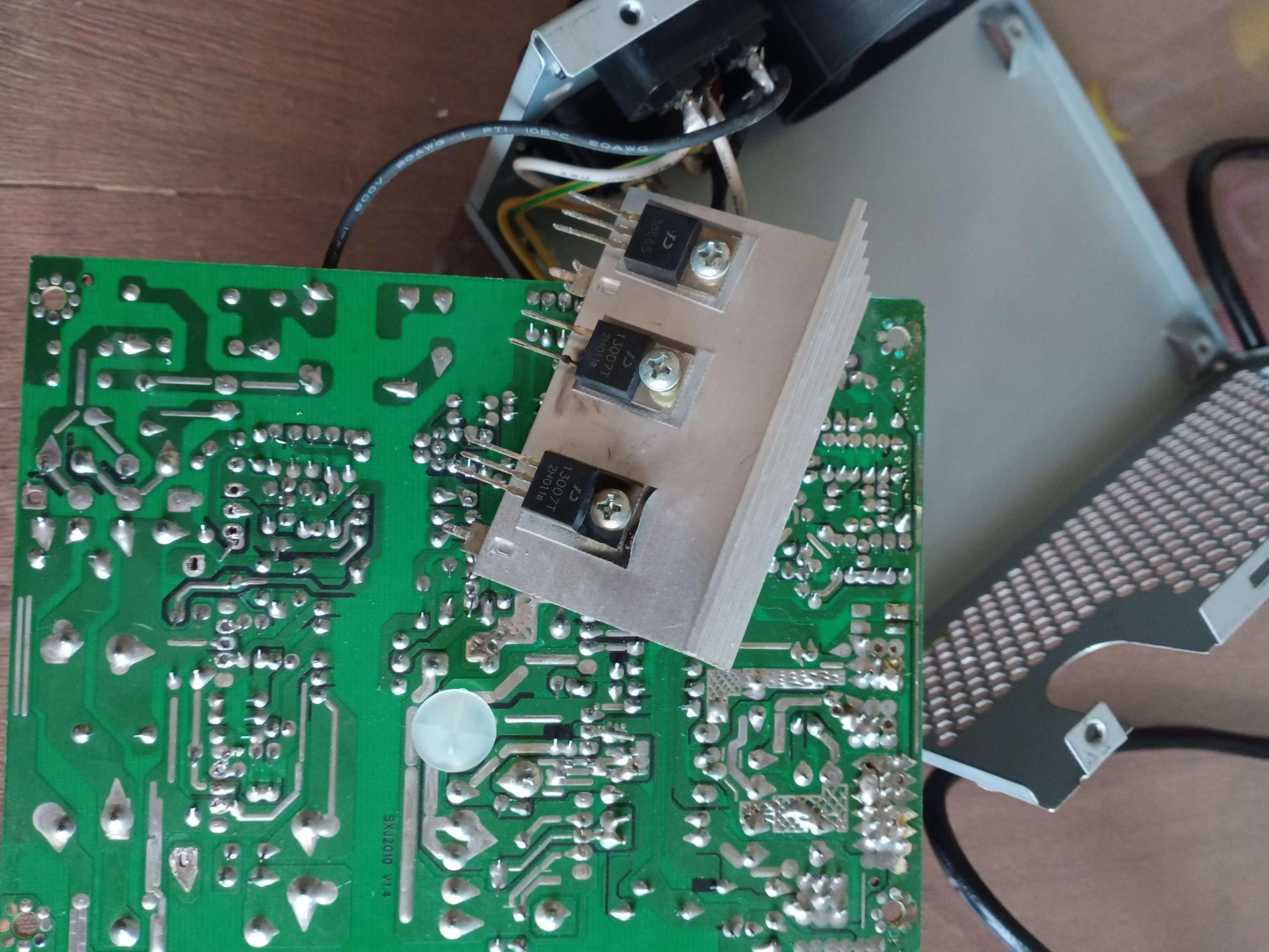

    Got a used working computer running Windows 7 about 3 months ago. Two days ago, the power supply blew up with loud spark and i immediately shut off the power. It was an unknown brand Tatu (output 450 w).
    Upon opening, i found out the two transistors on heat sink 1are fried with burn mark. Replaced the two trans(E13007 type). Also checked if the surrounding components are affected. The diode seems to be working, i pulled one leg off and tested using diode test. One side got reading while swapping test probe shows 1(infinite).
    I also pulled out the nearest 2 small caps at C5 and C6, they are both 10uf50v. Capacitance read 10.5 to 11.2 uf while esr from 0.46 to 0.5 (based on these reading, i soldered them back on board).
    Later, i pulled the 2nd heat sink out, tested those rectifiers by diode test. Black probe on middle leg while red probe on left and right leg got some reading. From the readings, i guess those rectifiers are still good.
    Tested the 16 pin(SDC 7500 voltage pwm),dc test with black probe on pin 7 and red probe on pin 12 shows 15vdc, at pin 14 it shows 5vdc.
    Tested the 14 pin (SDP 339 voltage quad comparator), dc test with black probe on pin 12 and red probe on pin 3 shows 5vdc.
    For testing this blown power supply, i replace the fuse with a series lamp bulb. Upon switched on power, the bulb lighted for 1 second then no more light. So there is no short. But the output power on the 24 pin still not appearing. Only the 5vdc standby power is detected from the green wire. Any help to revive this psu is greatly appreciated.

      Realistically, those MJE13007 clones, the size of the main transformer, the wimpy heatsinks, and not very large output inductors mean the realistic maximum continuous output power is in the 200W-25oW range. Note also that the 12V and 5V rectifiers are both rated for less than the label currents, and the 3.3V label and rectifier ratings are equal.
      I realize the system had been running for some time with this PSU, so those factors would mainly be relevant if you hope to expand the system.

        This is a very sad-looking PSU. Probably candidate for this thread, but digress. I don't suggest to repair it for use in a computer, as it's just very anemic. However, if you do want to repair it for learning purposes, these cheap PSUs are fairly straight-forward (well, I say that after going through a similar rodeo and struggling with one for quite a bit.)
        That said, probably start by reading this thread:
        https://www.badcaps.net/forum/showth...light=kdmpower
        In particular, read these two posts in detail:
        https://www.badcaps.net/forum/showpo...00&postcount=8
        https://www.badcaps.net/forum/showpo...1&postcount=11
        https://www.badcaps.net/forum/showpo...3&postcount=12
        TL;DR: check the driver transistors (typically 2SC945 or equivalent) and surrounding diodes on the secondary side that drive the middle transformer (which drives the 13007/13009 BJTs on the primary.) See this schematic as a reference:
        https://www.badcaps.net/forum/attach...6&d=1608943994
        Your PSU may not look exactly the same, but it should be similar. This is just the driving circuit for the main PS. In my case, one of the diodes in front of Q8/Q9 was partially-shorted, and it gave me a good run-around until I found it. So check the driving circuitry and also for any open resistors in that circuit.

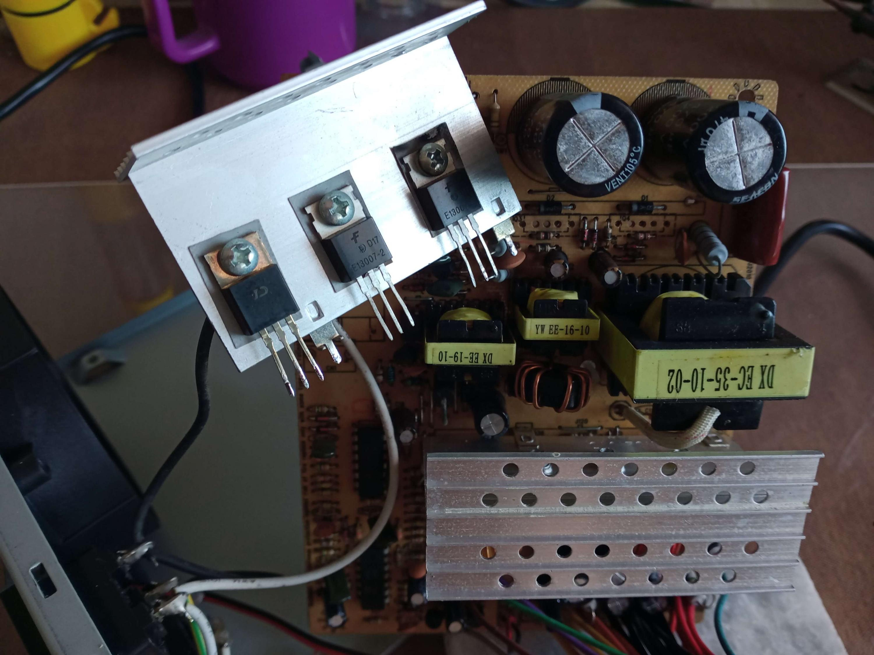

            normally when these type of PSU blow, you have to measure the resistors around it also. I make a close up look, your resistors seems to be gone.
              Those resistor near bjt13007 are at R8 (1ohm), R5(1ohm) and R6(2.7k ohm). R6 is open and i replace it with 6.8k ohm resistor from my stock.
              Will replacing with a higher ohm resistor affect the psu power on?
              I am trying to repair this old psu for learning purpose and not to use on computer or anything critical. Fyi, the two big main cap is 470uf 200v type. Upon power on, i tested it and dmm showed dc reading of 158v on each of the cap. Our ac main is 230v type.
              The psu output 5vdc standby and no other output. The fan not moving a bit. I replaced all the small caps at c6,c5,c24 and c22 to 10uf 50v type and the 5v standby still remains and no other output. Any suggestions?

                      Yes, you need to use something closer to 2.7 kOhms. In fact, I don't recall seeing this resistor anything else but 2.7 kOhms in just about every half-bridge PSU I have seen. Maybe just once I saw 1.5 kOhms, but I don't remember.
                      So to be safe, use 2.7 kOhm resistor. I suspect 2.2k and 3.0 k would be "acceptable" too. Whatever you pick, make sure both resistors that were 2.7 kOhms originally are now replaced with the same value - you need to have the Base drive to the BJTs fairly symmetric.
                      Oh, and if your R6 was open, then the 13007 BJTs are probably bad too. Don't even check them, just replace with known good ones. Also change ALL of the components going to the Base of those BJTs - i.e. aside from the 2.7 kOhm resistors, also the one or two diodes (probably 1n4148's), and even both 1-Ohm resistors.
                      And since you did have a primary-side failure, also check the two TO-92 transistors near the small transformer in the middle. Should be something like 2sc945 or 2sc1815. These drive the middle transformer, which essentially drives the BJTs on the primary side. Also check their protection diodes, bias resistors, and their grounding diode(s).
