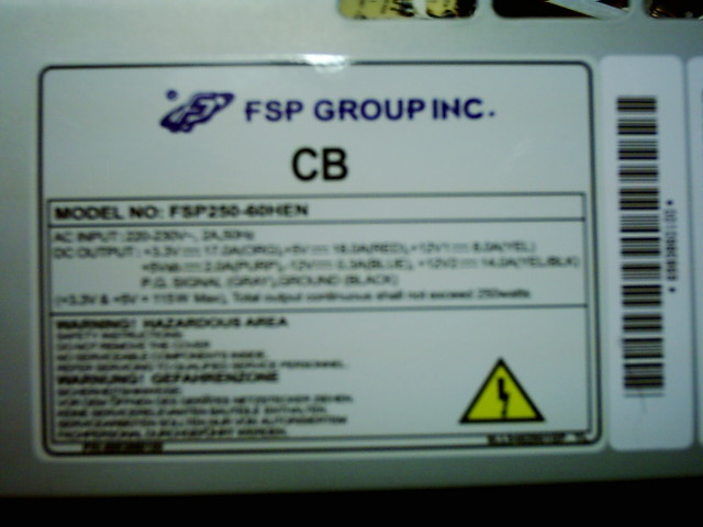

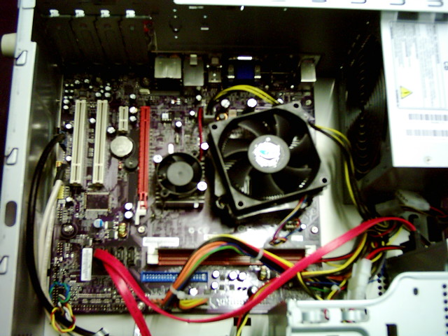

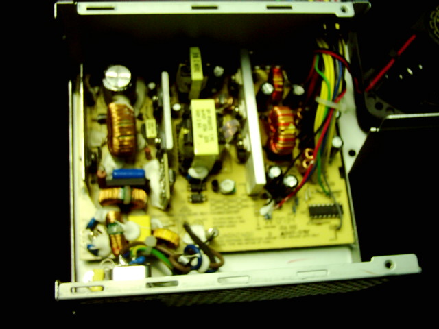

    what a joke - after i cleaned out the dust there was nothing in it!!!
    btw,
    one primary cap - 100uf 400v Ost.
    secondary's are all CapXion and Teapo
    it was running a celeron dual-core with onboard nvidia 610/7100GT
    all stock - from Packard Bell.
    (other than the chipset-fan i fitted)

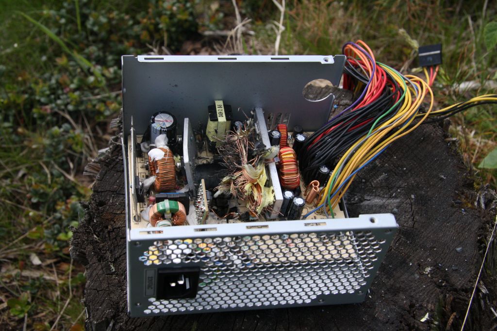

        Re: Fsp250-60hen

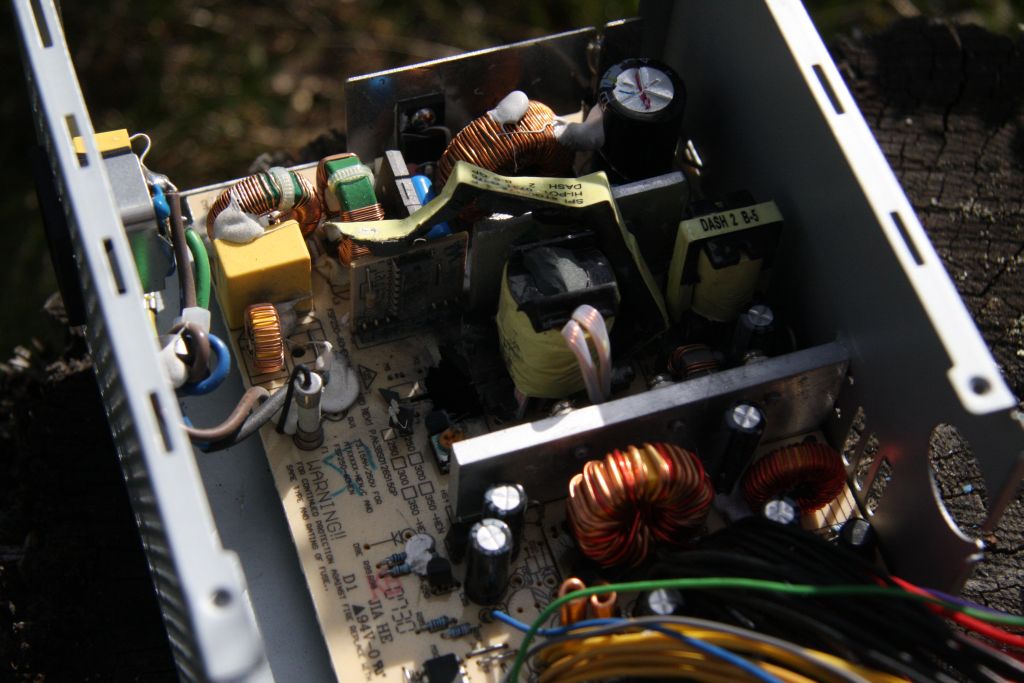

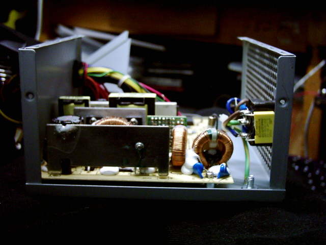

        I posted about this PSU just a day ago here; https://www.badcaps.net/forum/showpo...&postcount=164
        IMHO this design can not deliver 250w and stay within spec, with a 100uF primary cap and those extremely small 8mm caps on the secondary with 20AWG cabling I think this PSU would start to go out of spec at 150w DC
        Primary side;
        Bridge Rectifier; US4K 80R 4A,
        Switching Transistors; 3x FQPF5N50C 5A, 500V
        These are rated 5A at 25°C, derate 0.3W/1°C
        There is also a diode soldered to the same heatsink one of the lone above switching transistors sits on to "complete" this fine design, it's markings says (I think) SF38G 729, this would make it a 3A diode
        Secondary side;
        1x MBR2560CT; 25A
        2x YM3045N; 30A
        1x 1000uF 16v 8x20mm for +5vsb line
        4x 1000uF 16v 8x20mm for +12v line
        3x 1000uF 16v 8x20mm for +5v line
        2x 2200uF 6.3v 8x25mm for +3.3v line
        All are CapXon except one 1000uF 16v TEAPO strangely enough
        Hell, they even found a way to cheap out on the screws, it is held in place with 2 screws and perforated steel!
        Well I guess I should give them cred for 2 screws holding the secondary heatsink against the case of the PSU, then again they probably figured if they didn't use the whole case as a heatsink the thing would melt away with those woefully inadequate "heatsinks" (I'd rater call them slabs of aluminium)

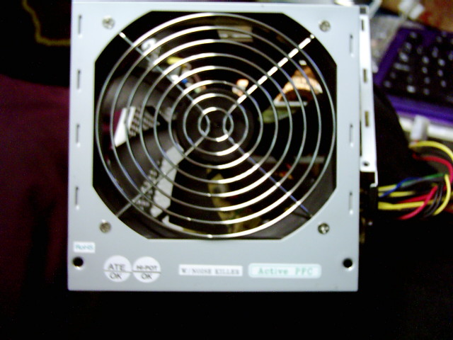

          best part, the fan hardly moves.
          temperature controlled - supposedly.
          although i got it pretty warm - it heated the top of the pc and the fan didnt speed-up!

            Primary side;
            Secondary side;
            1x MBR2560CT; 25A
            2x YM3045N; 30A
            One of the FQP5N50C's are probably for PFC, as well as the diode. The other two act as primary switchers in two transistor forward.
            Secondary side is also more than enough. Enough caps on the secondary for a 250W. I would say it's a 250W. Not a decent one, just a 250W. If you look at the PCB it's silkscreened to support much higher wattage builds, so it can probably deliver the wattage. Now the question is, does it do it in spec?

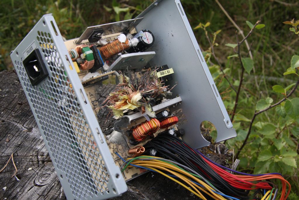

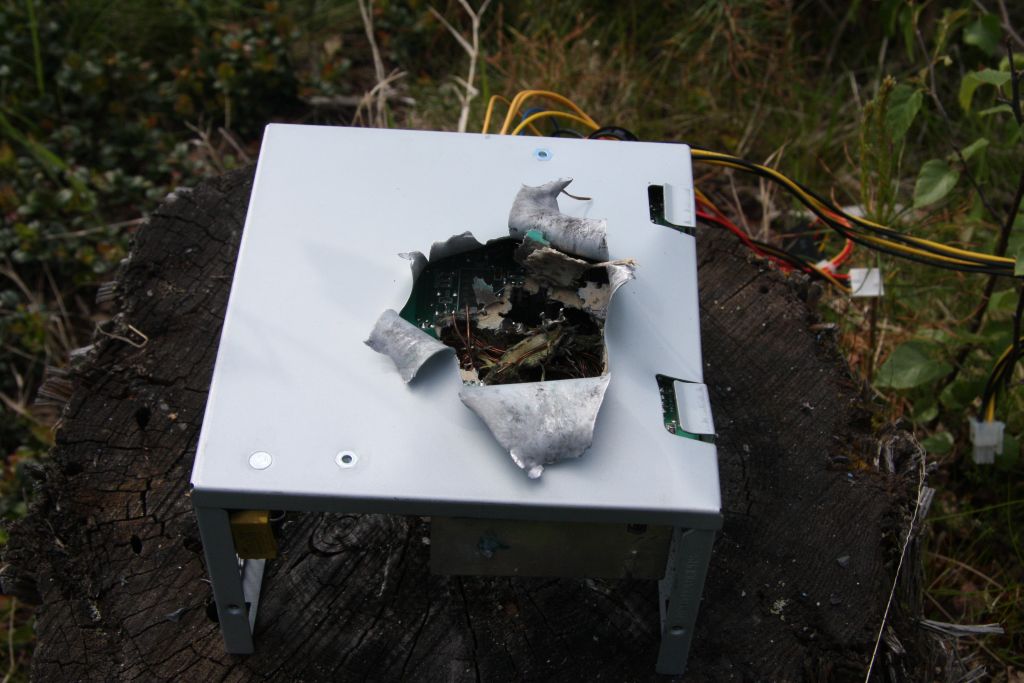

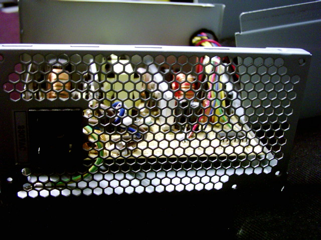

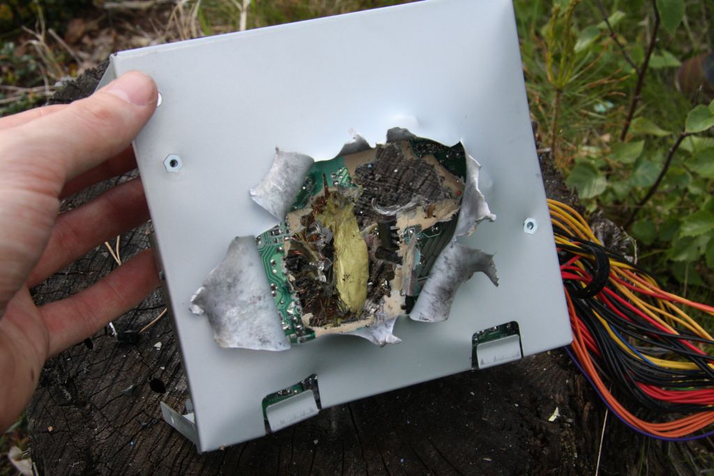

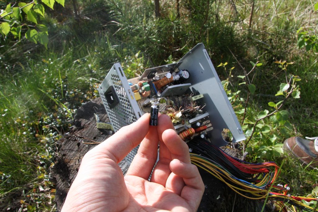

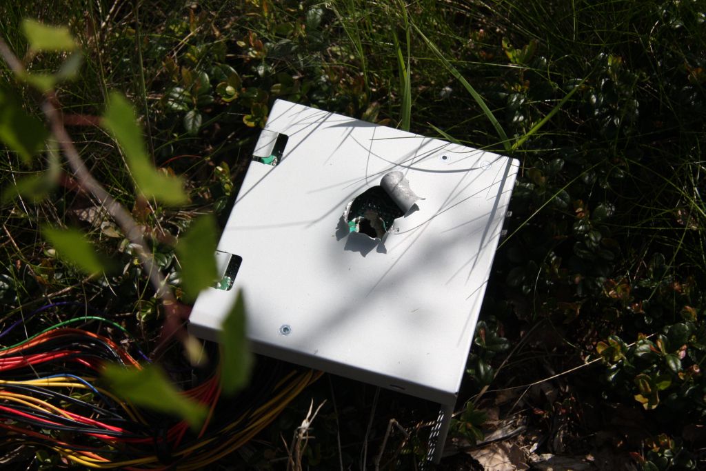

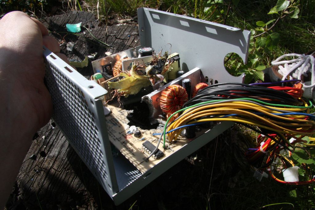

                          Hmm, I think I will have to let Jonnyguru down,
                          See I came to the conclusion that the FSP powersupply needed some additional airvents...
                          So me and a friend decided to work on that a little!
                          Hit one, nice tight venthole!
                          Hit one just barley wingclipped the transformer (I bet it's scared now!)
                          Hit two, yup, the transformer was right to be scared!
                          Much better air circulation now after hit two...
                          The exit hole after hit number three, even more airflow....
                          Hit three remodeled the heatsink for better surface to air contact, should cool much better now with these new fins!
                          Here was our problem, CapXon Capacitors, this ones literally shot
                          Final view of the finnished product...
                          And now two GIFs for the second and last shots
                          Last edited by Per Hansson; 04-23-2016, 01:44 AM. Reason: Offsite images uploaded due to problems with host

                            it maybe wasnt a good PSU, but that's just dumb IMHO.

                                    This psu in question where eating HDD´s so it whas a act of mercy. ( and a way to not forget why it where on a shelf). I have to remeber the deer slug have a q tec p suply lying around not woth recaping.
                                    This littel hunt resulted in one dead psu and 3 dead ant´s and one spoted elk (not season tho)

                                        Welcome to Badcaps Rooz
                                        Yea, Rooz was the marksman and I the photographer
                                        The FSP did not deserve to live, as I wrote in the big PSU thread it was a HDD killer...
                                        I don't have the equipment nor desire to fix such a poorly built PSU, it would need bigger heatsinks, better filtering on the secondary and much bigger capacitors (on both sides)
                                        It would also probably need better than AWG20 cabling if you intend to pull some current from it...
