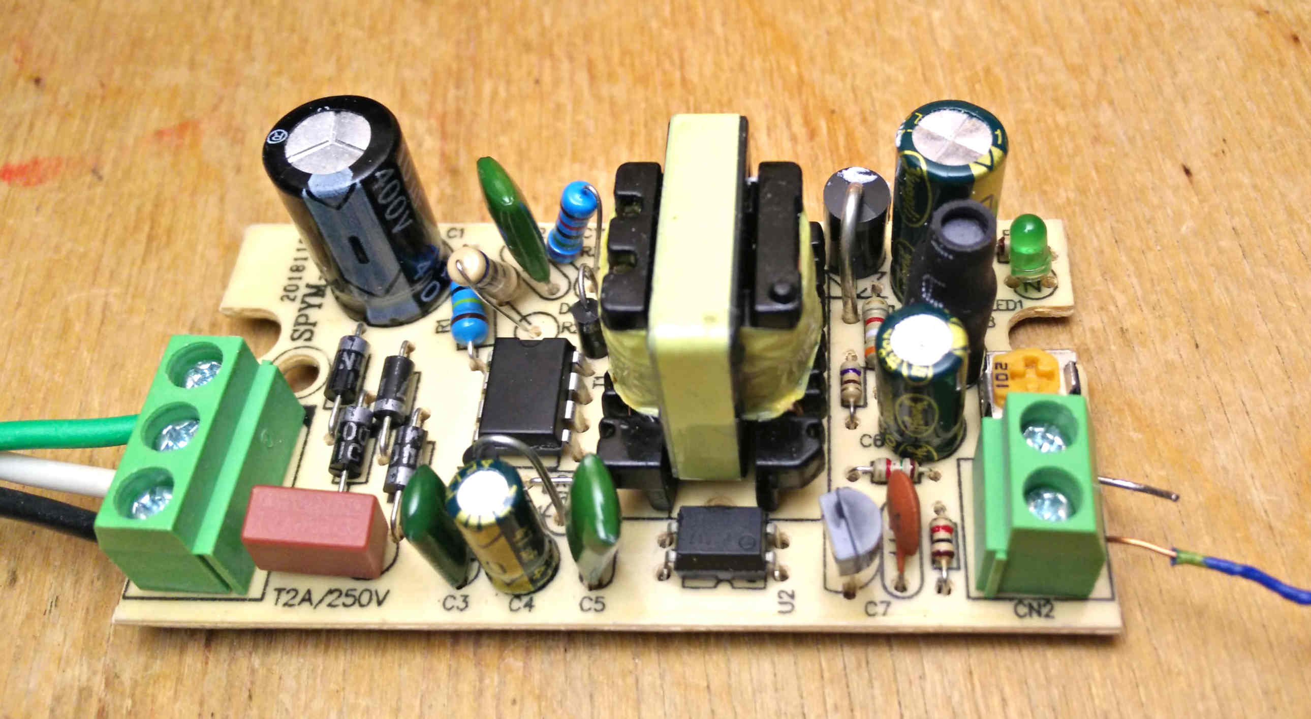

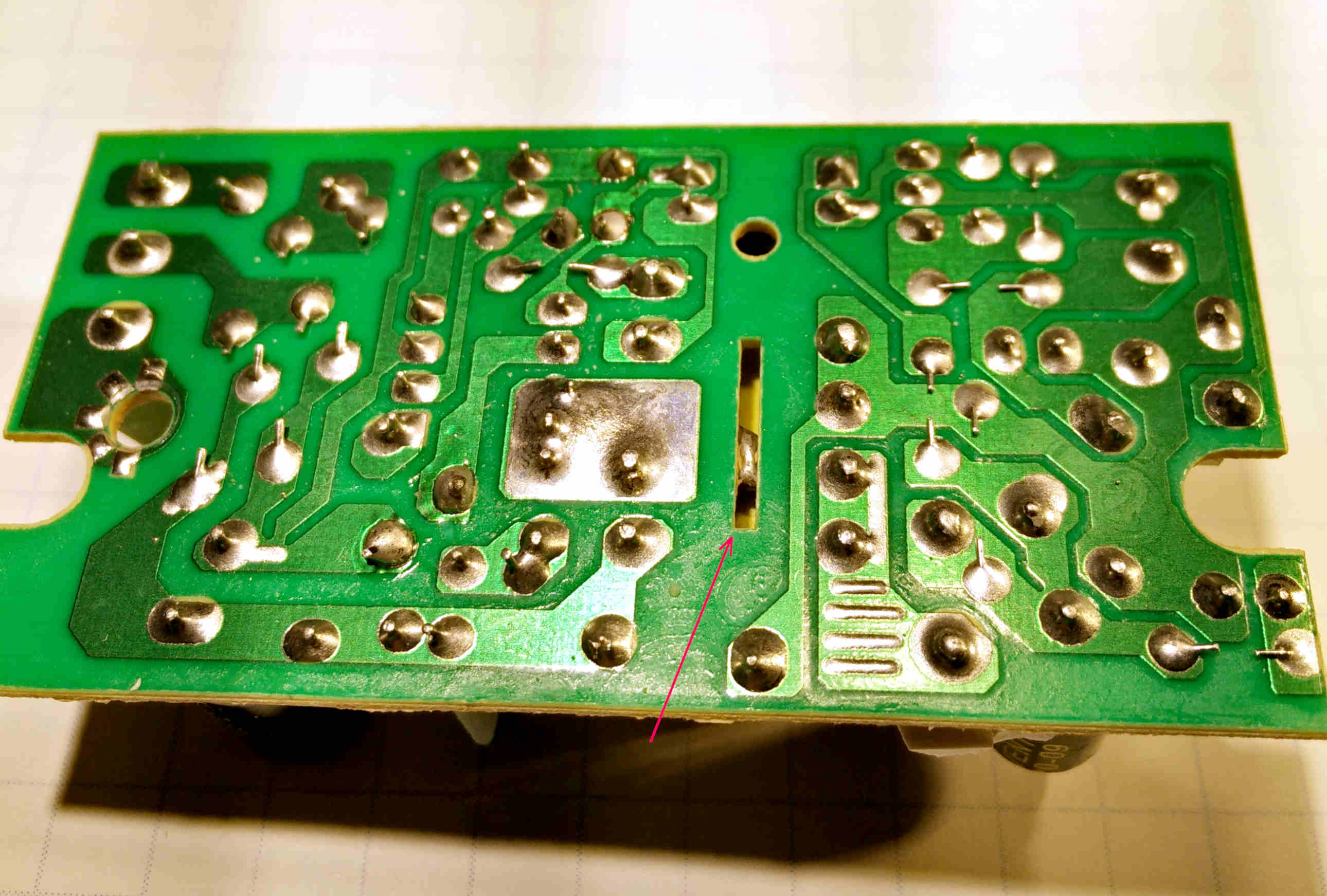

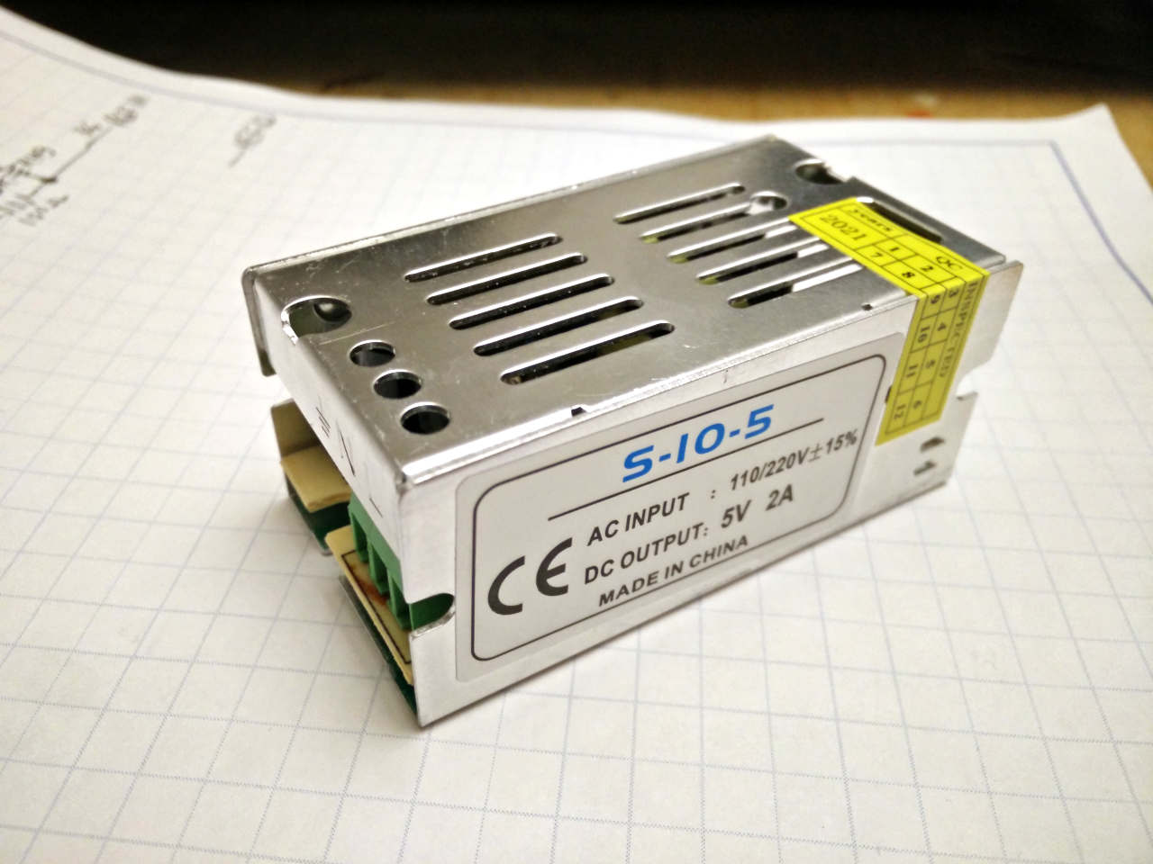

    I got a 5V 2A power supply for some hobby projects from Aliexpress store YXD Wish for about $4. S-10-5 and the build quality good, solder blob under transformer and a solder balls on the PCB top so I cleaned that up.
    Powered it up, get 5.0V but when connecting a load resistor it cratered. At 10R load which should be 0.5A, it dropped to 3.8V out and it went into hiccup mode below 5 ohms. About 1.5W output is all I can get.
    I drew out the schematic and poked around with a scope. It's running slow at 31kHz and primary current pulses are measly 30mA. So I think the IC is fake and not working, it has no markings.
    It appears to be a TX203H alternates are CR6203, RM6203, SDC603, SW2604, SL2128B. Commonly used in wall warts.
    (The bottom rung version of this same S-10-5 using phenolic PCB, uses IC DK1203 Dongke Semi and no current-sense resistor, and cheapened other stuff.)
    I asked for a refund and so far the vendor is quiet... I had another one ordered from a different Ali store but the floods took out rail and highways to the coast so it will be a while to get here and compare.

          The problem with these smaller power supply modules, they're always missing parts to be cheap.
          I look for: a fuse, common-mode choke/X-cap for EMC, NTC and decent sized primary cap. It's too much to ask. A name-brand AC wall-wart has all of that. But who wants to glue that down in your enclosure.
          I have another board, high quality - but the transformer runs pretty hot even at 1A load.
          In the 10W league, it's cheap chinese open-frame, or "high end" $20 potted modules like CUI PSK-S12B module. CUI VOF-10B rated 3-year life and has Teapo caps. UGH.
          Meanwell I'd looked at it was all big, 25W-50W is the smallest ,then the potted modules IRM-10-5V but who knows what's inside.
          Popular is the Hi-Link HLK-PM01 modules but no fuse, no input EMC filter.
          I'll keep looking, it seems easier to mod a cheap open-frame one.
