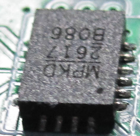

    I ended up getting one of these things and it appears to be broken.
    For some reason, though it passes charging current through just fine, the UPS/battery power does not work. Once power fails on the input, output power fails too.
    The weird thing:
    Input voltage: 5.0V
    Battery voltage: 4.1 V
    output voltage: 5.3V
    This should be a real simple device: a li-ion charger and a boost SMPS. The voltages would imply that both sections are working but nevertheless it flops flat when unplugged from a power source. The battery seems to be in good shape by itself.
    Unfortunately the parts on this are the typical SMT... any clues on datasheets?

    Monolithic power https://www.badcaps.net/forum/showpo...85&postcount=3
    The 2nd one is MP2617B https://www.monolithicpower.com/en/mp2617b.html
    I`m not sure what the first one is.

      Thanks yep that makes sense, the MPKD2617 is closer to the "input" so it is the charger. Just need to see where the pins go, but since I do see the 4.1V at the battery the other one is more suspect - unless the MPKD2617 gives a signal to turn the DKJ528 on/off...
      Actually it looks like the 2617 could be running the whole show... now I'm totally lost what the other chip's doing.

        How many pins does that DKJ528 have is it 12

          Re: Mission Cables USB charging cable "UPS"
          As far as I can tell,yes it looks like 12 pins.

            Found it,its 14 pins,there`s 2 pins underneath MP3421GG
            https://www.monolithicpower.com/en/d...en/sku/MP3421/
            The marking code is DK ,the J is a yearcode ,the numbers are a lot number

                    Damn I hate SMT. Trying to probe the board with tailoring pins since my multimeter probes are way too big, and even these pins are way too big not to mention having to hold them there while trying to look at the meter...
                    So far it seems the enable pin of the boost circuit seems incorrect though unfortunately it tracks underneath another component and finding where it goes will be a challenge. This crap circuit seems to be using a 4 layer board no less, not even sure it's necessary. Grr.
