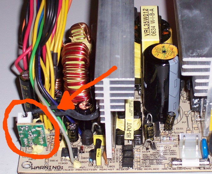

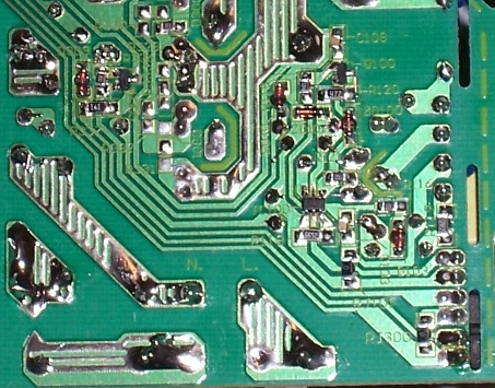

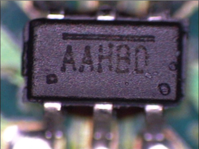

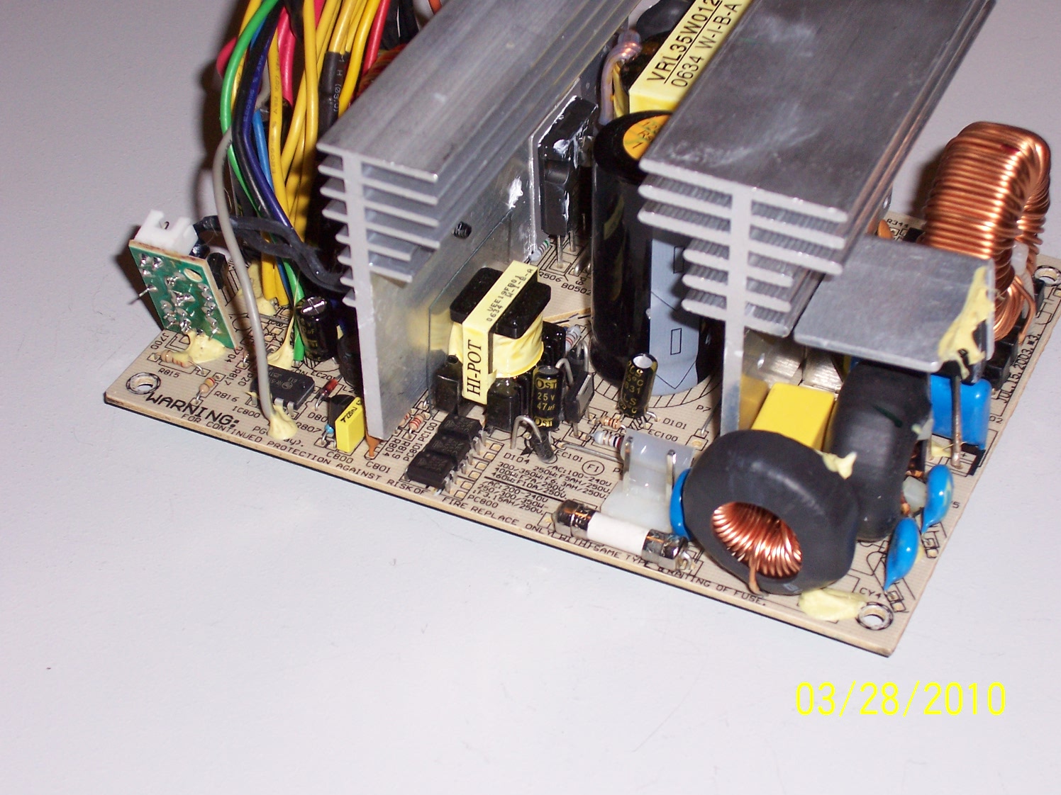

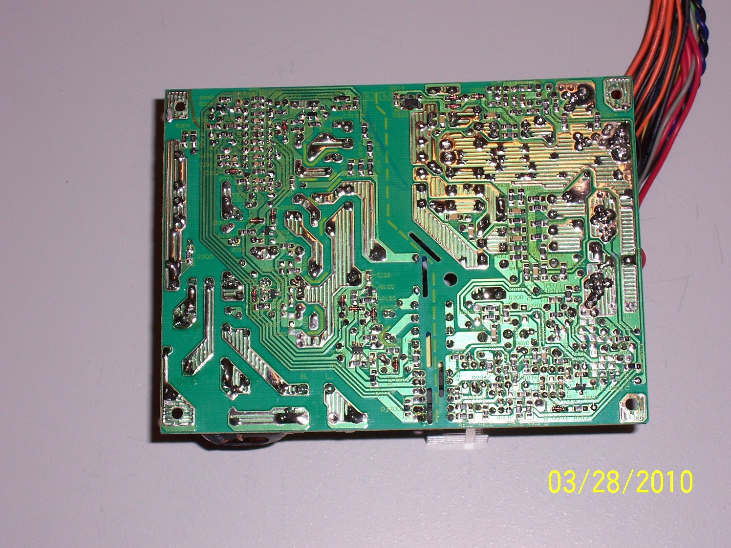

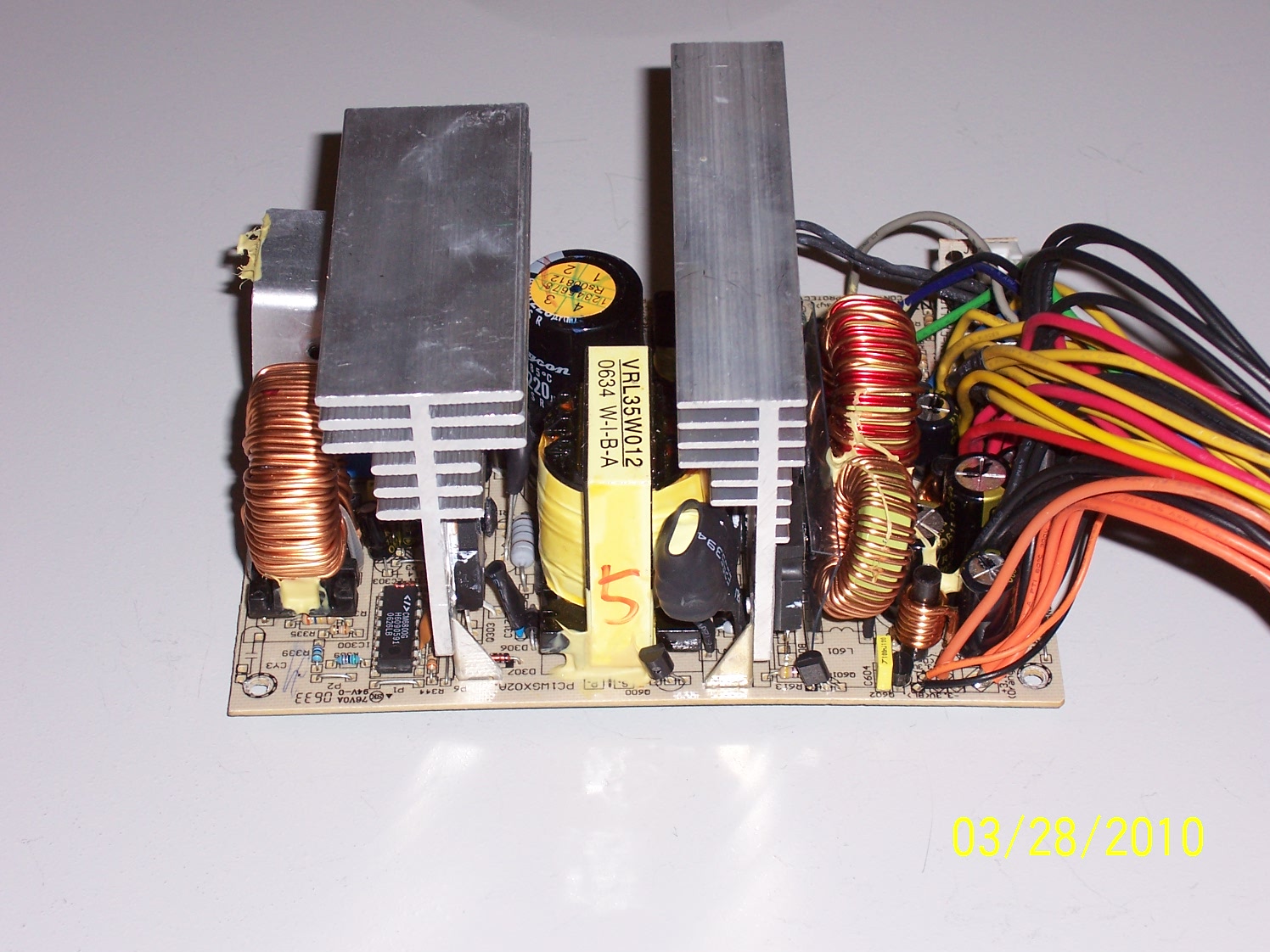

    Next big project is an Antec SU-380 with blown fuse. Of special interest is the 5vsb surface mount IC on the bottom of the pc board. Can anyone identify it???

    Could it be temperature control for the fan?
    Googling AAHB0 Gets a hit on the following:
    MAX6510CAUT-T
    Category: Sensors => Temperature Sensors
    Description: MAX6509, MAX6510 Resistor-programmable Sot Temperature Switches
    Company: Maxim Integrated Products
    TOP MARK ADNT ADNU AAHA AAHB
    Datasheet http://www.digchip.com/datasheets/pa...CAUT-T-pdf.php

      Re: Antec SU-380, no 5vsb, blown fuse...
      The temperature control is a separate PCB

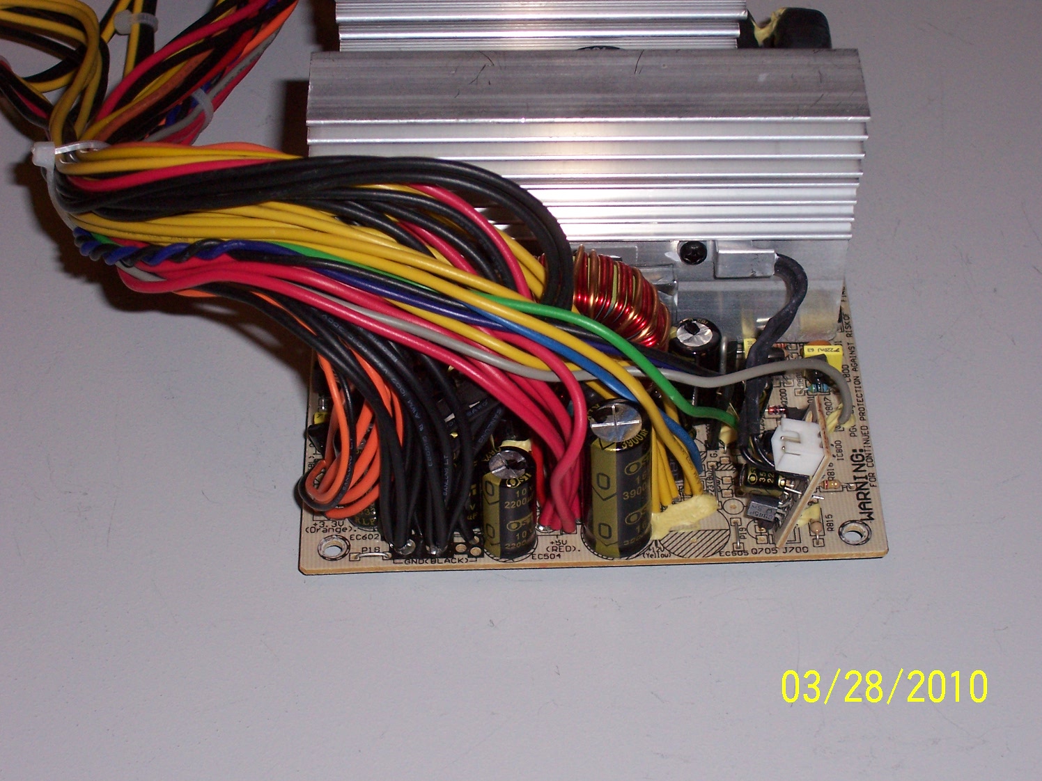

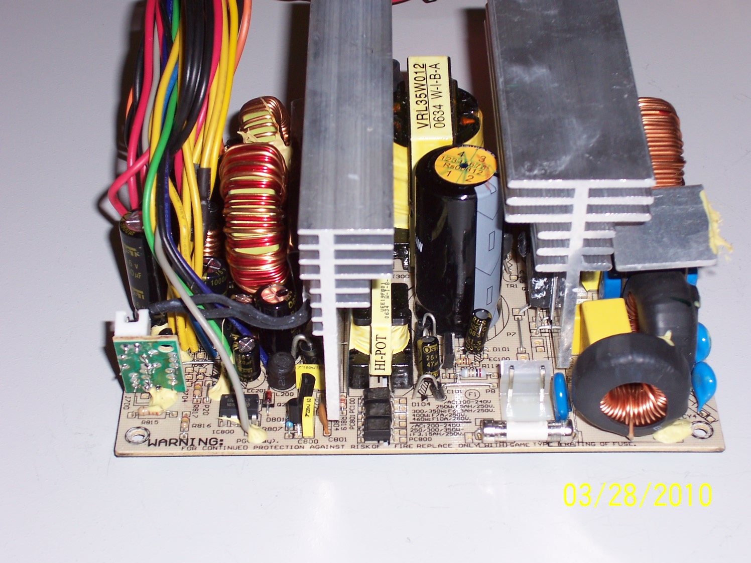

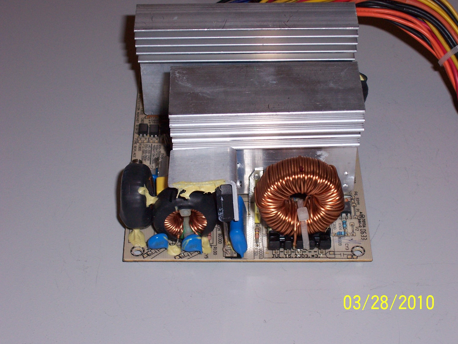

        Back to this power supply - have had to deal with family medical problems these past weeks.
        I measured resistance of lots of parts on this board and could not find anything shorted. So I boldly replaced the fuse and powered the psu. Everything came up working. All voltages OK. Now for the big question......what blew the fuse?
        As time permits, I will replace the 12 or so OST capacitors.
            "Now for the big question......what blew the fuse?"
            hmmmm......?
            Where's the soft-start thermistor??
            veritas odium parit
            • 370forlife
              Large Marge
              • Aug 2008
              • 3113
              Pretty sure that's it.
              • Toasty
                • Jul 2007
                • 4171
                If true, that seems an odd place. Typically expect to see it before the rectifier; right at the beginning of the line supply just after the fuse.

                        As a followup, here is some information on the 5vsb circuit for this power supply. Attached is a schematic. I never did find a data sheet on the pwm chip. With power supply plugged in but computer power off (ps-on in off mode), the 5vsb is running at 20.33 khz with pulse width of 1.0 usec for the turn on pulses. With computer power on (ps-on in on mode), the frequency of the pwm chip was very unstable, ranging from 24 to 33 khz.
                        Active PFC voltage measurements on the main input capacitor (220 uF 400 volts) is 160.5 DC with power off, and 377.8 volts DC with power on.
                        Fuse replaced and a recap, I am ready to put the pc board back in the case.
