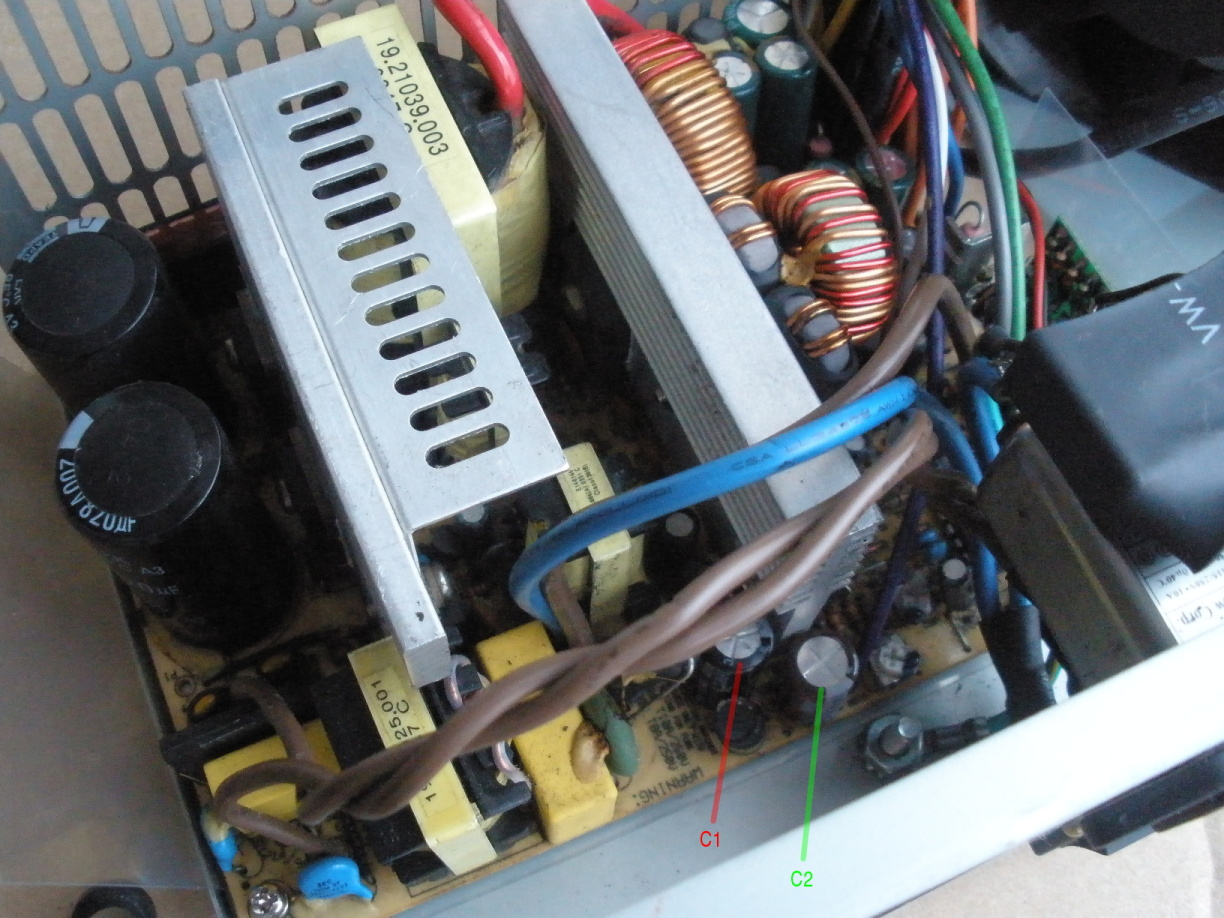

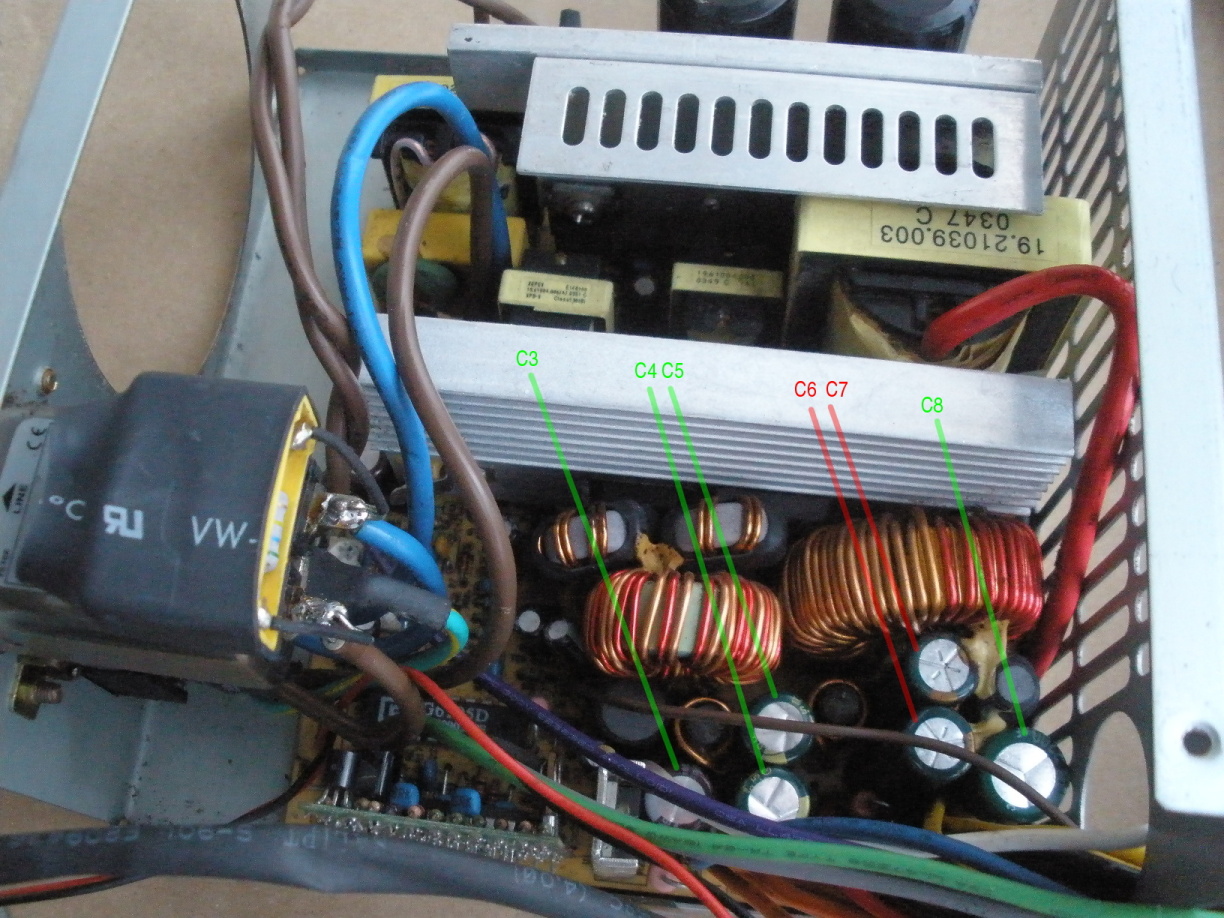

This w0009 "rated" 420W psu has stopped working after recap, lasting 4 days.
When powered all fans spin very shortly and everything dies.
I have +5.17V on 5VSB purple rail
Caps list:
I recapped all caps except C6, C7 & C1
C6 & C7 are used on red line rail
Caps list:
- teapo sh 16v 1000uf
- Nichicon PW 680uF ripple:1050 (replaced teapo sek 16v 470uF ripple:360)
- Sanyo WG 6.3v 3300uF (replaced jenpo)
- teapo ? 10v 3300uF
- NCC KZE 16v 2200uF (replaced jenpo)
