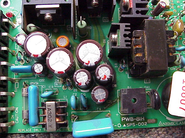

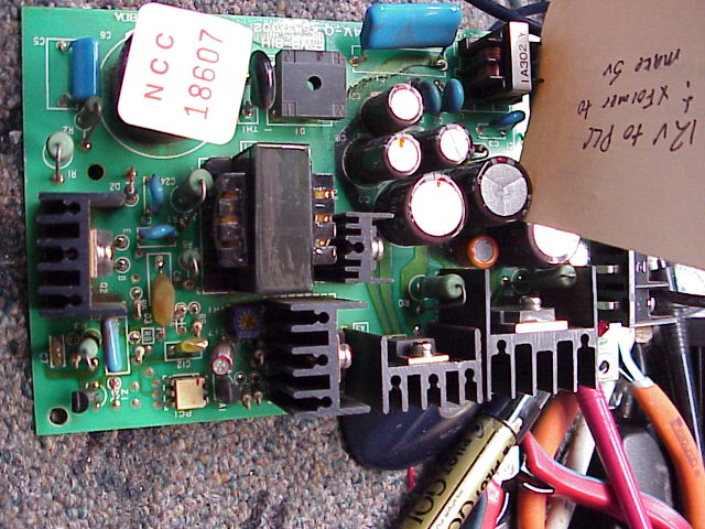

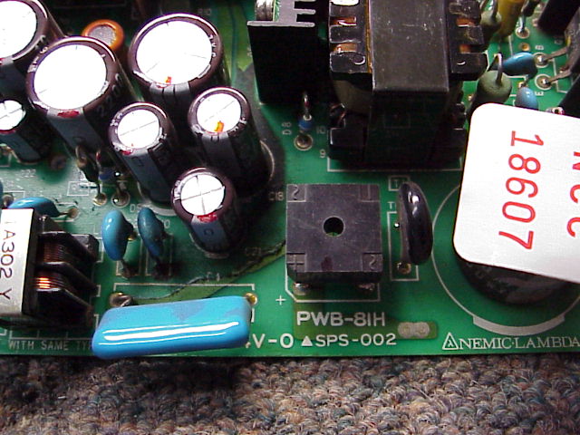

nemic-lambda industrial psu leakage from +12 to ac line!
  • kc8adu
    • Nov 2003
    • 8832
    • U.S.A!
    this is the second OH SHIT! unit in this mitsubishi laser.
    the first leaked caps ate the remote sense trace and overshot badly enough to trash the laser 4 pcb.
    this one has cap leakage bridging +12 to the ac.
