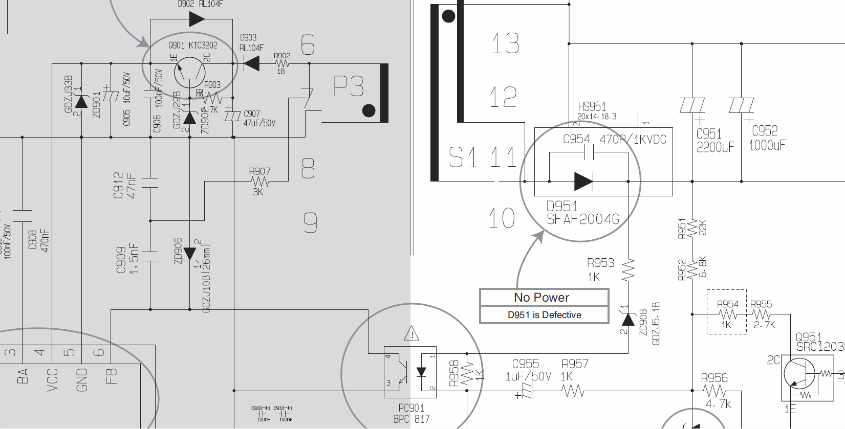

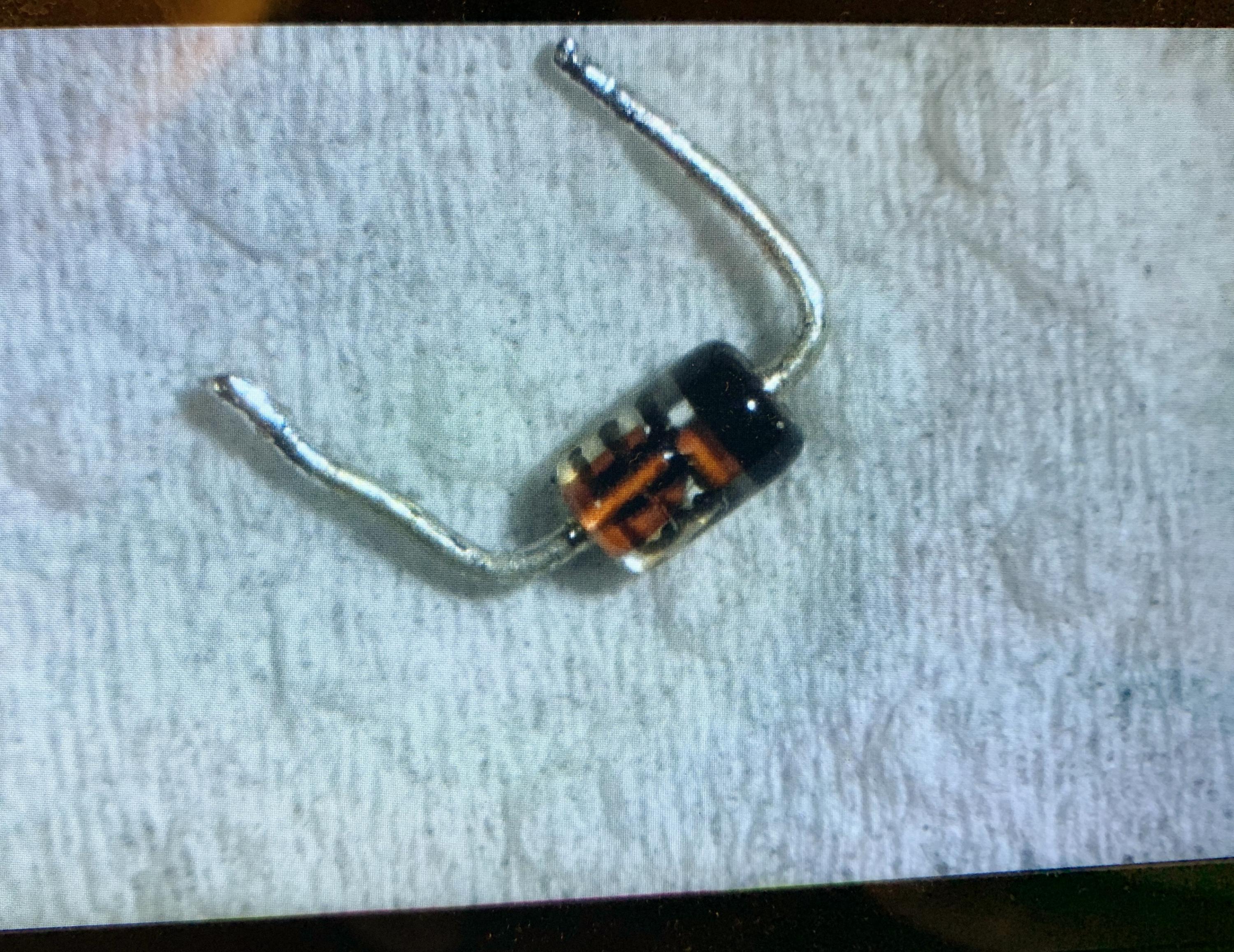

    Ive got a shorted zener diode on a power board for a sub but struggling to make sense of the markings to identify a replacement.
    From what i can make out says 33B5T
    This is what a google brings up
    https://datasheetspdf.com/pdf/102878...ents/MZC33B5/1
    Was looking at this as a replacement 3.3v Is this suitable?
    https://www.ebay.co.uk/itm/161636082...Cclp%3A2334524

    What Make & Model sub? it could be a 33v zener (33BST)

      It’s just a wireless sub part of a LG sound bar setup
      LG nb3530a
      Actually found another shorted zener directly after a octocupler from the primary to secondary side.
      I’ll get some board pics up shortly
      And yes the 5 could be a S, so 33BST

        I have two shorted zeners on the output of the optocoupler. One zener diode on the feedback pin and one on VCC. The feedback pin has a max rating of 5V and VCC has a max rating of 25V. Wouldn't this mean 33V zeners are unsuitable?

              The print reads 33B5T and I can't find any information regarding the values online. I've been searching for the past few hours for a data sheet that looks something like but I've had no luck.

                Rather, a regular 33v zener diode (stands in the role of power protection).

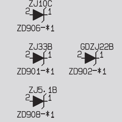

                  found a circuit for the power supply:
                  ZD901 - 33V
                  ZD902 - 22V
                  ZD906 - 10V
                  ZD908 - 5.1V

                      yep, standard design appears to be to use a 33v zener in that position
