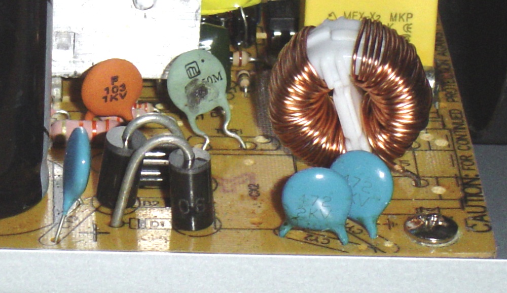

    My PSU "popped" a couple of days ago. Looks like the inrush current limiter has blown. Unfortunately the part of the component that came away has disappeared. It's the green component in the photo.
    Does anyone know the full markings for this component? I tried looking at a few websites with manufacturers logos on them, but couldn't find this one. The component still measures 6.6 Ohms in-circuit.
    The board is marked TB-1.2 REV:1.7
    ________________________________________________

    Find one from a junker PSU of equal or greater current rating (5A per the label). It's okay to put one from a 600w unit in there.

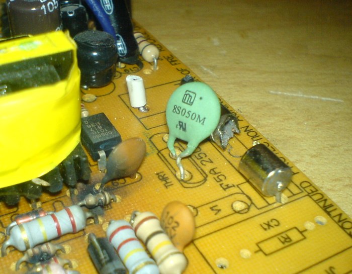

        This is a sunpro psu...
        I had a smiliar one (labeled 300w) which had this NTC labeled 8S050M.

              Re: Sum-vision KY-550ATX inrush current limiter
              Yep it's very definitely blown. You can see few burned resistors around 5vsb circuit and the big 5vsb transistor was shorted and the small 5vsb transistor blew itself in half. Oh and look at the bottom of c19 cap(5vsb filtering).

                I have actually replaced the PSU, so there's no urgency to get this one going again. Other than the component thats blown, I don't think there is anything else wrong, as the PSU carried on working after the "pop", giving me time to shut the PC down normally. Although I haven't powered the PSU up again since.
                I don't have any suitable scrap units, apart from 2 (very) old PC's which probably only have 200/250W PSU's.
                Thanks for the photo mur. It gives me an idea of what I have.

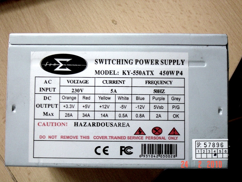

                      It does look like a Sun Pro as mur suggested. If it really is, don't bother! They use the cheapest caps possible, have tiny heatsinks and undersized components, and almost always a charred PCB as a consequence of that. Not worthwhile to fix in my opinion. Definitely something I'd never put in a working computer again.
                      But if you want to fix it for the sake of it, then why not. Keep in mind that the 450 watt rating on the label is a complete lie - this PSU won't do more than 200 watts, if even that much. With that said, a NTC from one of the old power supplies you have might work just fine.

                        Fox's psu isn't sunpro. Don't know what that is without a more detailed shot. Can't be too good, still has the 4 diode treatment.
                        Mur's psu is a sunpro, you can tell by the bright yellow transformer and just the text they use.

                          I think it is. Model number on this one is KY-550ATX. If you look up Sun Pro on the UL site (E210743), their page has many other PSUs with this KY-xxxATX m/n format. And then there's the mismatched input diodes, which is something I've only observed in Sun Pro and Powmax/Leadman PSUs.
