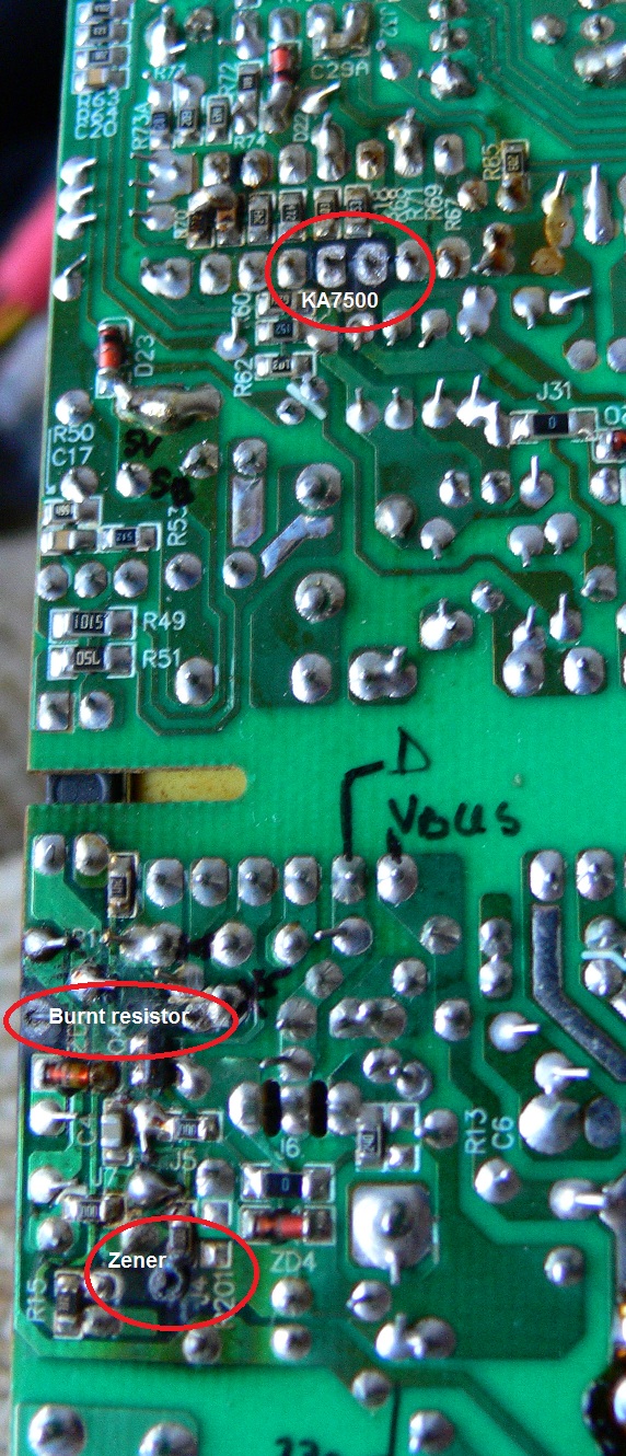

    Greetings everyone,
    A couple weeks ago, my dad got a semi-fried SmartPower 500W from a cousin of mine. First-look "diagnosis": all the big "Fuhkyuu" bloated (even the primary ones), one resistor "well-done" (from the 5vsb area to the PFC controller chip, most likely its Vcc), one "tanned" zener in the same area, two pins of the KA7500 controller somewhat burnt.
    I've attached photos of the "culprits". From what i've seen around this forum, the pcb is identical to the 350-400w versions, with the PFC section non-populated.
    I'm going to chip-mod the 5vsb section, most likely with a TNY266's i've scavenged from a Dell PSU. I think/hope i've correctly "transplanted" everell's DM311 schematic to the TNY266, just too bad his photo-guide isn't quite as clear as i'd like it
    Now, i intend / hope to revive it sometime soon. My hunch is that the PWM is quite surely fried, by the looks of things. With a bit of luck, i think i can source a replacement from a friend (it's pin-to-pin compatible with TL494).
    I'd appreciate any tips you might have. It's a CWT-built unit, so it looks sturdy, to say the least, and it'd be quite a shame to go to waste
    PS: Of course, it WILL get a re-cap (Nichicon, UCC, Rubycon and whatever else i can find in my stocks, of the right values and can sizes)

    That power supply looks like it is going to be quite a project - but not impossible. I worked on a Antec SP350 with similar problems, and can offer some tips.
    The pwm chip, KA7500, is most likely bad. The burnt pins are Vcc power coming in and output to driver transistor #2. This means the the driver transistor #2 is probably shorted. On mine, I replaced the 7500 and both driver transistors, H945. If you have other junked out boards around, the 7500 chip and the 945 transistors are very common. One of the driver transistors also had a leaky diode which prevented proper startup. I replaced the diodes on both driver transistors.
    The main switching transistors were leaky, and the resistors R6 & R8 were fried beyond recognition. Replacement value is 2.7K. I also replaced a few other resistors in the switching circuit that had signs of burning. Also important to replace the 4.7 uF/50V capacitors in that circuit.
    As for the 5vsb circuit, mine was working when I started, measuring 12.15 volts. That is why I gutted that circuit and replaced it with my DM311 mod. Important to understand that the DM311 is NOT the only chip that can be used, and you can probably make other chips work. The DM311 operating frequency is 67 Khz, which worked with the transformer in my psu. Check the data sheet for whatever pwm chip you plan to use. If it runs at a higher frequency, such as 132 Khz, the transformer might not work properly with it.
    Keep us posted with your progress. If you have any questions, I will be happy to try to help. Toasty has also done a lot of work on the Antec SP series.

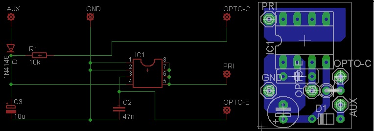

        everell , i can post the schematic for the Viper12A-based switcher, which i modeled after your DM311 design, if you'd be willing to "double-check" it
        BrianC , i intend to remove / bypass the discrete 5Vsb switching circuit, and replace it with an IC.
          Would love to look at it - perhaps can make recommendations - but the final proof is how well it performs.

                >>all three pin-to-pin measurements showed "out of range", so no shorts there either.
                On Diode Test function? I assume DMM. Should show something.
                D10 is likely shorted taking out R11. Check D8 and Q3 and solder side Q4 (1P), ZD1, R13(chip 24Ω) on Source leg of Q3. All of this likely caused 5vsb to go high taking out the SMPS controller KA7500C. That crack in the top of the chip is -not- an ion ram scoop.

                  Previous test was on 200ohm scale. On diode test, it says "534" (red-drain, black-source), and "634" (red-drain, black-gate), other combinations show "out of range". This is for Q3 (main 5vsb switcher).
                  Both D8 and Q3 look ok visually (diode right up against trafo, and the main 5vsb switcher), D8 measures in at 541 (mV, i'm guessing).
                  Q4 measures ok, but i'm not sure (618 red-B black-C, 625 red-E black-C).
                  ZD1 says 707 (red-edge of pcb, black-inside) and goes "out of range" the other way around.
                  R13 looks ok, and measures in at 25 (says "240" on it, but i blame the crappy DMM for the 1ohm inaccuracy ).

                          everell , here's the schematic and the pcb for the VIPer12A 5vsb board, and HERE is the application note i used to "transplant" this, to make it look like your DM311 circuit.

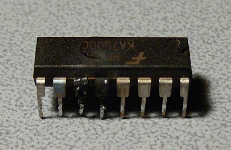

                            Yep... I think it's safe to say this chip has seen better days...
                            Possibly noob-ish question: if i were to power up the psu without the pwm in it (as in just plug it in the wall socket), it shouldn't blow up, right? Or at least not before i'd have a chance to check the 5vsb, for instance...
                            Khron's Cave - Electronics - Audio - Teardowns - Mods - Repairs - Projects - Music - Rants - Shenanigans
                              Looks good to me. Give it a try and let us know how it works.
                                If no other problems with the psu, that is correct. If you see or smell smoke, turn off immediately because the main switching transistors are bad. You can resolve that problem by unsoldering them and taking them and the heat sink out, then continue with evaluating your 5vsb circuit.

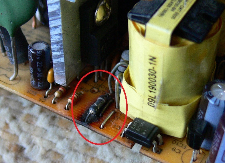

                                  Although I must admit, i'm still a bit worried about that "well-done" zener (or whatever it is, visible on the solder-side photo), and that "coverless" resistor in the PFC Vcc (first photo)...

                                      Not this one. From what i noticed, my 500w version and the 350-400w versions share the same pcb design, but those two don't have the places filled; mine does. The PFC coil's opposite the input filter, and it has an 8-pin KA3844 controller, if my memory serves me right. Also, the 350-400w ones don't have the resistor that's blown on my board (which goes to the KA3844's Vcc pin).

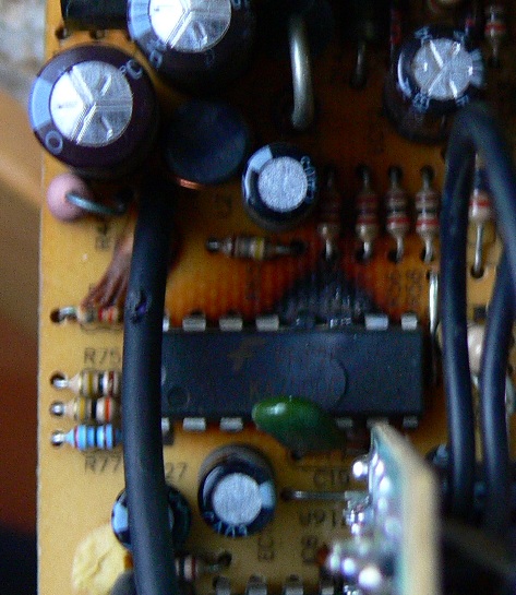

                                        Before power up - would you please post a few more pictures - showing that pfc circuit, and a top down showing entire circuit board.
                                        As for your new 5vsb circuit board, how are you going to mount it? I didn't see any mounting holes. It needs to be securely mounted to something.
                                        Looks like your time zone is about six hours ahead of here. Are you in UK or Europe?
                                        Photo of your 7500 chip with "ion ram scoop" looks cool!
