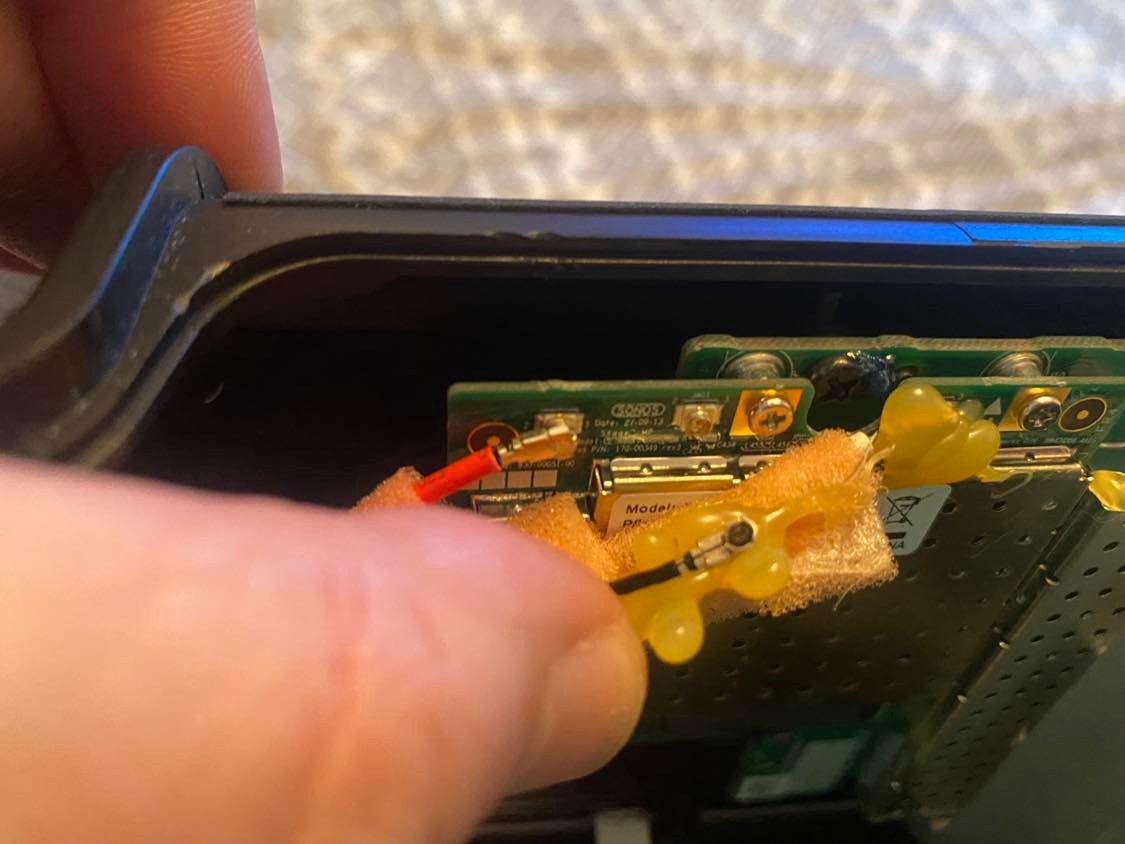

                    Hey guys and girls, came here searching for a solution to my high pitch whining Sonos playbar. Decided to order up replacement capacitors and some insulating varnish as per BossCharles and Dobrykamil. I thought while the unit was in pieces I might as well carry out both "repairs".
                    Anyways, worked a charm. Nice and quiet now. If your unit was anything like mines you might be in luck!
                    This fella's video helped me get a grasp of the teardown and what to expect.
                    https://www.youtube.com/watch?v=wltivp3ty3E
                    If you're in the UK, I ordered RS Stock No.708-3746 for the capacitors.
                    And RS Stock No.199-1480 for the varnish.
                    Wee note, I removed the three capacitors and using a little cup with some varnish in, I dipped the transformer in while still attached to the board. You'll just need to find something to support the board on both sides while it's in soaking in there. Left it for about 4 hours before removing. Left it another few hours to dry then popped the replacement caps in and reassembled. One thing I will say is that there were some tiny little cable headers that were secured in place using hot glue, (see attached) upon refitting they did positively snap back into place, but it might be beneficial to have hot glue at hand to help secure them in place.
                    Just wanted to say thanks to those who offered help/ suggestions, and if anyone else stumbles across this post looking for a solution, it's worth a shot! You saved me a fortune, cheers!
