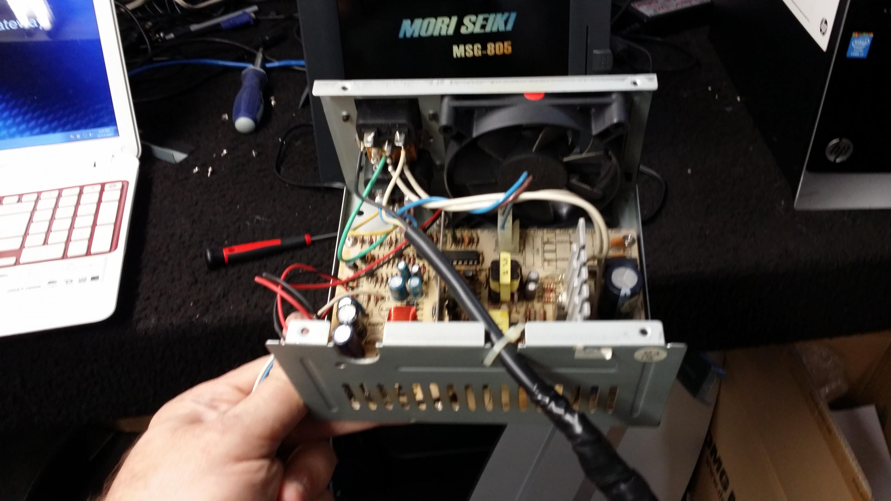

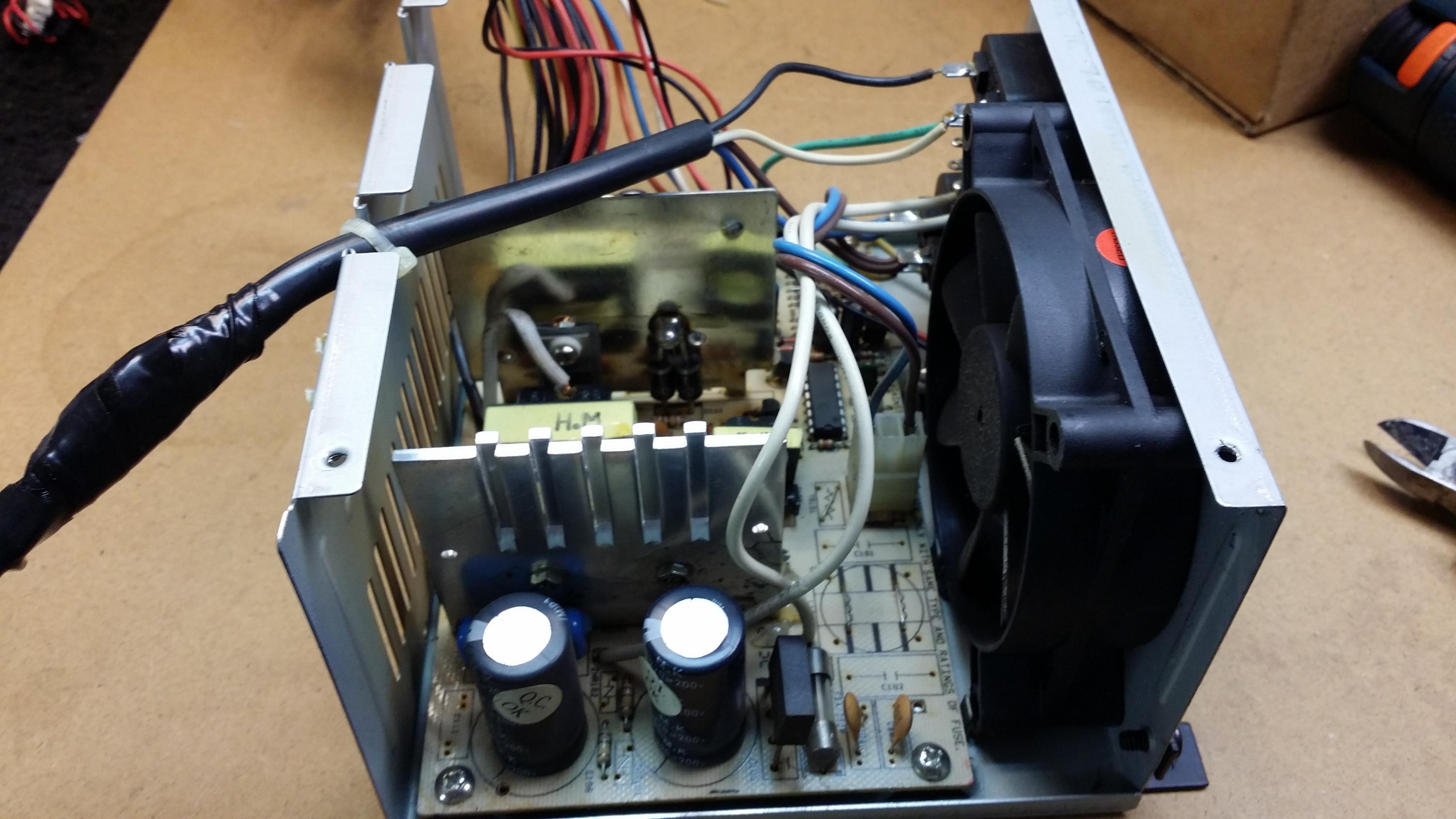

the gutless, bloated, and fried power supply hall of shame
This is a sticky topic.
  • jazzie366
    • May 2016
    • 304
    #1361
    Re: the gutless, bloated, and fried power supply hall of shame
    Originally posted by Wester547
    CRT TVs / monitors aren't nearly as hard on their caps as LCD TVs / monitors are.
    Heh, it's only 3 years old. The real test of any bad cap is time.
    One could also chalk that up to the inconsistency that is characteristic of many bad crap brands.
    Inconsistency true, but seeing as they've been the same for so long, and that the datasheets haven't changed in ages other than for looks I'm not buying it.
    They may not be as hard on the caps, but then there's people like Samsung that used them. One might argue KSC branded caps are bad, meanwhile Apple also used them in their PSUs, just opened one from over 10 years ago recently, the caps are all KSC and doing fine. Same can go for Beryl, Lscon, Su'Scon etc. I blame the manufacturers more than anything.
    Popcorn.
      master hoarder
      • May 2008
      • 12175
      • Bulgaria
      #1362
      Re: the gutless, bloated, and fried power supply hall of shame
      Originally posted by jazzie366
      They may not be as hard on the caps, but then there's people like Samsung that used them. One might argue KSC branded caps are bad, meanwhile Apple also used them in their PSUs, just opened one from over 10 years ago recently, the caps are all KSC and doing fine. Same can go for Beryl, Lscon, Su'Scon etc. I blame the manufacturers more than anything.
      That's exactly the problem with crap cap brands - some will run 10+ years and some will die in a year or less.
      Yes, it is important how the cap is used in the device and if abused by heat, excessive ripple, and whatnot. But still, I have seen way too many crap cap brands last only a little bit in one device and much longer in the same model device - particularly in PC PSUs. So I still rather avoid crap cap brands when possible - or at least when doing repairs for other people. For my own stuff, I often leave the device alone until a problem surfaces. Or in some cases, I replace only the caps that are most critical and can cause damage if they failed.
      Last edited by momaka; 10-04-2017, 06:15 PM.
      • Wester547
        • Nov 2011
        • 1268
        • USA.
        #1363
        Re: the gutless, bloated, and fried power supply hall of shame
        Originally posted by jazzie366
        They may not be as hard on the caps, but then there's people like Samsung that used them. One might argue KSC branded caps are bad, meanwhile Apple also used them in their PSUs, just opened one from over 10 years ago recently, the caps are all KSC and doing fine. Same can go for Beryl, Lscon, Su'Scon etc. I blame the manufacturers more than anything.
        I’ve seen many a failed KSC in Huntkey PSUs, the same PSUs in which Fcon and Teapo regularly blow up (along with a host of relatively unknown Chinese brands). KSC don’t always show visible signs of failure either. Yes, they may be better than CapXon, Sacon/Evercon/GSC, YEC, Stone, Rulycon/Jee, Goldlink, pre-merger G-Luxon, Jackcon, Hermei, Arcon, Chhsi, Fuhjyyu, etc, but that doesn’t make them trustworthy.
        My takeaway is that such brands (and bad series) should not be used in mission critical / heavy duty applications at the very least, such as a workstation or a server PSU or motherboard.
        Last edited by Wester547; 10-04-2017, 07:11 PM.
        • eccerr0r
          Solder Sloth
          • Nov 2012
          • 8703
          #1364
          Re: the gutless, bloated, and fried power supply hall of shame
          Originally posted by jazzie366
          What? That has full wave bridge rectification? There are 4 diodes right outside the AC input.
          I wasn't talking about that one, watch closely to what you're quoting.
          I was talking about the one _I_ had, and prepare to wince in pain where three diodes AND the feedback circuitry were omitted for cost savings:
          • jazzie366
            • May 2016
            • 304
            #1365
            Re: the gutless, bloated, and fried power supply hall of shame
            Originally posted by eccerr0r
            I wasn't talking about that one, watch closely to what you're quoting.
            I was talking about the one _I_ had, and prepare to wince in pain where three diodes AND the feedback circuitry were omitted for cost savings:
            HOLYSHIT
            Is that a measly 47uF smoothing cap on the output?!
            Popcorn.
            • kc8adu
              • Nov 2003
              • 8832
              • U.S.A!
              #1366
              Re: the gutless, bloated, and fried power supply hall of shame
              noname pos at supply found in industrial equipment.
              more wire jumpers than parts.
              • kc8adu
                • Nov 2003
                • 8832
                • U.S.A!
                #1367
                Re: the gutless, bloated, and fried power supply hall of shame
                what regulation?
                and who cares about line/load isolation?
                Originally posted by eccerr0r
                I wasn't talking about that one, watch closely to what you're quoting.
                I was talking about the one _I_ had, and prepare to wince in pain where three diodes AND the feedback circuitry were omitted for cost savings:
                • eccerr0r
                  Solder Sloth
                  • Nov 2012
                  • 8703
                  #1368
                  Re: the gutless, bloated, and fried power supply hall of shame
                  Yeah that wall wart was a real POS. I wonder how well it'd perform if I added the missing parts...
                  • Behemot
                    • 4845
                    • CZ
                    #1369
                    Re: the gutless, bloated, and fried power supply hall of shame
                    Oh yeah baby, there's that diode treatment too
                    That AT unit, so some turning machine or something like that?
                    • RukyCon
                      A Fake Rubycon
                      • Jan 2017
                      • 816
                      #1370
                      Re: the gutless, bloated, and fried power supply hall of shame
                      Originally posted by eccerr0r
                      Yeah that wall wart was a real POS. I wonder how well it'd perform if I added the missing parts...
                      Maybe you can take a look at this one and tell me if it can output 2 amps.
                      (this one you can't fill in the missing parts)
                      When it arrived i found out it was broken. (the seller is shipping me a new one for no extra cost even though i just wanted a refund, oh well)
                      Last edited by RukyCon; 10-13-2017, 11:40 PM.
                      I'm not a expert, I'm just doing my best.
                      • Behemot
                        • 4845
                        • CZ
                        #1371
                        Re: the gutless, bloated, and fried power supply hall of shame
                        Maybe about an amp. I presume the blue cap is not safety-rated.
                        • RukyCon
                          A Fake Rubycon
                          • Jan 2017
                          • 816
                          #1372
                          Re: the gutless, bloated, and fried power supply hall of shame
                          Originally posted by Behemot
                          Maybe about an amp. I presume the blue cap is not safety-rated.
                          You are right about the blue capacitor not being safety rated.
                          Also the primary capacitor is a fake Ymin LKL 6.8uf 400v capacitor. (Two reasons why i think the Ymin cap is fake. #1 the print on the heatshrink looks like crap and #2 the maximum temperature rating on the capacitor is "125°C" when on the datasheet it says it should be 130°C)
                          I'm not a expert, I'm just doing my best.
                          • Per Hansson
                            • Jul 2005
                            • 5895
                            • Sweden
                            #1373
                            Re: the gutless, bloated, and fried power supply hall of shame
                            Originally posted by kc8adu
                            noname pos at supply found in industrial equipment.
                            more wire jumpers than parts.
                            It reminded me of this, it's kinda the opposite where the PSU is fine, but just as many jumper wires
                            https://www.badcaps.net/forum/showpo...postcount=1039
                            • jazzie366
                              • May 2016
                              • 304
                              #1374
                              Re: the gutless, bloated, and fried power supply hall of shame
                              Originally posted by Wester547
                              I've seen many a failed KSC in Huntkey PSUs, the same PSUs in which Fcon and Teapo regularly blow up (along with a host of relatively unknown Chinese brands). KSC don't always show visible signs of failure either. Yes, they may be better than CapXon, Sacon/Evercon/GSC, YEC, Stone, Rulycon/Jee, Goldlink, pre-merger G-Luxon, Jackcon, Hermei, Arcon, Chhsi, Fuhjyyu, etc, but that doesn't make them trustworthy.
                              My takeaway is that such brands (and bad series) should not be used in mission critical / heavy duty applications at the very least, such as a workstation or a server PSU or motherboard.
                              Yeah, Huntkey was BestBuy's house brand right? I know currently Insignia is, and they are still using the same OEM from ages ago, still using fCon cabps in them. I know they aren't all fCon now though, some of them are Taicon on the secondary, some are fCon and they're quite large values (3300uF and 2200uF seemed to be the most common ones).
                              Yes, I know it doesn't make the caps trustworthy, but I'm still blaming the manufacturers of the power supplies for the failures, seeing as in other applications, albeit they were smaller, they lasted and are still good to this day. So while that might not make them "amazing" capacitors, but they're at least half decent so I'd assume if they were ran well under spec they'd be fine.
                              Popcorn.
                              • jazzie366
                                • May 2016
                                • 304
                                #1375
                                Re: the gutless, bloated, and fried power supply hall of shame
                                Originally posted by ruky con
                                You are right about the blue capacitor not being safety rated.
                                Also the primary capacitor is a fake Ymin LKL 6.8uf 400v capacitor. (Two reasons why i think the Ymin cap is fake. #1 the print on the heatshrink looks like crap and #2 the maximum temperature rating on the capacitor is "125°C" when on the datasheet it says it should be 130°C)
                                That is in fact, a fake Ymin. The vent is wrong, and it's pushed in. That's the #1 sign of a fake cap, the vent. That's a common cheapo way of putting a vent on a crap cap. They use a punching machine to put the vent in without supporting the bottom of the can, so it just presses in. This almost ALWAYS makes contact with the foil on top, so if it's a high voltage cap, the WHOLE CASE it live at mains voltage. Now, this might be true for most caps, except in this case, there is an incredible current behind it.
                                And the printing with the logo is wrong, there should be more spacing between it. The spec of temp being wrong is also a dead giveaway.
                                I'm curious as to why there are so many fakes of brands like these. One thing I've started to notice is that they all are re-wrapped. I've found knife marks and scratching on the cases of crap caps, indicating that the fakers are buying caps from someone, and then re-wrapping them.
                                There's a brand of cap called Orient that I'm suspicious of being behind this. I've received some of their caps from cheap china lots, and what I've seen is that they re-wrap their caps with newer wrappings on them, meaning they've taken older stock and re-wrapped it with newer wrappings to make them look new. It makes me suspicious that there's some fuckery going on there.
                                Popcorn.
                                • Behemot
                                  • 4845
                                  • CZ
                                  #1376
                                  Re: the gutless, bloated, and fried power supply hall of shame
                                  Recycling is a big thing in the west, so China's just trying to catch up. So we send them ships filled with e-waste, and they try to reuse everything. Either whole refurbished and repacked boards, or at least as a spare parts. In worst case they disassemble it to the basic components and resell those. Back here OFC. They've been doing that for some time now with lithium cells. Obviously they moved forward and started re-wrapping caps too.
                                  I bought some used MOSFETs some time ago with new electrodes stamped onto the old ones. This may actually be the cheapest way how to obtain genuine power FETs from China as they won't be faking used transistors when there is so many genuine ones going back for free. Among the new ones, if it is really cheap, 99 % of them are fakes.
                                  Kinda makes you wonder why ppl are so dumb to send it there for free (throwing it to those like an all eco-friendly-whatever-crap e-waste bins and making some subsidised suckers rich) and than buy it back again as a „new one“ on sale from fleebay etc.…
                                  • Agent24
                                    I see dead caps
                                    • Oct 2007
                                    • 5079
                                    • New Zealand
                                    #1377
                                    Re: the gutless, bloated, and fried power supply hall of shame
                                    Originally posted by Behemot
                                    Kinda makes you wonder why ppl are so dumb to send it there for free (throwing it to those like an all eco-friendly-whatever-crap e-waste bins and making some subsidised suckers rich) and than buy it back again as a „new one“ on sale from fleebay etc.…
                                    Semiconductor companies and component distributors are going to make more profit selling next year's designs to new industry than anyone selling recycled parts to repair technicians.
                                    Average consumer Joe doesn't know what a MOSFET is, but he can buy a new TV for $199 on sale so he doesn't care anyway.
                                    Only people like us care, but we are not a high profit market. China makes a profit because they get all the e-waste for free (or get paid to take it) and the market is bigger than zero, so they're still not losing money and they don't seem to care about tiny profit margins (for now).
                                    -David VanHorn
                                    • RukyCon
                                      A Fake Rubycon
                                      • Jan 2017
                                      • 816
                                      #1378
                                      Re: the gutless, bloated, and fried power supply hall of shame
                                      I just noticed some scratches on the vent like someone used a knife on this capacitor. This makes me believe that this capacitor is indeed second hand.
                                      Last edited by RukyCon; 10-14-2017, 04:20 PM.
                                      I'm not a expert, I'm just doing my best.
                                        master hoarder
                                        • May 2008
                                        • 12175
                                        • Bulgaria
                                        #1379
                                        Re: the gutless, bloated, and fried power supply hall of shame
                                        Originally posted by kc8adu
                                        noname pos at supply found in industrial equipment.
                                        more wire jumpers than parts.
                                        Awesome!
                                        With mostly jumpers inside, that label sure puts a whole new meaning to "NO SERVICEABLE COMPONENTS INSIDE"
                                        Last edited by momaka; 10-14-2017, 08:44 PM.
                                        • jazzie366
                                          • May 2016
                                          • 304
                                          #1380
                                          Re: the gutless, bloated, and fried power supply hall of shame
                                          Originally posted by ruky con
                                          Maybe you can take a look at this one and tell me if it can output 2 amps.
                                          (this one you can't fill in the missing parts)
                                          When it arrived i found out it was broken. (the seller is shipping me a new one for no extra cost even though i just wanted a refund, oh well)
                                          Out of curiosity, can you crack open that transformer? It looks half decent for an overall shit power supply.
                                          Popcorn.
                                          • bauto601
                                            KDM 480W PSU upgrade succes! (opinions?)
                                            by bauto601
                                            Back in 2020 i bought a (2nd hand) compact ATX psu to replace my current one. My PC case only fits very short ATX power supplies so i didn't really have the choice of buying a decent 80Plus unit. The current unit is a modded YoungYear unit that i made a thread about a while ago:
                                            A "nice" YoungYear unit? - Badcaps
                                            The "new" unit is a KDM-M6480 480W psu, the 480W number is a typical KDM bullshit claim of course, but the 24A rating on the 12V rail seemed reasonable and the "Active PFC" claim gave me a bit of hope that this was going to be decent-ish....
                                            12-26-2023, 03:05 PM
                                          • eccerr0r
                                            Gutless, not bloated, killer, and should be hall of shame POS
                                            by eccerr0r
                                            Introducing... the POS-124Z which really is a POS:
                                            Yep it's a POS allright.
                                            I tried powering it up. It's a KILLER - not fried, but sure will fry things! I got 21V out of it unloaded according to my DMM!
                                            I tried 21W load (car lamp) - got 16V, which is really pushing that lamp.
                                            Then I tried a 50W load (car headlight) - got 13.2V. Not too bad but this is with the heavy load...except the circuit breaker kept tripping.
                                            So I had to take a peek:
                                            EIEW. Looks like a Darlington emitter follower + Zener device. Heatsinking?...
                                            10-05-2022, 01:28 AM
                                          • tamerelapute
                                            [LA-J891P] Warm cpu on 19v rail injection, is it fried ?
                                            by tamerelapute
                                            I'm learning electronics(already have some basics) by fixing a FH52M LA-J891P rev1B. It come from an acer nitro 5. The charger was defaulting upon pluging. The 19V rail resistance is 0ohm (I believe that caps screw my measurement). When i inject 5A, I get a rail tension of 1.3V, and 0.8V vcccore.
                                            Except the cpu, I cant feel anything getting warmer.
                                            I believe that it is normal, because the cpu is "eating" half the power I'm imputing.
                                            I dont know if the cpu is fried, because I did not remove the big capacitor on vcccore.
                                            I believe that if the cpu was fried,...
                                            07-08-2024, 03:28 PM
                                          • x_orange90_x
                                            Samsung UN65AU8000FF fried by water
                                            by x_orange90_x
                                            I was given this tv today. It was purchased just last month and only used for 3 weeks until recently when water leaked down the back and behind the cover. I removed the boards and WHOA 😲 did this thing get fried. Unfortunately the water got directly onto the backlights portion of the PSU. The board appears to be completely unrepairable, but I'm not certain about the backlights. I managed to get the probes of my tester into the slits of the plug and I DO get readings from both strings. I'm getting 26v from both. The PSU says LED Output is 167.4v however. Would this indicate that the backlights...
                                            10-16-2025, 08:40 PM
                                          • Lapsmith
                                            Fried capacitor on Dell-5520. Guilty as charged.
                                            by Lapsmith
                                            While installing new SSD's in my new to me Dell 5520 laptop, I dropped a screw which sparked and fried a capacitor. Yes, I know I should have disconnecte the battery first Doh!😡. The laptop runs fine, but I want to replace the capacitor asap. I ordered and received the replacement (10uF, 25V 0603). Since I also managed to burn up one of the pads it was soldered to, my main question is whether it is okay to solder this capacitor on top of another capacitor (same size, same function in circuit). Specifically, PC4428 is bad and no way to easily solder to the board. I would like to solder it piggy...
                                            07-06-2025, 11:08 PM
