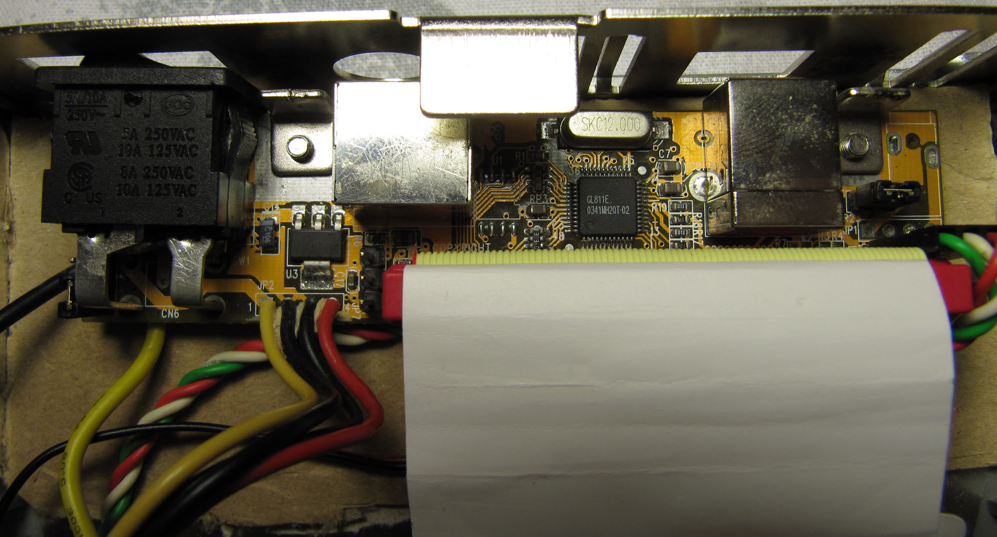

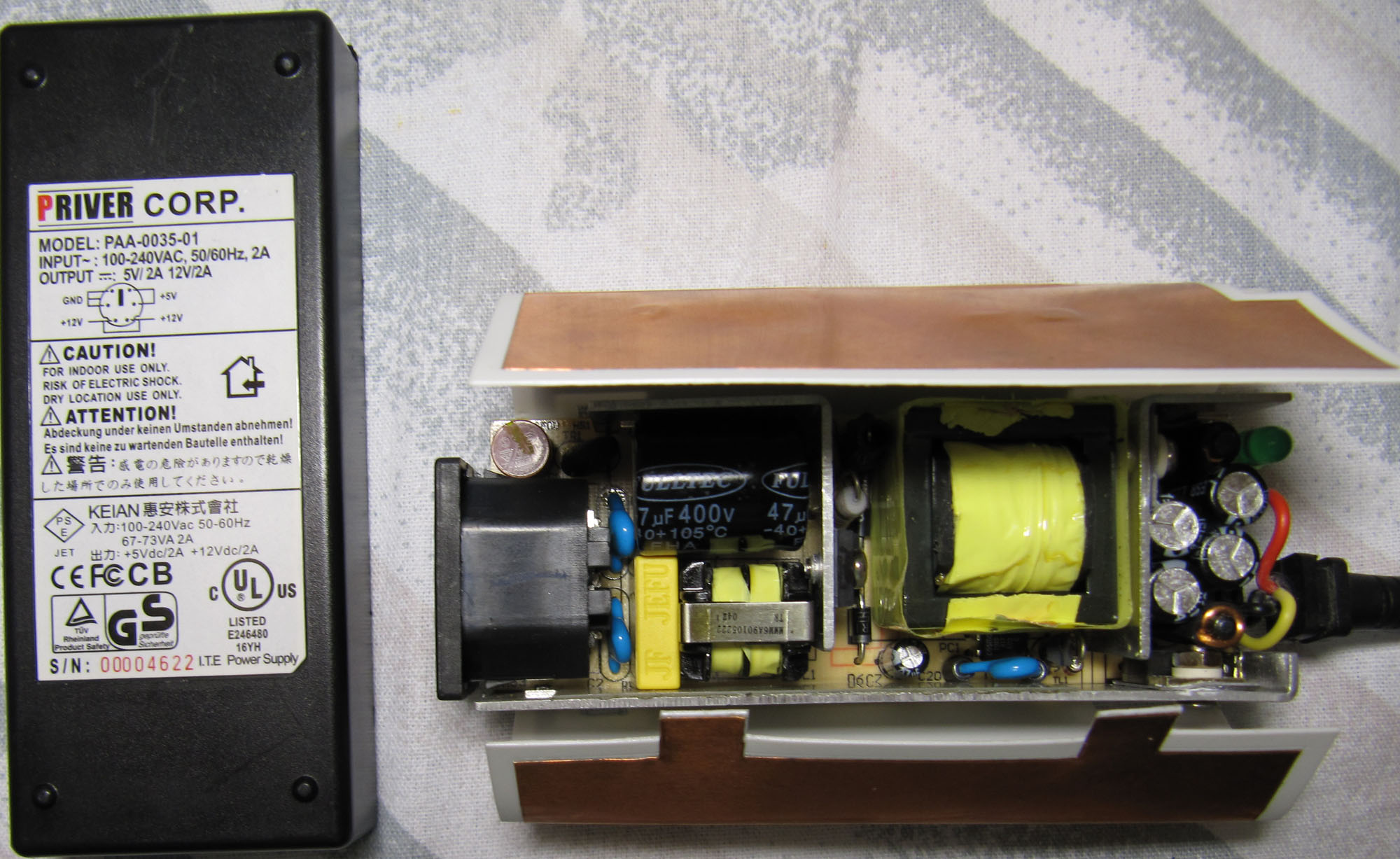

    The hard drive case brand is VIPOWER, it was bought at 2004 and it has gone bad less than 3 years later.
    12V voltage is crazy. It goes from 11.3 to 13.5 and tries constantly to reach 12.14V and stay there, but few times it manages to do that.
    5V seems to be ok.

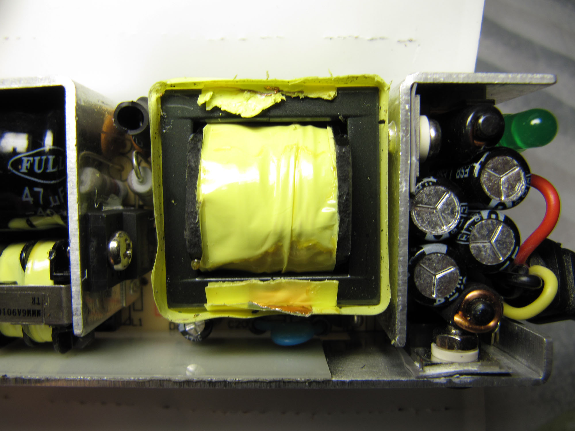

    Opening that psu today with tech guy's help, no bad caps were found in it..
    He said the transformer is bad and nothing can be done with that...
    Photos attached

    recap it and look for bad solder joints.esp replace the small lytic toward the center of the board.if the transformer were bad it would not run.
    • i4004
      • Oct 2006
      • 2029
      Re: External hard drive case with bad supply
      you mean no bulging caps?
      they still may be bad...did you measure their esr?
      if not, then you don't know if they're bad or not.
      that's something those that don't know say...hehe...

                • i4004
                  • Oct 2006
                  • 2029
                  just look at the "nice" soldering on that pcb.
                  but yes, it is kinda weird that supply is ok, and device itself is making problems.
                  troubleshooting can't be too easy as measuring will just show whole circuit pumping voltage when it happens...
                  i would resolder it first, then see if i can detect any component overheating, if resoldering doesn't help.
                  (i don't see how would i tackle if from purely electrical perspective of just measuring voltages etc.)
