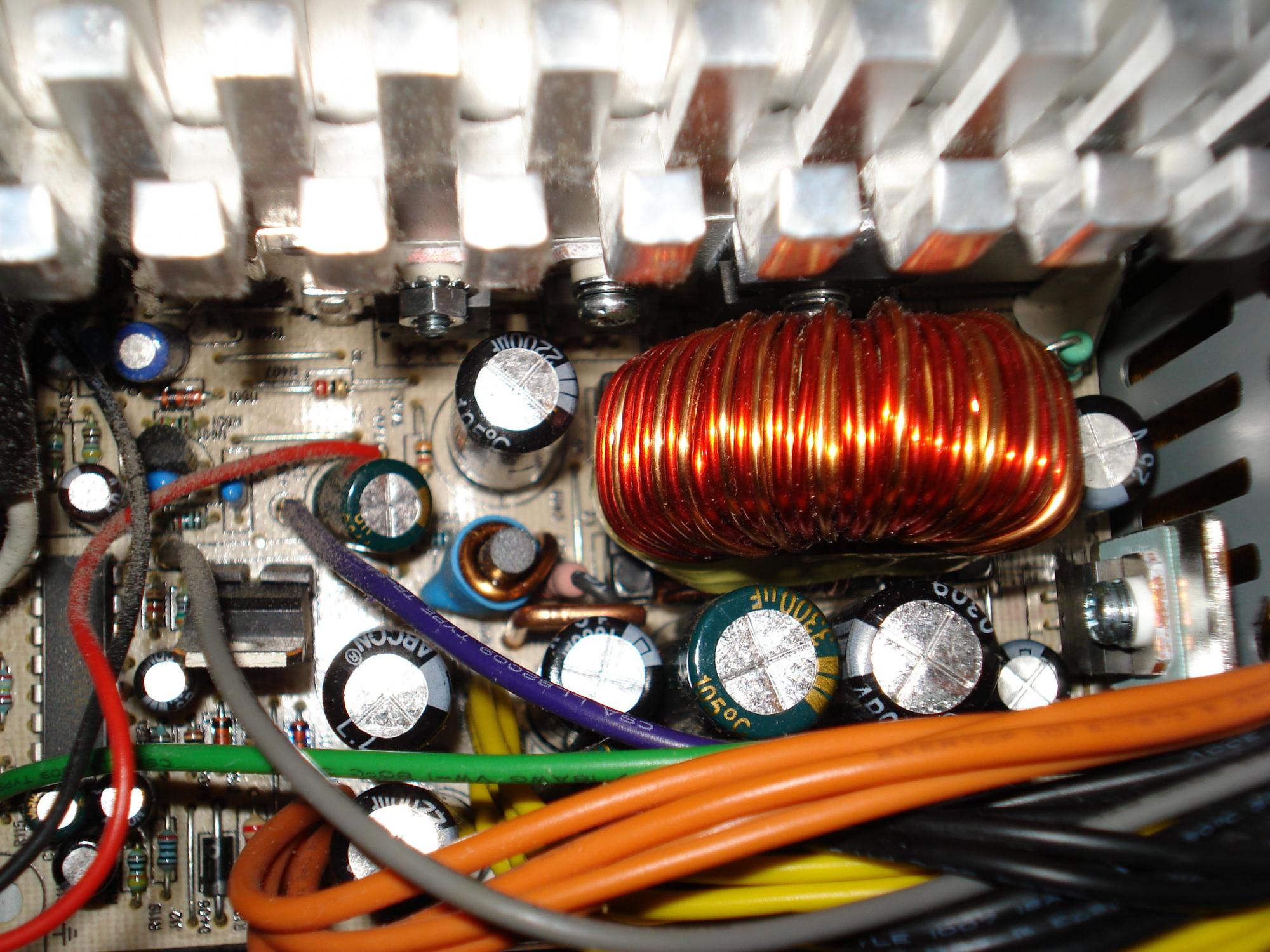

    I have a few Dell GX260 and GX270 PSU's that are dead and I am wanting to replace the capacitors. Both models Hipro hp-2507fwp or fp2507f3cp have the same value capacitors. I have read on other posts that all the large ARCON caps should be replaced. I made a diagram / picture in hopes that someone could tell me if I am on the right track or if I am swapping to many or to little caps. the hp-p2507fwp psu has a bulging 3300, 4700, and 1000uf 16v and the HP-p2507f3cp only has a visible 1000uf 10v c302 bulging
    here is the total list
    470uf 25v ARCON QTY-1
    4700uf 10v ARCON QTY-1
    3300uf 10v ARCON QTY-1
    3300uf 16v ARCON QTY-2
    1000uf 16v ARCON QTY-1
    2200uf 10v ARCON QTY-3
    1000uf 10v ARCON QTY-1 C302
    100uf 50v ARCON QTY-1 C202

    Yeah looks like you're on the right track. Looks like there's another one you might want to replace too: it's by the 3 2200uF@10v caps, right next to the blue coil and the purple wire. It's littler, but it looks like it's part of the +5vsb filter, and is important. Also, when looking for replacements, if you know the voltage rail that each cap is on, you can probably find caps that will work better. Like there's no need for a 10v cap on the 3.3v rail when a 6.3v cap will work fine. The 25v cap is probably on the -12v rail, so you can use a 16v cap there.
    Other people here have more experience with the little caps, and can offer more guidance than me.

      I had a similar unit (Only, it was 200w). It had teapo caps in it. None were bulged/leaking and the PSU seemed fine, but I replaced them pre-emptivley with Panny FC and a couple of FJ I salvaged from a motherboard.

        Thanks that cap by the purple wire is a 470uf 16v i will include it also I had to pull it to read it.

          Success on the first PSU I swapped all but the 50v caps with salvaged caps and got the 50v at a local store for a buck and it looks good so far. i went with 6.3v on some of the 10s and 16v on one of the 25v

            Well the second one was a bit of a challenge. After testing the fuse and swapping all the caps it would not power up then I started re-swapping all the caps but I noticed it would power up when I bent the bd slightly so I shut the lights out and looked for a spark. I found that the fuse holder had bent open slightly causing a bad connection. I bent it back and all is well with this one. Guess its on to the next one.
                  This can destroy the PSU.
                  You can switch 6.3v and 10v back and forth because they are on either 5v or 3.3v circuits but you cannot apply that rule to higher voltage caps because they are most likely on higher voltage circuits.

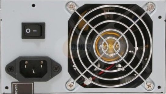

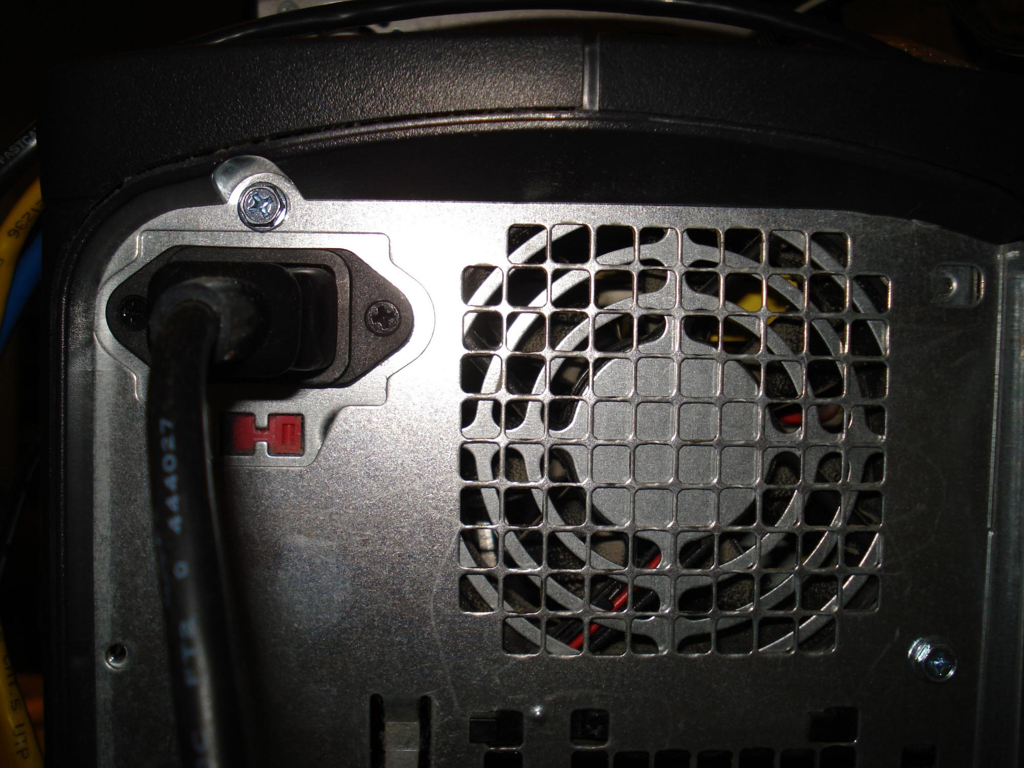

                    Nope, not really (at least not w/o the cage-cutting I was specifically looking to avoid). The HP-P2507FWP, at least in its Dell OEM configuration for the Optiplex series ("Dell DLP2507FWP2"), has no on/off rocker switch and locates its power-cord receptacle in the upper left (as viewed from the rear), directly underneath which is a small, red international voltage slider-- all of which corresponds precisely with cutouts in the Optiplex back panel (see 1st image I hope to have properly attached hereto).
                    In contradistinction, the Antec Earthwatts series PSUs-- like most standard and replacement ATX PSUs-- includes a rocker-switch in the upper left and therefore positions the power-cord receptacle in the lower left, while-- unimportantly here-- lacking any external voltage slider (see 2nd image I likewise hope to have properly managed to attach).
                    There are any number of Dell/Optiplex-specific replacement PSUs out there addressing these particular configuration issues, but as a class seem to fall pretty much into one of two categories: "cheap & sketchy" or "solid but dear". An example, perhaps, of this latter would be the PCP&C entry available at this site, inter alia.

                    Yep, yep, & yep. For the record, here's a photo (3rd & final image-- again, fingers crossed) of the HP-P2507FWP/Dell DLP2507FWP2 at issue here (multiple other views/focal lengths available, should anyone really wish to stare at still more bad Arcons...):

                      Your images ain't workin'.
                      Most good PSU's you'll find today [Earthwatts included] are APFC and won't have a voltage slider.
                      The 650w Earthwatt on the desk here has the switch on the bottom left and the AC is just slightly above it and below the middle.
                      The FSP FX700-GLN has both switch and AC side-by-side at left center.

                        Pics work now
                        I say make the case standard so you can use what you want.
                        The only hassle I see is the upper right screw but you could skip that one.
                        Three is enough.

                              Meaning use a jig saw and make the hole standard.
                                Only higher voltage there is 12 V for which 16V caps are just fine. There could be higher voltage on some small caps in operating circuits but I've never really encountered such thing in PC PSU's (how there could be more on the sensing lines when there's maximum 12 V on output, you know). Higher voltages are used just because 1-10 uF caps for like a 16 V or less usually don't exist at all. At least that's what I've discovered through time and I'd dare to take it as a rule unless I'll find unit which disproves it
                                  The only place it is safe to assume that is the output filters.
                                  Anywhere else you need to check the voltage because there are WAY too many PSU designs to assume they are all the same elsewhere.
                                  All it would take is some designer placing a cap in an odd place on the PCB to ruin your whole day.
                                  It's just common sense to check if lowering the cap's voltage.

                                    Of course it's good to check, but as I said, I checked it every time in the past and never encountered PSU where was higher voltage even on the high-voltage caps. For that reason I don't check anymore on secondary and on primary side are usually 1 uF or 2,2 uF/50 V which I replace by 100 V Chemi-Cons sicne they don't have lower voltage caps in that store So no need to check I guess
                                    Also if he actually replaced the 470uf 25v ARCON, it's just fine as it's most likely +5 V standby acording to the picture. I replace these caps by 6,3 V/3300 uF
