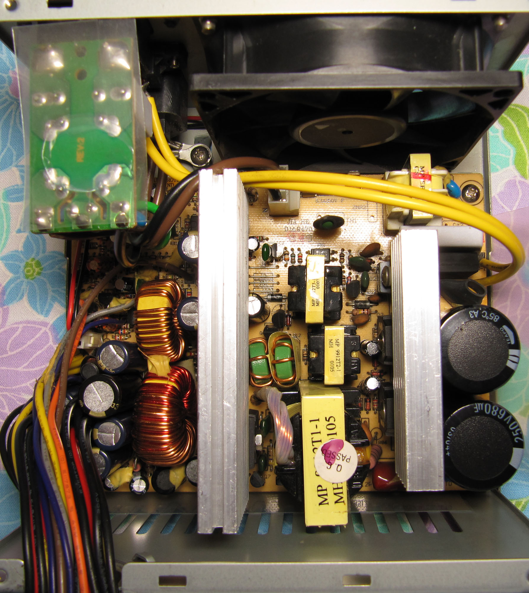

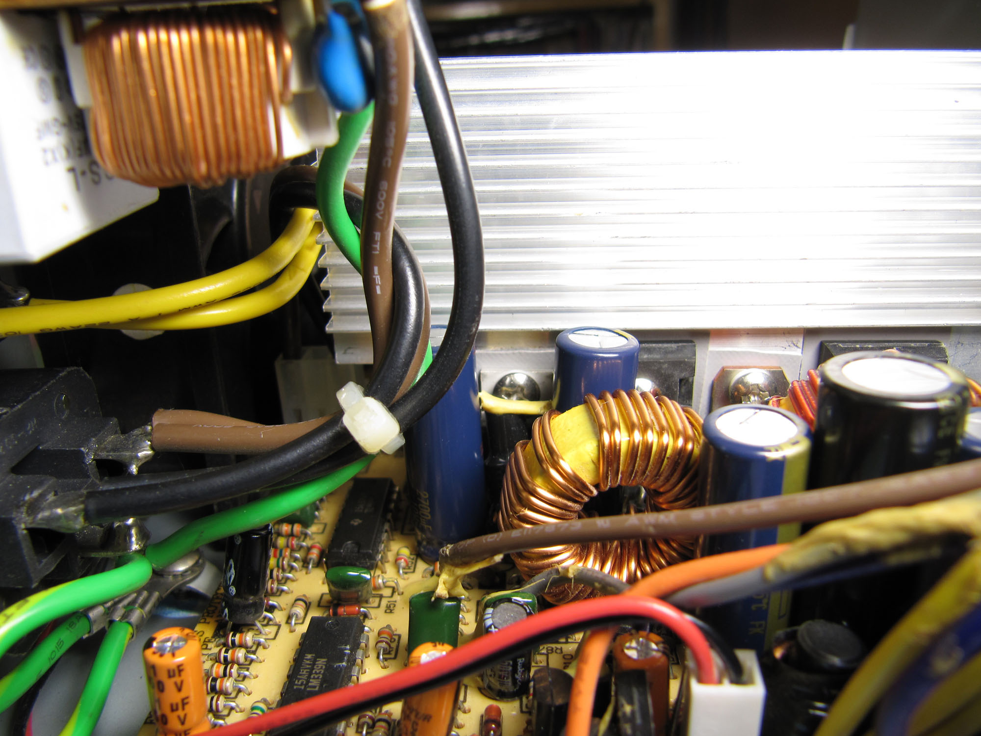

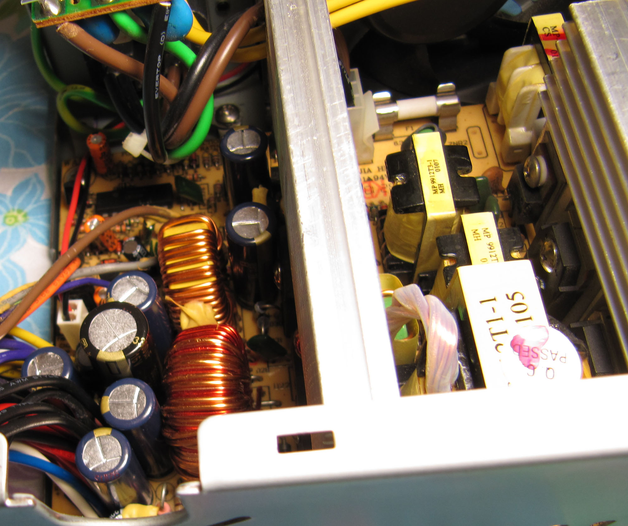

                  I recapped macron power 300watt!
                  list of original and replacement caps:
                  2x680uF 200V saturn logo--> 2x680uF 250V TEAPO
                  +12V
                  1x3300uF 16V saturn logo--> 1x3300uF 16V panasonic fm series
                  +5Vsb
                  2x2200uF 10V saturn logo--> 2x2700uF 10V panasonic fk series
                  +5V
                  +3.3V
                  1x470uF 25V saturn logo--> 1x 470uF 25V panasonic fm series
                  4x10uF 50V saturn logo--> 4x10uF 50V rubycon YXF
                  not replaced caps:
                  1x1uF 50V saturn logo
                  3x1uF 50V jpce-tur
                  possibly -12V and -5V:
                  2x220uF 16V jcpe-tur
                  the psu is running ok! I tested it on pentium 4 1.5GHZ that previously did not boot at all with this psu and now it boots ok. soon I'll post voltages.
                  2 points that I need some help:
                  1) The psu makes a high-pitched sound. I noticed that the sound is less when system is in full load, and gets more noticeable when idle.
                  2)Is it necessary to put some glue at the caps? I have no idea of the type of glue needed and when to find it.. Can I omit this part?

                    Actually, it has a full input filter. 2 Y caps, 2 X caps and a coil.

                        Ohh ya, forgot about mov's. They are what allow the psu to survive input surges.
                        Glue-not needed. They are used from the factory just to hold the caps and other parts in until they are soldered in. No need for it.
                        Whining-Probably coil while, maybe a coil on the secondary side is vibrating at a audible frequency. This happens from time to time, it should be fine. I don't know if you can pour hot glue or something on the offending coil to secure the coil to stop it from whining.
                                I think the noise was came from 5VSB transformer, I have one unit like this.
                                When I've changed 5VSB cap (before Pi filter, circled) to Panasonic FJ, I heard the noise too.
                                After I've changed to Chemicon LXZ (higher ESR, longer life), the noise is gone.
