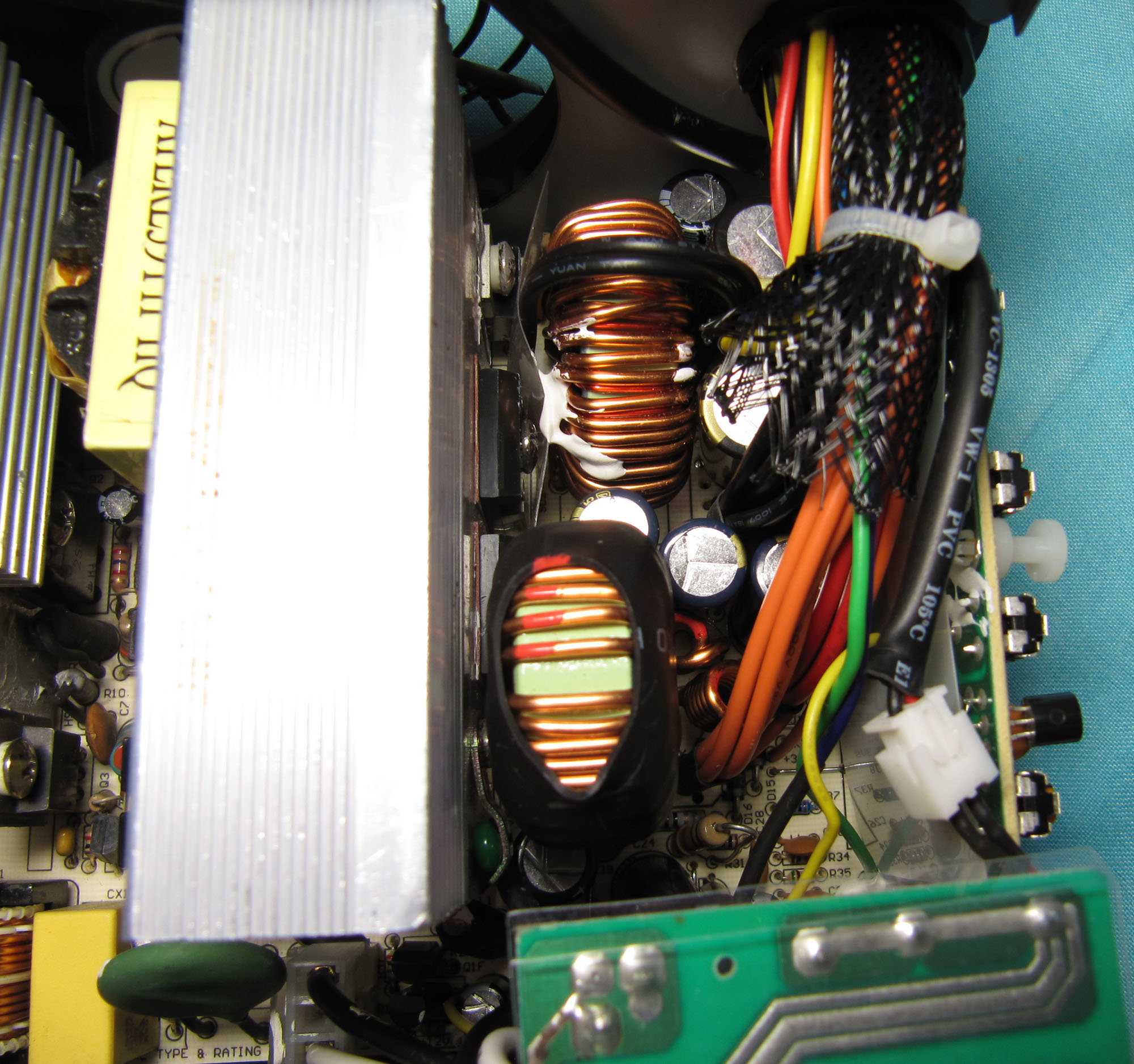

    I replaced the 10A rectifier with ESAD83-004 that I got from an enlight 250W psu. It worked!
    However the rectifiers seem to be a bit too close now.. I don't know if this could be a problem.
    Ready to order replacement caps now
    edit: photo attached
    Help me please....
    I recapped this psu, added Metal Oxide Varistors, a coil at 12V output and a plastic cover among the board and the metal case (it didn't have one).
    I changed capacitance in the following:
    560uF input HEC caps with 680uF Jun Fu.
    5Vsb output: 2x470uF --> 2x1000uF Rubycon YXF
    5V output: 2x2200uF --> 2x2700uF Panasonic FK
    3,3V: 2x2200uF --> 2x2700uF Panasonic FK
    and 12V: 1x1000uF --> 1x3300uF Panasonic FM
    The psu was tested without any load and all voltages were ok, but when I tried it at a pentium 4 1,5GHZ pc, 40 seconds after I pushed the power button and just when windows welcome screen showed it shut off. I pushed it again and again but I could only hear a noise from the psu like starting and stopping immediately.
    Examining the psu with a multimeter and my esr micro 4 meter I found that the 12V output appears completely shorted. Is it the schottky rectifier that has failed? And why?
    I replaced the original BYQ28E ultra fast rectifier with ESAD83-004
    I uploaded some photos I took of the psu right before I tested it and had if fail

      Is that thermal pad that the 12v rectifier uses a metallic material, perhaps conductive?
      I would take the secondary heatsink out and test the rectifiers for shorts.

        Ok, I took out the 3300uF 16V Panny FM, tested it with esr micro and found it ok.
        I did the same with the resistor and it is not shorted either.
        Next, I took out the ESAD83-004 and tested it with my multimeter, diode mode. Results: Completely shorted
        Does this mean that this psu needs ultrafast type rectifier at 12V?
        edit: The thermal pad is not conductive, it came with ESAD83-004 from an old psu.

          Typically if an ultrafast is needed, it will refuse to turn on at all, acting like there is a short. Though that may be the case, who knows.
          May have just randomly failed because of age or previous use. Personally I would add another schottky and see if it shorts again, but I have a ton laying around so I don't know.

            in most of PSU, 12V rectifier need 60V or more of peak Repetitive Reverse Voltage (VRRM), try to replace with S30D60C (30A/60V Schottky) or F30D20C (30A/200V Fast Recovery)

              also better to change both primary switching transistor to 12A part (TO-247/TO-3P), such as 2SC3320 or MJE13009L.
              and 150K resister located between JunFu 680uF had broken.

                The primary transistors are 2x E13009.
                The resistor has just burnt glue on it as far as I can see.
                I found BYW51-200 from a dead power supply (https://www.badcaps.net/forum/showth...64#post108564). Is it suitable for 12V of that psu?

                  20A, 200V fast recovery should be enough for mundane tasks.

                    Sorry,if they're E13009, they should be fine.
                    if you can get bigger package like TP-247/TO-3P (E13009L), they've more Collector Power Dissipation (run cooler/more reliable).

                      The shorted 30A schottky was successfully replaced with the 20A fast recovery rectifier BYW51-200.
                      Now the power supply works and powers the Pentium 4 PC without any problem.
                      Thank you 370forlife and POM_MJ
