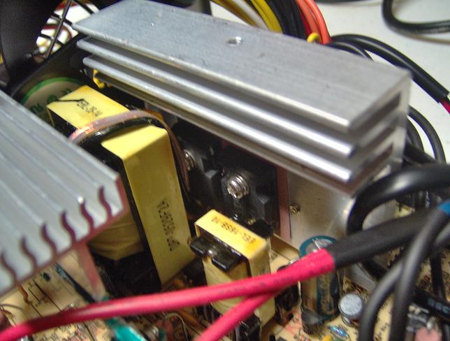

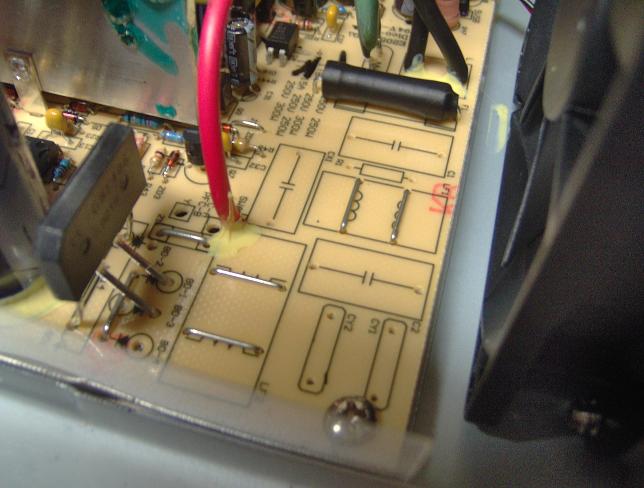

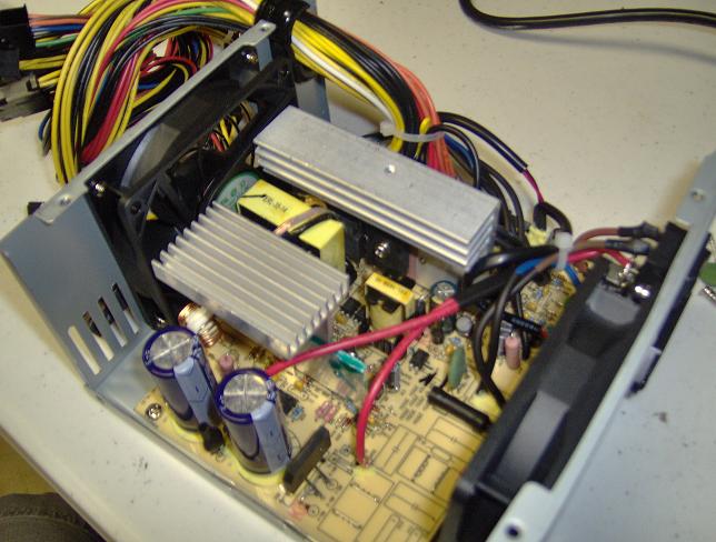

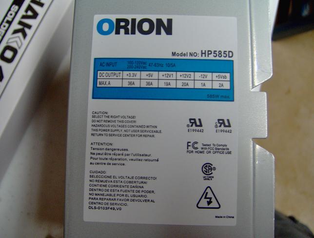

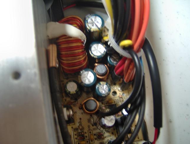

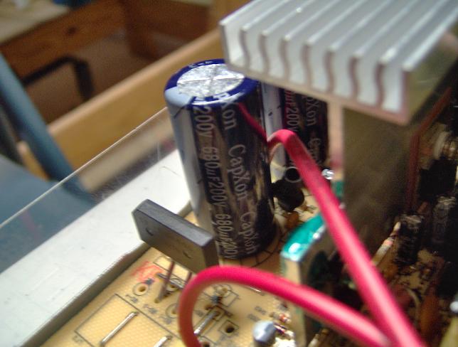

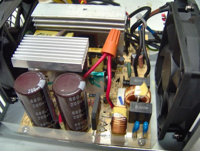

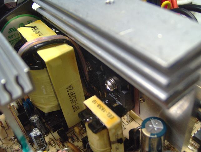

HEC Orion HP585D
  • 370forlife
    Large Marge
    • Aug 2008
    • 3112
    HEC Orion HP585D
    A freebee. Usually $30 on newegg, lets crack her open and see what she's made of...
    Oh dear. Not that good. Those are the tiniest input caps I have ever seen! They are only 18mm diameter! No way they are 680uf. At least that is a decent actual 35 sized transformer. I can't remember the primary's part number, but it is in single forward rated at 600v, 10A continuous, 36A pulse (mode used here,) with a copper plate to help with heat. Fans are by Young Lin Tech, so not totally skimping here.
    Chart shows no combined power, just the max for each rail. Hmm....
    Hello, anybody home? And what the hell is that, is that supposed to be a bridge rectifier. I've only seen ones like these used in audio amps. No provision for heatsinking, and is rated at 4A, 600V. 480W is not near 585W, and this is rated at 75% efficiency.
    Teapovision. All the secondaries consist of teapos, except for the small ones for the -12v and -5v, which are su'scon. Super group regulation. All three rails on one coil. Ugh.
    Secondary heatsink components. One on the right is a 30A, 45V part on the 3.3v (rated at 36A). Middle is a 40A, 45V part for the 5v rail (rated at 36A). On the other side of that, not visible due to the transformer, is a lone 20A, 40V part for the 12v ("2" rails, even though all 12v come from same holes, with one at 19A, one at 20A, no combined rating).
  • 370forlife
    Large Marge
    • Aug 2008
    • 3112
    Re: HEC Orion HP585D
    There, now a full input filter, 6A 600v bridge rectifier, and a full input filter with 2 panasonic .33uf X caps, 1 .1uf teapo X cap, 2 2200pf Y caps, and 2 coils. Also, those new Nichicon 680uf, 200v caps. Yay.
    New secondary silicon. 3.3v now utilizes a 60A, 45V part. 5v uses a 70A, 30V part, and the 12v now has a 60A, 45V part. Much yays were made.
    I elected not to recap it for 2 reasons. 1. teapos aren't that bad in psu's, and 2. They are all 10mm and 8.5mm sizes, which I don't have any 8.5mm caps near their ratings, and no 16v 10mm caps.
    • Toasty
      • Jul 2007
      • 4171
      Re: HEC Orion HP585D
      A 12 minute makeover!!!!!!!!!!!!
      HOLY CRAP!!!
      veritas odium parit
      • ratdude747
        Black Sheep
        • Nov 2008
        • 17136
        Re: HEC Orion HP585D
        that is one POS PSU!
        free, but shitty as hell. glad you could fix it.
        sigpic
        (Insert witty quote here)
        • 370forlife
          Large Marge
          • Aug 2008
          • 3112
          Re: HEC Orion HP585D
          Really not that bad of a unit. No 2 transistor 5vsb, medium grade caps from the start, wouldn't be so bad if it wasn't for two things. One being advertised as Intel 2.01, while the PCB is dated for 08/07/2008 and marked as Intel 1.2, and the other is the super group regulation, as well as the transient filter.
          Single forward primary switcher is a more efficient design, but not really viable for higher wattage units, although the primary switcher in this one is capable of about 450W. Secondary heatsink is thicker than most delta units I have used.
          • kc8adu
            • Nov 2003
            • 8832
            • U.S.A!
            Re: HEC Orion HP585D
            it will still go BANG! if loaded to the label ratings.probably ok for most home pc use though.
            the mfr counts on the fact that very few pc's will need that 585w!
            • 370forlife
              Large Marge
              • Aug 2008
              • 3112
              Re: HEC Orion HP585D
              Originally posted by kc8adu
              it will still go BANG! if loaded to the label ratings.probably ok for most home pc use though.
              the mfr counts on the fact that very few pc's will need that 585w!
              Some tests of the HP585D have shown that the OCP trip point is just above 430W.
              Not surprising, this is the same unit used in those thermaltake XP550 430W psu's without the transient filter, which can do 430W in spec.
              • kc8adu
                • Nov 2003
                • 8832
                • U.S.A!
                Re: HEC Orion HP585D
                the fcc logo and ul are forged.
                no way it will pass either spec.well maybe now that you added a bunch of parts.
                did you use x and y rated caps ?
                • 370forlife
                  Large Marge
                  • Aug 2008
                  • 3112
                  Re: HEC Orion HP585D
                  That is compucase's ul number. Fake UL logo is correct, same with the FCC logo.
                  Yup, the X caps are X2, Y caps are safety series X1 Y1.
                  • Newbie2
                    • Sep 2005
                    • 885
                    Re: HEC Orion HP585D
                    Doesn't look like a bad power supply now that you've added better components to it.
                    Well done 370forlife!
                    My gaming PC:
                    AMD Phenom II X6 1100T Black Edition 3.3GHz Six-Core CPU (Socket AM3)
                    ASUS M4A77TD AMD 770 AM3 Motherboard
                    PowerColor AMD Radeon RX 480 8GB GDDR5 PCI-Express x16 3.0 Graphics Card
                    G.SKILL Value Series 16GB DDR3-1333 RAM (4x4GB dual channel)
                    TOSHIBA DT01ACA200 2TB 3.5" SATA HDD (x2)
                    WD Caviar Green WD20EARX 2TB 3.5" SATA HDD
                    ASUS Xonar DG 5.1 Channel PCI sound card
                    Antec HCG-750M 750W ATX12V v2.32 80 PLUS BRONZE Power Supply
                    Antec Three Hundred Mid-Tower Case
                    Microsoft Windows 10 Pro 64-bit
                    Microsoft Windows 7 Ultimate SP1 64-bit
                      master hoarder
                      • May 2008
                      • 12164
                      • Bulgaria
                      Re: HEC Orion HP585D
                      Originally posted by 370forlife
                      Some tests of the HP585D have shown that the OCP trip point is just above 430W.
                      Not surprising, this is the same unit used in those thermaltake XP550 430W psu's without the transient filter, which can do 430W in spec.
                      This is indeed the same power supply as the Thermaltake XP550-NP 430W, minus the input filtering. According to xbit-labs and hardwaresecrets, the limiting point for these power supplies is about 350 watts. Anything after that will overheat the primary switcher (from xbit-labs tests that is). There is OCP on these units, though, which puts them somewhat above regular gutless units.
                      Here's the two reviews if anyone is interested
                      http://www.hardwaresecrets.com/article/332
                      http://www.xbitlabs.com/articles/coo...oundup_18.html
                      As far as regulation, 3.3v rail is derived from the same transformer pins as the 5v rail. The reason you see only one coil is that the 3.3v rail is regulated with a voltage regulator rather than a saturation coil.
                      Now I have a curiousity about this power supply, though - how many ICs are there on the PCB, 2 or 3 (ID numbers would also help)? I'm wondering because I have the Thermaltake XP550-NP 430W version of this power supply, and I want to know how the 5vsb rails generated and regulated - wheather it's a 2-transistor desing or something else. Mine's still under warranty, so I don't want to open it just yet.
                      By the way, 370forlife, you did some great work on this power supply!
                      Should be pretty reliable now. I know that mine has stable voltage regulation (12v is a little high at 12.36v, but all other rails are nearly perfect).
                      • 370forlife
                        Large Marge
                        • Aug 2008
                        • 3112
                        Re: HEC Orion HP585D
                        Well, not counting the three little 4 pin IC's near the 5vsb transformer, there is 1 8pin welltrend wt751002 930 j48a1g
                        The three little 4 pin IC's near the transformers, if they are even IC's, are all cosmo 1010 817 J18 C's.
                        I was thinking of getting some polymers for the secondary caps, as the highest uf 10mm 16v electrolytic cap I could find are all 1500. I was thinking of getting some nichicon 16v, 10mm, 820uf caps, but I don't think the ultra low esr of them would help any.
                        • Toasty
                          • Jul 2007
                          • 4171
                          Re: HEC Orion HP585D
                          (4 pin) They're the opto's.
                          The Weltrend is a supervisor chip. (The iMac supplies use the 7512)
                          Toast
                          veritas odium parit
                            master hoarder
                            • May 2008
                            • 12164
                            • Bulgaria
                            Re: HEC Orion HP585D
                            Thanks for the info.
                            I noticed there is one more IC behind the input caps. Probably a UC3842/UC3843 or some other similar variant. Unless this IC is something else, then it's very likely that this power supply uses a 2-transistor 5vsb design (The Welltrend wt751002 is similar to the TPS5310, and nither of those offer 5vsb monitoring/protection). The 3 4-pin ICs in the transformer area are optocouplers, like Toasty said. If there was 5vsb protection, there should have been one more optocoupler and maybe another IC somewhere (like the Bestec ATX-250 12Z).
                            With that said, it's probably a good idea to keep an eye out on this power supply (and definitely change the 50v, 10/22/47uF 5vsb cap if you find it).
                            Last edited by momaka; 10-17-2009, 12:32 PM.
                            • 370forlife
                              Large Marge
                              • Aug 2008
                              • 3112
                              Re: HEC Orion HP585D
                              Opps, missed that IC behind the caps. 8pin ST UC3843B.
                              Don't know which cap is the 5vsb cap. There are many 50v 10uf and 4.7uf, and one teapo 6.3v, 2200uf cap next to the 5vsb transformer.
                              • Toasty
                                • Jul 2007
                                • 4171
                                Re: HEC Orion HP585D
                                That Teapo is a common failure. Every one I've seen in that position across various PSU makes and models is bulged. Some less than 2 years old.
                                Re: Polys in output - You'd need to double them up to get the oomph! provided by the higher capacitance of the regular lytics. Yes, ripple would be super low, but as soon as something drew current for an instant, the voltage(s) would sag to far. It's not something you may readily see with a meter, but on a scope you'd see the blip.
                                Think of it as trying to start the car with lawn tractor battery vs. a truck battery. Both may do the job, but the lights won't dim as much with the truck battery.
                                Toast
                                veritas odium parit
                                • qw3r7yju4n
                                  • Dec 2011
                                  • 2
                                  Re: HEC Orion HP585D
                                  so any how to's? - would love to spend little money and upgrade my PSU - I have a little DC/AC knowledge. Witha quick walkthrough I would be a PRO
                                  • qw3r7yju4n
                                    • Dec 2011
                                    • 2
                                    Re: HEC Orion HP585D
                                    and how are you allowed to sell a fake logo? was this dated before there were laws?
                                    • everell
                                      • Jan 2009
                                      • 1514
                                      Re: HEC Orion HP585D
                                      I have recently acquired a Thermaltake TR2-430W. PC board looks just like yours - except it already had the line filtering parts. GBU806 bridge diode. I think Bestec is better built.
                                      Old proverb say.........If you shoot at nothing, you will hit nothing (George Henry 10-14-11)
                                      • eagleeyez
                                        • Sep 2011
                                        • 29
                                        Re: HEC Orion HP585D
                                        Please anyone has the schematic diagram? I need to know the value of C31 and retrace what may be the cause of it's explosion so I can replace all of them.
                                        I want to know also if this PSU is worth my time repairing it? since I did found it trashed by someone and I've seen that it's 600W which I consider a good PSU but I am not expert in this, just trying to save some hardwar from trash yard and putting a second life to it.
                                        Thank you
                                        Last edited by eagleeyez; 09-18-2015, 08:49 PM.
                                          ACER Predator Orion 5000-610 Predator Orion 5000 i5-8400 Specification for Upgrade or Repair
                                          This specification for the ACER Predator Orion 5000-610 can be useful for upgrading or repairing a desktop PC that is not working. As a community we are working through our specifications to add valuable data like the Predator Orion 5000-610 boardview and Predator Orion 5000-610 schematic. Our users have donated over 1 million documents which are being added to the site. This page will be updated soon with additional information. Alternatively you can request additional help from our users directly on the relevant badcaps forum. Please note that we offer no warranties that any specification, datasheet,...
                                          09-12-2024, 03:28 PM
                                          ACER Predator Orion 3000 PO3-620 Predator Orion 3000 i7-10700 Specification for Upgrade or Repair
                                          This specification for the ACER Predator Orion 3000 PO3-620 can be useful for upgrading or repairing a desktop PC that is not working. As a community we are working through our specifications to add valuable data like the Predator Orion 3000 PO3-620 boardview and Predator Orion 3000 PO3-620 schematic. Our users have donated over 1 million documents which are being added to the site. This page will be updated soon with additional information. Alternatively you can request additional help from our users directly on the relevant badcaps forum. Please note that we offer no warranties that any specification,...
                                          09-12-2024, 03:28 PM
                                          ACER Predator Orion 3000 PO3-600 Predator Orion 3000 i5-8400 Specification for Upgrade or Repair
                                          This specification for the ACER Predator Orion 3000 PO3-600 can be useful for upgrading or repairing a desktop PC that is not working. As a community we are working through our specifications to add valuable data like the Predator Orion 3000 PO3-600 boardview and Predator Orion 3000 PO3-600 schematic. Our users have donated over 1 million documents which are being added to the site. This page will be updated soon with additional information. Alternatively you can request additional help from our users directly on the relevant badcaps forum. Please note that we offer no warranties that any specification,...
                                          09-12-2024, 03:28 PM
                                          ACER Predator Orion 5000-610 Predator Orion 5000 i7-8700K Specification for Upgrade or Repair
                                          This specification for the ACER Predator Orion 5000-610 can be useful for upgrading or repairing a desktop PC that is not working. As a community we are working through our specifications to add valuable data like the Predator Orion 5000-610 boardview and Predator Orion 5000-610 schematic. Our users have donated over 1 million documents which are being added to the site. This page will be updated soon with additional information. Alternatively you can request additional help from our users directly on the relevant badcaps forum. Please note that we offer no warranties that any specification, datasheet,...
                                          09-12-2024, 03:28 PM
                                          ACER Predator Orion 5000 PO5-610 Predator Orion 5000 i7-9700K Specification for Upgrade or Repair
                                          This specification for the ACER Predator Orion 5000 PO5-610 can be useful for upgrading or repairing a desktop PC that is not working. As a community we are working through our specifications to add valuable data like the Predator Orion 5000 PO5-610 boardview and Predator Orion 5000 PO5-610 schematic. Our users have donated over 1 million documents which are being added to the site. This page will be updated soon with additional information. Alternatively you can request additional help from our users directly on the relevant badcaps forum. Please note that we offer no warranties that any specification,...
                                          09-12-2024, 03:28 PM
