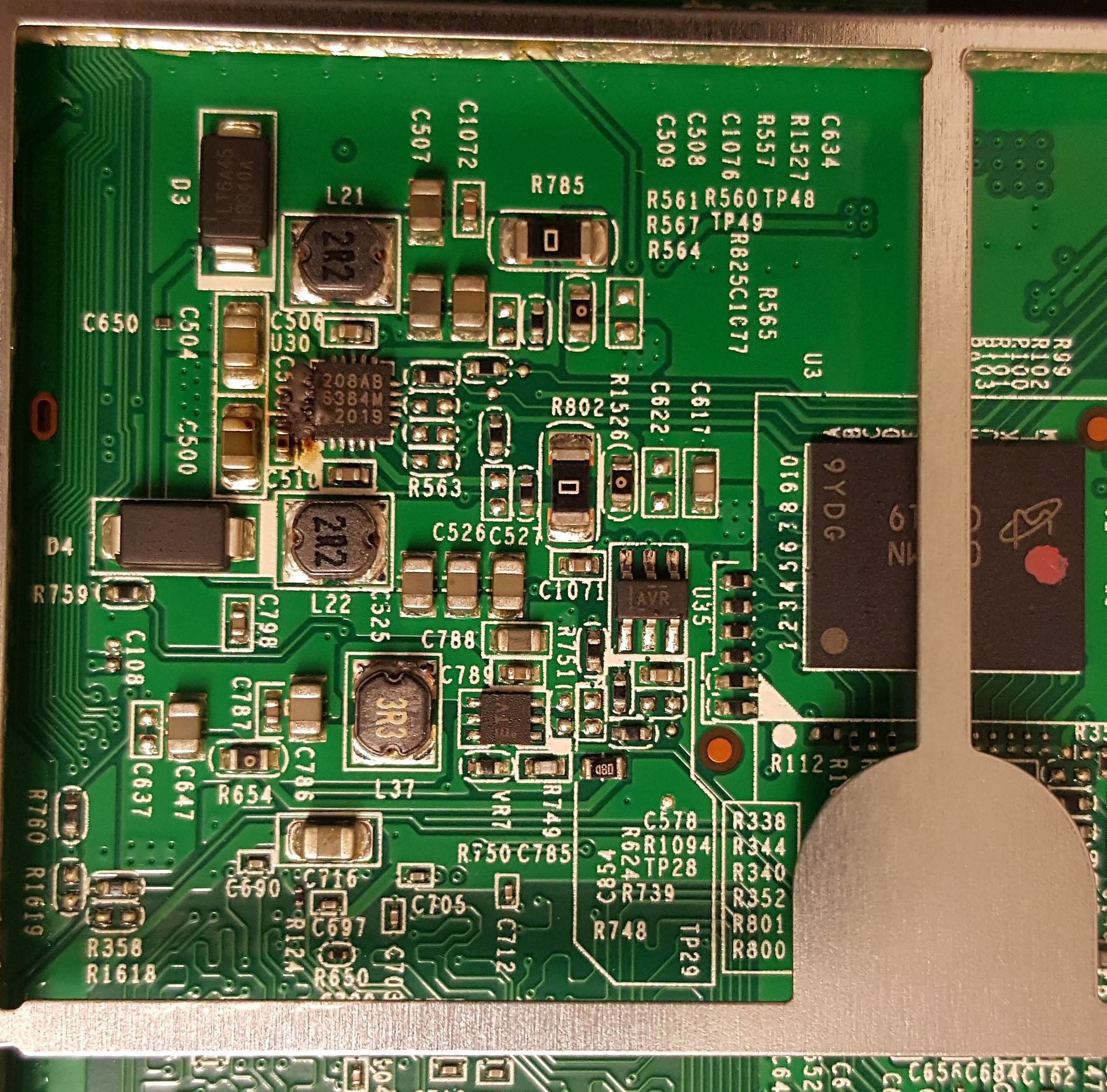

    Need help identifying regulator IC
    This is part of a Netgear R7800 wifi router.
    One of the voltage regulator ICs seems to have blown.
    The markings are:
    208AB
    6384M
    .2019
    It's a 3x3 QFN-20 package, and it seems to have dual regulators, given that there are two coils attached in a symmetric fashion. It seems to power a Micron 1.8V flash memory chip (at least).
    I haven't been able to identify the manufacturer and real part number.
    Can anyone help? Thanks!

    Re: Need help identifying regulator IC
    Here`s a similar post to yours,tring to ID the same IC https://www.badcaps.net/forum/showthread.php?t=73118
    found one seller,sadly theres no description https://www.yoycart.com/Product/592025570784/
      Thank you very much for the response.
      This is looking like it's more trouble than it's worth, given that I'd have to program the chip before installing it, which would mean figuring out how it should be programmed in the first place.
