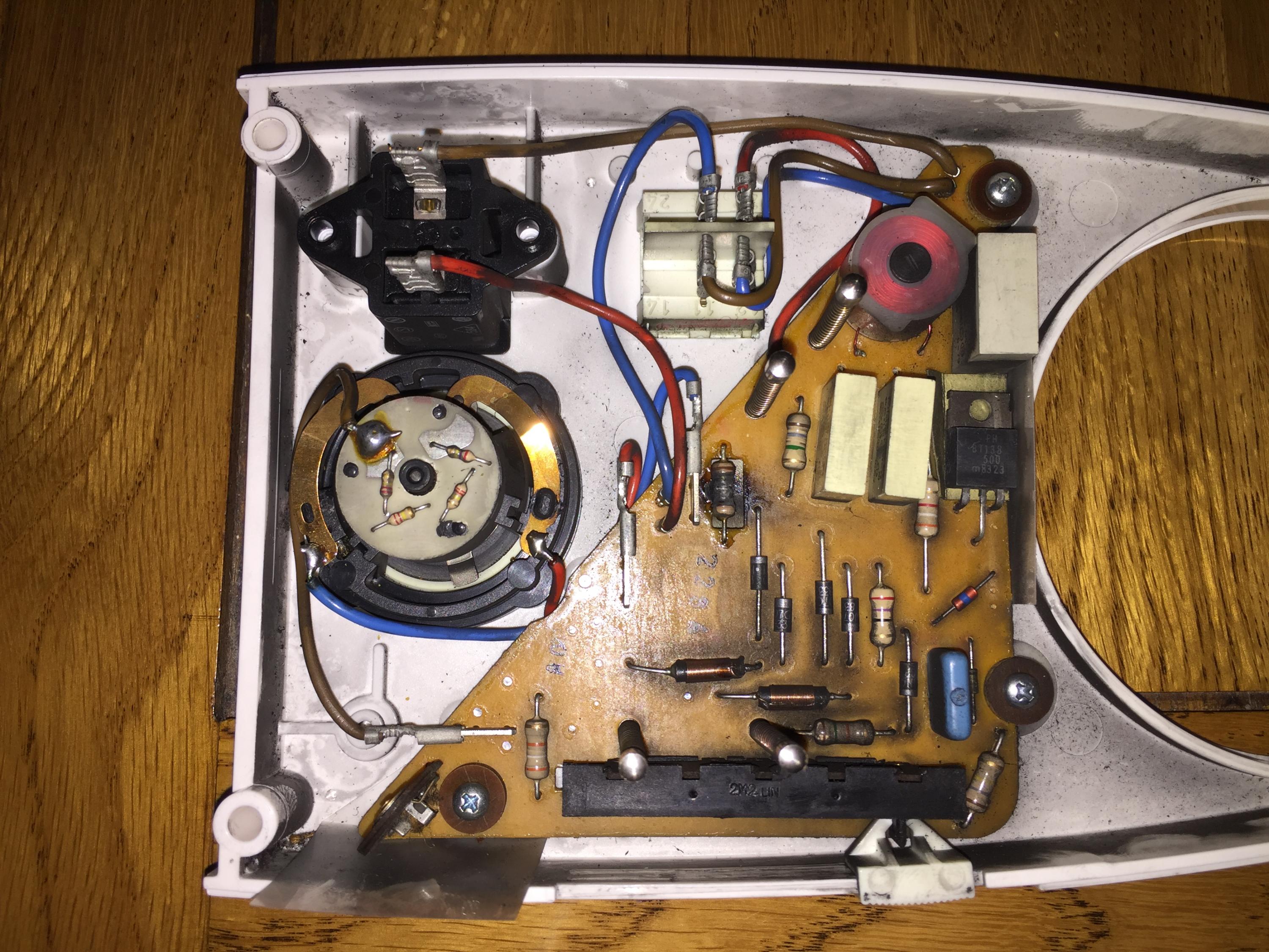

    Hi
    I'm trying to repair my mothers 30+ years old sewing machine which she's got quite used to over the years.
    At the moment I've only done some basic tests as i think there could be numerous faults.
    Model is a Elna Stella electronic air.

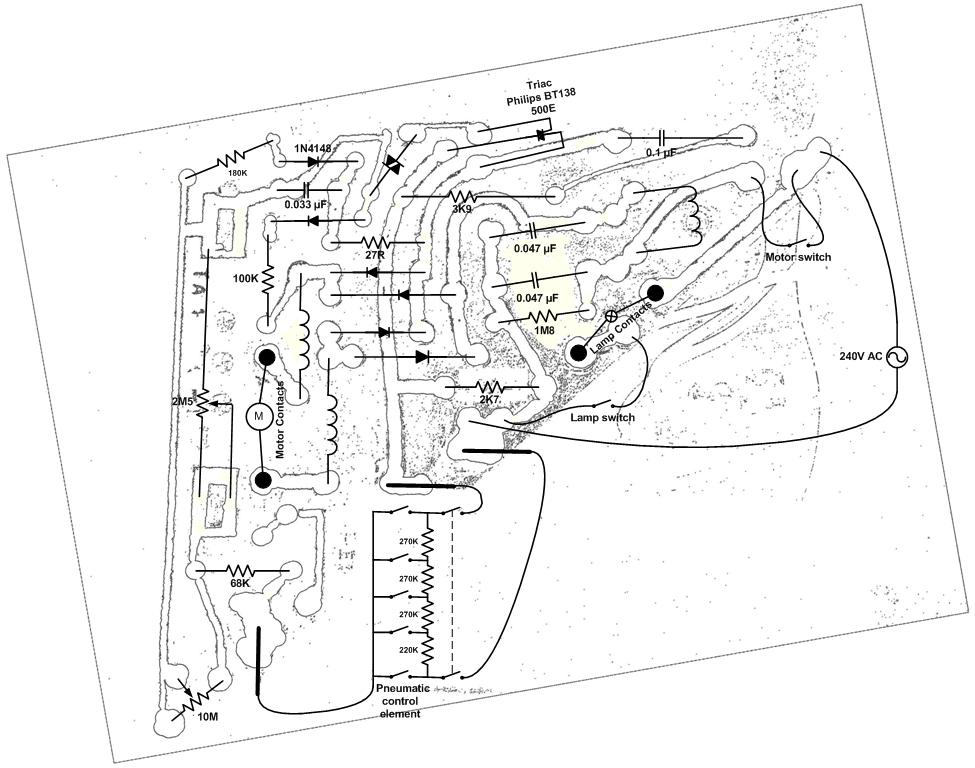

    The machine is controlled via an air foot peddle which as can be seen in the image is connected to an air switch, sorry don't know the correct term for this device. One of the contacts on this is a bit loose which i will try to fix back down somehow although I'm not sure how I'll achieve this at the moment. But when i tested this i do get varying resistance from the device when operating the foot peddle.
    I have about 150 ohms resistance across the motor so assume this is OK for now.
    I have tested all the resistors and all but one seem ok, apart from the 3k9 which can be seen in the schematic, this was obtained from the following website.
    http://www.diceyhome.free-online.co....lla_refurb.htm

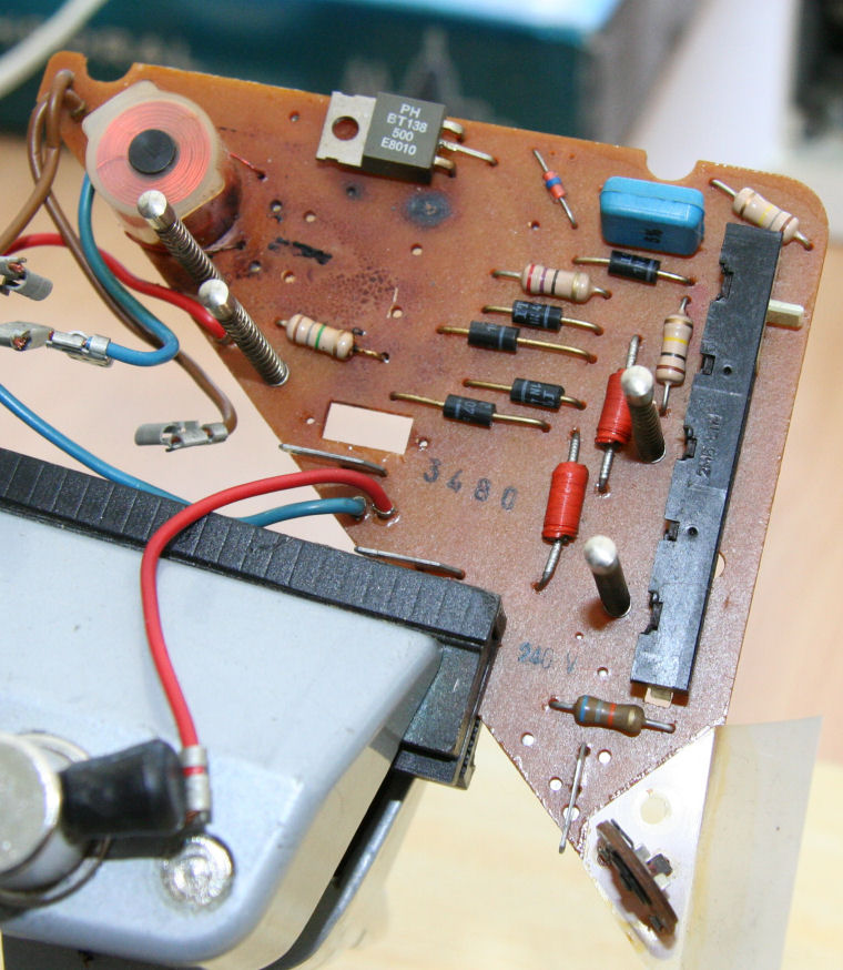

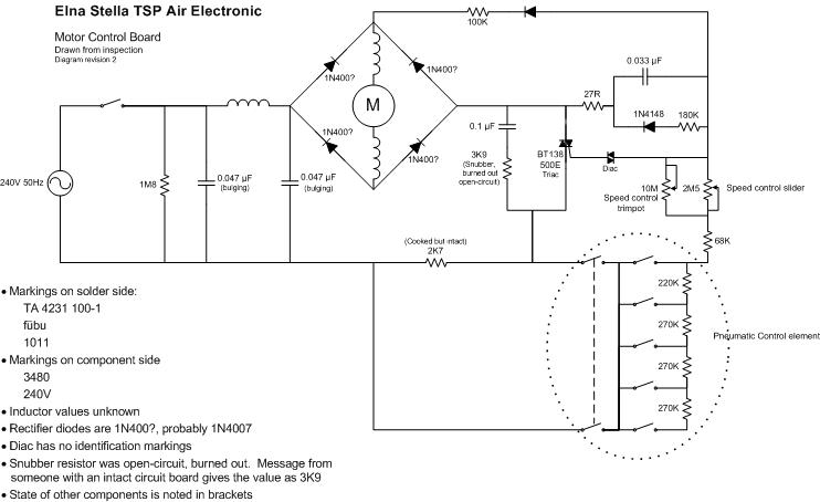

    That other site's Elna Stella TSP Air Electronic schematic has many errors. If I had a pic of the backside I can draw a correct schematic. The 3k9 snubber resistor is OK in your pic, not burned.
    I would first find out why the other resistor burnt up. Some Stella have a pcb air-flow cutout for more cooling for that resistor. I think it's for current-sense feature for constant-torque to keep up speed level with changing load.
    It has a brown stripe so value starts with "1", and "2" in that other website's pics. We'd have to figure out where in the circuit it is.
    It looks like a progressive (air pressure) switch that engages more contacts with pressure against the spring. It could be (decimal) 4-levels, or 32-levels (binary). Just pull off the brown terminal and measure ohms across the terminals (brown) should have about 220k steps, starting with 270k perhaps.

      that burned resistor probably indicates the 0.1uf capacitor is short circuit.

        wouldn't harm to test the diodes

          OP if you can look for numbers or a pic of the two small diodes next to the blue cap at the board edge. I think it's a zener diode, not 1N4007. Just need pic of the traces around the blue cap and can finish the schematic.
          You can use a light-bulb in place of the motor for testing. The other two pins go to a switch or something.
          I found a pic with the original resistor, wow these boards are rare.

              Re: Power supply & air switch on sewing machine
              It's an action photo with his cutters and soldering iron blocking traces
              I couldn't make it out. The right side of the blue cap, no pics on that diode.

                  That helps alot. He mixed up the triac MT1, MT2 and not sure how there are 7 switches in the air control. Two are redundant for safety perhaps. It's a sophisticated speed controller.
                  The burnt resistor is in series with the motor and triac, and does torque limiting.
                  If the machine jams and you are heavy on the throttle, it would burn up.
                  I would say it is a 1k part (use 3W) because I saw that at http://blog.bambersew.com/sewing-mac...machine-repair and you have a brown stripe intact. It is 2k7 in the other website but it must be a different model Elna.
                  Any other shorted parts (triac, cap, diodes, etc) would just leave the motor stuck running all the time I believe. I'd change the four film caps due to age. The one diode next to the blue cap is a zener I think.

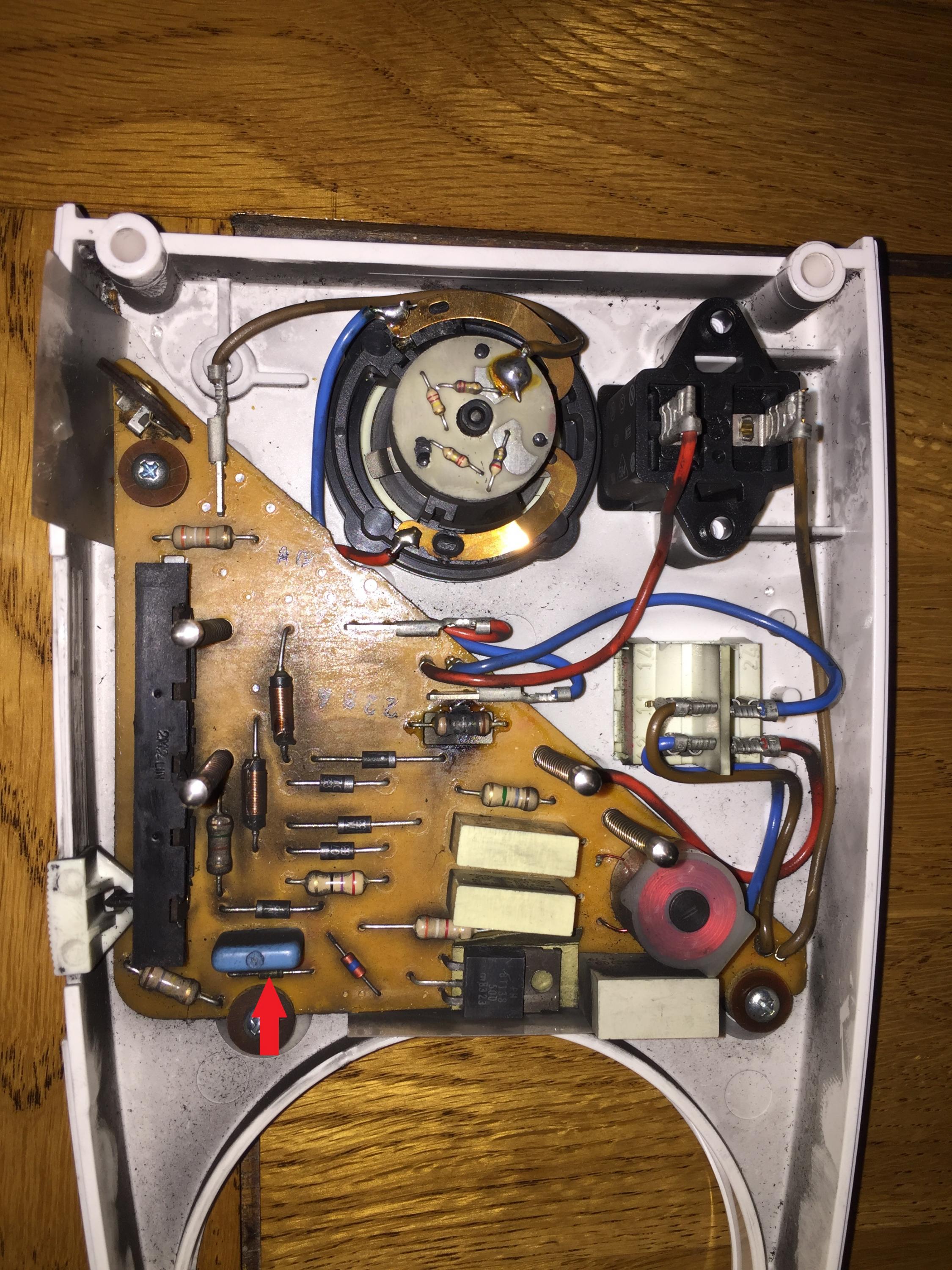

                        Let me know if the outside diode next to the blue cap is a zener, I think it is.

                              Is the diode that i have highlighted in the image the one your asking about, if so its a 1N4148.
                              • redwire
                                • Dec 2010
                                • 3912
                                Thanks for the pic, hmmm hard to tell it's covered in belt dust. Needs a wipe with q-tip and IPA. 1N4148 is usually reddish/pink body and a zener is orange.

                                  I've cleaned the board now, the image was taken before, 1n4148 is whats printed on it, its a yellow colour. I can take a new photo if you like.
                                  • redwire
                                    • Dec 2010
                                    • 3912
                                    ok, 1N4148 it is. I thought I saw an orange one (zener) on another board which made more sense as the circuit looks at motor back EMF to keep speed constant.

                                      Did you say that the schematic that I linked to is wrong, did you think the triac was in the wrong place, I may try to redraw this during the holidays.
