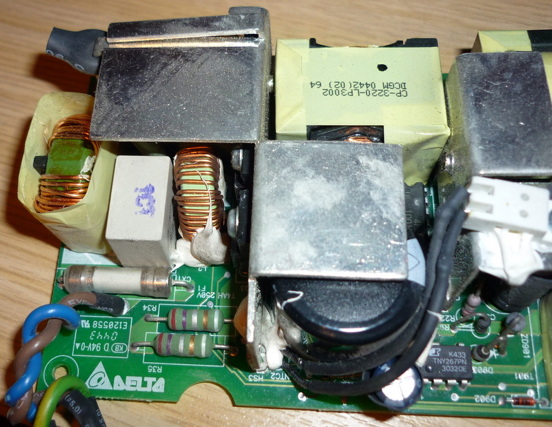

        • seanc
          • Nov 2008
          • 1319
          Re: iMac G5 PSU - no power
          Apologies for the late reply, this wasn't intended to be a post and run.

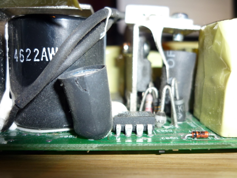

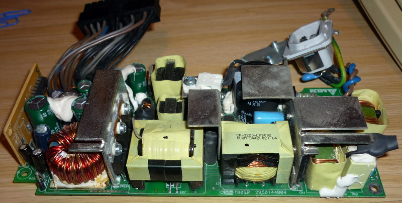

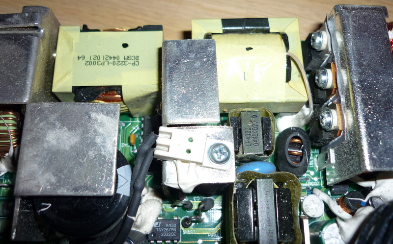

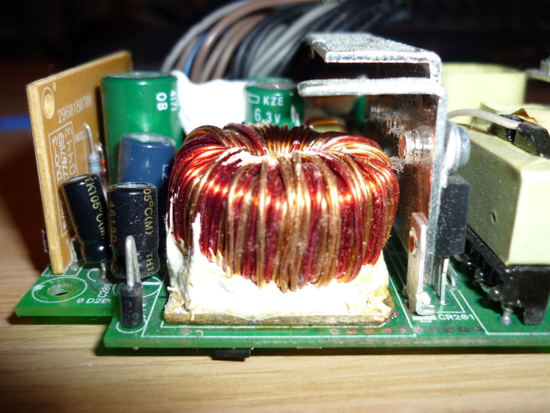

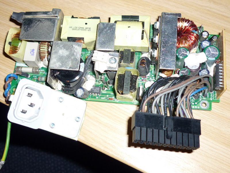

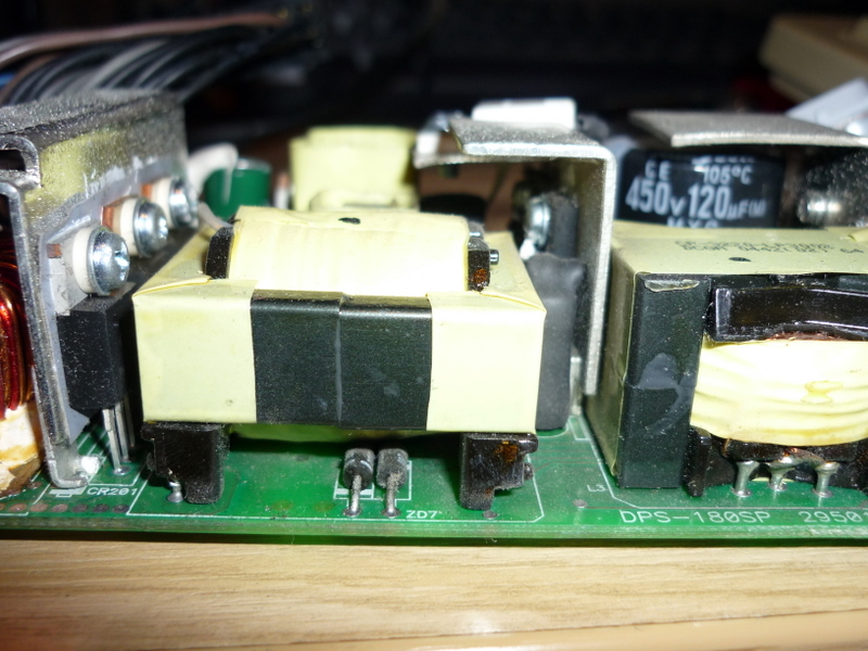

          OK, so pictures are at the bottom.
          I used a 10k ohm resistor to discharge the cap.
          You can see what I believe to be the rectifier bridge, attached to a heatsink, next to a coil in yellow tape in the second to last picture.
          Testing this to the mains provides the results toasty was expecting.
          It all looks nice and tidy in there.
          Do you want pictures of the bottom?

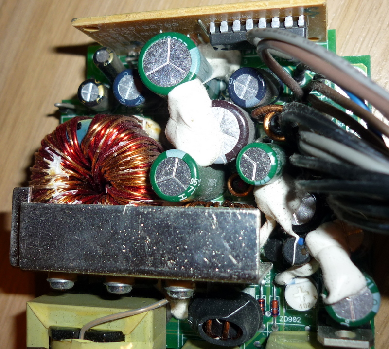

          • Toasty
            • Jul 2007
            • 4171
            Every bloody one of these PSU are different in design. Very frustrating to have to rework/reanalyze the circuit every time.
            ...I see a re-cap in your future...
            Although the KZE's appear good, appearances can be deceiving. Those Taicons are a good bet on being bad.
            Please identify all caps by Value & Voltage, then Brand and Series & Diameter in mm's.
            i.e.- 1000uF - 10V - UCC - KZE - 10mm
            Height is limited to 30mm or so, but nothing except the main filter cap appears to be stuck under a heatsink.
            Use a PLASTIC utensil of some type to remove the white caulk as necessary so you can see the markings. Be careful as there may be other components "buried" in that junk.
            What equipment do you have for testing/repairing and what's your experience level?
            Please locate the "chopper" for me. I think it's out there by the power output leads. It appears to be the one standing by itself unattached to a heatsink. It should be a 5 or 6 legged unit. What are the numbers from the front?
            Underside shot would be great, especially if there are IC's mounted there. Identify them please as it's a good bet those match what I've already seen or have.

            • seanc
              • Nov 2008
              • 1319
              Yeah I was thinking just recap - it's not going to make it any worse.
              I have a multimeter or two for testing, no ESR meter... yet, soldering station.
              Experience level, low, I suspect but I'm here to learn I can quite happily change capacitors, swap out resistors and the like.
              I'll go investigate the capacitors in more detail, might be easier to get them out since I can't see the brand on some of them.
              Thanks.

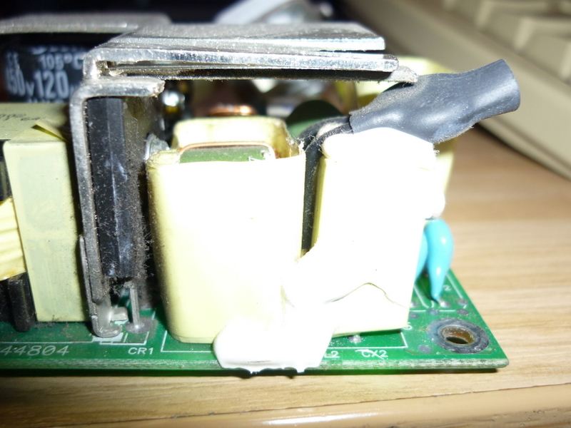

              • seanc
                • Nov 2008
                • 1319
                Hmm, so an update.
                I suspect I've pretty much ruined this. The area underneath the board is too densely packed for my inexperience - I've got joins where there shouldn't be and a couple of capacitor legs I can't get out.
                A little capacitor (I think, little orange rectangle) from the bottom went walkies, I've tried to put it back, it's probably cooked.
                *sigh*

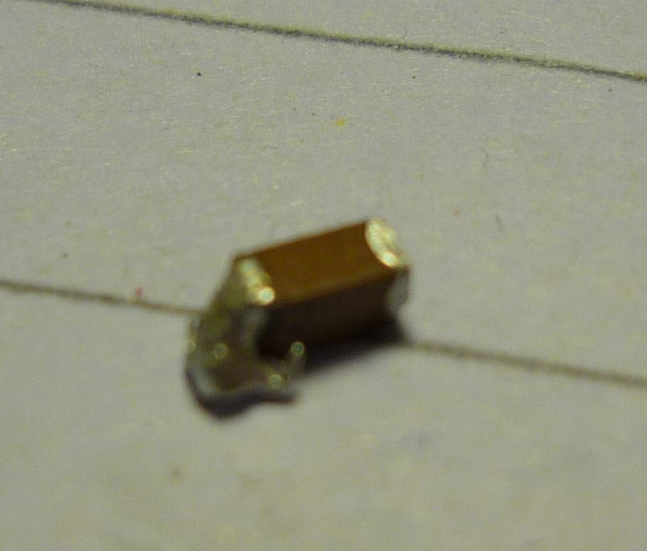

                    OK, so having slept on it and become less annoyed - I might as well soldier on a bit more.
                    Assuming I can get the capacitor leads out and the last capacitor in the center of the board, under the silver heatsink, I shouldn't be too far off, then I need to tidy it up. Some of these bad joins are so close together, they seem to be on the same pad and like they'd be touching anyway.
                    Now the surface mount capacitor that I accidentally took off, how can I work out what value to replace it with? There aren't any markings on it.
                    I've put it back, but it might be cooked.

                      • seanc
                        • Nov 2008
                        • 1319
                        Well I rammed the station up to a higher temperature which helped my cause considerably. If only I'd done that before.
                        No, not the 450v mains cap, a 450uf 3.3v cap, which is now removed along with those capacitor leads.
                        The last piece of the puzzle is this strange brown chip that I knocked off, another seems to have taken a battering from the iron as well; they're positioned too close to the capacitor leads for their own good.
                        There's a picture of it below. The camera seems to like the paper rather than the raised object in the middle... need to RTFM I guess.
                        • Toasty
                          • Jul 2007
                          • 4171
                          Okay. You can just put that back where you found it.
                          The ceramic chip caps are not a likely fail, even from high heat. You'd have to torch them to cause a problem. I thought you were talking about a plastic chip (electrolytic) cap that appears on a few that I've worked on. There are no markings on these that I have ever seen.

                          • seanc
                            • Nov 2008
                            • 1319
                            In the event that it did fail, how would you work out what to replace it with?
                            • Toasty
                              • Jul 2007
                              • 4171
                              Since there are no "public" schematics out there (for 99% of any brand or type PSU's), and if I didn't have another unit I could open to find it, I'd look for a few that matched in size and shape on the same board and pull them and measure them.
                              It's all strictly S.W.A.G.* from there. They are decoupling capacitors from what I've seen. Decoupling caps are usually used to remove noise and to smooth power fluctuations, especially around IC's.
                              Low frequency supplies (linear) use very few. High frequency SMPS like these, use a lot. The interference picked up by each trace, because they act as little antennas, is effectively "shorted out" by the chosen caps. A trace that goes several inches across the board and may go from top side to bottom and back again will be guaranteed to have -at least- 2 decoupling caps; one at each end of the line.

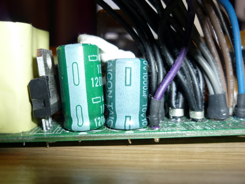

                                The 3.3uf 450v was a small one in the center under the heatsink that KerriJane described and the LAST one I removed - a lead came out of the cap on removal, I'll be pissed if that was the root cause of the issue.
                                Your help is very much appreciated. Even if the end result isn't a success, I hope to have learned some things from you guys

                                  Pics of the bottom where that chip cap came from. Please a full board shot straight on, not angled. Also, one that captures the area several inches around where the cap was, again straight on. Perhaps capture the height of the board at top and bottom of picture?

                                    I can't edit the above, shame, but I need to make an amendment to the first capacitor.
                                    It's 220uf 35v.
                                    I'll list below the predecessor of the capacitor, I'm missing a 1000uf 10v Taicon and whatever the 470uf 16v capacitor was - must have hit the bin before I realised I should keep them for reference.
                                    220uf 35v - Nichion PS H x 12.5mm D x 10mm ripple 600ma - was LTEC LZG 15mm x 7.5ishmm
                                    2200uf 16v - Panasonic NHG H x 20mm D x 12.5mm ripple 920ma - was United Chemicon KZE 25mm x 12.5mm
                                    2200uf 10v - Nichion PS H x 20mm D x 12.5mm ripple 1250ma - was Nichion PW 20mm x 12.5mm
                                    2200uf 6.3v - Nichion PS H x 20mm D x 12.5mm ripple 1250ma - was United Chemicon KZE 22.5mm x 10mm
                                    1000uf 6.3v - Panasonic NHG H x 11.5mm D x 8mm ripple 380ma - was Rubycon ZL 12.5mm x 10mm
                                    100uf 50v - Panasonic NHG H x 11.5mm D x 8mm ripple 110ma - was LTEC LZG 12mm x 7.5mm
                                    3.3uf 450v - Panasonic NHG H x 16mm D x 10mm ripple 41ma - was Taicon AQ? (other markings are 0437 <-date stamp I think, and (M)) 15mm x 7.5mm
                                    1200uf 10v - Panasonic FC H x 15mm D x 12.5mm ripple 1205ma - was a United Chemicon KZE I'm guessing 20mm x 10mm
                                    2 x 1000uf 10v - I already have Panasonic FM H x 20mm D x 8mm ripple 1560ma - one was a United Chemicon KZE 17.5mm x 7.5mm - the other a green Taicon of some description
                                    470uf 16v - I already have Nichion PS H x 12.5 D x 10mm ripple 600ma - predecessor unknown but looks to be blue (from pictures), possibly an LTEC LZG.

                                        All in stock except for 470/16. Use either Panasonic FC or UCC LXY.
                                        I prefer FM/HZ/MCZ in these supplies when I can get my hands on them. LOUSY and restricted air flow through its own grill then the case has a grill too. Would absolutely benefit from a fan directly in it.
                                        1000 / 6.3 - P/ NHG - 8x11 - 380ma - R ZL 10x12.5
                                        EEUFM0J102
                                        http://uk.rs-online.com/web/search/s...duct&R=5260932
                                        2200 / 6.3 - N/ PS - 12.5x20 - 1250ma - UCC KZE 10x22.5
                                        EEUFM0J222L
                                        http://uk.rs-online.com/web/search/s...duct&R=5260982
                                        1000 / 10 - have P/ FM - 8x20 - 1560ma(2)- UCC KZE 7x18 & Taicon ? spec
                                        EEUFM1A222
                                        http://uk.rs-online.com/web/search/s...duct&R=5261165
                                        1200 / 10 - P/ FC - 12.5x15 - 1205ma - UCC KZE I'm guessing 10x20
                                        EEUFM1A122
                                        http://uk.rs-online.com/web/search/s...duct&R=5261121
                                        2200 / 10 - N/ PS - 12.5x20 - 1250ma - N PW 12.5x20
                                        EEUFM1A222
                                        470 / 16 - have N/ PS 10x12.5 - 600ma - LTEC LZG 10x12.5?
                                        EEUFM1C471L **NO STOCK**
                                        http://uk.rs-online.com/web/search/s...duct&R=5261389
                                        Use:
                                        EEUFC1C471L
                                        http://uk.rs-online.com/web/search/s...duct&R=6283807
                                        -OR-
                                        ELXY160ELL471MH20D
                                        http://uk.rs-online.com/web/search/s...duct&R=5478795
                                        2200 / 16 - P/ NHG - 12.5x20 - 920ma - UCC KZE 12.5x25
                                        EEUFM1C222
                                        http://uk.rs-online.com/web/search/s...duct&R=5261301
                                        220 / 35 - N/ PS - 10x12.5 - 600ma - LTEC LZG 7x15
                                        EEUFM1V221
                                        http://uk.rs-online.com/web/search/s...duct&R=5261828
                                        100 / 50 - P/ NHG - 8x11 - 110ma - LTEC LZG 7x12
                                        EEUFM1H101
                                        http://uk.rs-online.com/web/search/s...duct&R=5261597
                                        3.3 / 450 - P/ NHG - 10x16** - 41ma - Taicon AQ? 7.5x15
                                        ECA2WHG3R3
                                        http://uk.rs-online.com/web/search/s...duct&R=3654818
                                        -OR-
                                        Rubycon YK
                                        http://uk.rs-online.com/web/search/s...duct&R=1937262
                                        ** under heatsink height limited
                                        You're going to have a lot of extra caps as they sell them in packs of 5.
