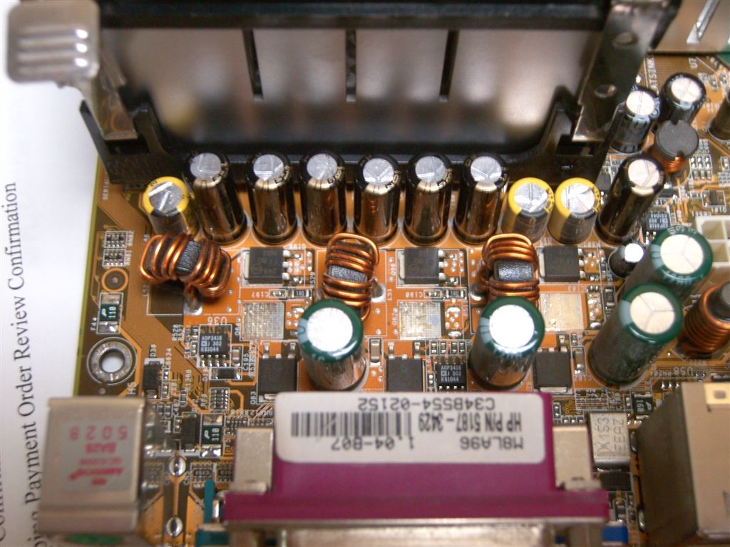

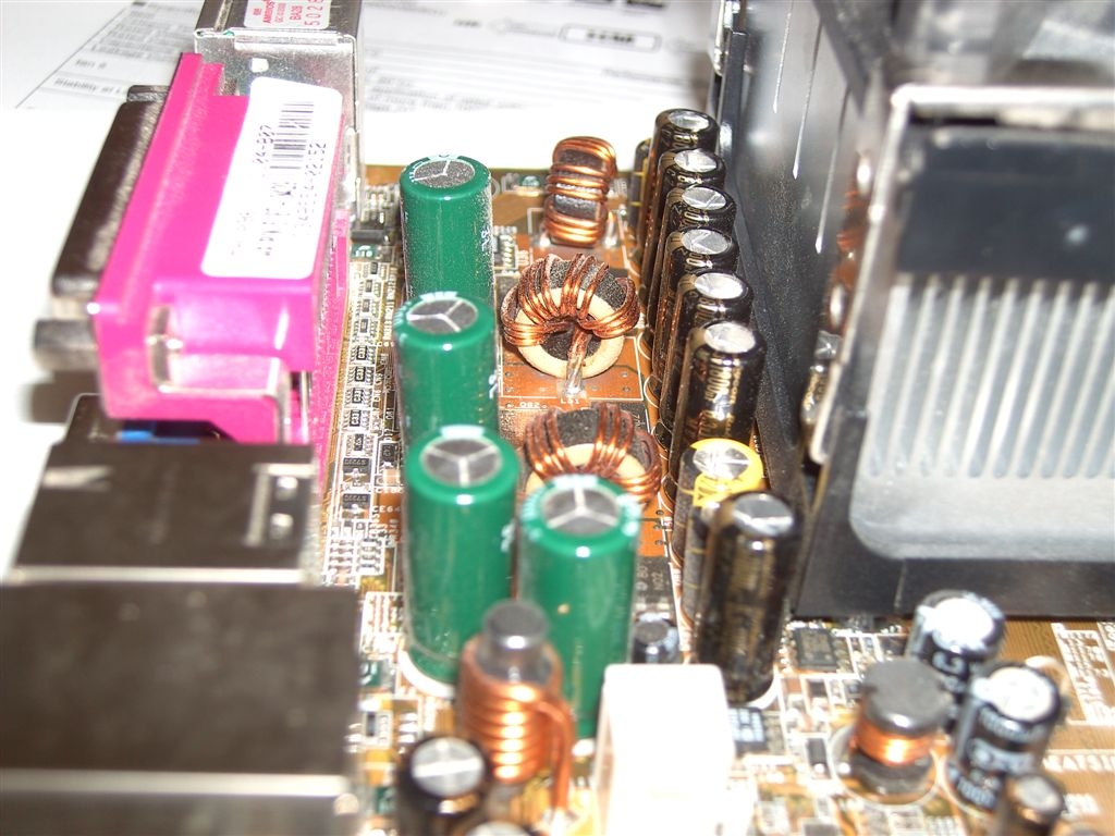

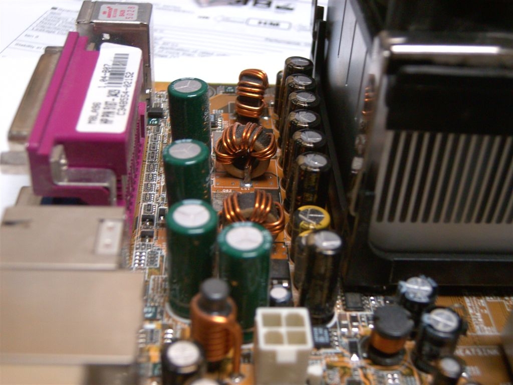

could you give us a dose of pics? that would help a lot.sigpic
(Insert witty quote here)Comment
Re: HP A265C P4SD-LA Power Issues
The original power supply is a hipro model HP-D2537F3R. I haven't opened it since I am using 2 other power supplies to test it. I have attached the pics requested the 4 cpas not replaced are green KZE 16V 1200uF. I have some 16V 1500uF caps (rubycon) that I believe will work there size wize. The MOSFET's look clean no blow outs or anything like that. Other Ideas??Comment
Thanks for the pics. Nothing looks out of place. I think the PSU is a Bestec in Hipro clothing. I'd like to see when you pop it open.

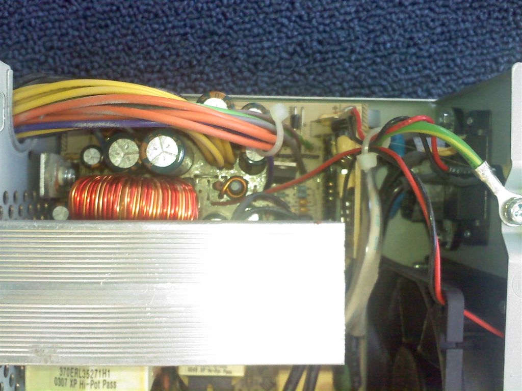

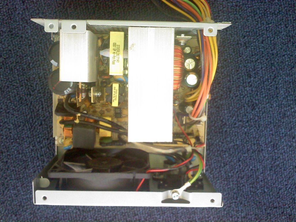

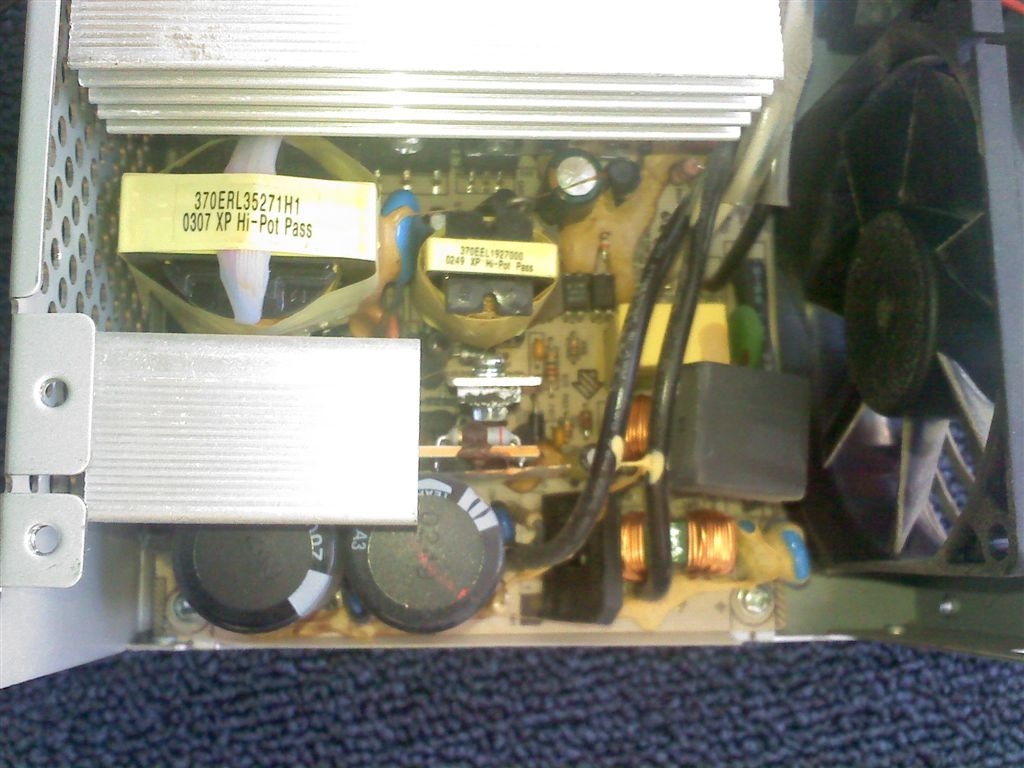

I also am attaching some pics of the inside of the HiPro 300W Power Supply. 2 of the teapos are raised just slightly but none of them have vented.
Other thoughts? Thanks again!Comment
Hipro, ahh yes. Looks decent on the inside (except for that triple group regulation on the secondary). You may want to check the voltage coming from that purple wire. It should be not much more than 5.00v. Too high could cause the southbridge to fry. Try with just the cpu in, and it should at least give a no (or bad,) ram beep code, if it even has a speaker on the motherboard.

PSU actually looks decent. Complete input filters and a bridge.
The PSU not powering up tells me there is something wrong on the board or at least an overload. You said the 500w unit at least spun the CPU fan. That kind of points to an overload.

OK I finally figured this thing out.
After talking with Toasty a few times he said something about a short, so I looked over the board again and found that my solder removal tool had barfed on the pins under the PCI slot.
After removing the extra solder and testing with a known good PSU it finally posted. I then tried it with the original HiPro PSU and nothing happened. After replacing the 2 caps mentioned before that were just slightly raised, but not vented, in the Original PSU the computer posted again.
I have now reassembled the entire PC and it is running updates right now.
Huge thanks to Toasty & a new lesson learned. A PSU tester is not the final test of a good PSU.
