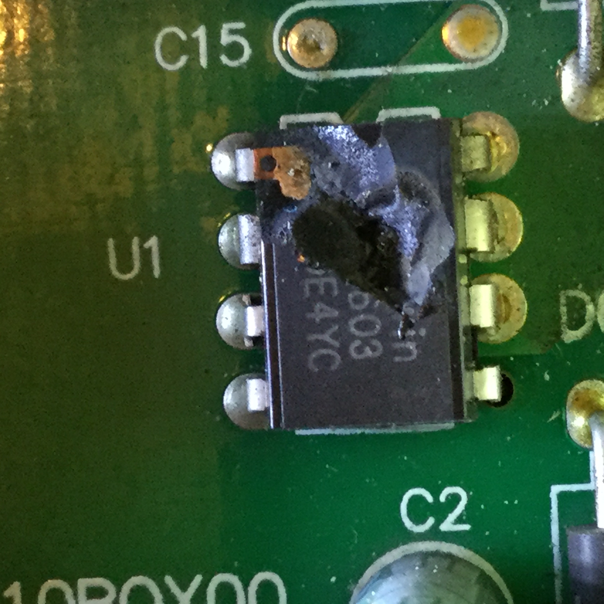

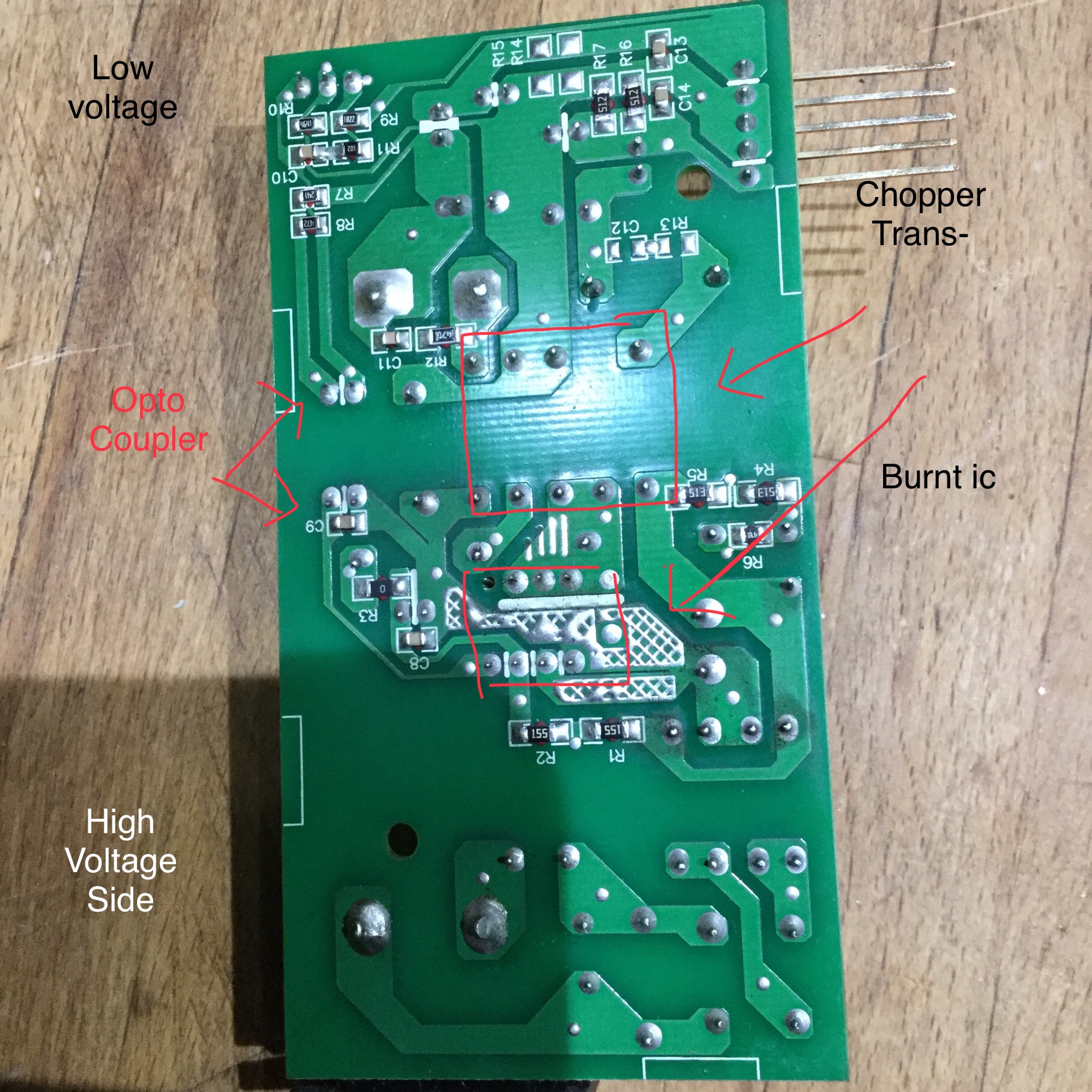

    Hi All
    Can anyone help assist on id of this component (or manufacturer)from a TV UHF Amplifier

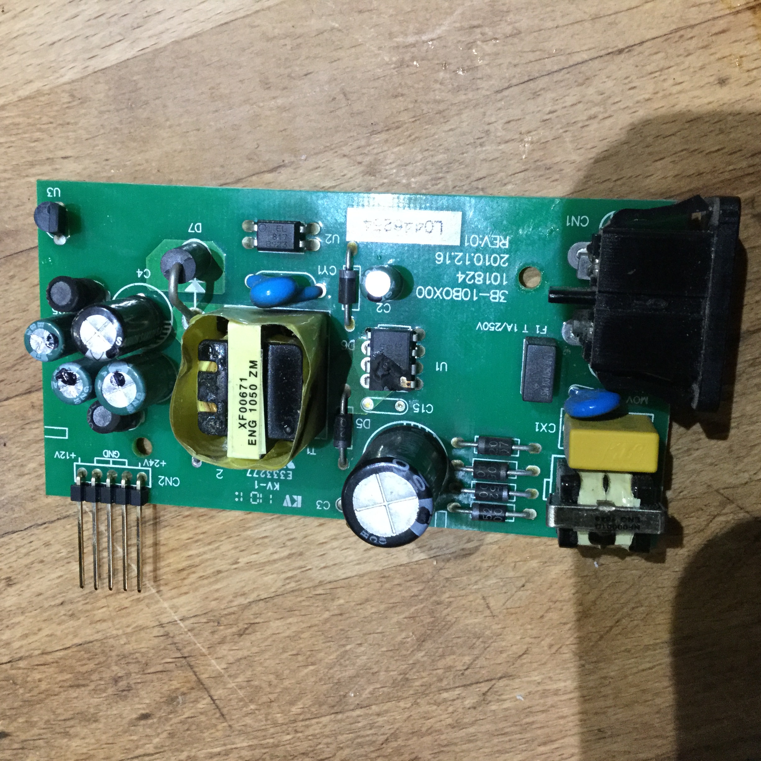

    It is SMPS IC. What is the make and model of the device?

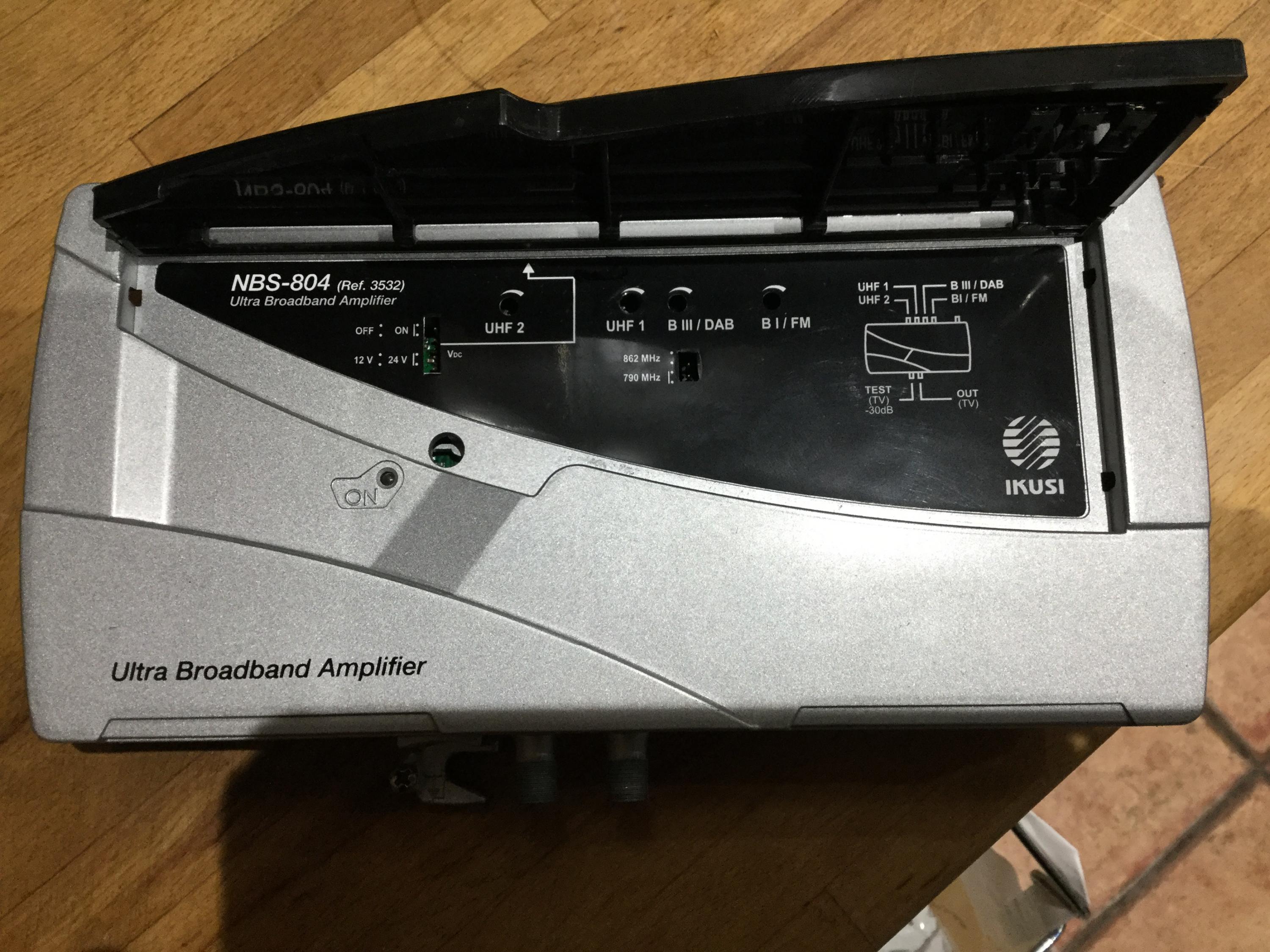

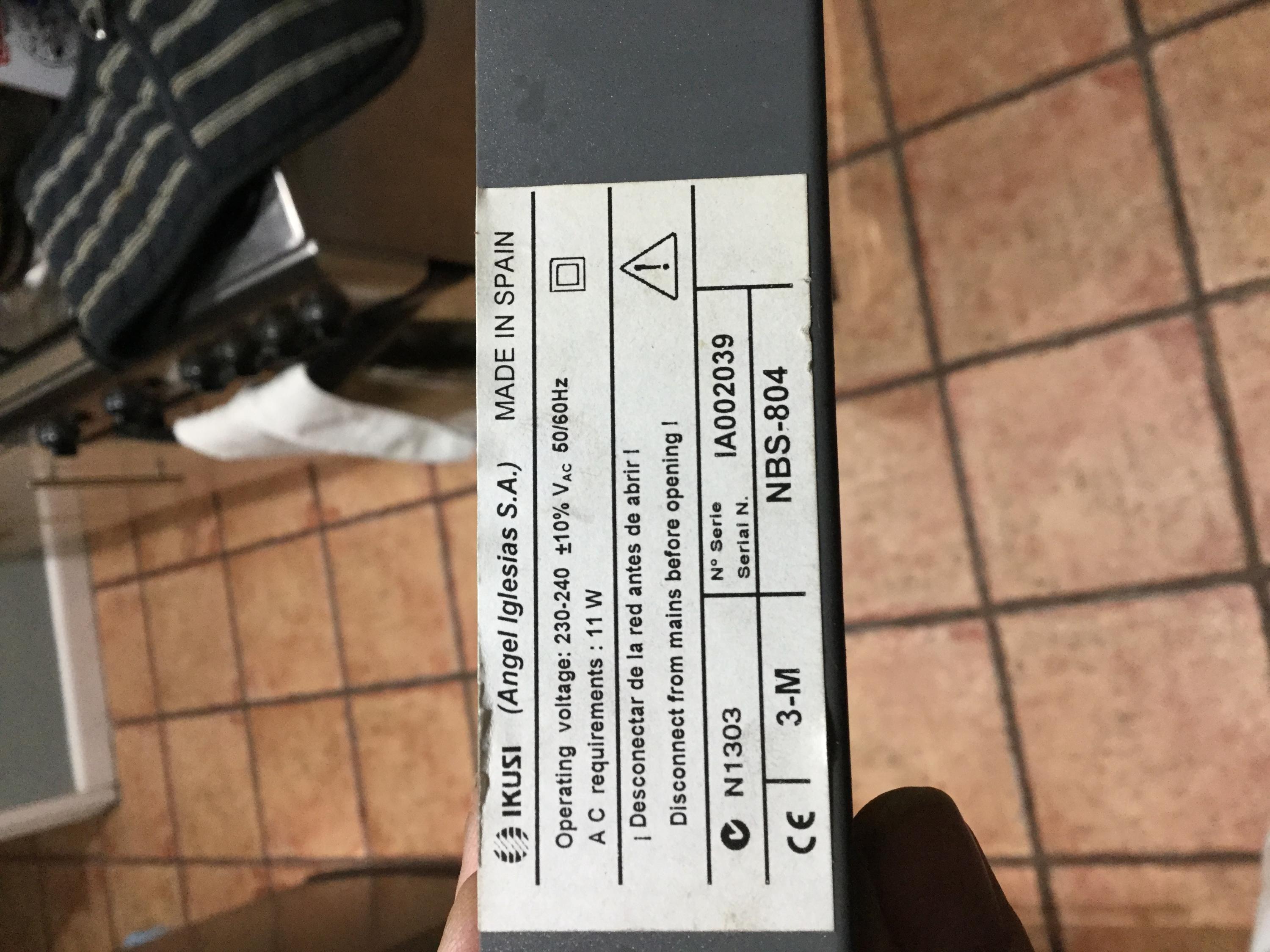

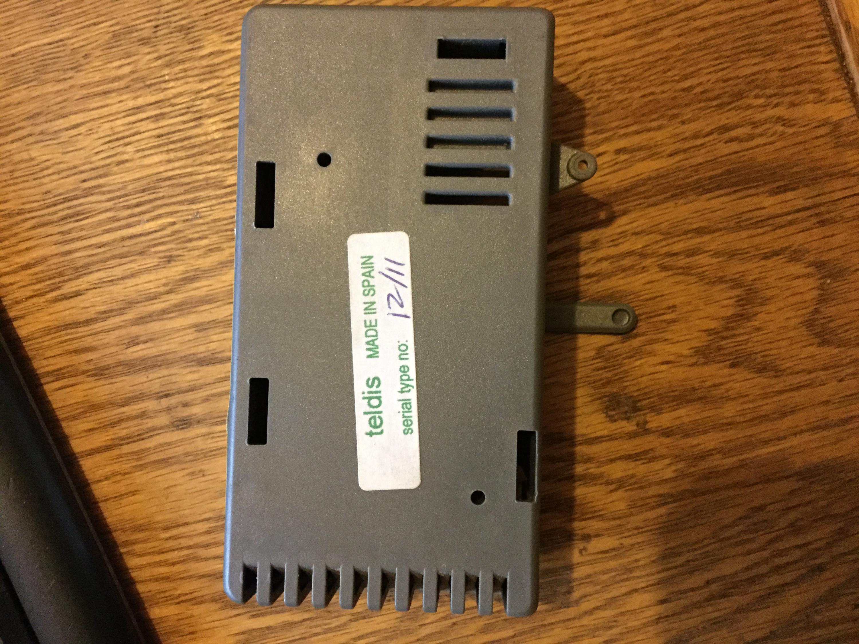

      Manufacturer: IKUSI (power supply side could be Teldis)
      Model Number: NBS-804
      Its a bit niche as this equipment is used in blocks of flats to distribute UHF TV signals

        The closest I can find, so far is a DP2360, DP2362 based on the pinout

            probably easier to put another 12/24v dual PSU in there.

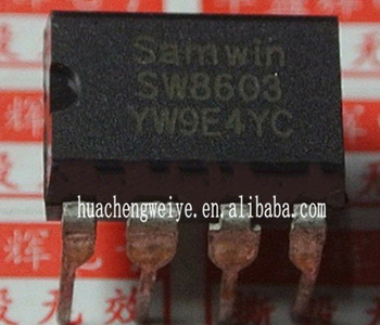

              It's a Samwin SW8603

                Re: Component ID on TV UHF Amplifier PSU
                Thanks RJ your a star
                Sorry for the lack of replies works been taking up a large chunk of time ,
                next job to try and source once again many thanks too everyone
