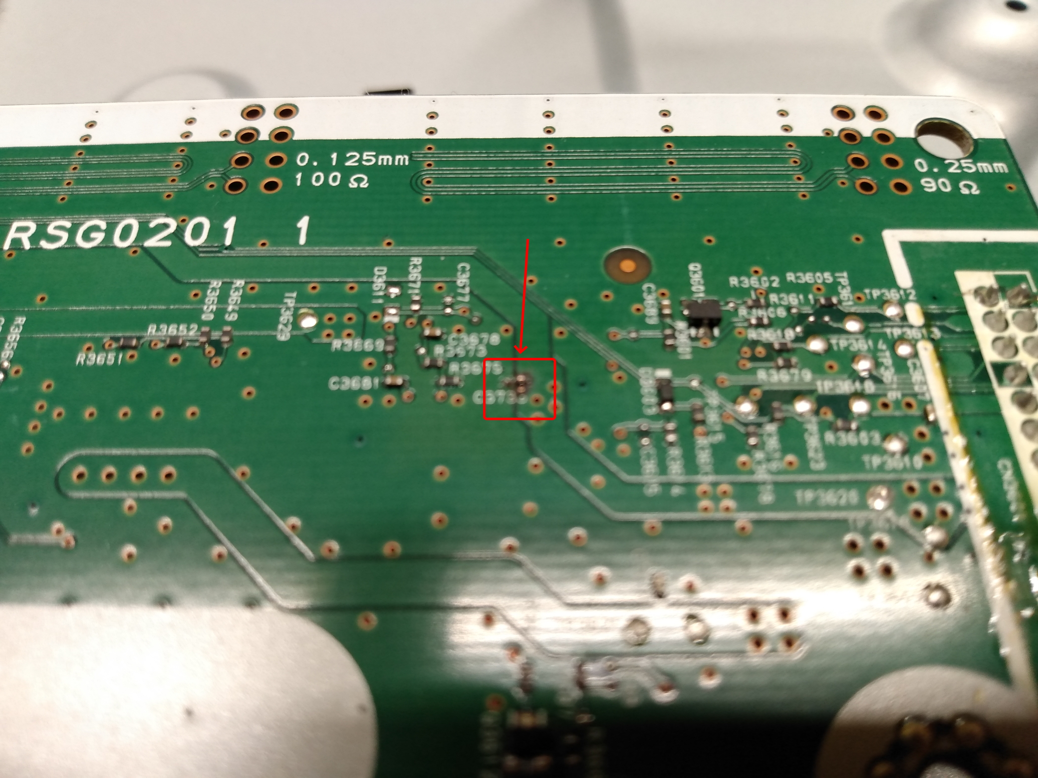

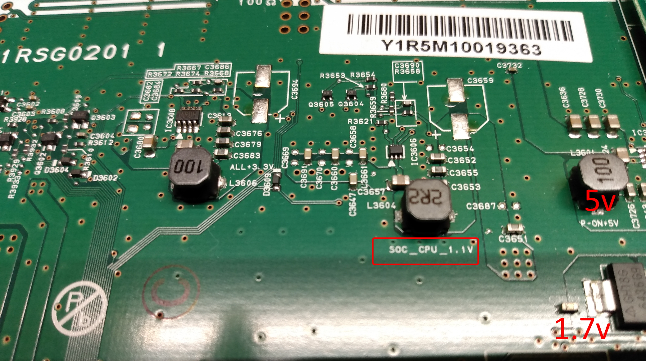

                        At this point I have concluded with high confidence that the Power Supply Board is not at fault. I then concentrated my efforts on the Main Board measuring voltages and visually inspecting components.
                        All the voltages check out except for the SOC_CPU_1.1v rail which looks to be dead. Further visual inspection revealed a small blown cap ( I think ) on the PCB backside near the CPU_1.1v rail
                        I am not sure what is regulating the 1.1V but instead of continuing to troubleshoot/replacing components, I simply purchased a replacement board for $12 on ebay. I'll report back as soon as I swap boards.

                          Is the cap shorted? if it is just remove it and see if the cpu_1.1v returns IC3606 will be the ldo for that voltage

                            I removed the component, cleaned the PCB and verified that there is no short. Still no CPU 1.1v.
                            I checked IC3606 and it looks like Pin1 is getting a 13V input voltage, I am not sure about the rest of the pinout but there are no shorts to ground that I can find. I cannot read the legend on the IC so I have no clue what the pinout is supposed to be.
                            I should be getting replacement board soon but would still like to troubleshoot this board for future reference.

                              What are the numbers/letters on IC3606, or a closeup picture to be able to see the markings, you may need to use alcohol to clean the top of the ic to read it.

                                Pain in the butt, had to use a magnifying station at work to read the legend.
                                UTH 233, confirmed by colleague just to make sure. Searched and found nothing.
                                Replacement MAIN due in today, I will report back this weekend with findings/results.
