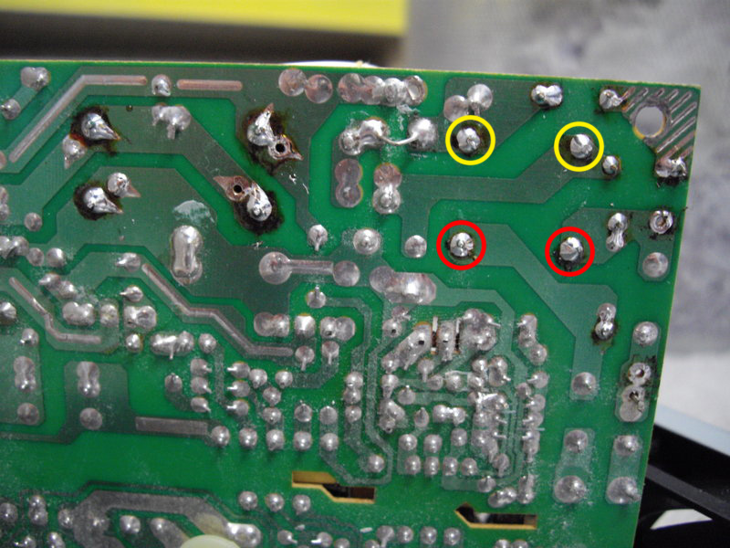

    Hello people,
    I have recently decided to try to rebuild my "The Best Power" MT-500P 500W power supply so it can be a backup PSU for my Celeron 2.2GHz computer. I started by adding in the input filtering components that were missing on it. When I tried to power up the power supply, the 6.3A 250V fuse in it blew, lighting up the inside of the power supply for a second. I have one other fuse, a 10A 250V fuse that I took out from an old power supply, to replace that one with. But, I don't want to blow the other fuse I have and potentially start a fire.
    Here are pictures:
    The primary side of this power supply.
    The input filtering components that I added in (notice the blown fuse near the X cap, it's black because it blew)
    Underside of the primary filtering section (the soldering on the primary caps look bad, they were better when I powered it on, I was trying to find a short somewhere in them)
    Could this be a short?
    When I added the X cap, the fuse was in its way. I heated up its solder joints to move it slightly outward so the X cap would fit. But looking at the last picture I have, could it be shorting to another component in the power supply?
    I won't replace the fuse until I'm absolutely sure what's making the fuse blow.

      The fuse doesn't have a short, those two pads are meant to be connected as the PCB is like that:
      Another picture of the underside of the primary input side (I redone the solder joints on the primary caps):
      A picture of the X cap:
      A picture of the blown fuse:
      Also, the place where I put the X cap in, is that even a place for an X cap? On the PCB it had "R1" in the rectangle, but it had "'CX2" next to it which I guess means a place for an X cap.
      Willawake's ISO 420W PSU, which has the same PCB layout, I think has an X cap in that location:
      Which component I installed could possibly be causing this weird problem?

        Looks like you put the input coil the wrong way. I think it should be rotated 90 degrees (doesn't matter clockwise or counter-clockwise). Let's double check that though...
        First, remove the X cap. Then, with the coil in there as is (don't remove it or change its position), set your DMM to resistance and put the probes on the two spots I circled in red in the picture below. Do you get a short (0 Ohms)? If you do, you've put the coil the wrong way.
        Now remove the coil, set your DMM to resistance check again, and put the probes on the two spots I circled in yellow. What do you get?
        If you get a resistance that is low at first but then begins to climb up and goes high, your power supply most likely hasn't been damaged.
        In that case, flip the input coil 90 degrees like I said, and it should be working again.
        Also, I recall that the bridge rectifier configuration for that power supply was a bit different that other power supplies I've seen. It looks like you got it right, but can you post another picture of the top side of it just to double-check it.

          I did the first thing you said and got 1.0-1.1 ohms on the multimeter. I did the second thing you said and got a small but rising resistance.
          I flipped the coil 90 degrees and installed the 10A 250V fuse, and the power supply works.
