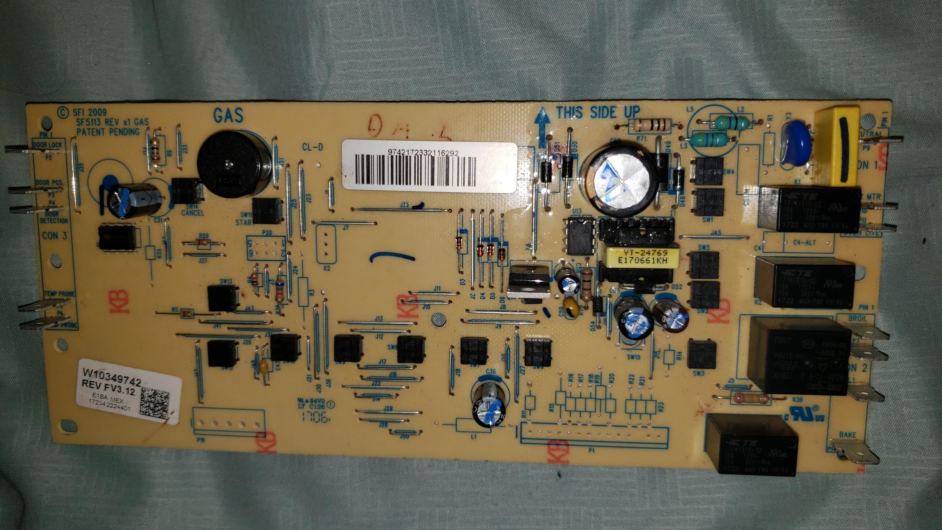

    I am attempting to repair a control board for a gas oven. The initial fault occurred after a lightning storm, the digital read out and all oven controls ceased to work. Upon inspection I found a resistor on the line side to be open. I replaced it with a 1/4watt as that is all I had at the time. I applied power to the board while on the bench and it worked (display lit and buttons functioned), however when my dad plugged it all back in it "sparked, crackled and shut off". I then purchased .5watt resistors and we tried again. Again it burned out the resistor. I have not been present either time when he hooked it up and plugged in the range, but each time I have bench tested it and the display comes on and buttons work. I am including some pictures and further information below.
    I started to trace out the circuit, curious why there is so much draw causing the 10ohm resistor to open. I believe the power circuit is a switch mode power supply? Sorry still kind of a noob.
    One 470uH inductor in series to and before the resistor on the line side seems to have a small crack but ohms out at 1.1ohms or so.
    A few questions:

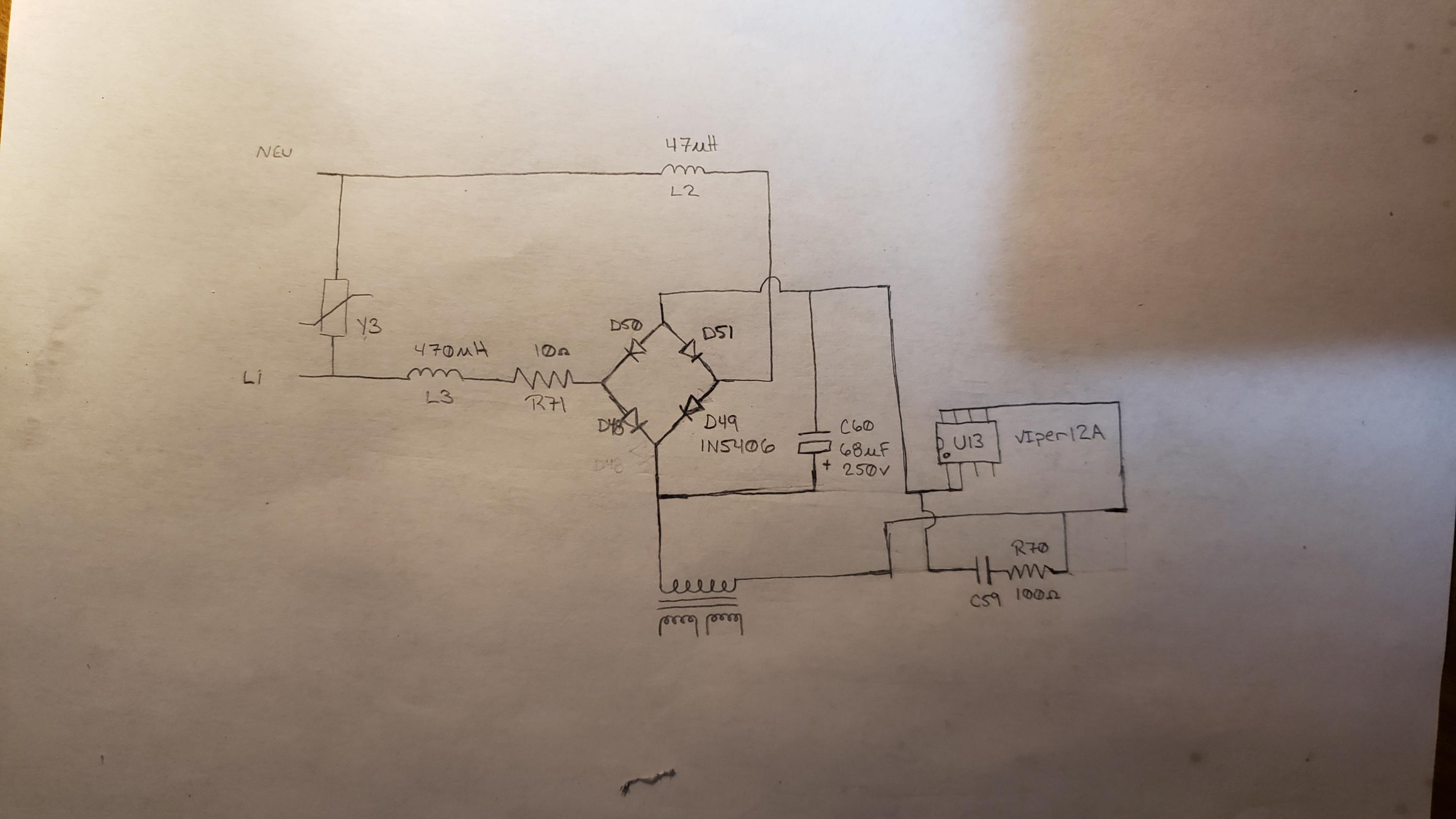

    1. If I traced the circuit out correctly and the diodes make up a full wave rectifier, then why is one diode larger/different from the other three?
    2. What seems to be the most likely failed component that would allow it to function on the bench but burn the resistor when installed in the range/oven?
    3. Could the 470uH inductor be shorted? I read something about inductors in series on ac mains to reduce high inrush current on initial power up? Is that what this one is doing, and is this the correct function in this situation?
    My circuit tracing efforts:

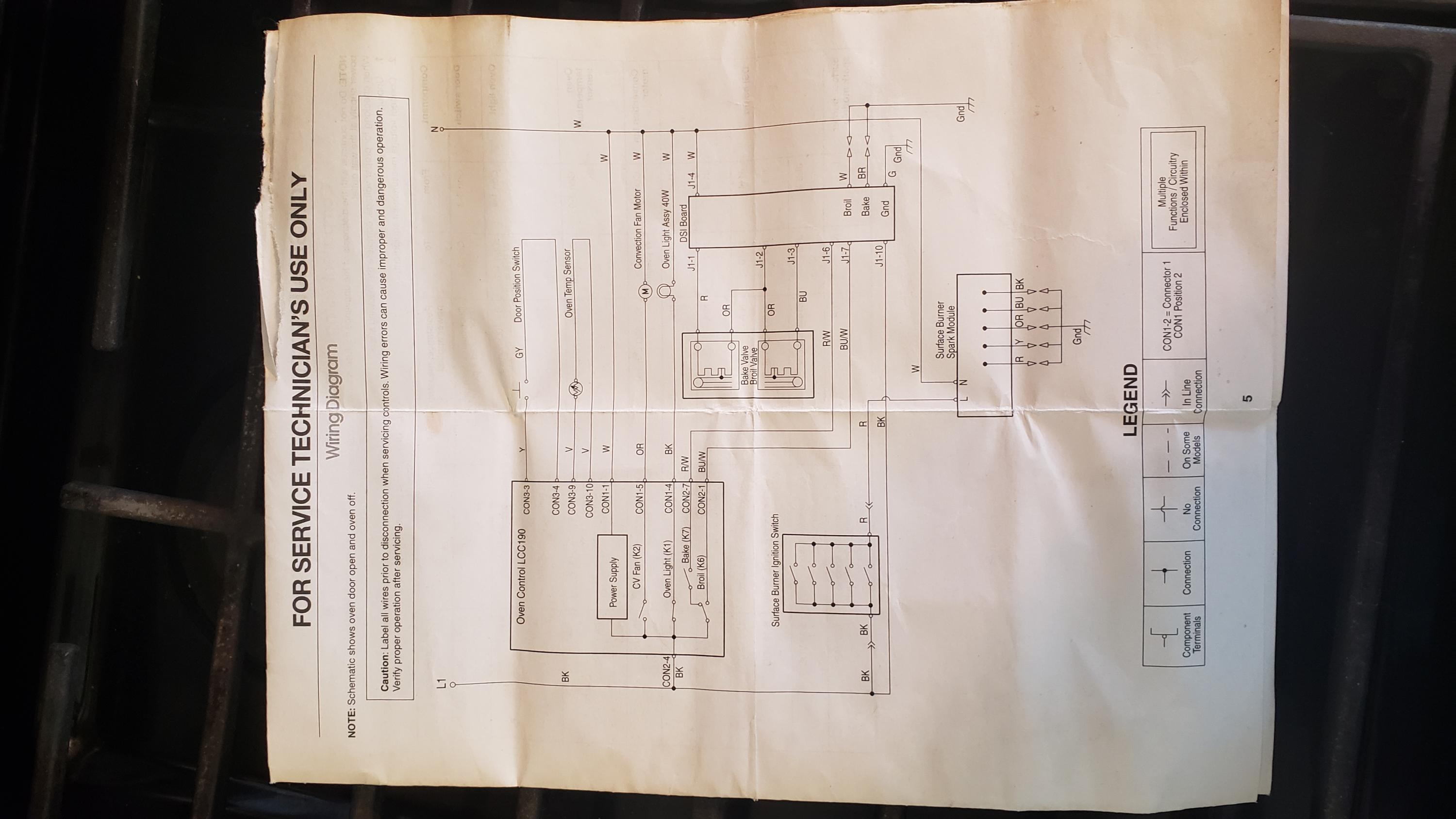

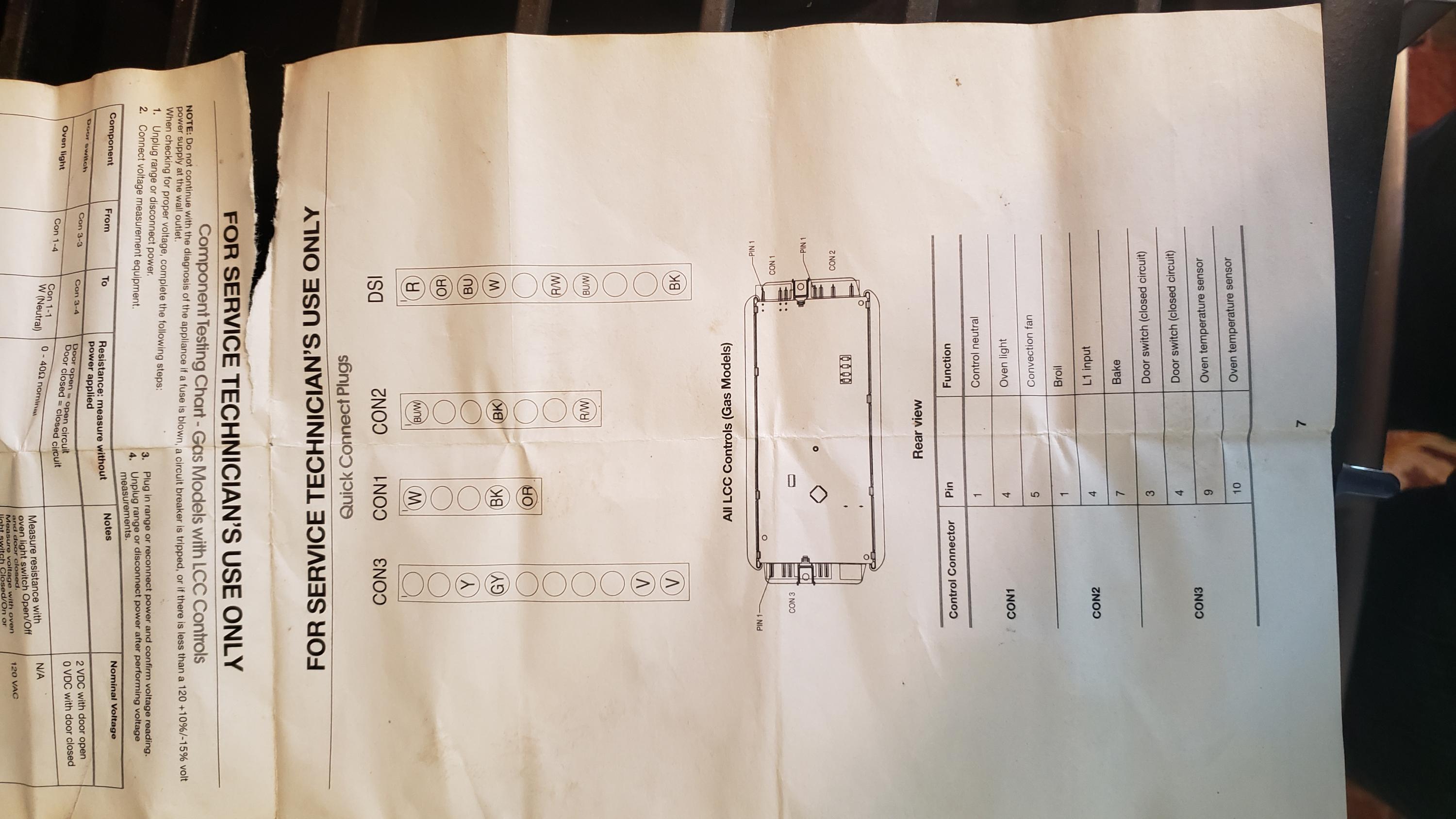

    The two relevant pages from the service manual for the stove:

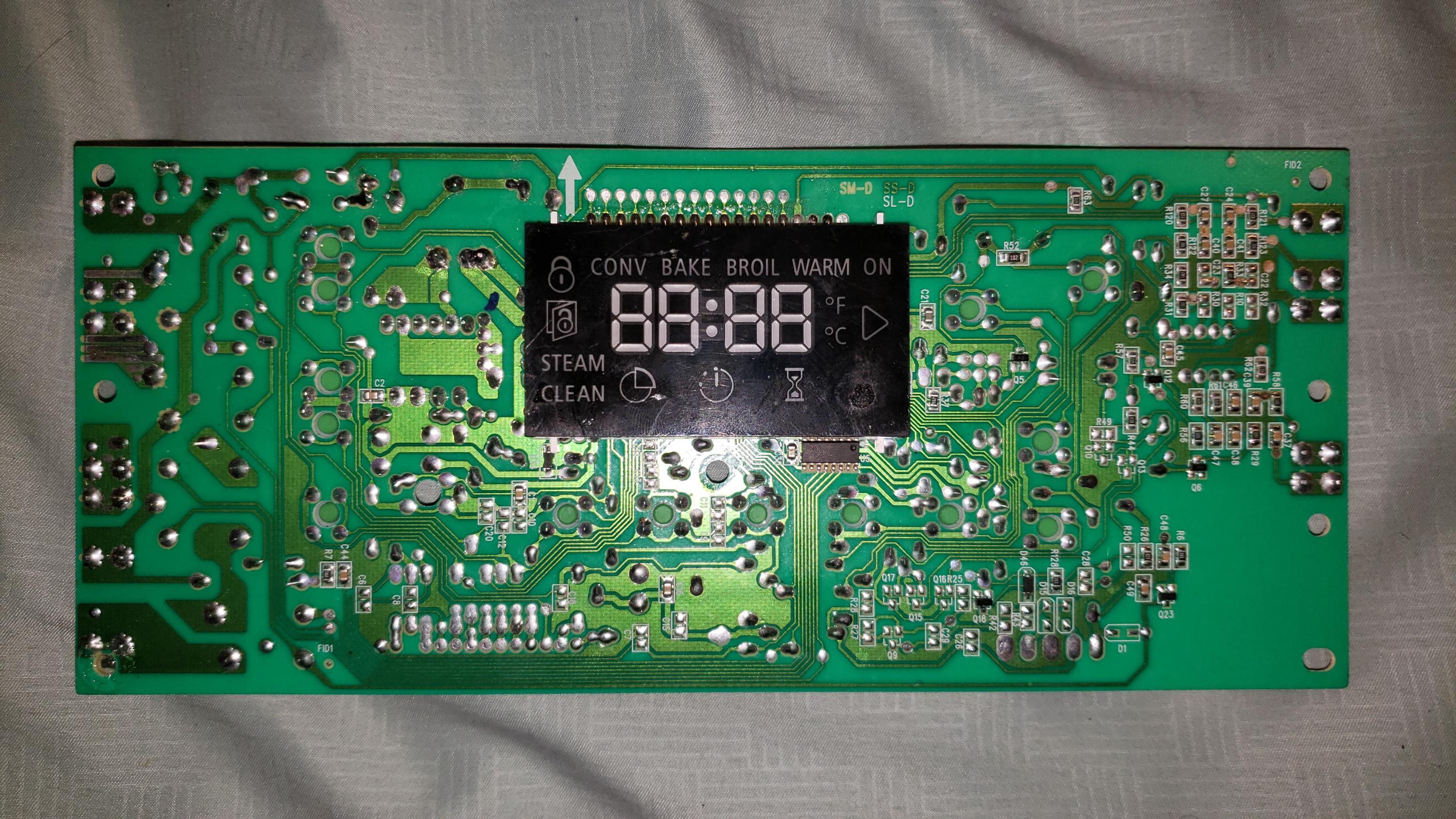

    Board top and bottom:
    R71 is the resistor that keeps burning up
    D49 is the odd ball diode 1N5406, unable to read others while on board
    I tested dc voltage after rectifier and it read approximately 160vdc as that is close to what I had in a simulator on my phone
    L3 is the somewhat questionable inductor
    Y3, MOV tested OL out of circuit

        bottom pic far left bottom . whats going on with the trace that looks missing ? appears to be under the yellow block thing
            Just a mounting hole for a screw if that option was used here, it is not, and it has some coating that ran over on it. Looks funky in the pic but just verified physically on the board.

              Okay I can remove the relays and check them. They are all one legged on the hot trace, I did not consider that. I will try to test them tonight and report back.
              I can still check But according to the connection figure for three of the four relays on digikey there is no back-emf diode: https://www.digikey.com/product-deta...BoCd9kQAvD_BwE
              And it looks like all the coils are DC with the contacts controlling AC so that one leg of the relay is hot AC

                            I test it with ac connected to L1 spade and Neutral spade U13 is the Viper12a

                                    The two coils on the input are not the problem, they are there to prevent noise from the switching power supply going back onto the ac line. Check the board on the bench, if it still works, install it in the stove with only the line & neutral connected and see if it still works, then connect the other plugs. Having something shorted on the relays output will have no effect on the relays coil so there will not effect the smps. You could have a problem with something connected to connector 3, check the wireing to the temp probe, door detecion,lock,position.
