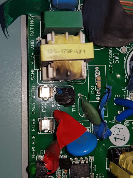

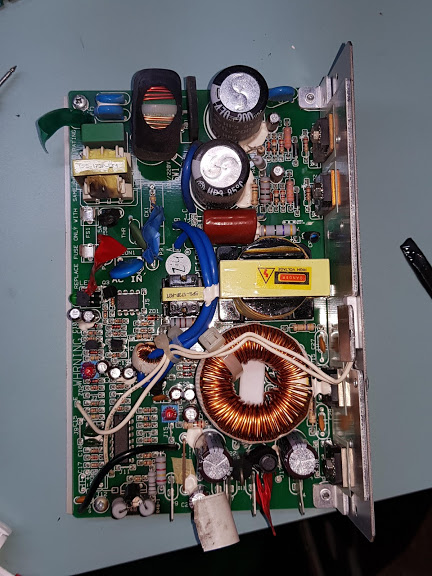

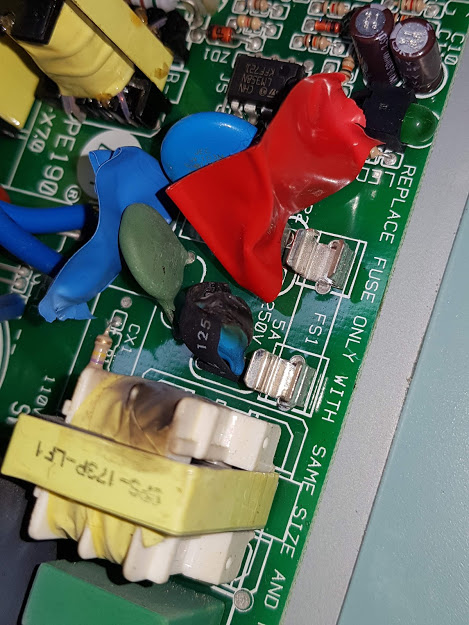

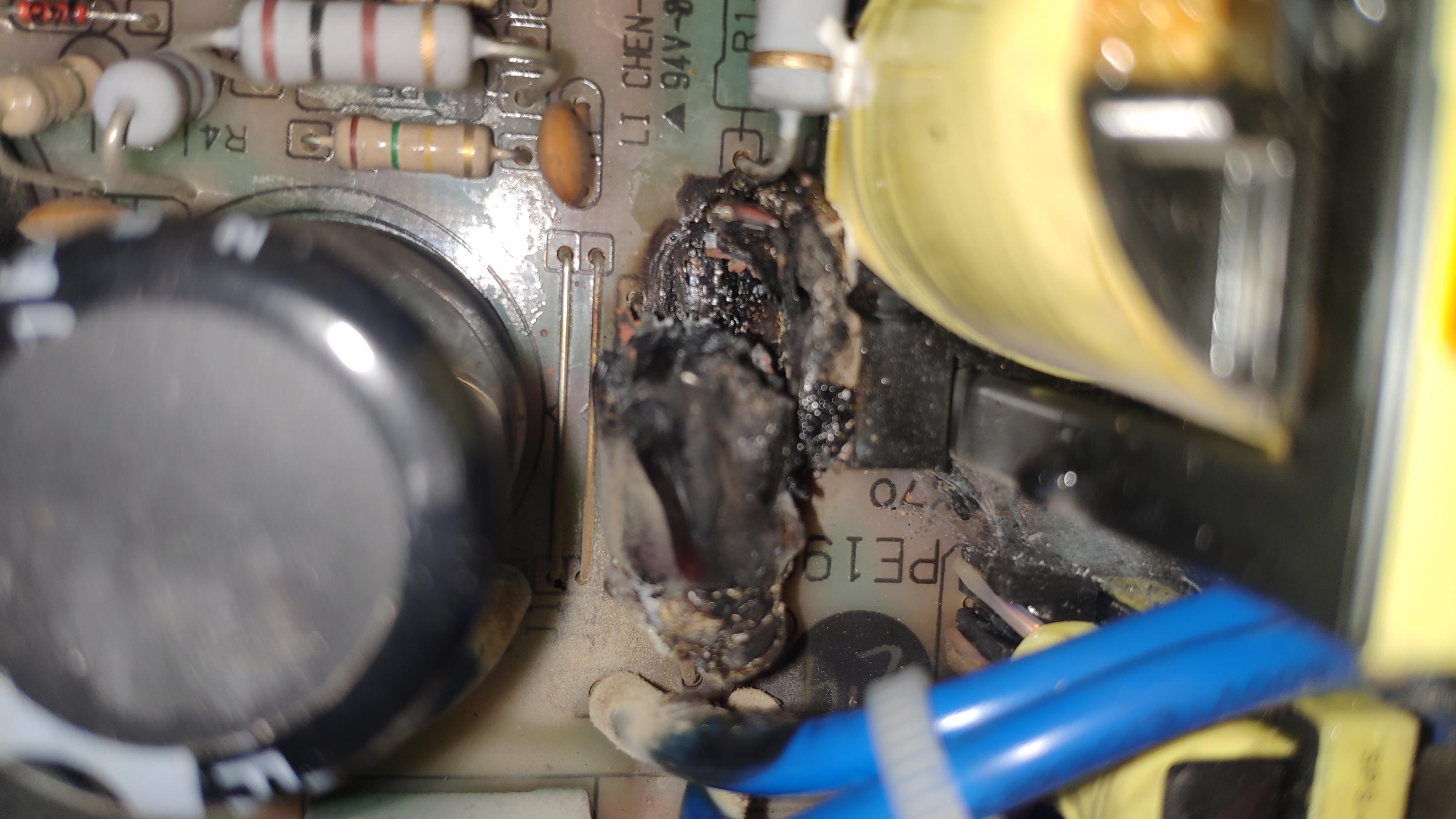

    Hi, there I got this battery charger in for repair. The component is all burnt so I am struggling to identify the part number I think its a metal oxide varistor but don't know its value can anyone confirm this component and its possible values..any info would be much appreciated

    If you remove the black heatshrink can you read any numbers? what is its board designation? is it across the a/c line?
    If not it should not be to difficult to find a replacement
    something like a 7D471K

      Thanks for your reply I removed the heat shrink but nothing is visible and yes it's across the ac line straight after the fuse before going to the rest of the board..thanks
      Your never to old to learn
        Re: Zig X70 Caravan battery Charger Component identification
        I would remove that blown MOV and start checking to see if anything else got damaged or not and see if the unit still working since MOV is not needed for the unit to function, it is for protection.
        If you find not damaged component then you can power it up using 100W incandescent lamp in place of the fuse and no load connected to see if come alive or not, if it does, the measure the diameter of the MOV, then it is just a meter of getting the rated clamping Voltage that is above you normal AC LINE Voltage.
          is it powered from mains or generator ?

            Okey budm i will remove it see if anything else was damaged and see if it will power up
            Petehall347 it was running off a generator as it wasn't on a caravan site to hook up too but it was my generator he used which has built-in surge protection as I use it for outside pa

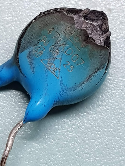

              I have removed the component and can just see the part number (471kd07 ) but can't find a replacement in the Uk is there a compatible replacement I can get. thanks

                Just look for 7D471K Varistor.
                7D = 7mm dia.
                471 = is the Voltage rating.
                I.E. https://irishelectronics.ie/7D471K-Varistor-Resistor

                  The generator is the problem if it's blowing 300VAC MOV that turns on at 423-517VDC. I would check if it's working. The regulator might be pooched or it needs a minimum load, as most generators are savage.
                  For replacement, consider Epcos/TDK S07K300 (B72207S0301K101) or bigger 10mm S10K300 if it will fit.

                    Thanks for the information I have ordered a new one and will let you know the outcome.

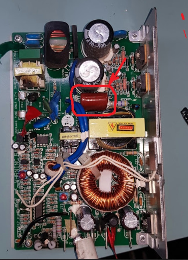

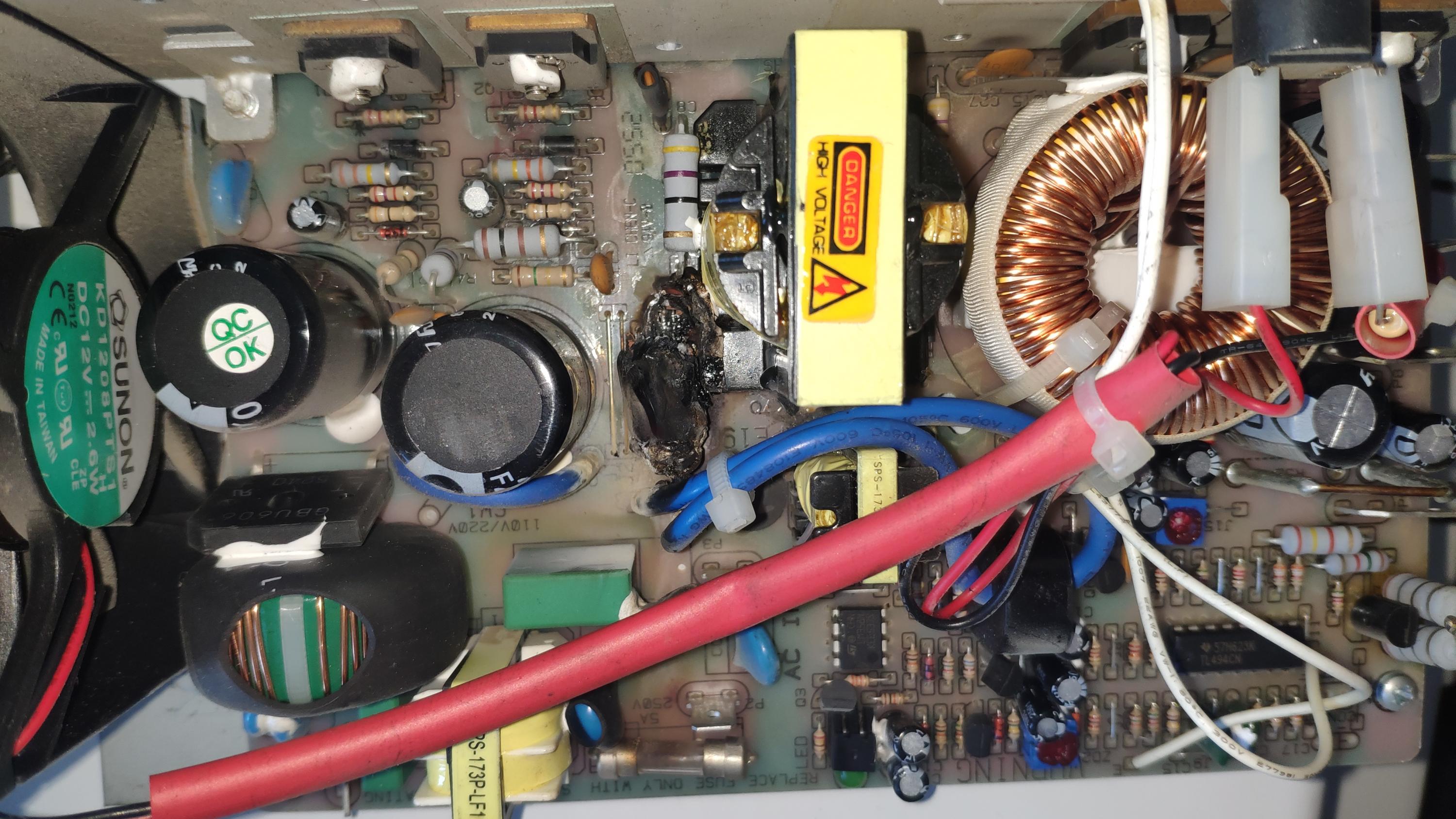

                      ZIC x-80 is a similar story, but another detail burned down. Please help me determine its meaning. Thank you for any information. Highlighted in red in the photo

                        That is a high voltage film capacitor, likely rated for at least 400v and something like 1uF of capacitance.
                        Most likely it is parallel to the two large filter capacitors and it is very strange that it would fail and nothing else...

                          Thank you for your time. Below are real photos of the place of the fire. Visually, no other damage is visible. Unfortunately, there is no ZIC X-80 scheme available, I have to bother you. If you need to take any additional photo, tell me which one. We really need the parameters of this part.

                            Desolder the capacitor and clean the area well.
                            Then check on the underside what it connects to.
                            If it is in parallel with the two large caps you can just give it a test without that capacitor present.
                            But check first if the fuse is blown.
                            And I recommend to use an incandescent light bulb in series with the unit, for example directly replacing the fuse:
                            If the lamp turns on and remains bright you still have a big problem on the primary side...

                                Probably not possible to find this exact units schematic, but you can use any TL494 based schematic as a reference, see here for example, there are a couple TL494 schematics for AT and ATX power supplies for computers: https://danyk.cz/s_atx_en.html
                                In these schematics it looks like the capacitor that burned up is not in parallel with the big filtering capacitors, so if that is correct you will need to replace it.
                                A good starting point is probably 1uF and at a minimum a 230v rating, but much better with 400v.

                                    As promised, I share the result. A 0.63mF 400V film capacitor was installed. I turned on all the 12 V equipment of the Caravan, while the battery was half discharged. After 8 hours of operation, the battery was charged. Then I connected the compressor and pumped up the wheels of the caravan. It works! I think that everything is fine at this stage. What are your opinions?
                                      Sounds good to me!
                                      It is unusual but sometimes capacitors short internally.
                                      I guess that is what happened here so that is why nothing else was damaged...

                                        I think that's a bit not the reason. I didn't know about the existence of X80 in my caravan. at the time when the caravan was connected to the 240V network, I connected a separate charger to the battery terminals. P.S. it's bad not to know the device and the devices of what you use)))). Thanks again to everyone
