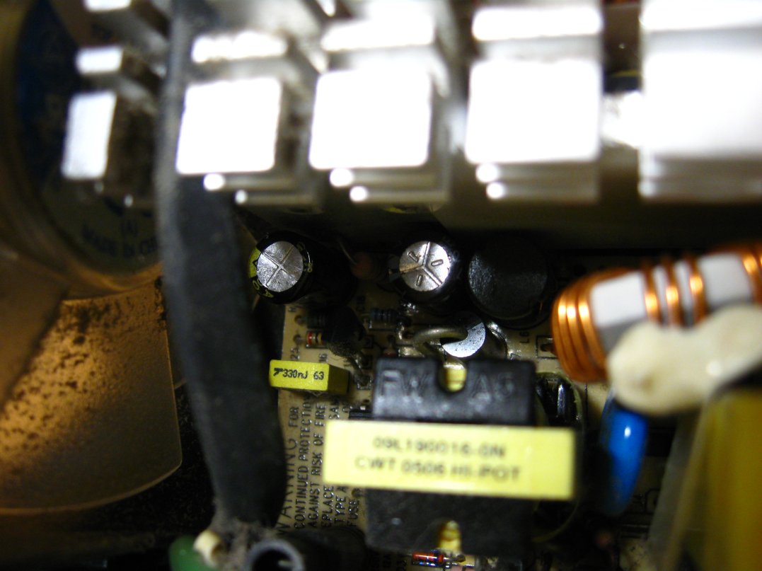

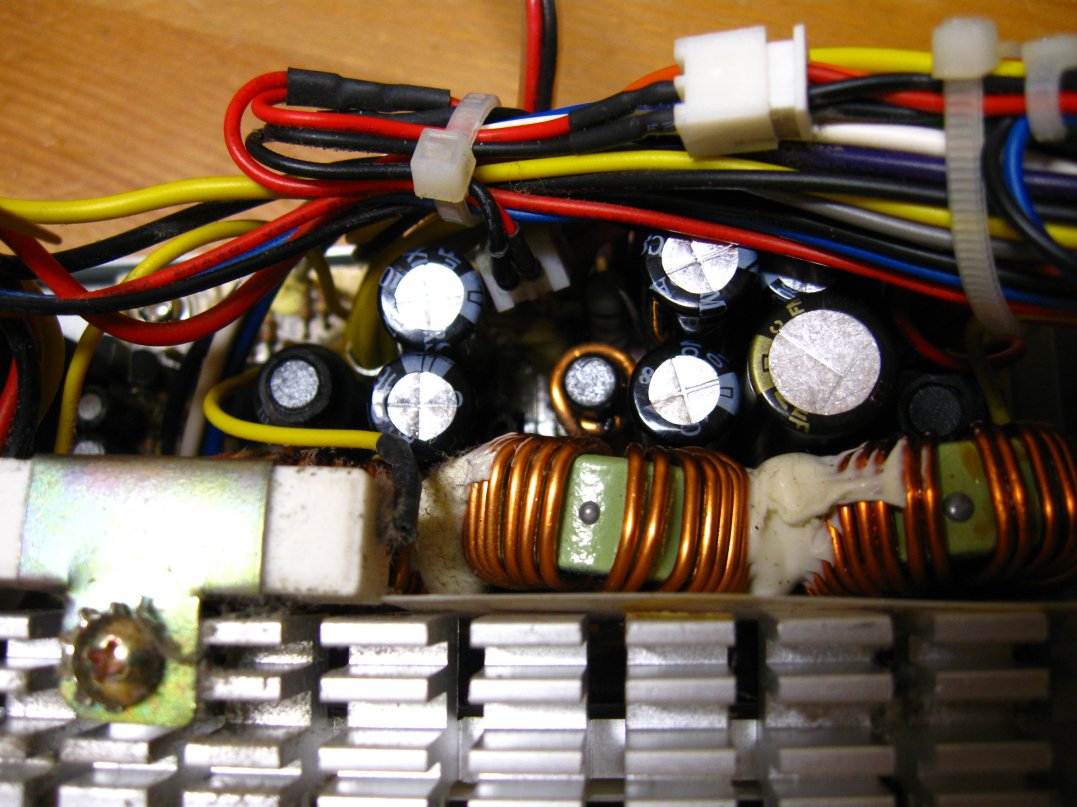

    I have used this power supply since 2004 (got it new). Recently it refused to start on cold boot - this really got worse when room temperature dropped in winter (Australia). I would have to run memtest or let the computer sit on the dual boot selection screen for a couple of minutes, and it would boot if I then reset.

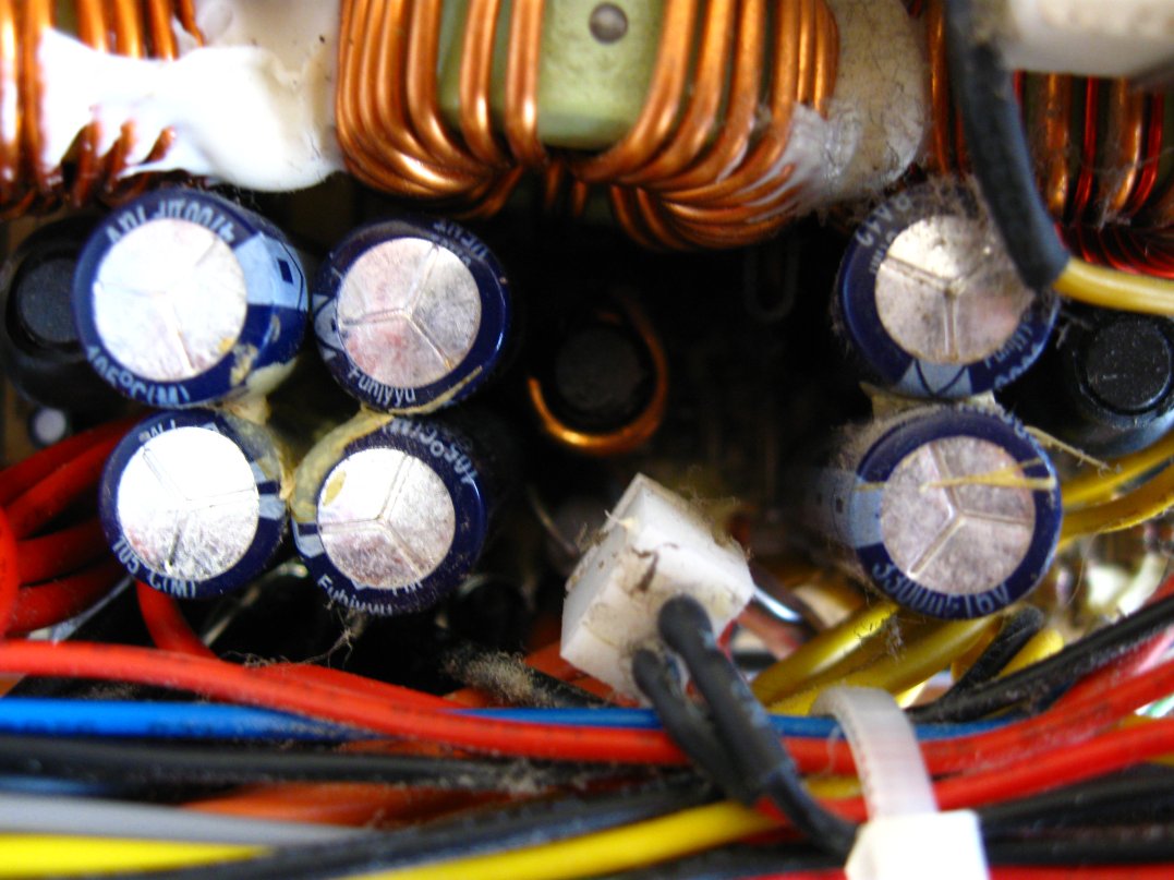

    When I opened it up I found a lot of Fuhjyyus, mostly bulging top and/or bottom. The ESR was as follows:
    4700uF 10V 0.8
    3300uf 10V 1.2
    " " 0.82
    " " 0.96
    3300uF 16V 0.17
    3300uF 16V 0.06 (this one was not bulged).
    I replaced them with the same spec Samxons (thanks Big Pope) except for the 4700uF which I used the same specification Panasonic FM for (managed to just fit it). I also replaced a 1000uF 10V near the rear exhaust fan with a Panasonic FM (I think it was a Teapo) although the ESR measured OK. The one next to it also measured OK - I would have replaced it also but it was 2200uF 10V and I didn't have a replacement as I thought it would be 1000uF, and I couldn't see the value until I took it out!
    Since replacing the capacitors I have had no problems with the power supply.

    Maybe your ESR meter is stuck on the wrong scale.
    When I measured the baked caps on mine (did 4 Antecs) I was getting 72 ohms 89 ohms, and over 99 ohms (out of meter range). Bad caps are usually in the whole number range and not the decimal range.

      teapos will do ok in power supplies, fyi. some brands are like that.

        Fuhjyyu aren't even worth the time to check with a meter. - Just replace them.
