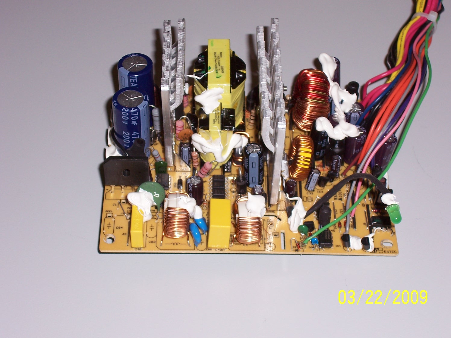

    I remember someone mentioning that a Bestec ATX-250 12Z was acting flakey, it quit working, then a few days later it ran fine again. I drew a schematic of the 5vsb section to see what I could find, also comparing it with the problem ridden "12E". So to begin, here is the schematic.
    I was pleasantly surprised that it had some protection features I was totally unaware of. The 5vsb pwm chip has a crowbar circuit (politically correct term is "latch"). There is also a SCR circuit for 5vsb overvoltage protection.
    Looking at the drawing labeled "crowbar", the left side shows the basic parts of the regulation circuit for a normally operating power supply. On the right shows the SCR protection circuit. When the 5vsb bus begins going much above 5 volts, the zener ZD3 begins conducting causing current flow through the LED section of the optoisolator PC3. This causes the output side (pins 3 & 4) to reduce resistance to the point that current flows into the scr gate causing the scr to turn on. Now there is a 1000 ohm resistor between the 16 volt line and the feedback pin, pin 4, rather than the 6800 ohm resistance plus any resistance on the output side of optoisolator PC2. End result is more current at pin 4 and the pwm chip crowbars.
    To test this feature, I jumpered the 12 volt bus to the 5vsb (no motherboard hooked up to power supply!). It instantly crowbared and shut down the power supply. The voltage on the 16 volt line dropped to 2.14 volts and stayed. The only way to release the crowbar was to unplug the power supply cord from the wall socket. After a couple of minutes to drain off the electrons, I turned the power supply back on. Next I used a jewelers screwdriver to touch between pins 3 and 4 of optoisolator PC3. This also turned the SCR on, and the power supply crowbared. The power supply instantly turned off. Same voltage readings. Unplug the power supply cord from the wall socket, wait a couple of minutes, then turn power supply back on. Looks like the problems with 5vsb overvoltage are solved with this circuit.
    For further analysis, I turned on the power supply, and using a small jumper wire, shorted the 12 volt bus. Instant crowbar and power supply off, 16 volt line dropped to 15.50 volts and stayed. After taking power supply cord from wall socket, voltage bled down to 14.45 volts, then quickly dropped. At this point I turned power supply back on. If it works for shorts on 12 volt bus ....... I shorted the 5 volt bus. Same result. Then I tried shorting the 3.3 volt bus. Same result. This looks like better short circuit protection than I have seen on most computer power supplies.
    If you are unaware of this crowbar effect, I'm sure it will seem like a flakey power supply. But now I hope some of you will dig out that flakey "12Z" and have some fun playing with it.

            i just got one of these free from a friend. out of a dead hp athlon xp box. no visible bad caps... boots fine but suddenly my hd fails. could the psu be a culprit or is my hd just dead?
            it boots ubuntu live and bios detects the hd. when i got to install it gives me a hd format error. a fedora cd did it as well. no odd noises. wd 40gb hd. i have an identical one from another source that runs fine.
            is it the hd, the psu, both or maybe other?

              Get your Blue esr meter out and verify that you have no bad caps, then check your power supply voltages, +12, +5, +3.3, and 5vsb. ANY power supply can have some bad capacitors. This does not sound like a mobo killer problem!
              Did you say this was the ATX-250 12E or 12Z??? Double check and lets be sure of what we are talking about.

                Hi Ratdude
                Well, it came from a dead HP box.
                Your Hard Drive apparently died while connected to it.
                It's very possible that the PSU is causing trouble. Hard Drives are often the first thing that a bad PSU kills due to the lack of caps, inductors or other protection on the Hard Drive.
                Personally, I wouldn't connect it to anything valuable until you can accurately measure voltages and preferably scope the outputs under load. Failing that, at least perform a check of the secondary Caps ESR.
                Just because the caps look OK doesn't mean they are. There could be gobs of Ripple with cap that look just fine. Other things can go wrong too.
                It might be a good idea to measure the voltages at the molex connector for the hard drive. A voltmeter won't tell you much about Ripple, but there's no harm in checking.

                  oh, and the hd was kinda flakey when i got it. it was used with an allied psu when i found it. remeber the 99 dollar machine? this was the hd out of it. it never worked right. it always took the computer (with delta psu) 2 post to detect it. moving to the other connector on the ide cable, it would detect it but some other error would occur. i think its the hd.
                  i have no esr meter. no money for one. i am not made of money
                  its a 12z. i once had a 12e but i gutted it since it was burnt up. my working one matches your pics.
                  the hp had bad caps. nichicon hm. it was a pavillion a210e. board to crappy for me to want to recap (i might though).
                  considering the above, i thinks its the hd, not the psu. what do you think.

                    Did you measure the voltages, +5, +12, and 3.3 volts? Do you have a dmm (digital multi-meter)?

                            its a goner. fixed the dmm, i got these:
                            12v=15.32
                            5v= 6.91
                            3.3v= 4.51
                            POS!!!
                            should i recap or should i shitcan?

                              wait- the dmm is off, it said my all outlet is 156v when it should be 120.
                              so, i need a new dmm.

                                Try changing the VMM battery. My VMM gives wrong high readings when his 9v battery is too low.

                                    Re: Flakey Bestec ATX-250 12Z?
                                    fixed it. said wall was 120.08, so ill buy that.
                                    tested box,
                                    12=11.84
                                    5=5.38
                                    3.3=3.38
                                    all in spec. so i assume the bestec is fine?

                                      This is not to be trusted PSU. I just dump it and move on with known good design PSUs.

                                        hooked the other wd400 to it. it works gread and has a lot less noise. the allied must have killed it ant it just happend to die when i used the bestec.
