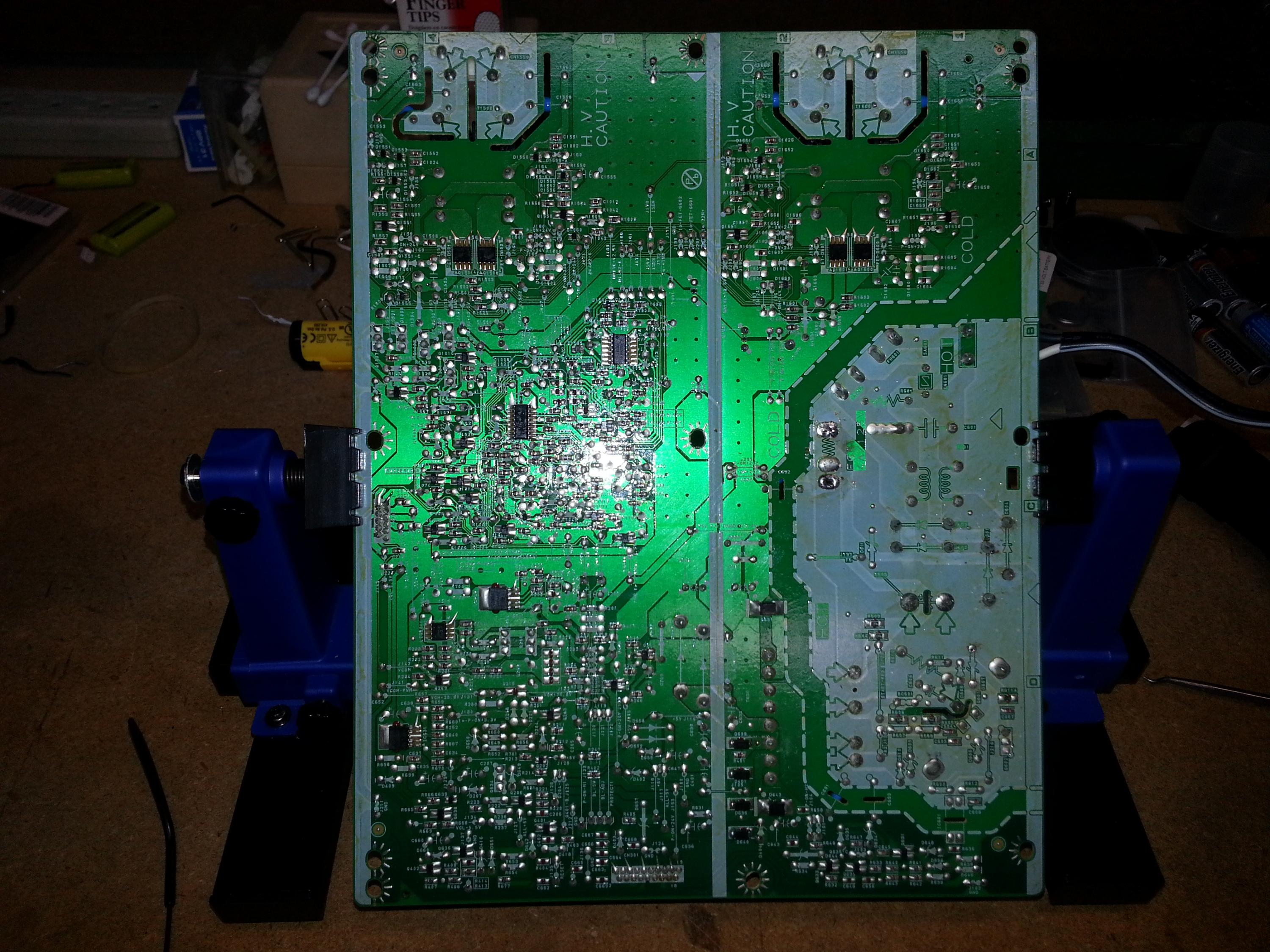

    This unit came with my new place, left by last owner. I Plugged it in and it WORKED! Tested all inputs, outputs, ran a channel scan and had an excellent picture for it's age.
    So as with all electronics, I let them run a long time as heat will eventually show any problems. 2 hours later, fuse blew. Reading other forums on similar PS's, I upgraded the rectifier diodes to the 3W as suggested. Plugged in, measured voltages, and they stopped at R602 which was open. NOW 2 QUESTIONS!

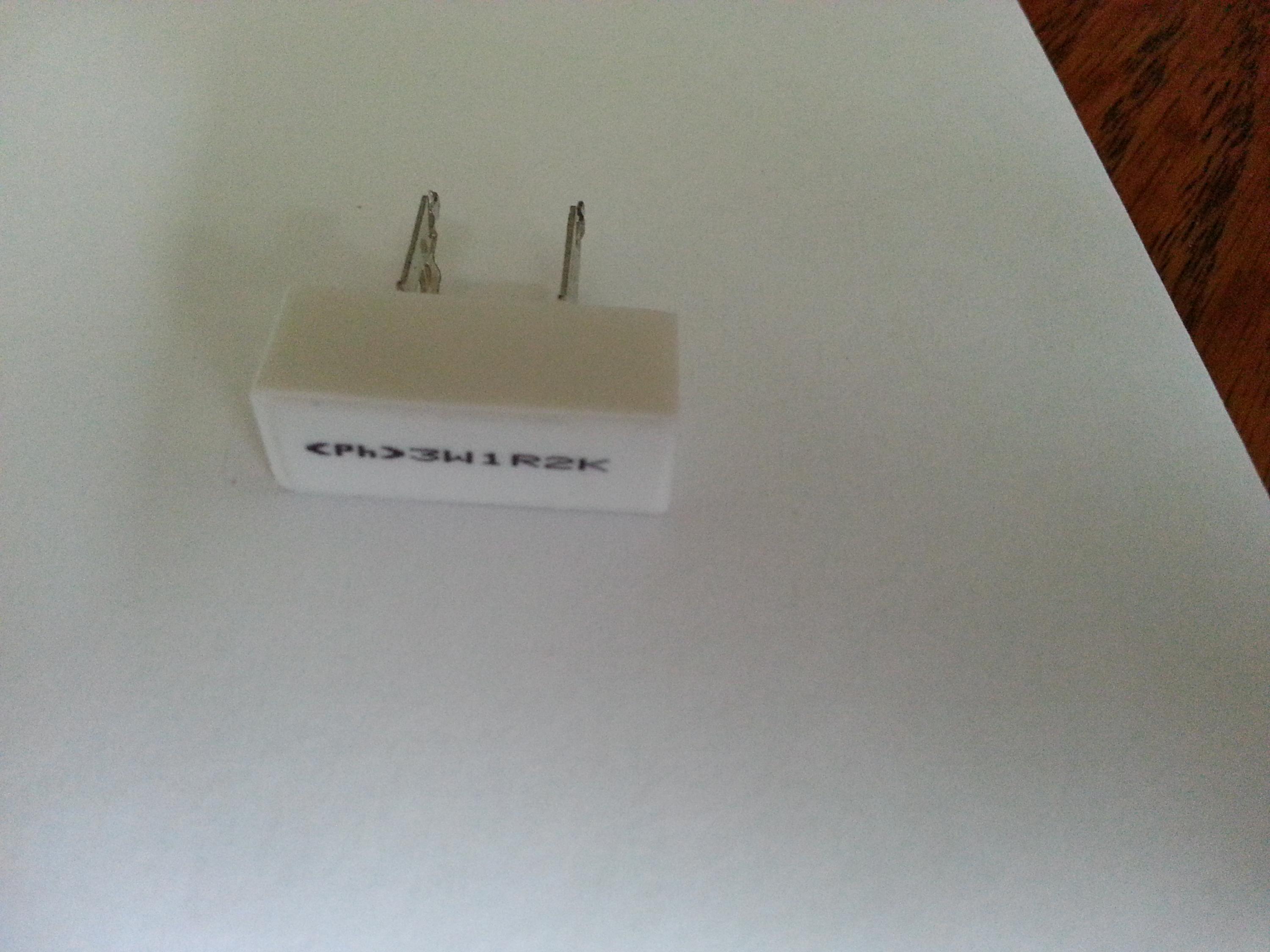

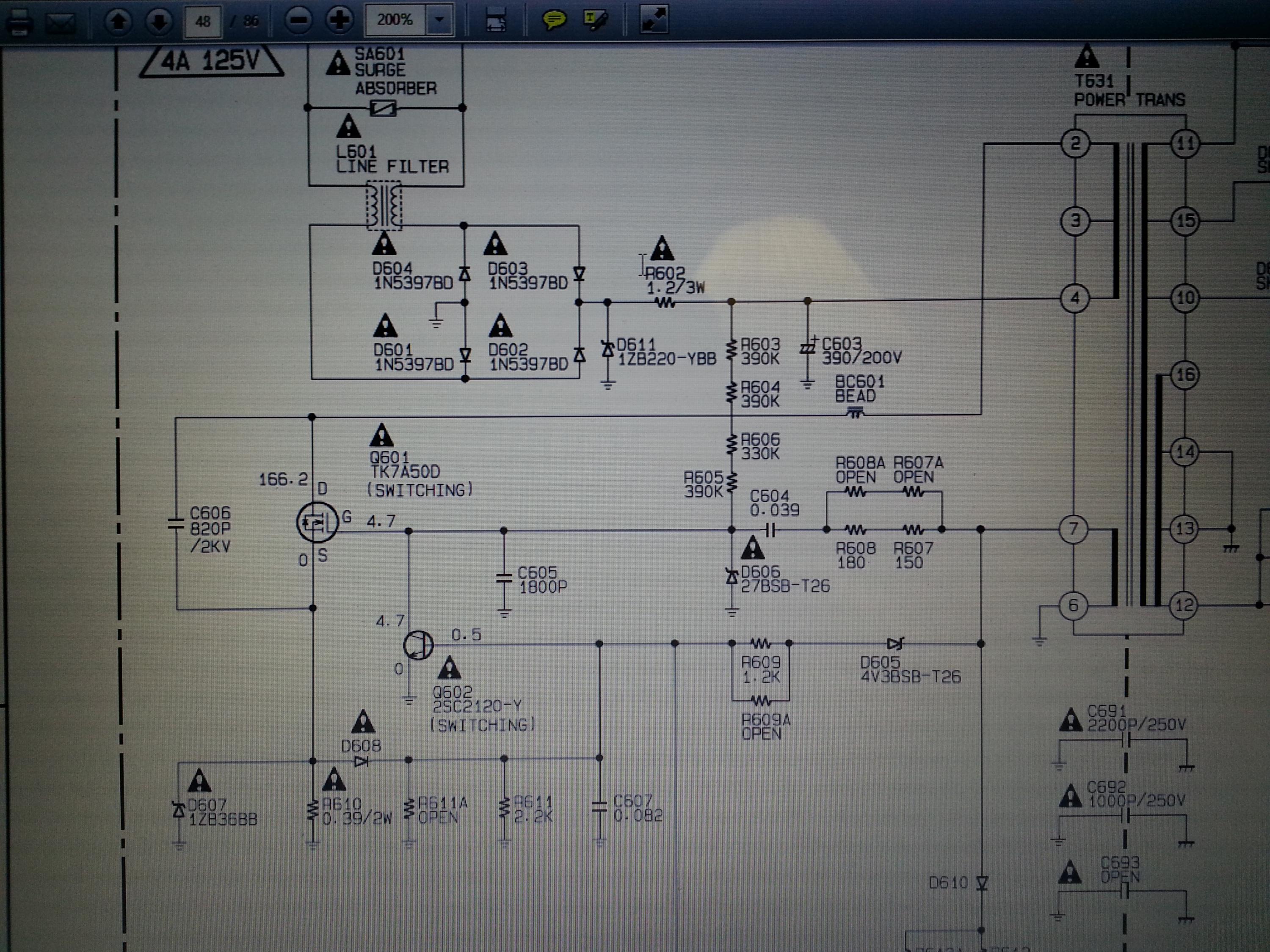

    This 1.2 Ohm 3W is not available anymore in any design. If you look at schematic attached, It would only drop around 2 volts but would dissipate 360W before heading to transformer and other PS circuits (HOT). D611 does not exist on the board, so no problems there. Could I just build a solder bridge based on schematic to eliminate R602?
    Further testing revealed Zener D607 (36V) as the shorting culprit. Before I buy that one and all other diodes that go to ground in hot section, Could anything else in your opinion have taking an hit from high amp rush? By looking at all components under magnifier, there are no visual signs of any problems except the hole to the shorted Zener D607.
    I don't want to keep spending $8 over and over with DigiKey if I am chasing my tail. ALL SUGGESTIONS APPRECIATED!
    Re: Funai Model LC220EM2 PS Issues
    That resistor is used as protector in case you have shorted circuit such as the power MOSFET Q601, that resistor is safety device that is why it marked with caution symbol in the schematic, it should be at flame proof type. What does the BOM of the board show that resistor as? Fusible resistor? That is what it should be. They put that resistor in there for reason so do not bypass it.
    Did you test D607 off the board? That D607 is connected in parallel with 0.39 Ohm resistor.
    Did you check all the diodes in the cold side?
    Did you check Q602?
    Did you check R610?

      Regarding 3A flame proof R602, since there appears to be nothing in the aftermarket to replace it, any suggestions? Could I just put another fuse (maybe 3A?) in place of it. The 4amp fuse F601 blew and did it's job, but the short also took out R602. Seems redundant to place 2 fuses in a series circuit, 1 before rectifier, and 1 after. But I don't claim to know it all. I already ordered all the diodes, so I'll know by Saturday hopefully. Maybe you can explain engineer design thoughts behind this

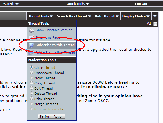

        Being new to this Forum, I did not get an e-mail letting me know someone had responded to my Post. How can I get notified, or is there something different I should be doing? I left the Forum open for several hours after the post and budm responded within 35 minutes, yet I never knew. I do get an email every time a new member posts. Thanks. I want to know how to help and be helped.
        • Per Hansson
          • Jul 2005
          • 5895
          • Sweden
          There is a subscribe button at the top...

              I found how to test Q602 and it is bad. On Diode setting testing off board, connect + lead to D and - lead to S. It is supposed to read open (1). I get 0.001 Ohms or shorted. Found part on Mouser for $1.45 but cheapest shipping is $9.00. I want to see this work but am tired of wasting money. Plus, I still do not have R602 installed as they are discontinued.
              I'll wait to hear from someone before I recycle this. It worked so GOOD until this short.

                          what are the part numbers printed on Q601 and Q602? There should be subs to be found on Digi or Mouser...
                          So... the 2SC2120 some folks replaced it with a BC337. These have different Hfe ratings, so choose one that has the highest.
                          The 2SK3561 is probably something similar to some 8 N 50 variant of different manufacturers. FDP8N50NZ-ND

                                you have to check the whole gate drive circuit. You have to remember that if the mosfet shorted to the gate, the full power is getting to the gate drive. That means the gate drive transistor is shot too.
                                So if you just replaced the Mosfet, but not the little gate drive transistor, well... it goes bang again.
                                Also check these 4 resistors in series (R603 to 605). Better yet check all the resistors if they went out of spec. Usually they go higher in Ohms if they are damaged. Recheck all the diodes and zeners too.
