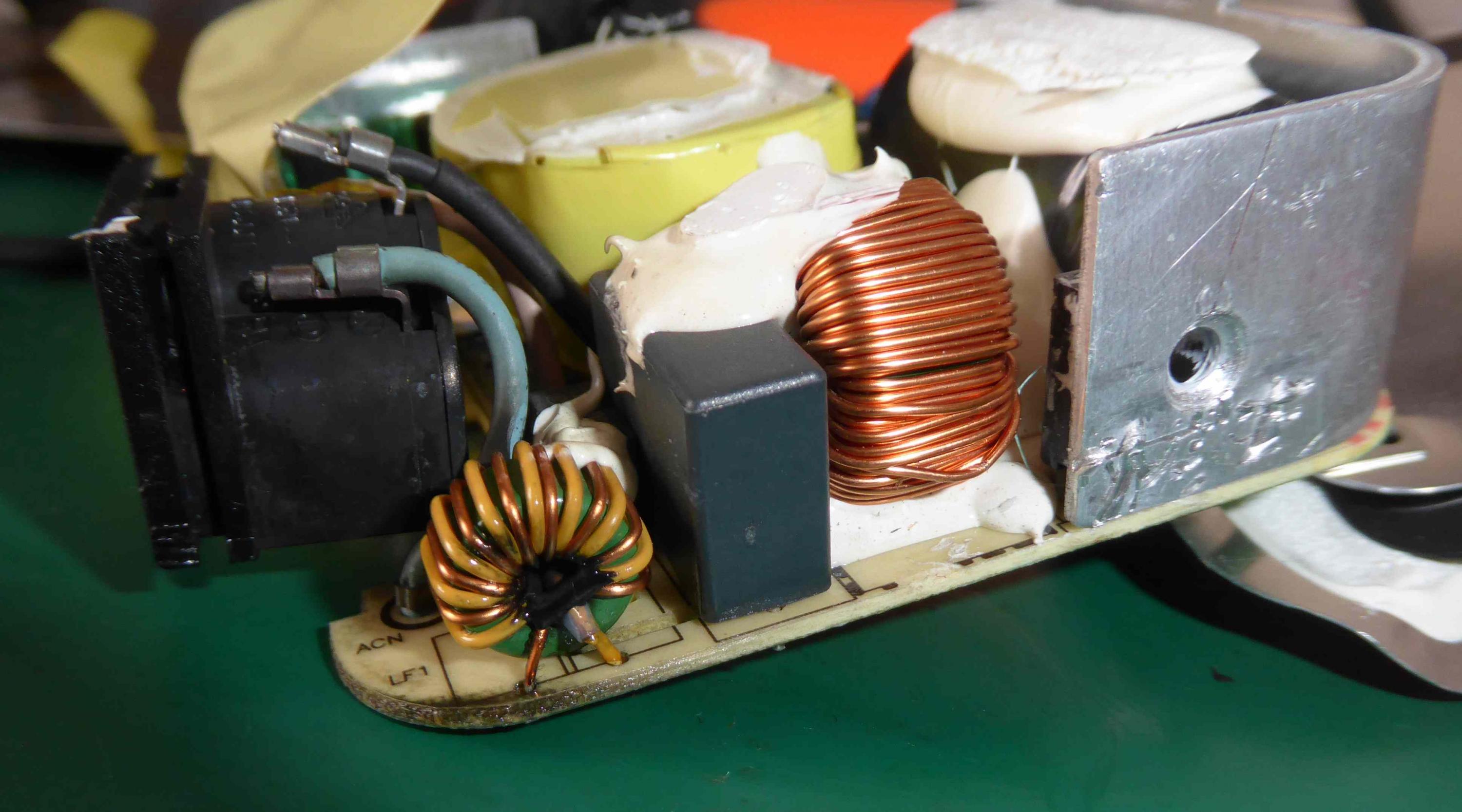

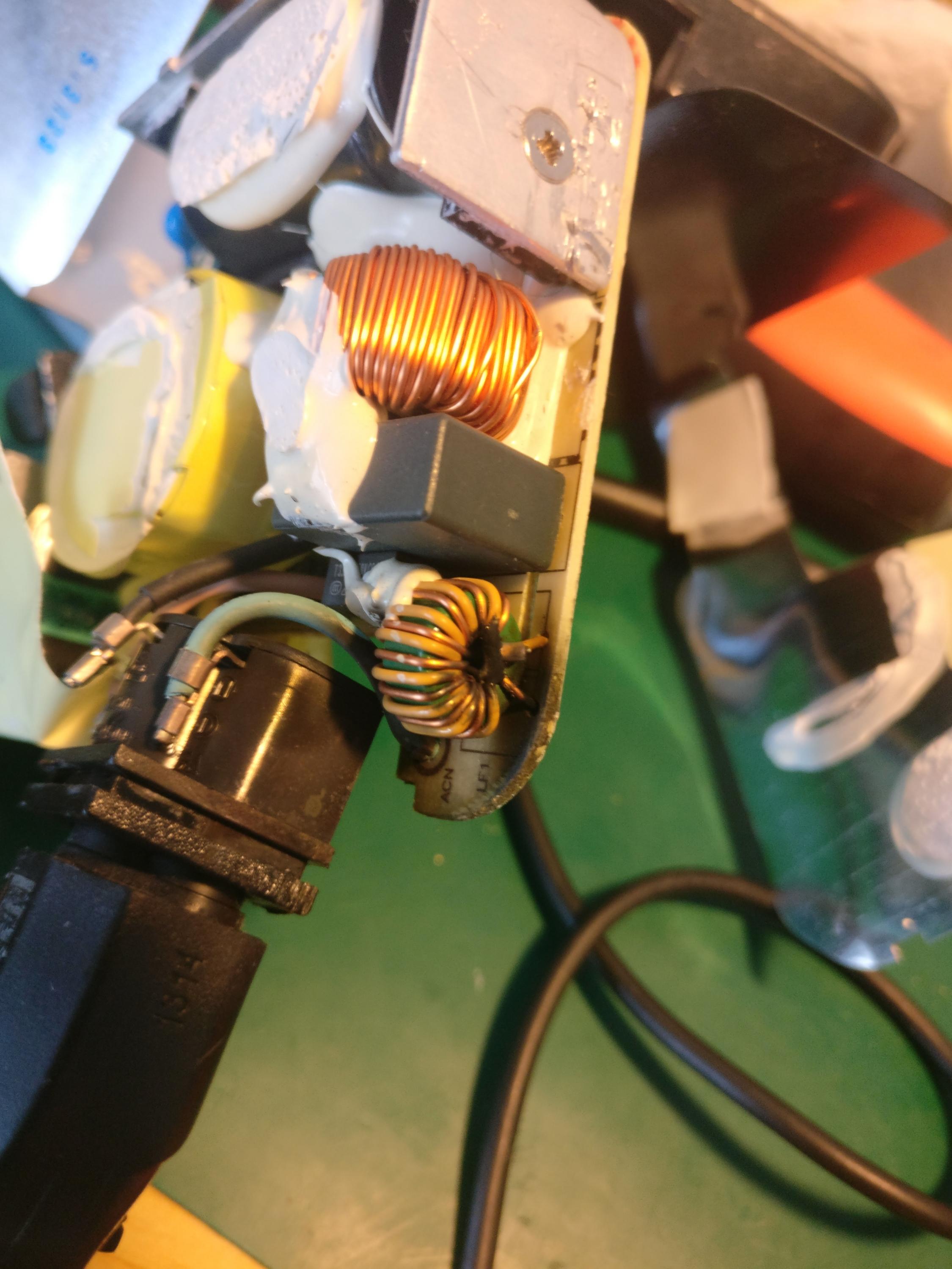

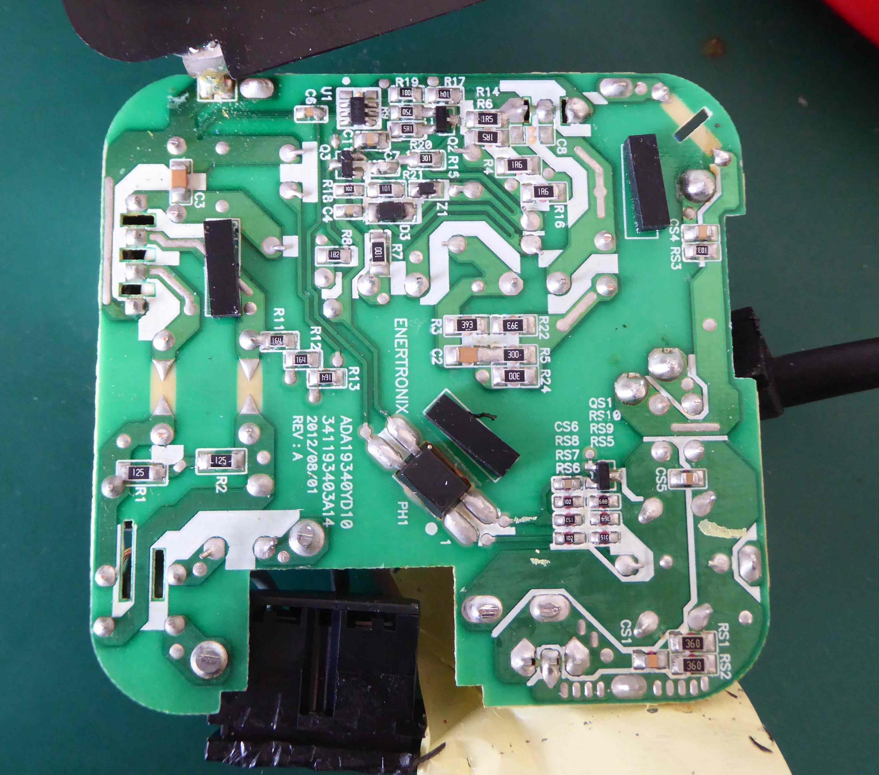

    This charger is not working, I saw that it is a bit burned around that component. ( looks like a coil)
    Any idea about how to fix this? Should I replace the component? Anyone knows exactly what it is? I don't have any reference.
    Any help would be appreciated.
    Thank you.

    It's a common mode choke, meant to reduce noise sent back through the power cable.
    Technically, the adapter could function perfectly fine without it.

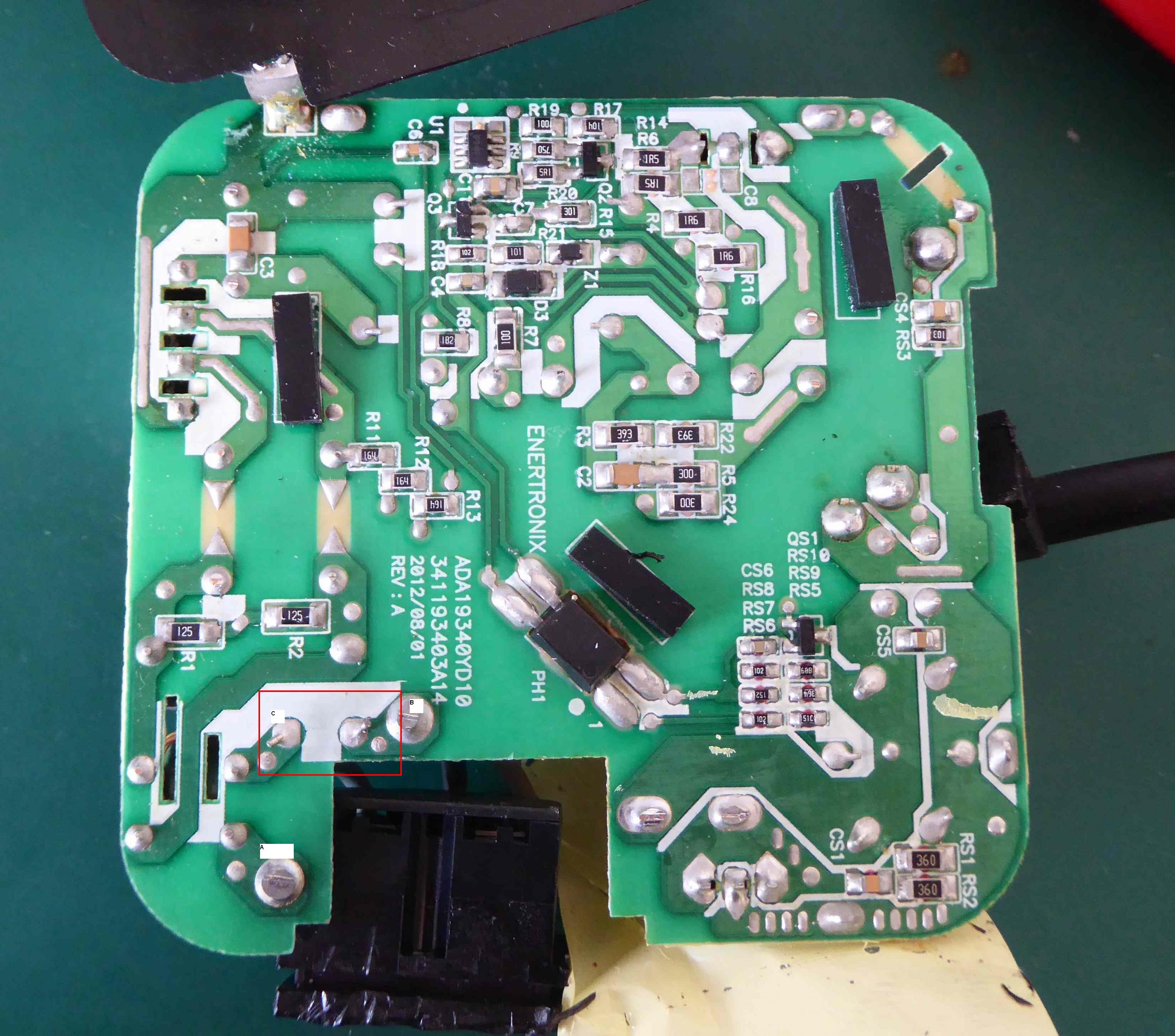

    Just look on the back of the circuit board, the AC wires go through that part and into that gray rectangular capacitor, so you just have to create connection directly to that capacitor by soldering two wires in the place of that part.
    Should be a wire between the two holes on the left side, one wire between the two holes on the right side, but double check by looking on the back of the circuit board.
    Anyway... if that inductor burned down (a broken wire on the inductor could explain why it's not working as AC isn't going further than the part) ... it could be that some other components are dead (shorted) further in the circuit, and that short circuit may have been the cause for the inductor breaking down.

      Please show us good clear pictures of the bottom side of the board, the burnt may be due to cold solder joints of the inductor legs to the traces.

        yea, looks like it just burned at the pin.

          Concur that it could be a bad solder joint. But as mariushm pointed out, there could be a problem farther on in the circuit that drew excessive current.

            I've seen them break off right at the top or shortly after the top of the PCB. If there is no replacement, take a winding or half a winding off that choke.
            It doesn't have to be a bad circuit component, that drew excessive power... it also could be due to vibration etc.

              Re: ASUS 90W Charger

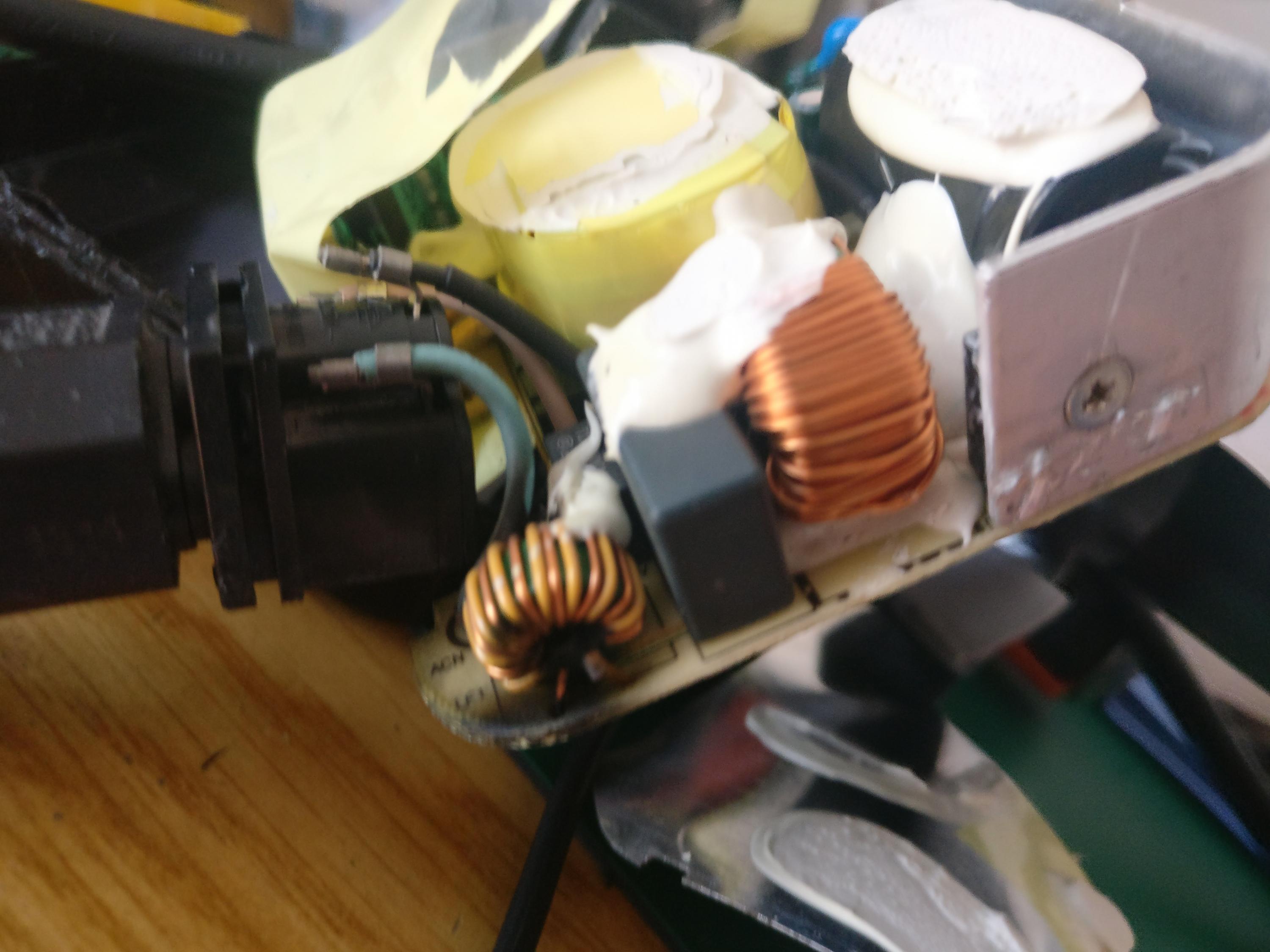

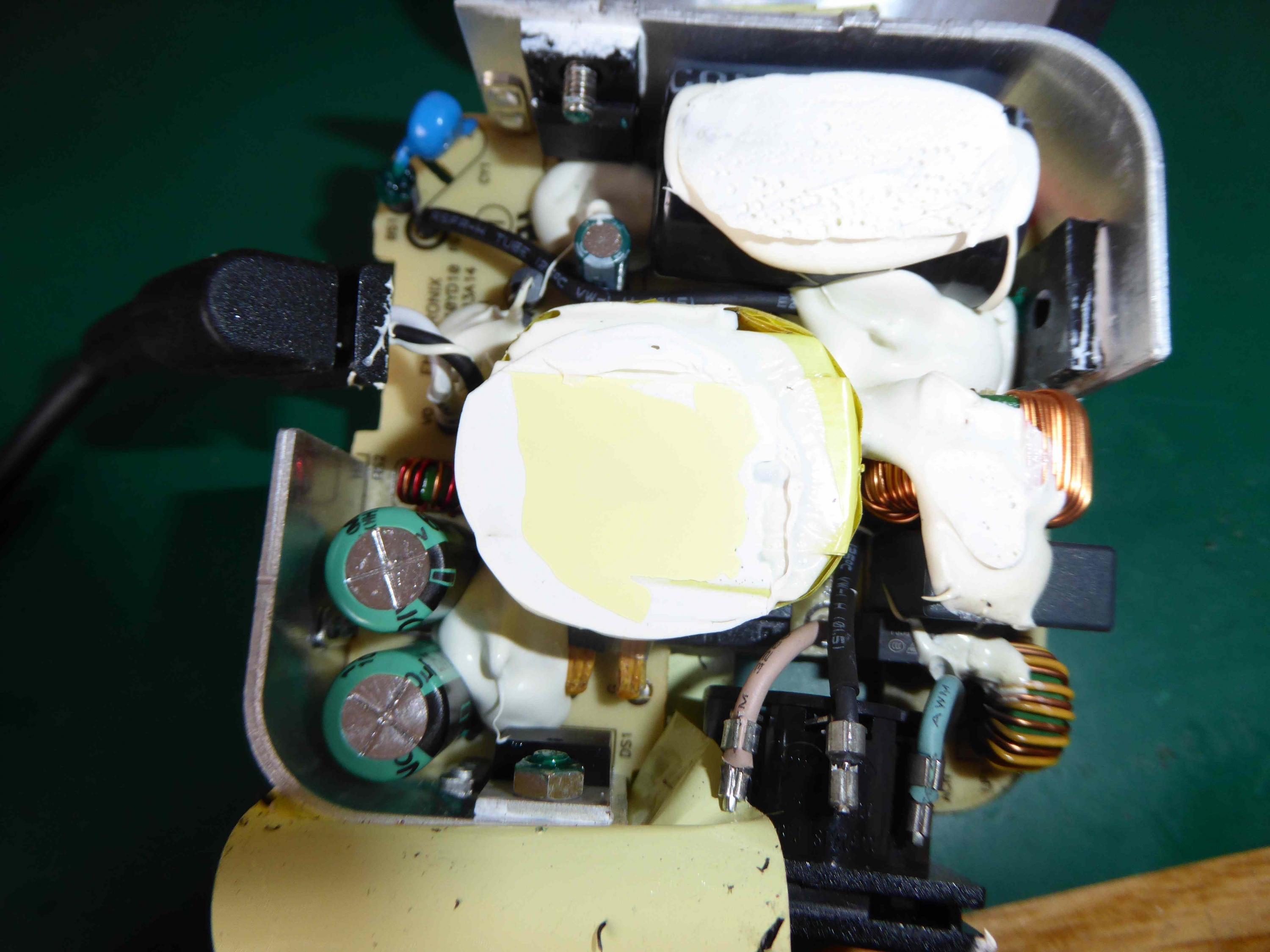

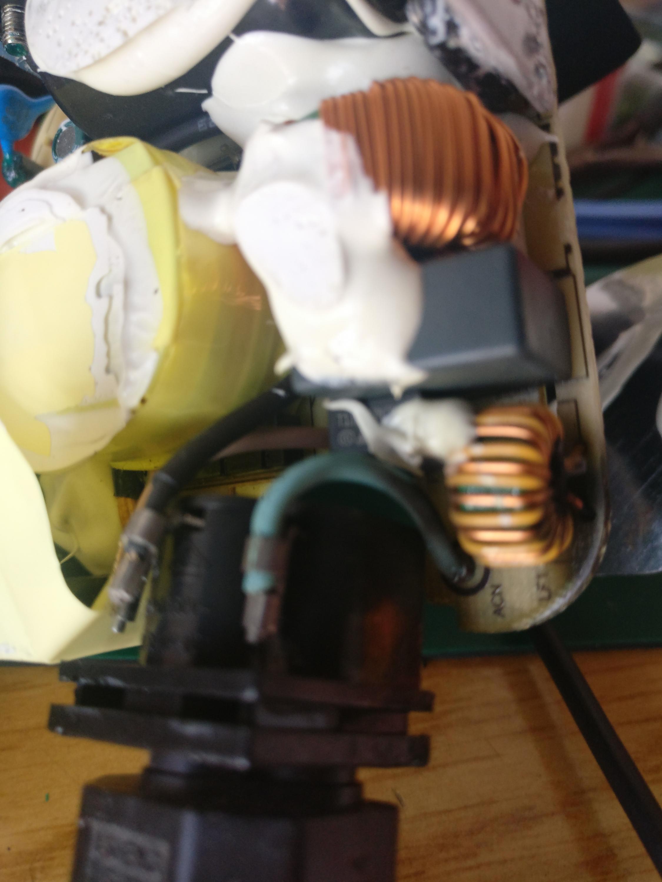

              Hi Guys, thank you for the replies
              Here're some better pictures.
              I've just try to re-solde the that burned component but nothing changed.
              Any ideia?

                remove the coil, clean the soot off and check it off-board.

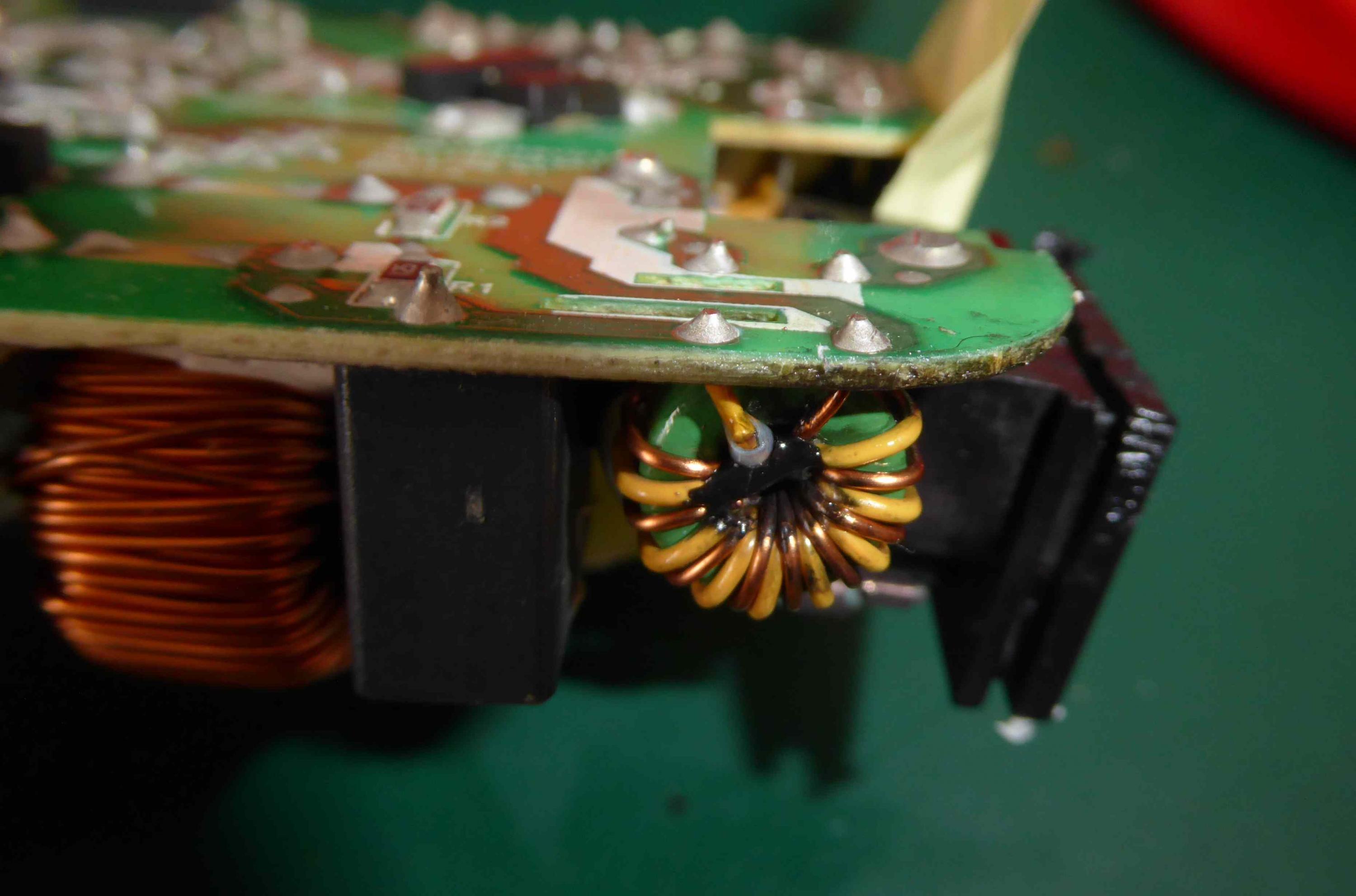

                  Will do, thanks.
                  How do I test the coil?
                  From 2 points of the coil I have 20MOhm resistance and the other 2 have no connectivity.
                  That's is probably the issue?
                  Should I just shunt those points?
                  BR,
                  Pedro

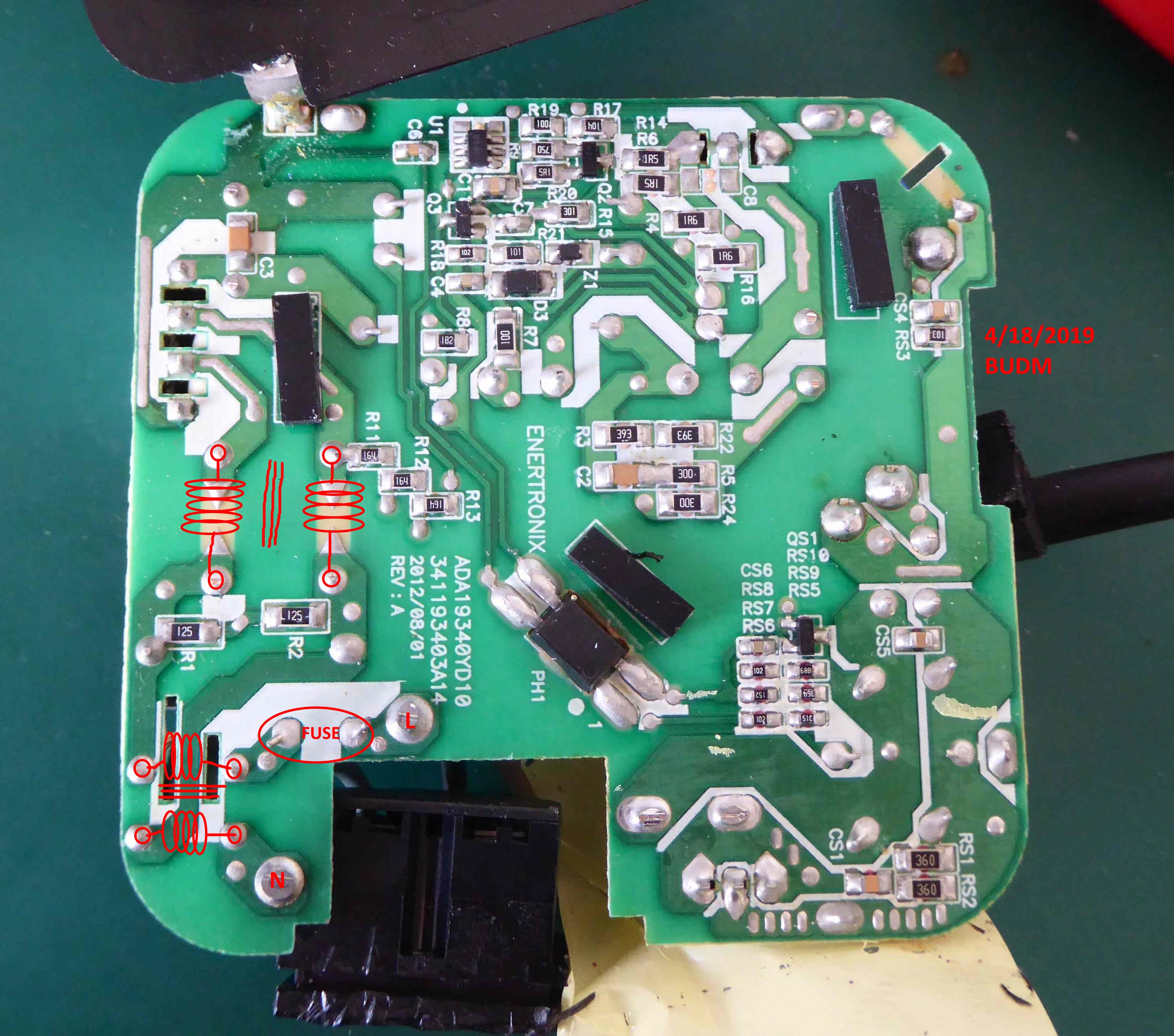

                    See picture of the pinout.

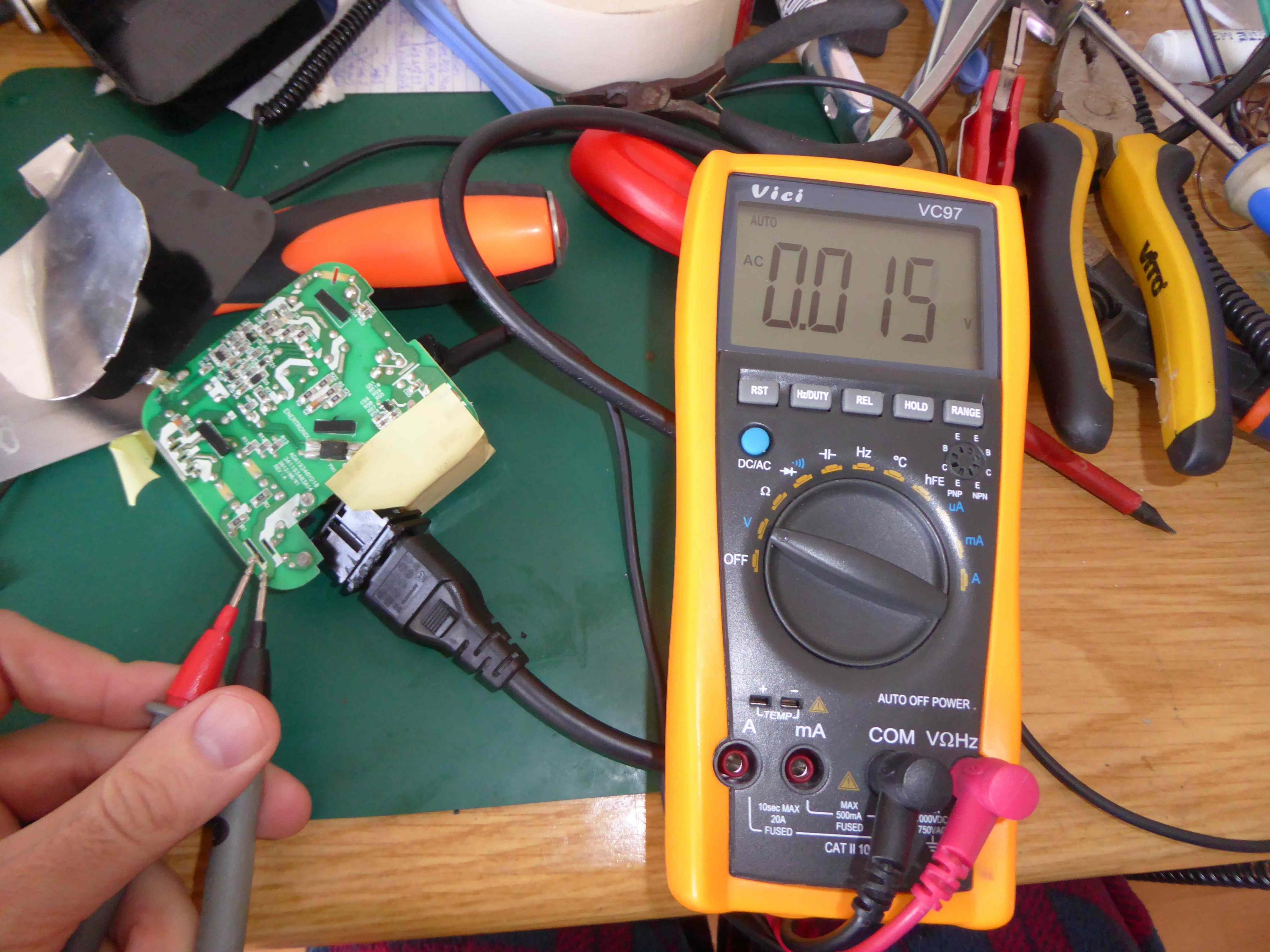

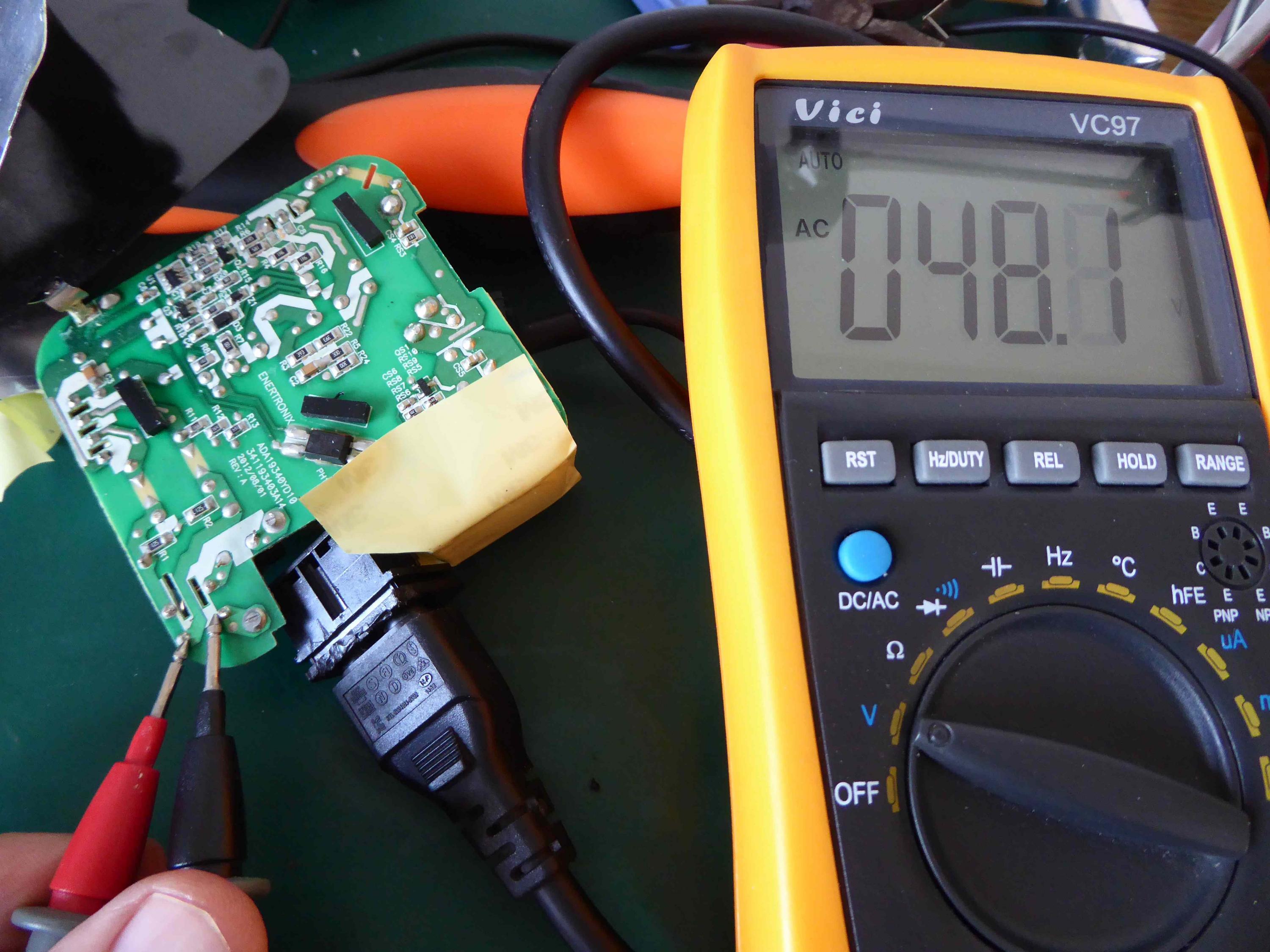

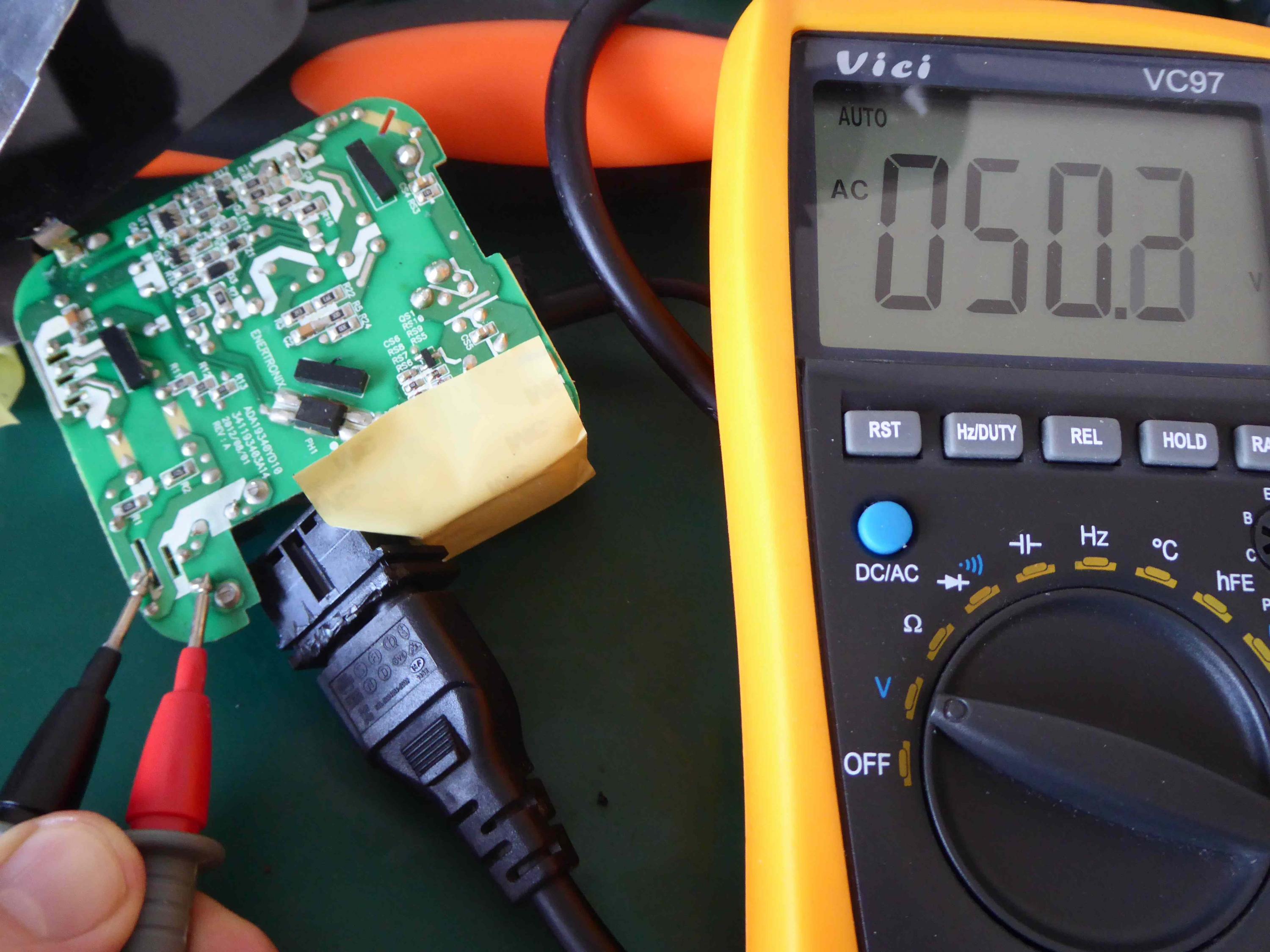

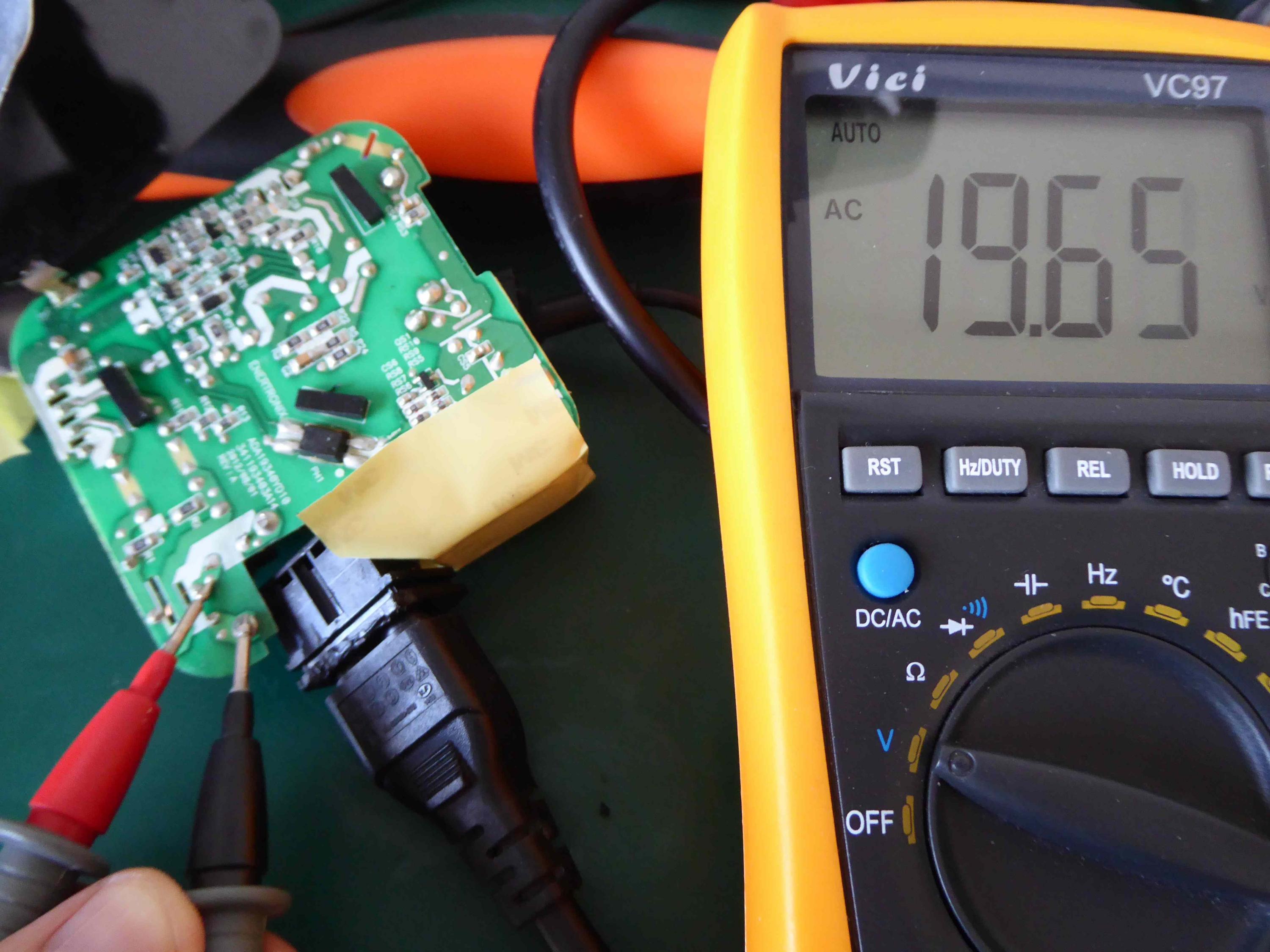

                      It looks like the fuse is open, Check the ac voltage between A and B then check between A and C, or check the resistance between B and C
                        I would expect OP to test the fuse already, common sense.
                        • eccerr0r
                          Solder Sloth
                          • Nov 2012
                          • 8716
                          This measurement looks suspicious:
                          https://www.badcaps.net/forum/attach...3&d=1555586153
                          That should be shorted together as a common mode choke, meaning it should be 0 volts across the two? Would imply the coil broke but I still can't believe coils break like that...
                          Agreed, probably could assume fuse was tested, but good to cover all bases.
                          In any case likely there's downstream issues unless it just so happens the coil broke... again, this is tough to believe but stranger things have happened.
