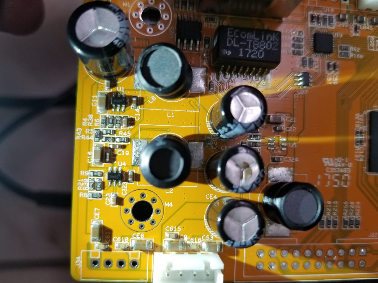

    Good Day,
    I was recently presented with a inexpensive DVR that had a short in its power supply. After searching I was able to isolate the issue to the 5v rail, specifically a 6pin IC with the markings DDAAC. It seems to be some form of power ic or a buck converter or sorts.
    I have been searching but cant seem to find a way to identify these ICs, could you point me in the right direction please. Attached to this post is an image showing a similar circuit on the board that is unaffected.
    Thanks in advance.

    Re: Help identifying power ic?
    I can't see anything but an [X]
      Either img tags are not working, or vBulletin is not recognizing the imgur page as an image, https://imgur.com/a/2oQ3LXE .
      I can't see clearly any IC such as berthfield described, but there is an electrolytic cap in the pic that clearly is swollen and vented.
        U4 looks like a sot23-6 LDO, Maybe post the model number, maybe there is a schematic around
            I changed that cap after taking the picture. The IC turned out to be a LDO as suggested but after searching for a few hours I was unable to find any replacements locally. The only markings on it were DDAAC not sure what that was supposed to signify.
            Edit: Forgot to mention that in the interest of time I removed the offending component and just went with a 7805 mounted to the side for 5v supply. There aren't many SMD suppliers locally and I was not willing to wait.
            Thanks all for your help.
              working on the same board at the moment.
              where U5 is fried no voltage for the mouse is the only issue.
              I am suspecting its the same as U4 at the moment can't tell as the top has been burnt off.
