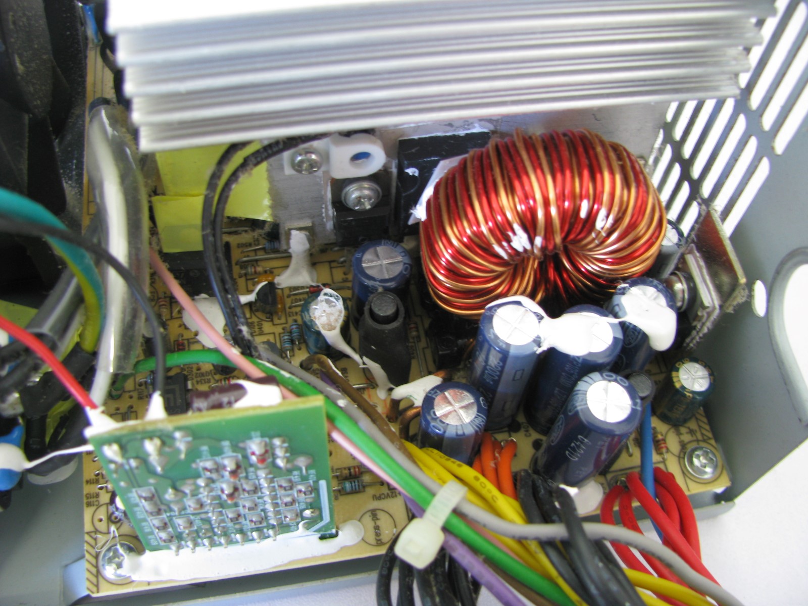

        Originally posted by Pentium4

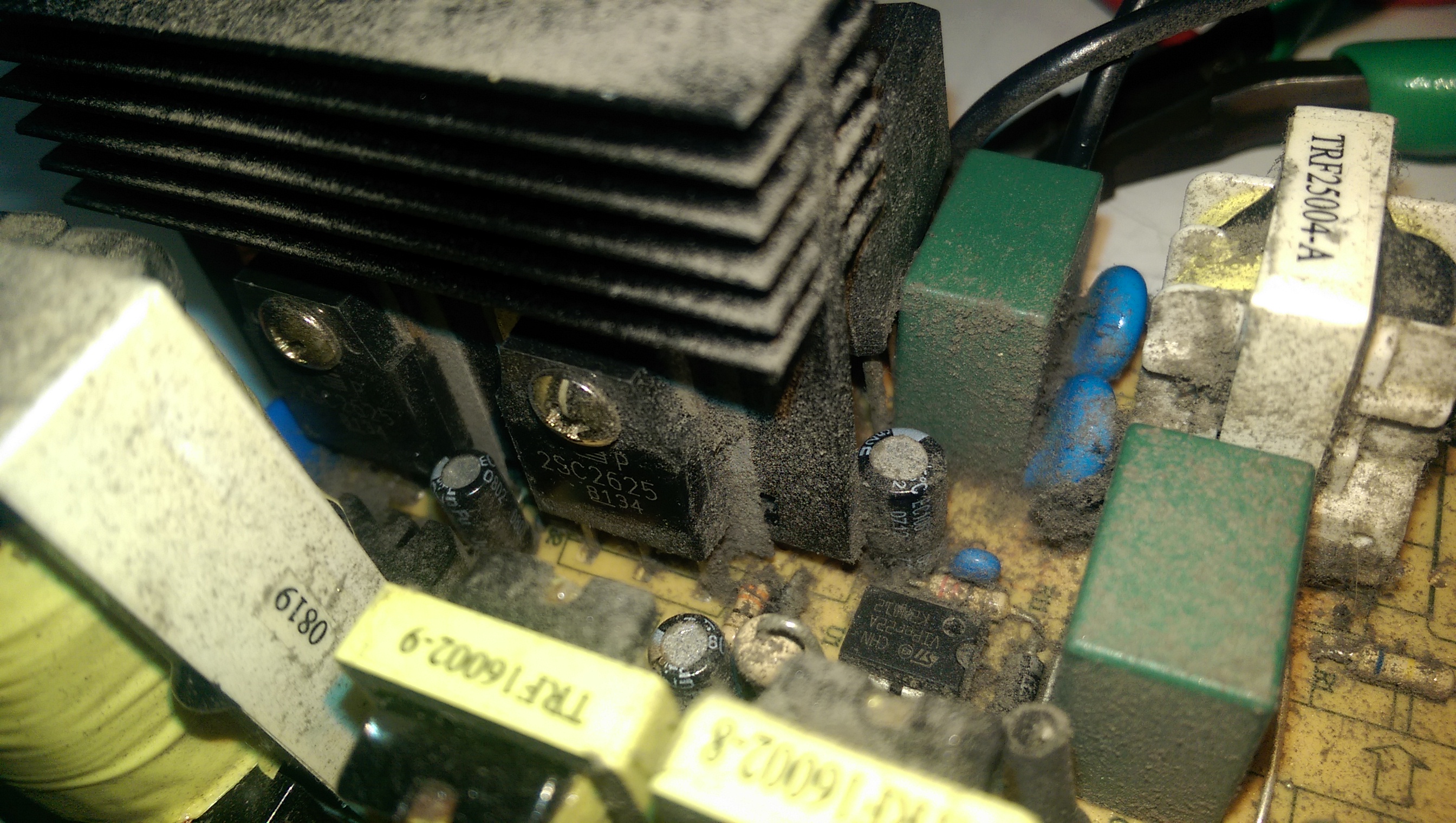

        c_hegge will love this one. Found this beauty in the garbage. 5VSB only gave 4.11V. The person who put it in the garbage was verbally scolded by yours truly What a well built unit. Too bad the glue person at the factory went buck wild on this thing, most of it is still white though. The caps that went bad are Ltec LZG and LTG (The brown one) The Taicon on the 12V appear to be fine. This thing did get over 6 years of 24/7 use, and I don't think a single top mounted 92mm fan is adequate enough for this PSU, so the Ltec did good. There are some CapXon in there too, they might be out of spec. The bulk ones are good sized at least. The switchers are two W9NK90Z rated at 9A. Seems plenty for 460W although I'm not a fan of that heatsink, especially with how slow the fan spins. The fan is a death Adda but it still spins very well even though it's pretty dry. It has two bridge rectifiers that share a heatsink, and each is rated for 8A. It has a nice input filter, with huge MOV's. Is there any benefit to having two NTC thermistors in parallel? They're both SCK 058. There's actually three 12V rails with OCP. Rail A is for CPU, Rail B is for mainboard connector + peripheral. Rail C is for the PCI-E connector. They all share two MBR20H100CT's. 5V uses two 20A schottky's as well. 3.3V uses one 20A schottky. 5VSB and -12V both have rectifiers on the secondary heatsink as well. 2A for 5VSB and 1.5A for -12V. Soldering looks excellent, oh yeah, cause it's Delta! Also love the mostly 16AWG wiring. Gonna recap it.
        That's a great looking PSU! And yes, you should really let people know what a mistake it is to toss a Delta PSU like that
        As far as I know, that white glue doesn't have issues at all, and is perfectly safe to use. It's only that brown glue that is a problem. Fix up the caps on it and it should be a nice reliable PSU.
          +1
          That white glue is, I believe, proper electronics-safe silicone glue. Delta has been using it for a while.
          Nice PSU indeed. In addition to yelling at whoever threw out this PSU, you should also them.
          I hate it when Bestec does the same thing (drowning everything) with that crappy tan conductive glue, though.

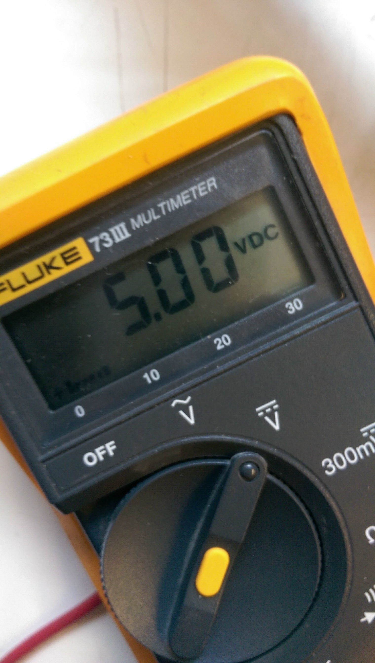

                The Delta came back up at exactly 5.00V on the 5VSB The 2200uF 16V Taicon PW on the 12V were perfectly in spec.

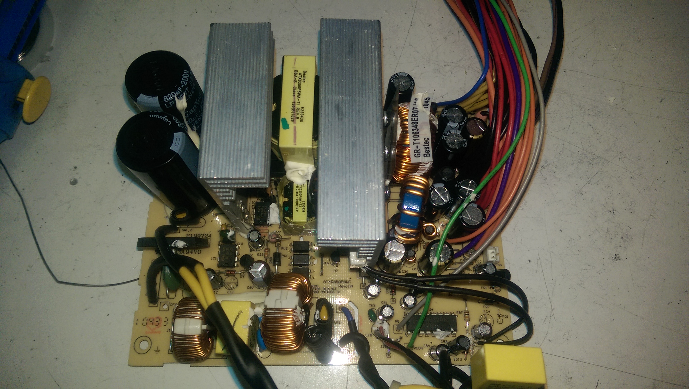

                  #1968

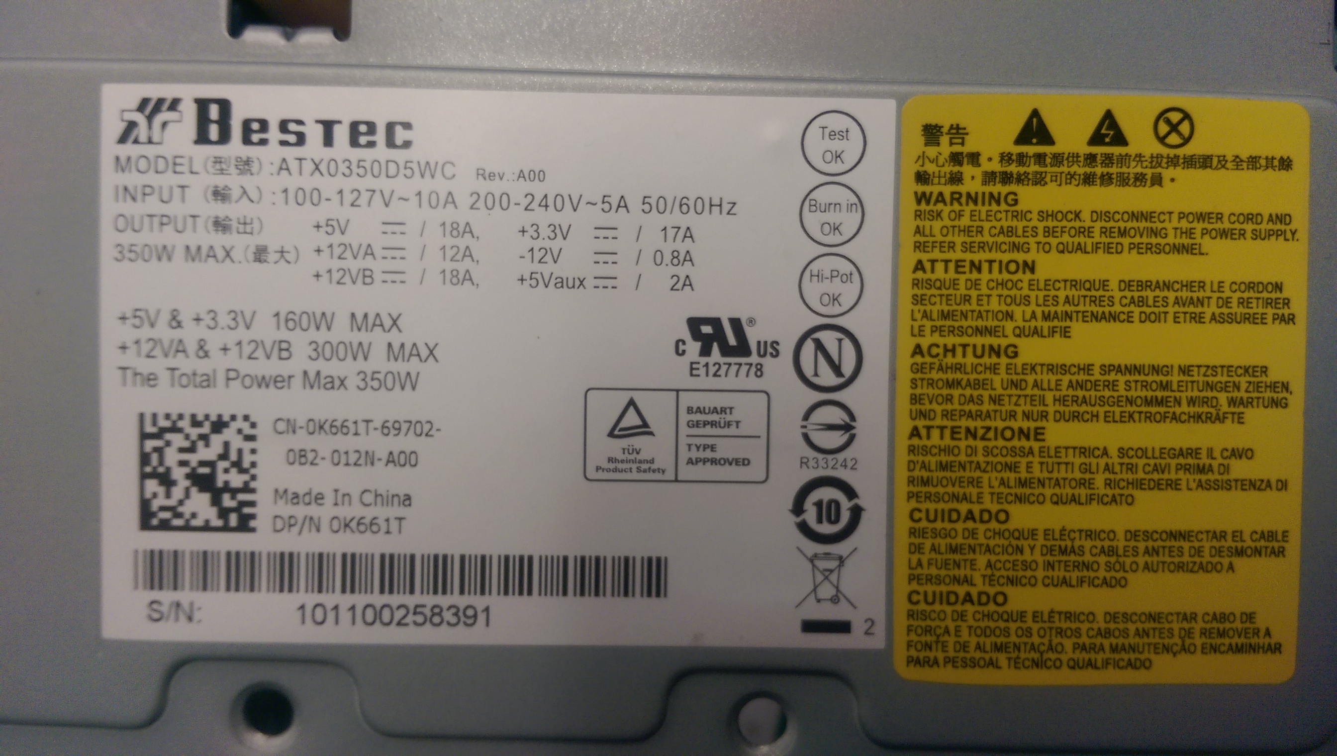

                  Here's a pretty new-ish Bestec that I recapped. 100% CapXon in there originally. But the bright side, no fucking 0.1uF lytics! I know it's a low value but I still don't trust them when they're cheap brands, and I can't really measure them. The CapXon KF read high capacitance out of spec on the 5VSB, 5V, and 3.3V but the 12V ones were fine I really like that there's 4 filtering caps for both 12V rails (Which uses two 20A schottky's). Originally 4 CapXon KF 2200uF 16V. Replaced with 3 Samxon RS 3300uF 16V and 1000uF 16V Panasonic FM for the cap adjacent to the CPU power wires. The 820uF bulk caps read 816uF and 813uF. Redid a few soldering joints, such as that one on the bridge rectifier which is pretty poor if you ask me. Nice PSU overall though!

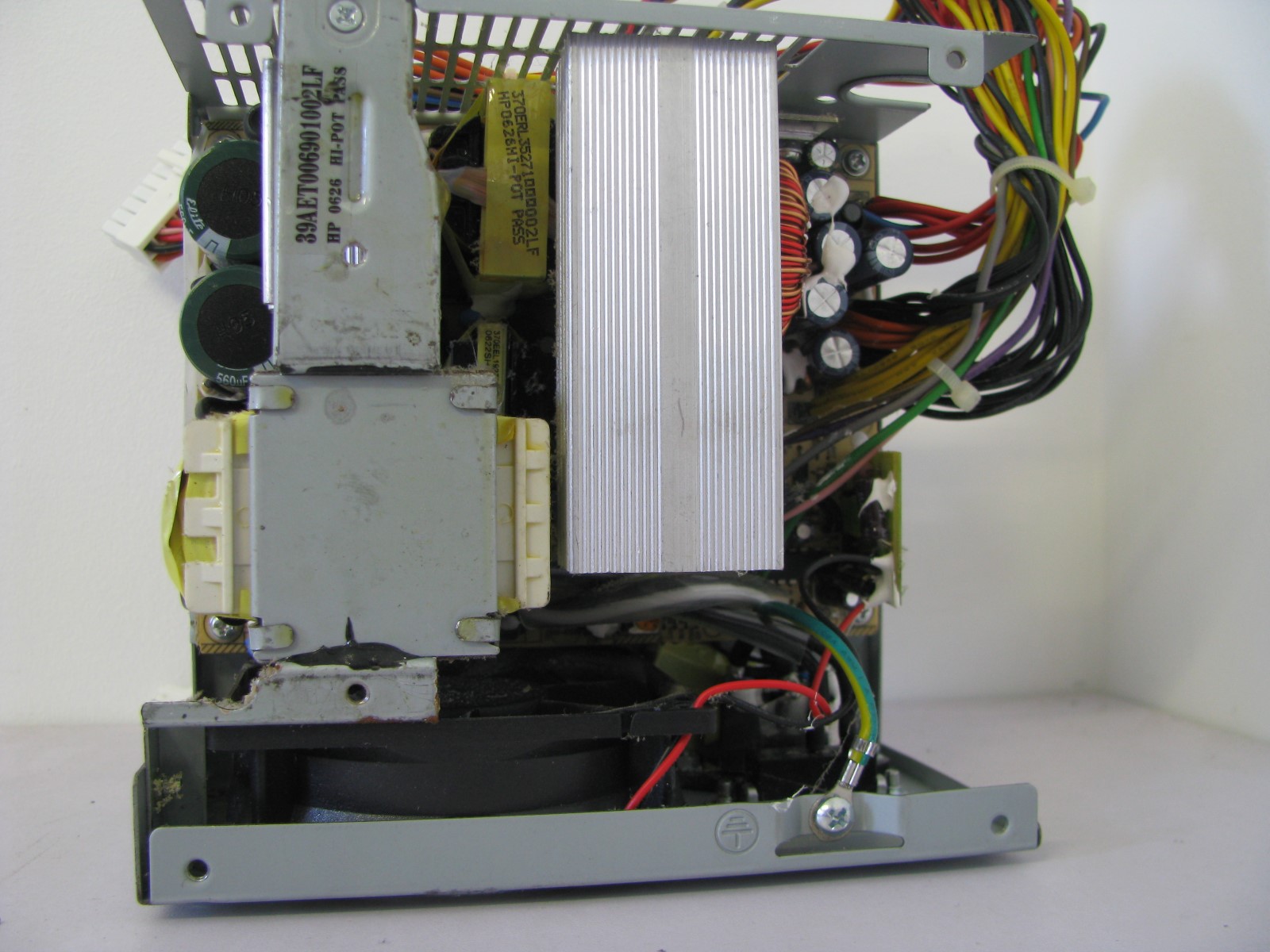

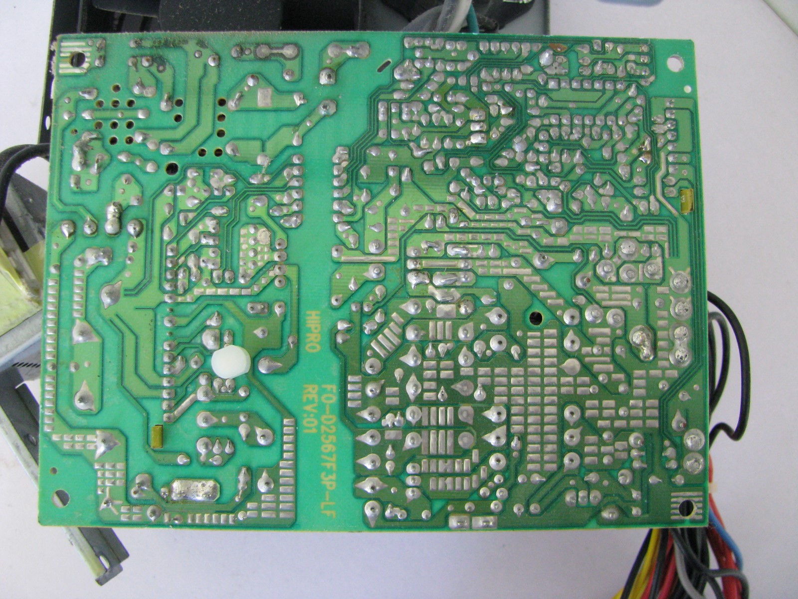

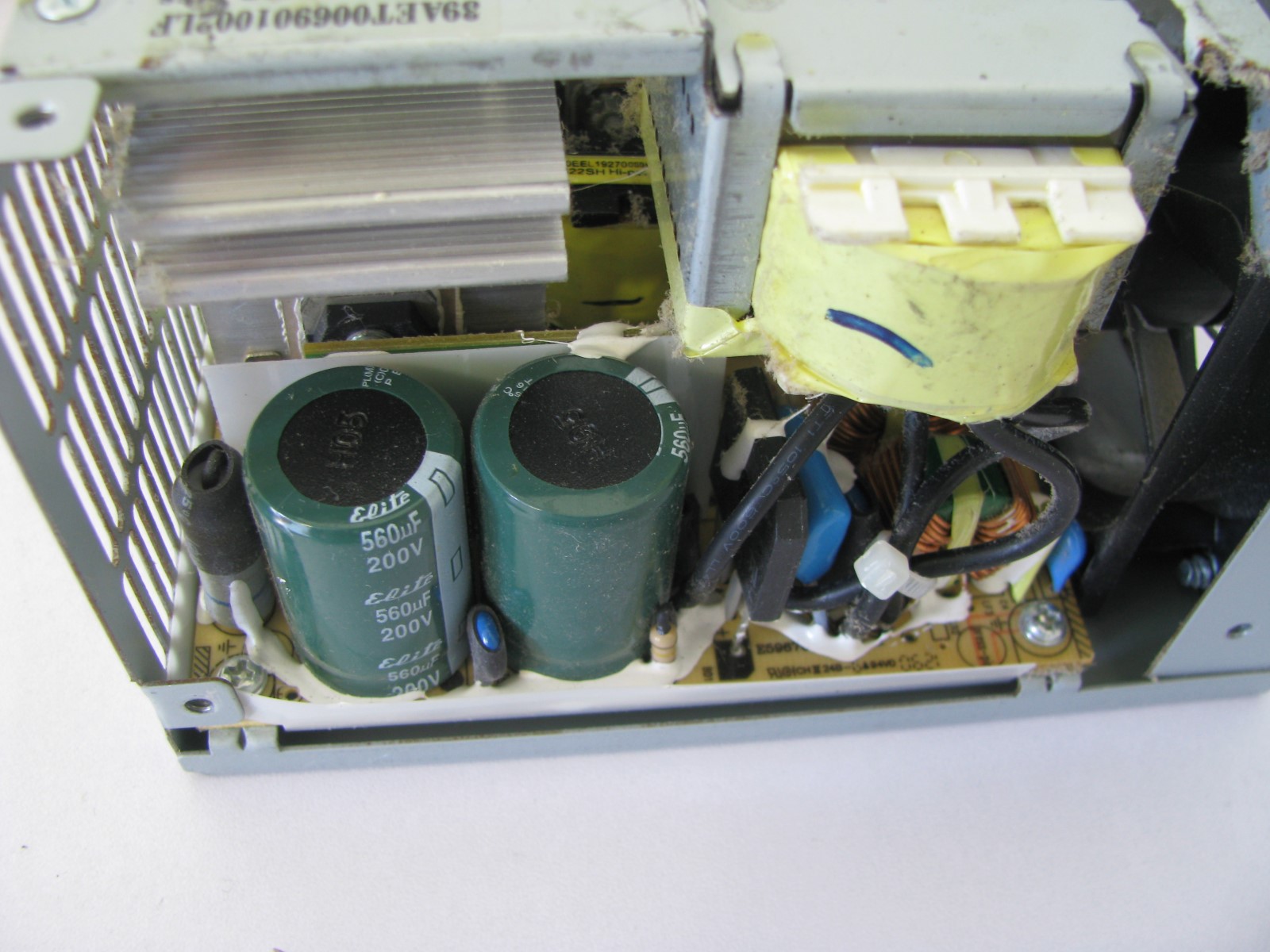

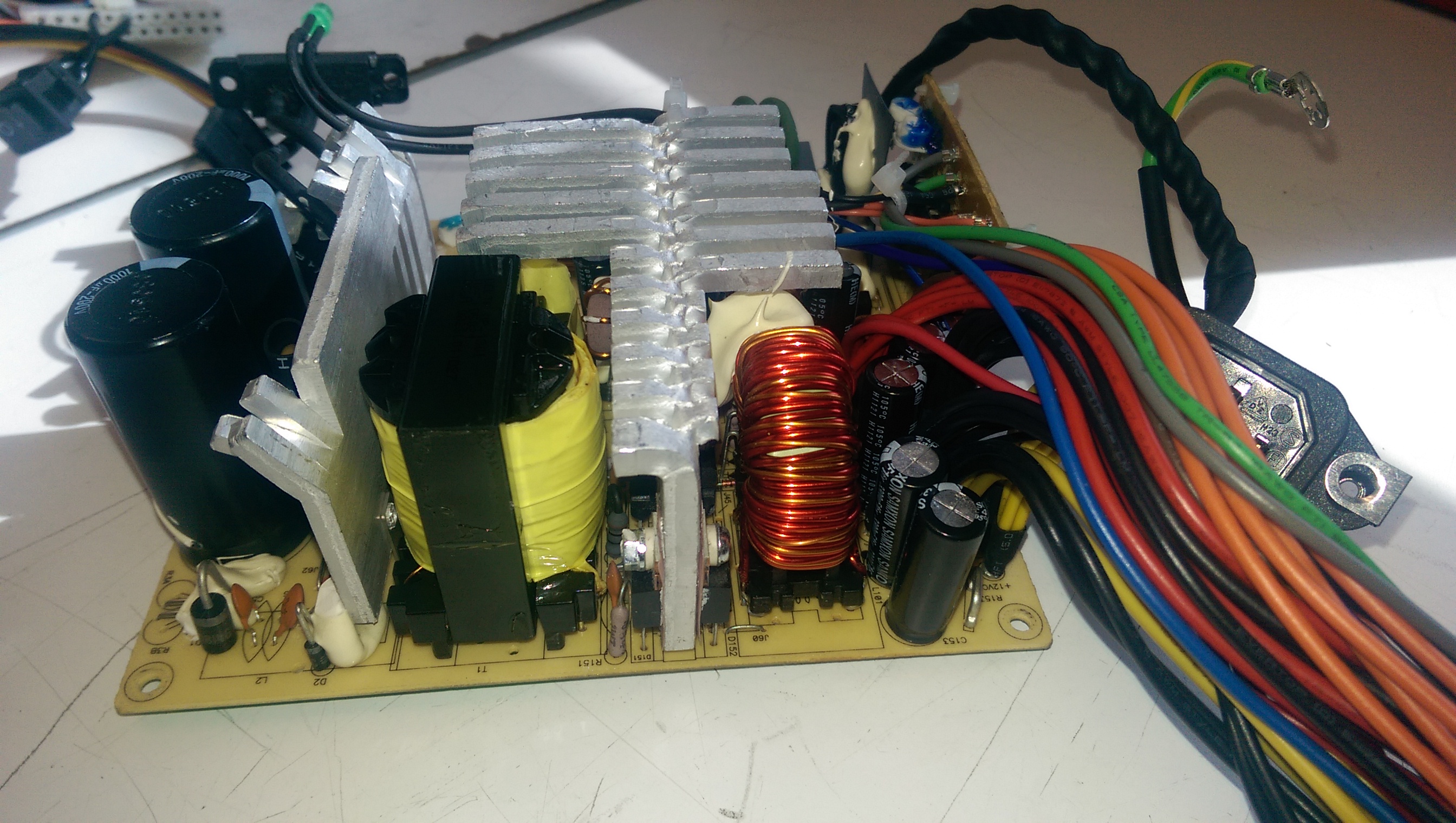

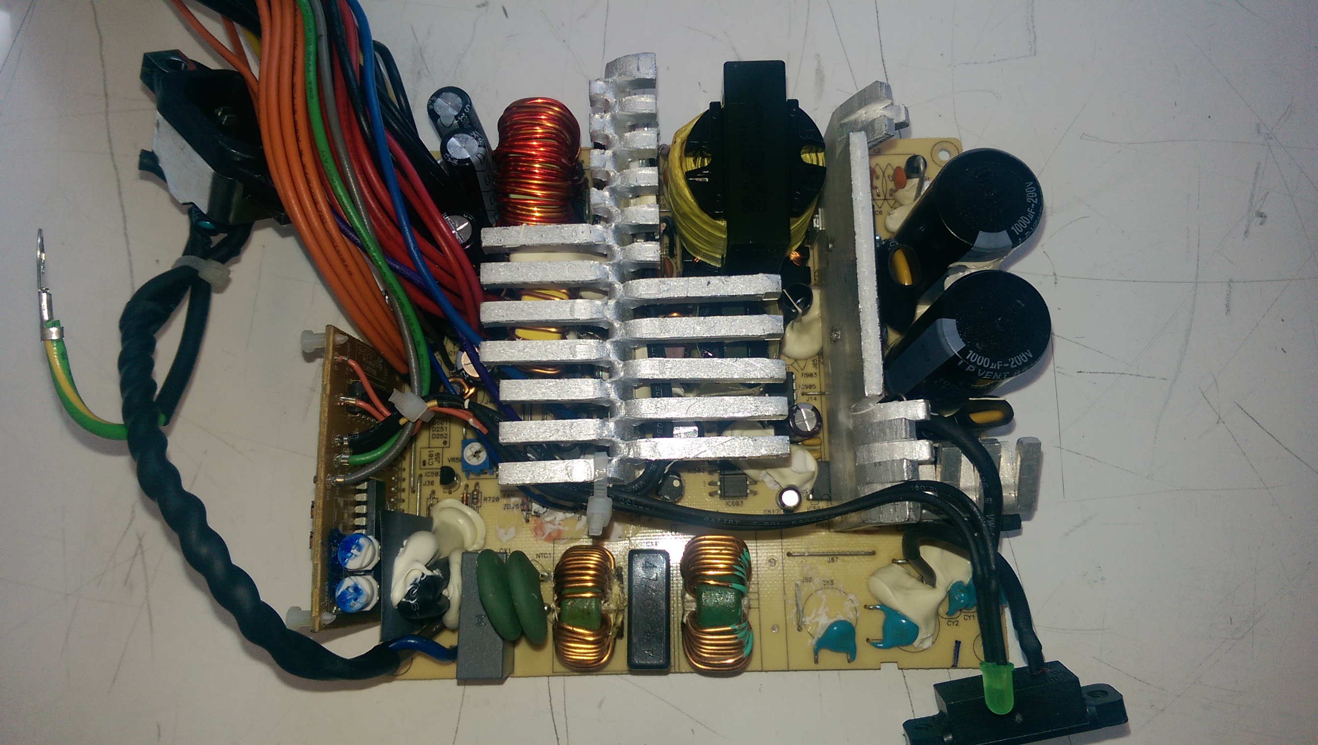

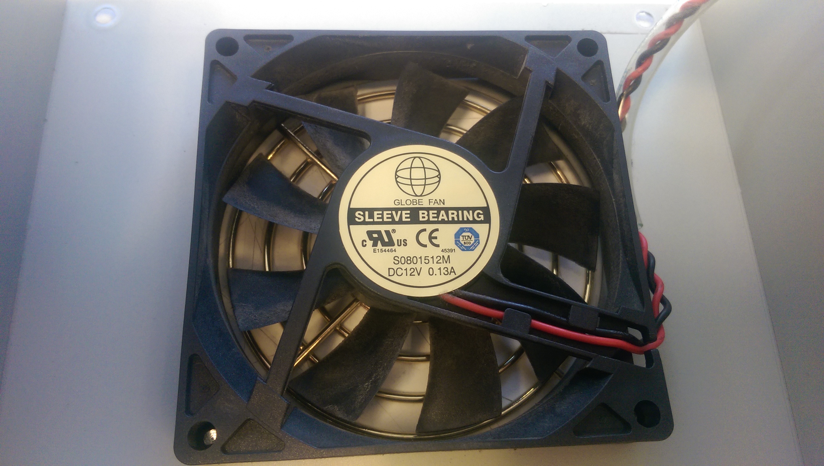

                    HP/Hipro D2567F3P. Being a Hipro, I'm expecting a decent unit, of course.
                    Two 12V rails, with 18A total 12V capacity. Not too bad, at least for a lower powered PC
                    Let's adda fan shot to this post
                    Nice beefy secondary heatsink there. Not that we expect any less from Hipro, though.
                    We have PPFC, and 560uF primary caps. Good enough for a 250 Watter if you ask me. I can't tell what the switcher is, though.
                    Secondary caps are mostly LTEC, with the exception of a couple of teapos. I'm not sure what the silicon is there, as I would have to remove the secondary heatsink to figure it out. The 3.3V rail does use linear DC-DC conversion from the 5V, though. I guess that's why we need such a chunky heatsink.
                    It may not be immediately obvious from that picture, but that Teapo cap on the 5vsb there is bulging.
                    The soldering is pretty good, as we would expect from Hipro.
                    This one looks like it should definitely be a keeper after a recap.

                      #1970
                      It's because the higher voltage prolongs the electrolytic dissolution or at least rebuilds or keeps the oxide layer from thinning faster than lower voltages do. Not that CapXon wouldn't eventually fail anyway....
                      Look at how much airflow that passive PFC blocks to the primary heatsink. Guess it doesn't matter in a PSU this overbuilt. The main switcher looks to be in TO-3PN so it should be good for 300W-350W.
                      As I recall, the 300W Hipro you reviewed that used the magamp circuit for +3.3V had the same heatsink so I don't think that is why. And the +3.3V rail in this unit actually has its own transformer tap, hence its own rectifier and its own winding in the main toroid and its own set of filtering capacitors before and after the regulator.
                      Probably because the one before the coil failed so that poor 8mm Teapo had to handle all that ripple....

                        #1971
                        Yeah, I know, but I loaded it up to 250W on the tester, and the secondary heatsink still got much hotter. The primary heatsink was still cool enough to touch comfortably.
                        Yeah, I know. It was more of a payout on how inefficient linear regulation is
                        The 5vsb ripple was only 25mV with 2A load, in spite of the bad cap. So, on the contrary, the Teapo is probably the only one that failed and the cap before it on the other side of the heatsink is now doing all of the work. If the other cap had also failed, the ripple would be way out of spec. It's not in a hot zone either - there are no load resistors or anything next to it. I think it failed just because it's a junk Teapo.

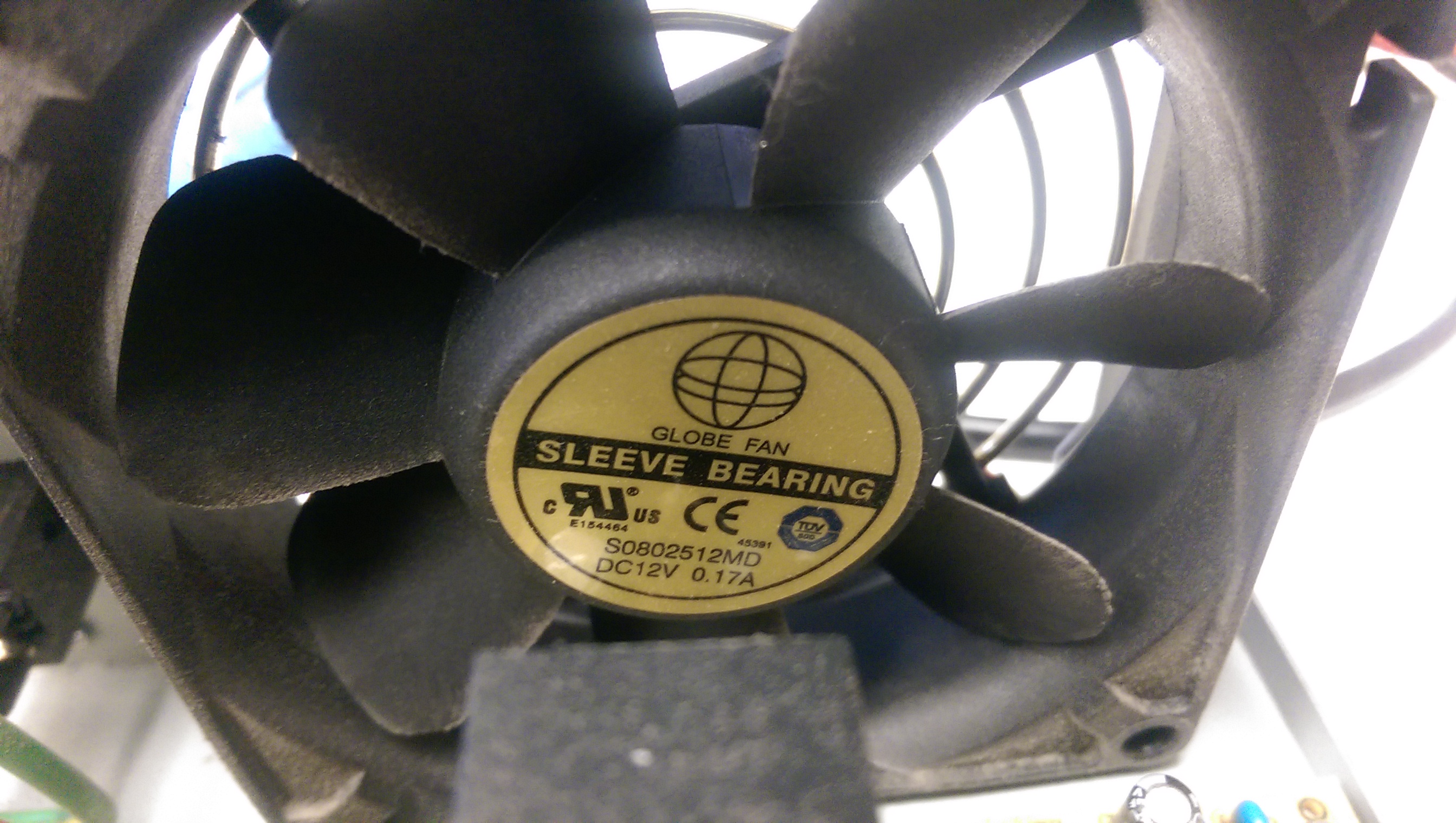

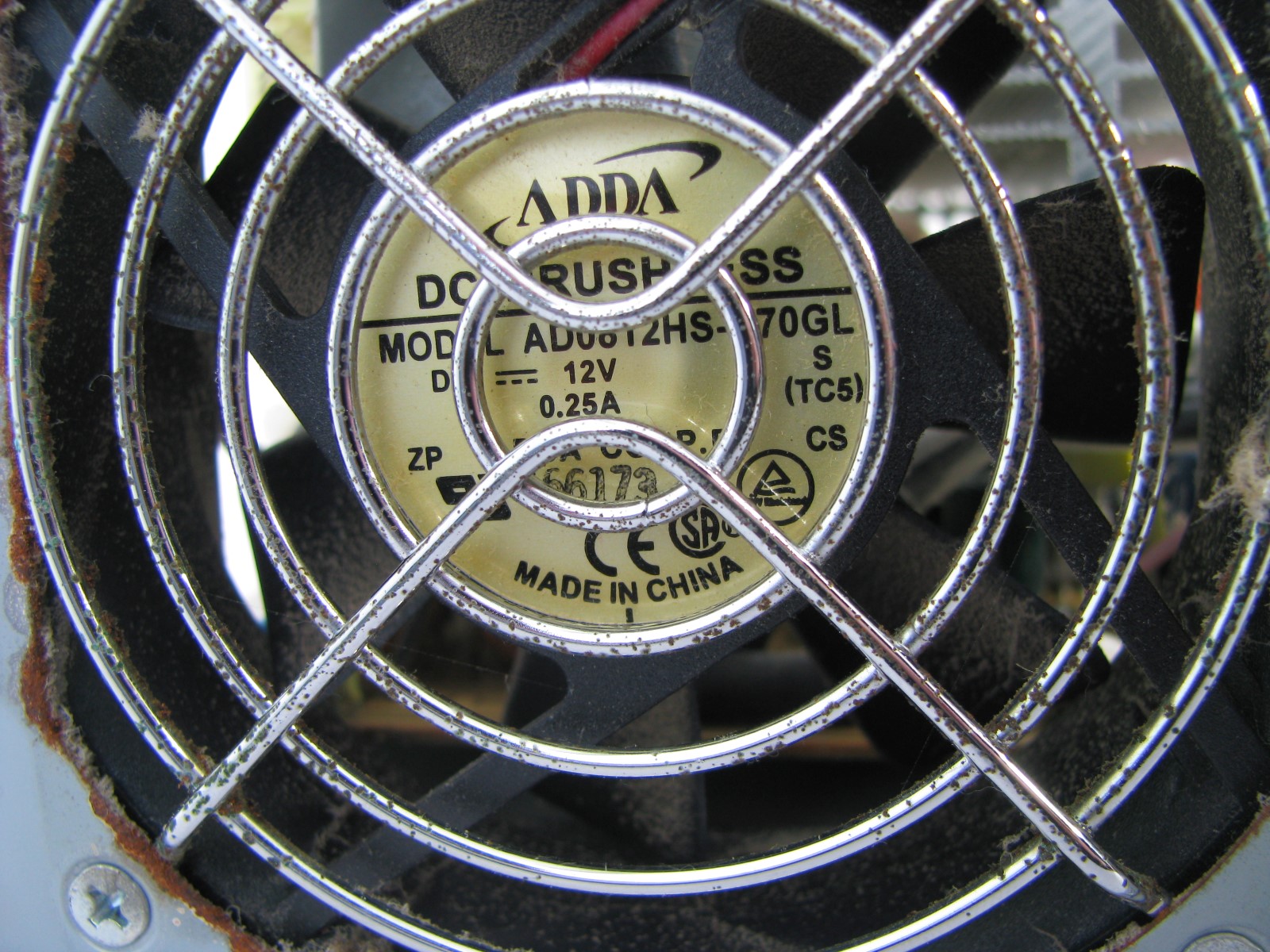

                          How well is the ADDA fan working? Yes, though, it could easily be the fact that it's an 8mm Teapo. I think a 10mm Teapo would have survived, though... it would be interesting to see how high the ripple would be with only 2A on the +5VSB without the fan spinning (standby mode only). I thought that the flyback topology puts quite a bit more ripple current through the capacitors without the aid of the magamp.

                            #1973
                            I don't think the PFC coil is blocking anything in there. On the contrary, it is in the air to cool itself. I have just reviewed a Thermaltake Litepower 400 PP (W0161) based on 300-350W Delta board. The PFC coil was clearly the hottest part inside, outcoming air from (by the outtake grill) peaked at temperature over 50 °C.
                            • Pentium4
                              CapXon Be Gone
                              • Sep 2011
                              • 3741
                              #1974
                              Wow, nice unit. 560uF bulk capacitance is huge for 250W! I also don't think the PPFC coil will cause too many issues, since it's a "low wattage" PSU. Once you recap it, it won't really matter too much how good the airflow is. If these can last up to 5 or 6 years with low quality caps, good caps in there will probably be good till ATX is no longer the default form factor

                                560uF is ok for 300 peak watts depending on the design! This psu is an ordinary example of Hipro build quality.
                                I am disappointed with the bulging Teapo...

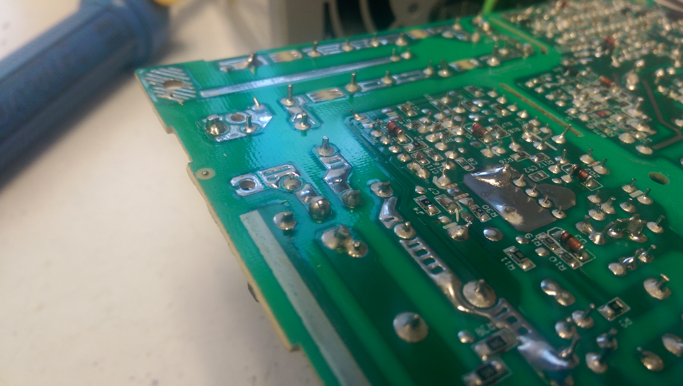

                                  Here's another Topower, that actually says Topower on it. It was locking up the system, and the top fan was grinding very loudly. 23,958 running hours on it powering an X-ray machine at a vet clinic, the system was Core 2 Duo with mostly low power components and the special X-ray PCI cards. All the caps looked good but I don't trust those Jun Fu. Turns out the caps on the 5VSB, 3.3V, and 5V failed without bulging. Can't really blame the one on the 3.3V after the coil, it was touching the 15Ω dummy resistor for the 3.3V (And you can see it changed the color of the glue). The one on the 12V was 215Ω, none on the 5V. All the caps are Jun Fool by the way. Hey at least it uses a Viper22A for 5VSB. Soldering looks pretty good for a Topower. Both Globe Fans were really dry.
