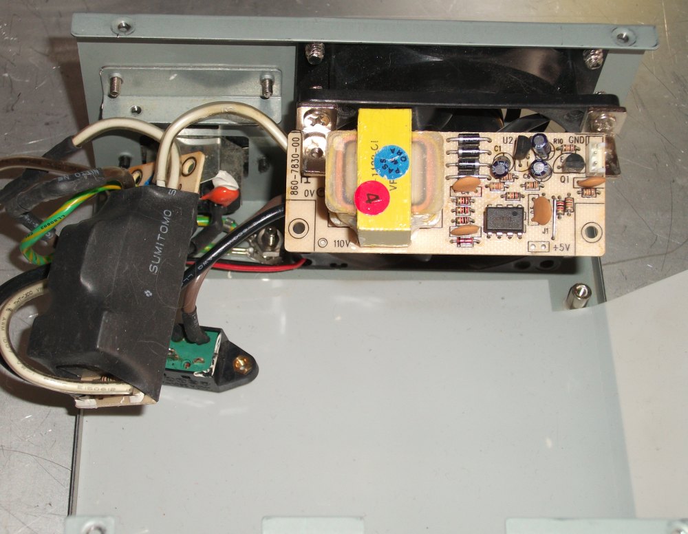

                                  #1756
                                  We've had to throw out a bunch of old PC component at work. I saved this HIPRO psu. It was in an AST server that was just collecting dust in the past 15 years. It has plety of peripheral connectors. It's an epic overbuilt unit compared to simple AT psus. Has some extra circuitry for standby power and other signal outputs also.
                                  Funny that capacitors range from Rubycon to Teapo, Crown and Jamicon...

                                    #1757
                                    In the final picture,why there are 2 P7 connectors?I see it's a AT PSU,but I don't really think a motherboard would require so much power.Also,300W and AT connectors,that's worth saving.BTW,what's that fan-style header for?I looked at picture 5 and it's connected to a board on the PSU,not to the fan itself.

                                      #1758
                                      The third connector is an extra 5 volt supply to the mobo (which wasn't in the tower case for a long time so we don't know the exact model). That green-black-black-red was going to the mobo too. A micro remote switch could turn on the psu similar to an ATX ps_on-gnd short.

                                        #1759
                                        That green "A" cap (the 2200uF one) looks ripe for blowing up.. doesn't appear to have a vent on the top!

                                          #1760
                                          Awww, man! I want that green cap! That would be awesome in a fire with no vent stamp.
