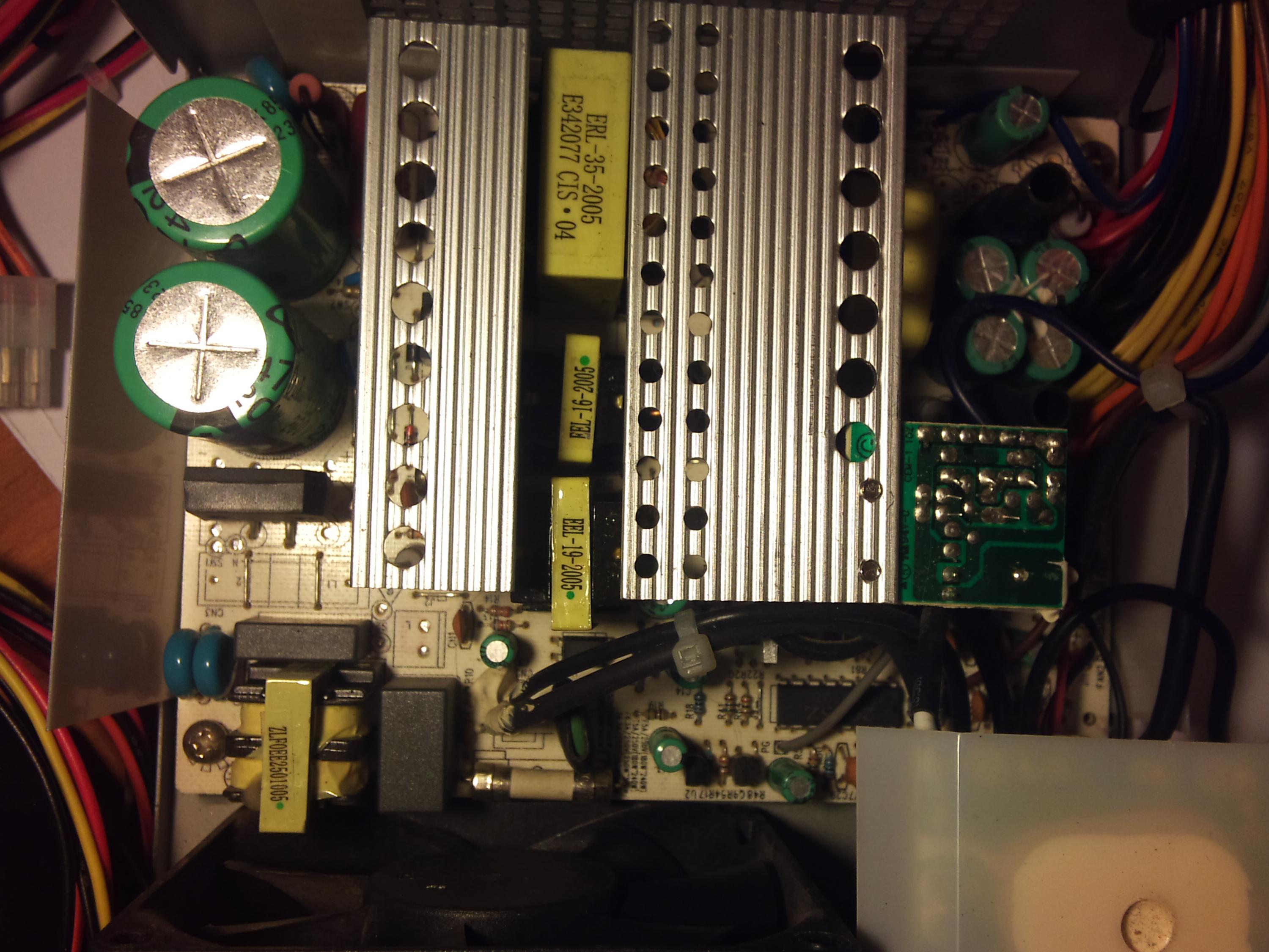

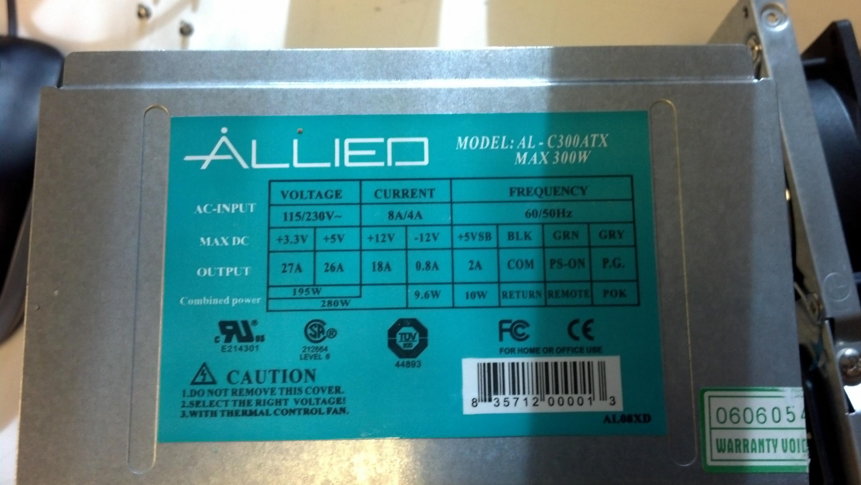

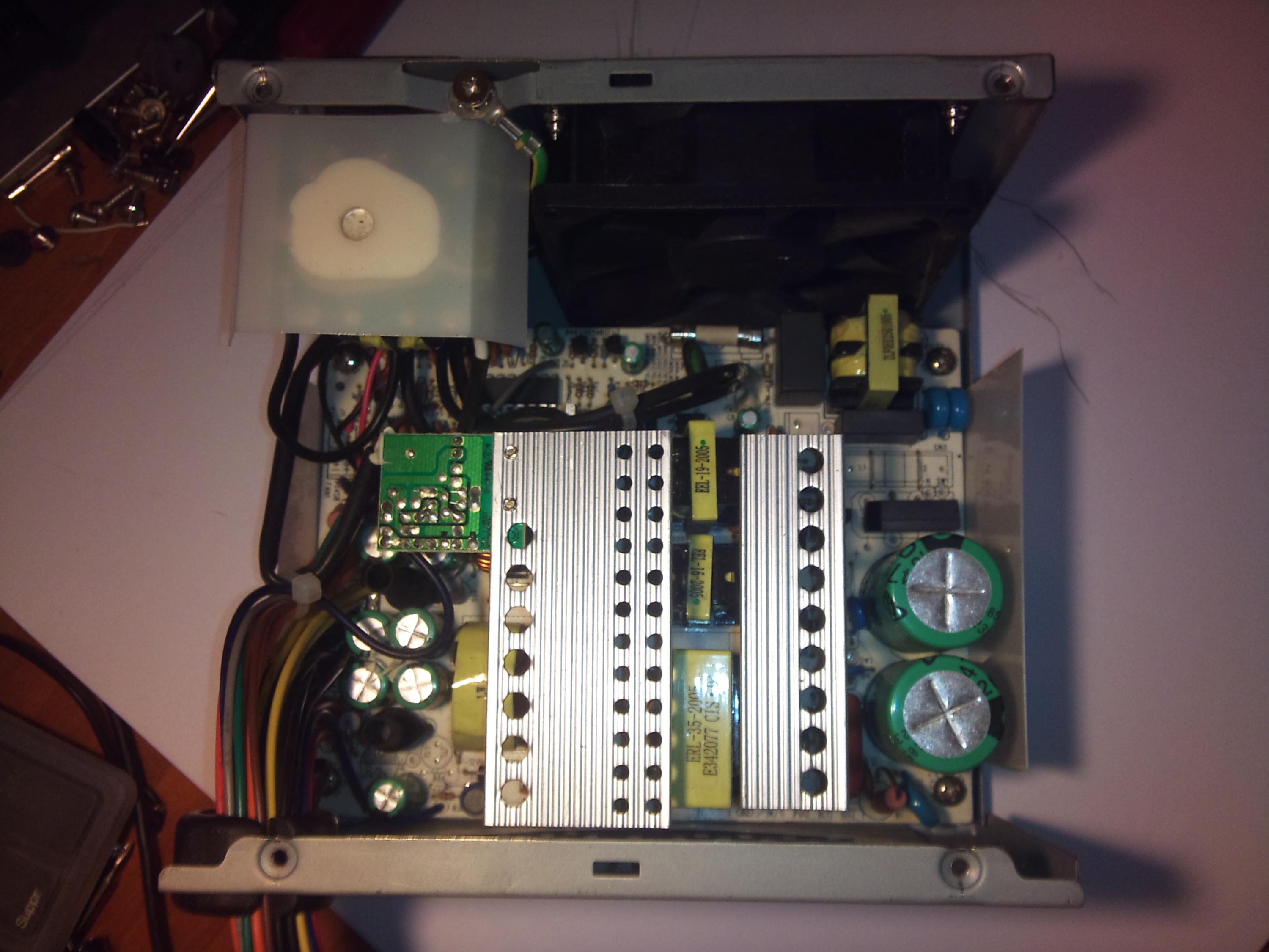

          Got yet another Allied here....and it doesn't look too shabby. Better than I'm used to from them. Full input filter (Minus an MOV) 4A rectifier, and what's probably realistically 330uF input caps. Unfortunately it has 13007 switchers but I have some 13009's I can replace them with. it also has a CEF02N6A MOSFET. the heatsink should be of adequate size. The transformer says ERL-35 but it looks more like a 33 to me...could be wrong though.
          The actual rectifier ratings are 3.3V = 20A, 5V = 30A, 12V = 20A, and a thermally controlled DC brushless fan.
          I was planning on replacing the input caps, the switchers, recapping it, and looks like a resistor needs to be replaced. It looks a little cracked but not broken....the thing does power up a computer with all voltages in spec (Barely) the 5V is around 5.22V. But a bulged 10V cap could be causing some issues. Also, when replacing the switching transistors would I be able to reuse the thermal pads?

            Originally posted by Behemot
            With some modifications it may do 350 W quite fine, 400 W max.
            Yeah right. With no space for PI coils, good luck keeping the ripple in spec on the outputs. Even with good caps, I'd guesstimate around 200W is where the ripple will start going really bad.
            It's a real 35.
            May also want to replace the ceramic cap next to it with the same value poly__ (styrene/propylene/ester... etc.). I've seen those ceramic caps burn up in Allied/Deer/L&C PSUs. Not sure why.
            Yes.
                I've seen daughter boards in BC before so i don't see any limitation there, lacking a scope to test/confirm results is what really stops me to proceed right now.
                  Well that's a DC to DC converter or perhaps synchronous rectifier PSU - obviously it won't have the same type of filtering as the cheapo half-bridge PSUs.
                  Yeah, if you go that route and add the caps and PI coils on the daughter board(s), then the ripple will likely be much less.
