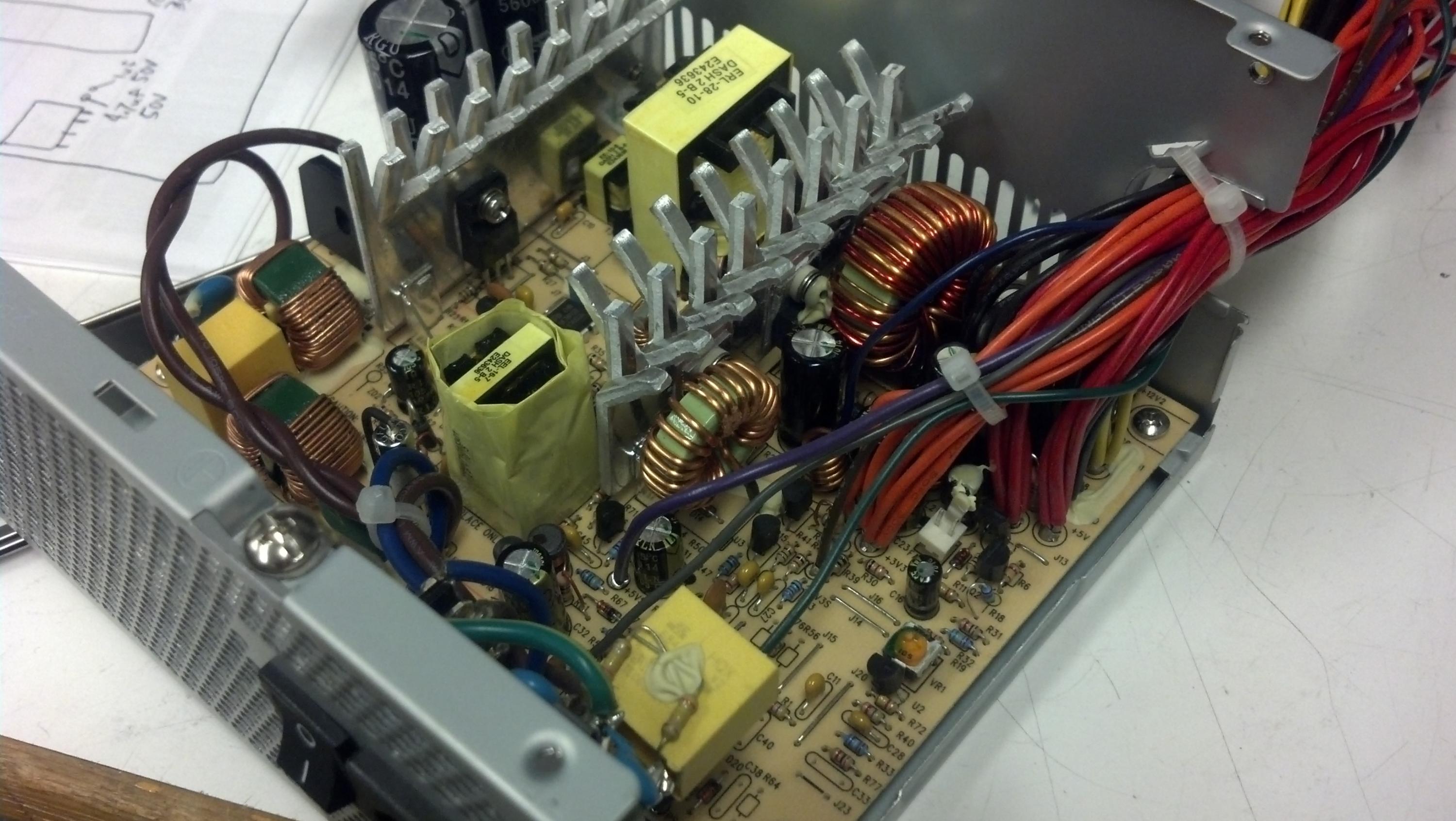

                          Just went on a trip to north NJ today.
                          Came back with a bad PSU board picked from a box. Obviously, bulging caps, tiny heatsinks, and more surprises to come!
                          Muh-soggy-knee
                          • Pentium4
                            CapXon Be Gone
                            • Sep 2011
                            • 3741
                            #1013
                            Do share
                            Got a PowerMan here. usually they're pretty good but this one is disappointing. Mainly because of the ERL-28 transformer. I have another PM with the same topology with (I think) an ERL-35. Replace it with that and recap it and I got a good PSU here! It has a 6 pin PCI-E connector too.
                            • c_hegge
                              • Sep 2009
                              • 5219
                              #1014
                              Other than the transformer, it looks Identical to the 400W IP-S400CQ2-0. I recently reviewed one, and it delivered 480W in spec.
                                Yeah I thought it was strange cause I've never seen one so small in this model. That's good to hear though, what size transformer delivered that much in spec?

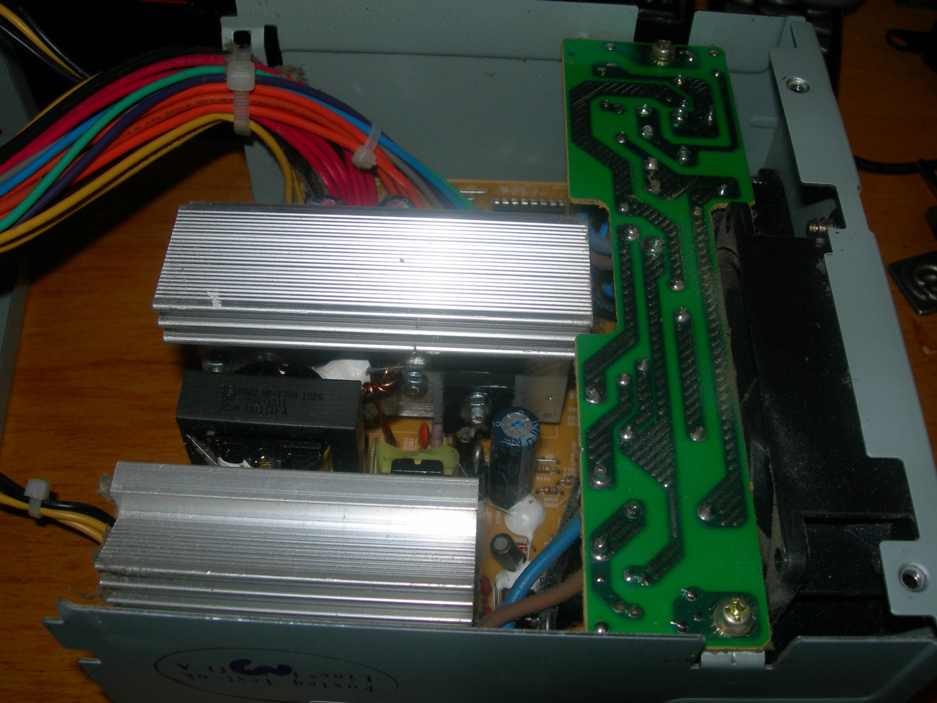

                                          #1020
                                          Originally posted by Behemot
                                          Prepare your vomit pail
                                          This is older revision, I will also talk about newer one which I got to my hands a year ago. This thing is still sold for like 24 USD/19 Eur incl. VAT. I tried to get local inspection to forbid that, you will see how many things it violates, but I think the „engineer“ dealing with me was both morron and on paycheck of the manufacturer.
                                          Pic 1 and 2 shows nothing spectacular, just remember the values
                                          Pic 3 - overall looks. This thing even has PFC, the newer revision got absolutelly tiny coil and ceramic cap - most likely PFC imitation, usefull for 5 W max PSU. According to inspection, PFC is not a must, the European norm actually talks about harmonics radiation - you can use just good ol' input filtration for this! No PFC is required in EU! Thats common mistake from those who actualyl never read the norm But when they write PFC in the name, there should be one, right
                                          Anyway, filtration is on daguhter board, but nobody would be harmed if they used the free spots too. Thermistor and varistors nowhere to be found. I will add all the things missing. Newer revision actually has two varistors.
                                          Tiny diodes, newer version even has rectifier, but 2 A labeled with rubber electrodes. The things is really small and starts dropping current at just 50 °C. Basically no difference here.
                                          Input caps are 470 uF, Fhy, never ever heard of that. Never revision has similar crap. Transistors are Toba T3866 and T13007-R. Found only bullshit, no actuall datasheet. Transistors seem OK, both heatsinsk really thin (2 mm) and tiny.
                                          Ordinary diode on +5 V SB. 20A schottky for +5 V, 12A fast-recovery for +12 V and 10A schottky for +3,3 V. Do you still remember the values from pic 1? But according to inspection: it is OK, the values on casing are just peak ones, manufacturer cannot expect you will connect it somewhere else than ordinary computer so it does not need to provide the wattage specified for longer period of time (longer than like 1 second).
                                          Only coils there are on +3,3 V rail, otherwise plain wire or stuff. Notice the termistor on common coil - seems that rectifiers are not the hottest things in this PSU, considering no coils and small Asia'X caps -5 V rail is not occupied by components
                                          Overall soldering quality is mediocre, PCB is not worst. Newer revision has even thinner PCB and casing. They most likely have one engineer for researching how these things can be cheaper because I found something new every time in there
                                          I will dig out this post of mine (No. 700 in this thread if you wanna the pictures).
                                          Been playing arround with my new loader and clamp meter for a while. I have succesfully done more or less complete rebuilt of this thing some time ago. It should now be capable of it's rated power. One thing I have noticed is that it seems to HAVE some kind of protection despite how crappy it looks. The thing is, it sits on the least important rails - +3,3 and +5 V I have been able to squeeze only arround 130 W combined from these rails, than it shuts down.
                                          On the other hand, it really is able to provide 15 A for 12V power-hungry systems (well, plus some minor load on +5 V from fan). Voltmeter does not show any crossloading when loading 15A on that rail ONLY.
                                          Will try to do some starting review on this thing, stay tuned for more
