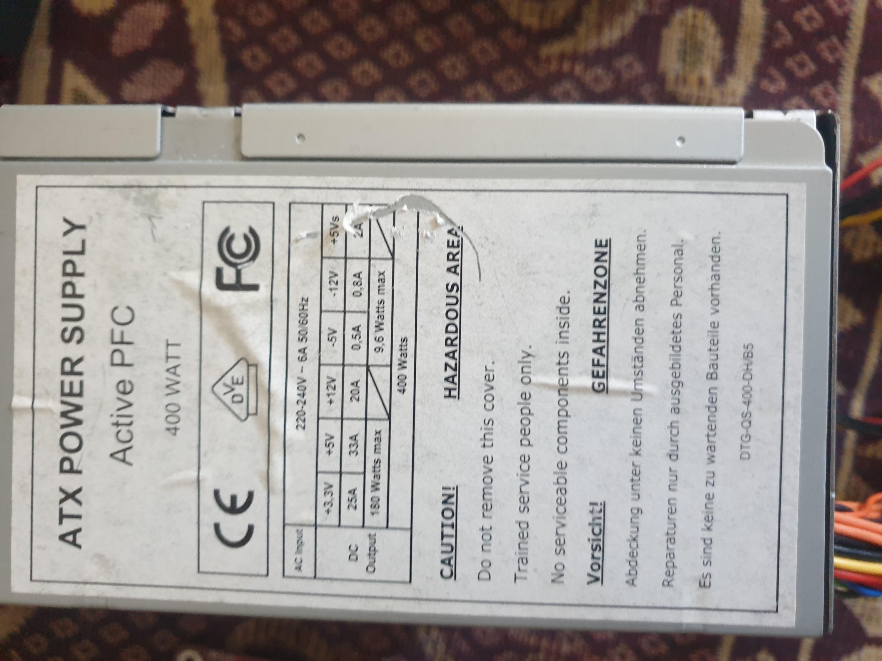

                                          #3220
                                          No-name special
                                          Why is it special? The insides shall tell you everything.
                                          No case swap involved, that is really how I found it, in a rather nice MSI K8T Neo-FIS2R + NX6600GT AGP custom build.
                                          FWIW, according to the fuse chart, this thing is realistically just 50W short of its rated power. Not bad, unlike most china specials I've had to work with.
