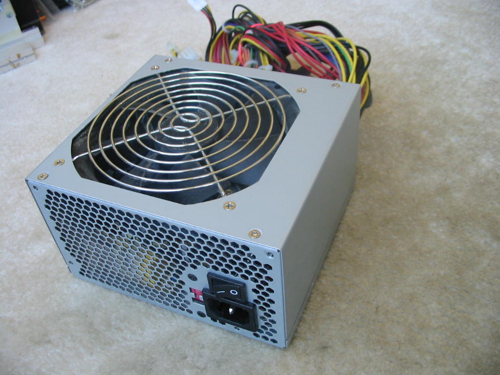

      Anyways, let's show it… as usual, starting with case shots:
Name:	FPS Group Inc. AX400-PN (1).jpg
Name:	FPS Group Inc. AX400-PN (2).jpg
      As can seen, pretty standard gray-box PSU with 120 mm overhead fan and non-sleeved wires – simple! (Just the way I like them.)

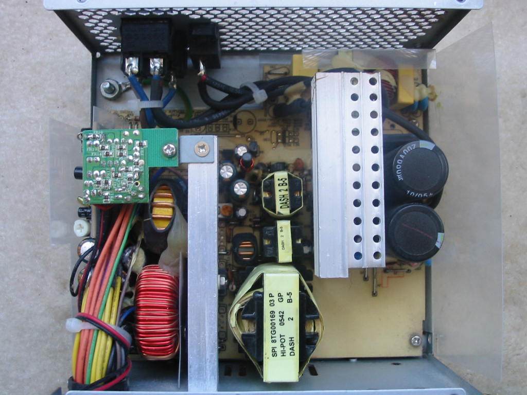

Name:	FPS Group Inc. AX400-PN (3).jpg
Name:	FPS Group Inc. AX400-PN (4).jpg
      Well, for a 350W continuous PSU, this looks really good – in fact better than what the pictures show here. In particular, the main transformer is ERL39 size (39 mm wide), which should definitely be enough. Also, the main output toroid is a T130-26 part with plenty of copper on it, so it too should be more than adequate. The design is a half-bridge with BJTs, so the Micrometals -26 core of the main output toroid should be fine here. Both heathsinks are quite hefty too. All in all, I can't think of anything to complain about. Perhaps I can try to pick on the lack of a NTC thermistor on the input? Seems like that might actually be a valid concern… but it may not be, as there is also a large multi-turn single-mode choke on the input. So I imagine that could attenuate inrush currents perhaps. OK, I know what I can complain about – the tan/brown conductive glue. But it hasn't turned brown yet, suggesting the PSU has been running pretty cool.

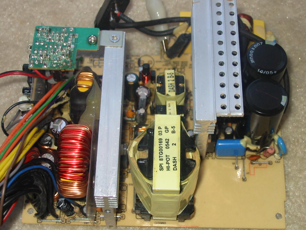

      Anyways, here is a shot of the primary side in more detail:
Name:	FPS Group Inc. AX400-PN (5).jpg
      No complaints here either. Primary caps are Teapo LXK @ 200V and 680 uF – good enough for the 350W continuous rating. Main BJTs are a pair of D209L in TO-3P case. Bridge rectifier is an 8-Amp part (GBU8J.) There's even space behind the primary heatsink for a PPFC coil, which wasn't installed on this unit. On the plus side, this should allow the overhead 120 mm fan to push air easier through the PSU – especially on the primary side.

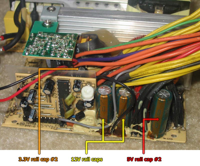

      Moving onto the secondary side…
Name:	FPS Group Inc. AX400-PN (6).jpg
Name:	FPS Group Inc. AX400-PN (7).jpg

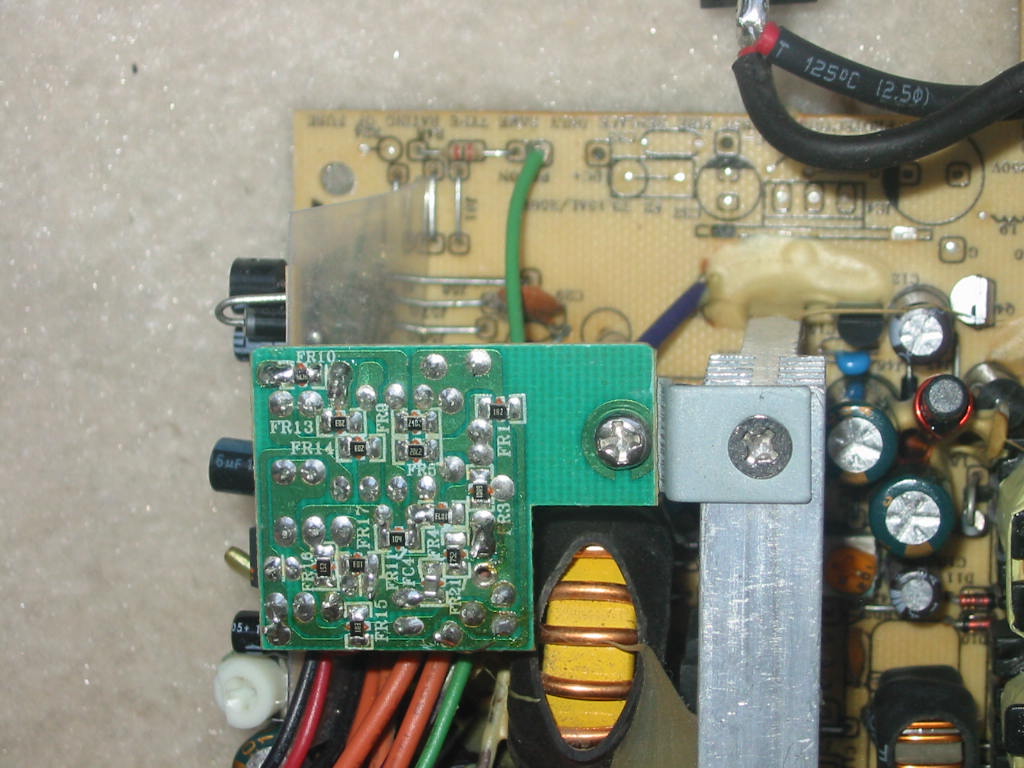

      Ah, now we see what the problem is: bulged caps. In particular, these two are the output caps on the 12V rail – 2x Teapo SC, 16V, 2200 uF. I think that's probably the reason why the seller on eBat decided to “scrap” the system and sell it for parts. Shame, because this is a good PSU and was an easy fix overall. The motherboard is quite nice too and probably getting harder to find now.
      Next, here is our “noise killer”:
Name:	FPS Group Inc. AX400-PN (8).jpg
      There is an LM358 dual op-amp IC on the other side of that board, along with the power transistor. The NTC for the fan controller is located next to the secondary heatsink on the main PCB, right below the 3.3V rail's output toroid.

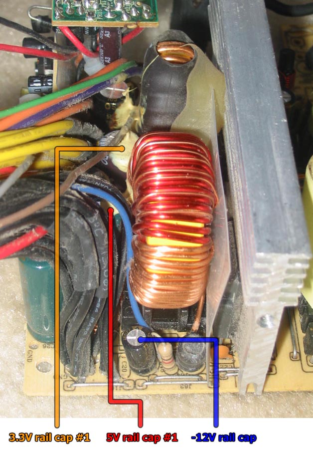

        FSP Group Inc. AX400-PN – cap diagram, partial recap, & resistor mods
        As far as recapping this PSU goes, it’s very simple. Each main rail has just 2 caps, as shown above (except for the -12V rail.) The only difficult part is getting to those caps due to the tan glue and also due to how cramped the secondary side is. (Those output wires really do get in the way!) But in any case, here is the cap diagram… or rather 2 of them, due to the wires blocking view for some of the caps.

        For the 5VSB rail cap #1:
        1x Teapo SC, 10V, 1000 uF ---> 1x United Chemicon KZE, 10V, 1000 uF
        For the 3.3V rail cap #1:
        1x Teapo SEK, 10V, 3300 uF(?) ---> 1x United Chemicon KYB, 6.3V, 3300 uF
        For the 5V rail cap #1:
        1x Teapo SC, 10V, 3300 uF ---> 1x United Chemicon KYB, 6.3V, 3300 uF
        For the 12V rail caps:
        2x Teapo SC, 16V, 2200 uF ---> 2x United Chemicon KYB, 16V, 2200 uF
        For the -12V rail cap:
        1x OST RLP, 16V, 220 uF ---> 1x Rubycon YXJ, 25V, 220 uF
        For the 5VSB startup/run cap:
        1x Teapo SEK, 50V, 22 uF ---> 1x Nichicon PW, 50V, 22 uF
        For the 2x BJT drive circuit caps:
        2x Teapo SC 50V, 2.2 uF ---> 2x Panasonic FC, 50V, 2.2 uF
        For the auxiliary secondary side cap:
        1x Teapo SEK, 50V, 47 uF ---> 1x Nichicon PM, 50V, 47 uF
