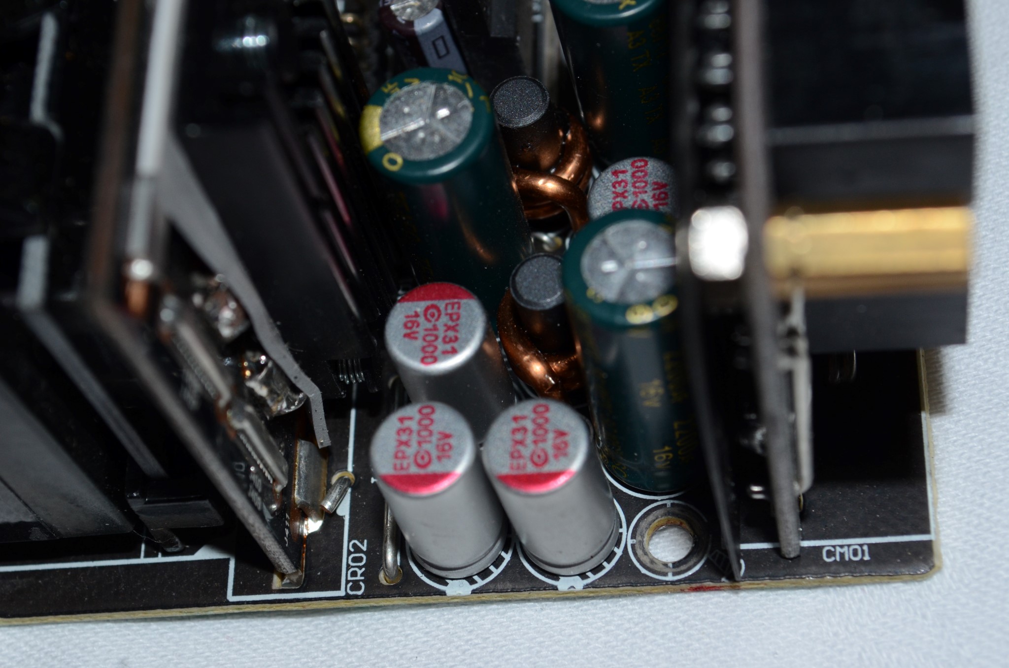

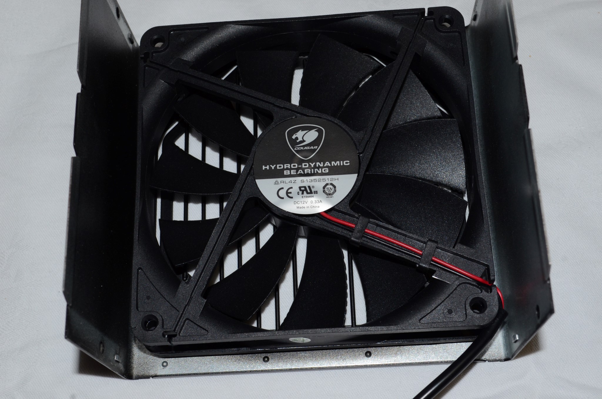

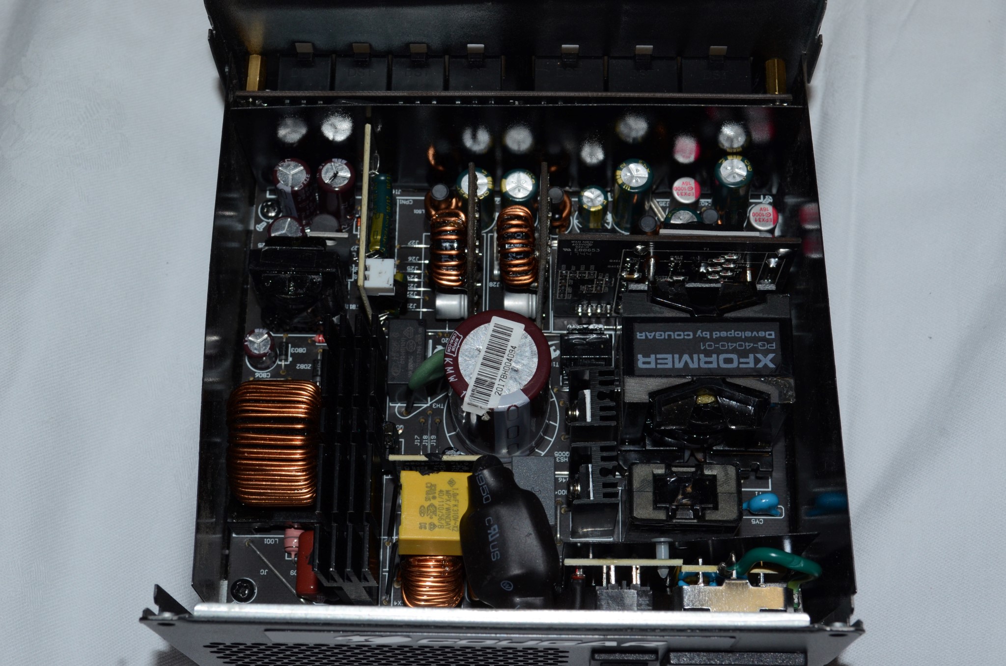

                            Something new:
Name:	DSC_4885 (Andere).JPG
ID:	2017272 Click image for larger version
Name:	DSC_4893 (Andere).JPG
ID:	2017273 Click image for larger version
Name:	DSC_4896 (Andere).JPG
ID:	2017274 Click image for larger version
Name:	DSC_4899 (Andere).JPG
                            I find the Transformer quite intriguing...

                              #2894
                              Looks pretty small. The main supply probably operates at really high frequency, though, so I imagine that's what allows it to be so small and still deliver its stated power.
                              That said, do you have a label shot of the unit? Just curious who made the PSU and how much juice it's rated for.
                              All in all, looks pretty much just like any other double-forward single 12V-design of today. And minor rails appear to be DC-DC buck regulated (again, as usual).
                              Not a fan of the all-black colors, though. Sooo boring nowadays! At least the PCB is not black on the bottom side too (I hate working on black PCBs.)

                                #2895
                                Well, yeah.
                                Its an LLC-Resonant mode Converter.
                                So I'd expect it to operate between 400kHz and 1MHz, maybe 2.
                                And I don't know if you see it on the Pictures but the Secondary Windings from the Transformer are soldered directly to the additional Board, where the +12V Rectifiers are.
                                Thats the 550W version of the Cougar GX-F, made by HEC/Compucase.
                                Ähm, its not Double-Forward because no Coil on the Secondary.
                                But another one right next to the main Transformer.
                                That's how you can distinguish an LLC-Resonant Mode thingy from other topologys.
                                Yeah and the interesting/great thing:
                                Its a Single Layer Board.
                                Another Interesting points:
                                The huge 1000uF/16V Polymer caps
                                The Enormous (for a 550W) 470uF/400V Main Cap.
                                  Well, yeah.
                                  ARGH, that's the usual operation frequency of the DC-DC modules.
                                  The isolated part operates in a range of maybe 50kHz or so, maybe even more than that.
                                      Impressive.
                                      HEC/Compucase build quality has definitely stepped it up a few notches from what I mostly saw from them a decade ago.
                                      Ah, I see. Thanks for the explanation. Didn't cross my mind to look for the (lack of) output toroid.
                                      Yes, LLC-resonant explains a lot how this PSU can deliver so much power out of so few components. I think that's also the same (or very similar) topology used in LCD monitor CCFL inverters as well as those small halogen light switching PSUs.
