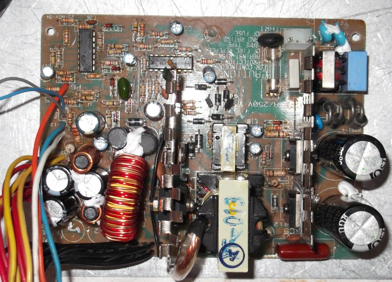

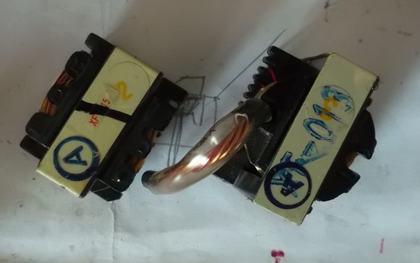

                I've got these two AT psu that I have no idea who the OEM might be. Both have the same casing and label, but it looks nothing special, very generic. Heatsinks are kind of unusual, a bit cheap looking. The beefier unit has a "temperature controlled fan installed" sticker. The main swithcers are 2SC2625. It has two SMBR3045PT in parallel for 5V rail. Also there is an unused "ALT Volt" rail that has no components installed at all. I replaced the main and secondary capacitors in this one.
                The main trafos might be giving some clue who might have made these, though I never seen these markings before.
                The fan controller with the ne555 looks like someting of a home made DIY circuit. Sorry for the crappy pictures...

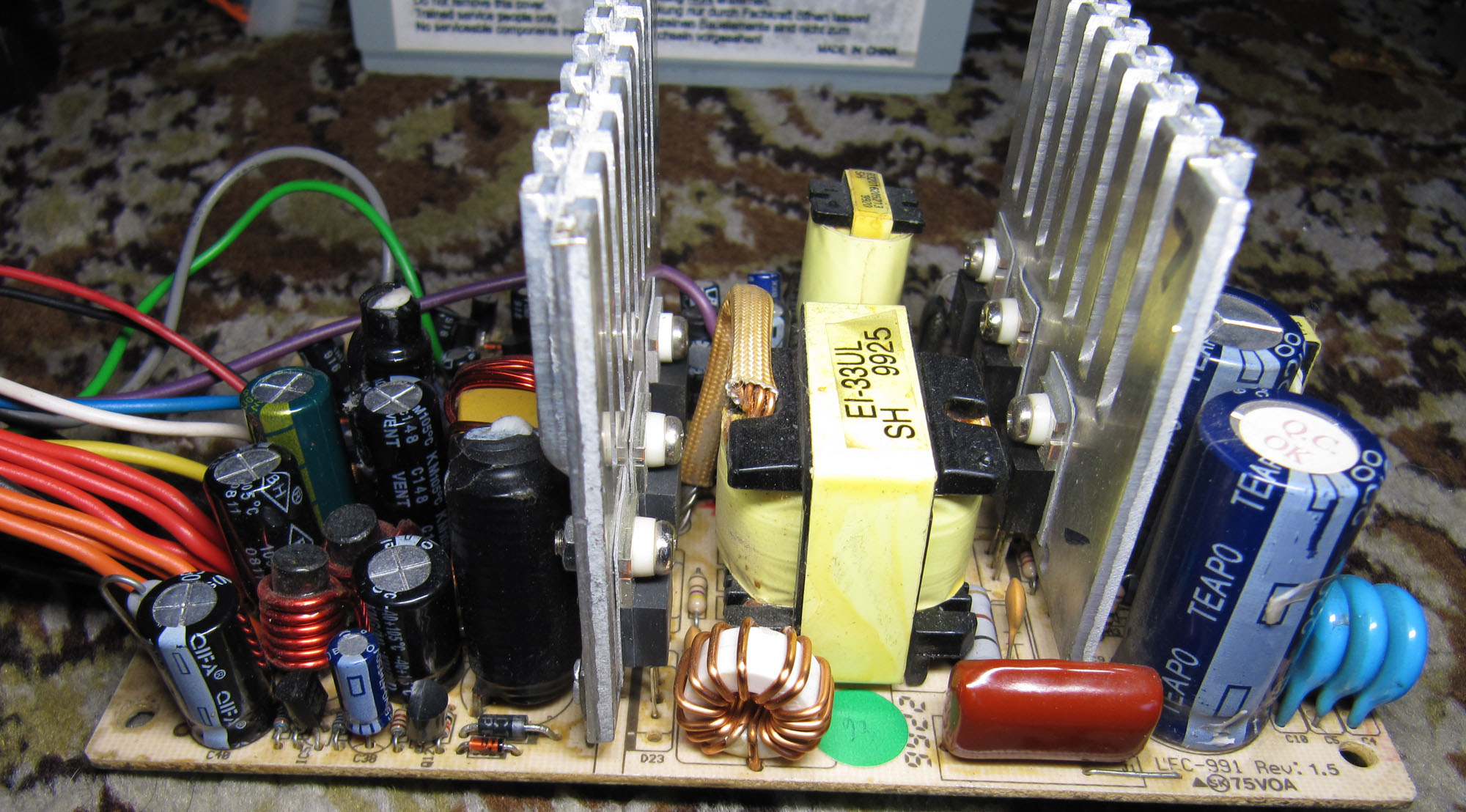

                        Linkworld LEC-991 1999
                        Someone tried to fix that psu. Some of the caps have been replaced.
                        It's a mini ATX psu. It came without a cover, so I don't know its rated power. I guess 200Watt.
                        Photos and datasheets attached

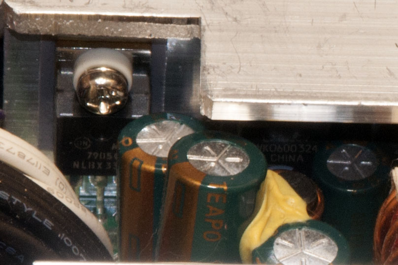

                                    Wintec WP609F11 300W power supply from a 1U Rackable Systems server.
                                    Starts out quite decent.
                                    But...Teapo! Not the absolute worst you could find but not really the greatest either. At the same time they aren't bloated or blown so maybe they're fine.

                                      #2298
                                      Is it DC-DC or group design? And isn't there a Hermei too?
                                      • ben7
                                        Capaholic
                                        • Jan 2011
                                        • 4059
                                        #2299
                                        It looks to me like a group design.
                                        Either way, it is quite nice actually, there is a proper fiberglass (?) PCB, not a cheap paper/phenolic type. Also, plenty of EMI filtering!
                                        That hermei vent could be a teapo, I think I recall someone finding them before.
