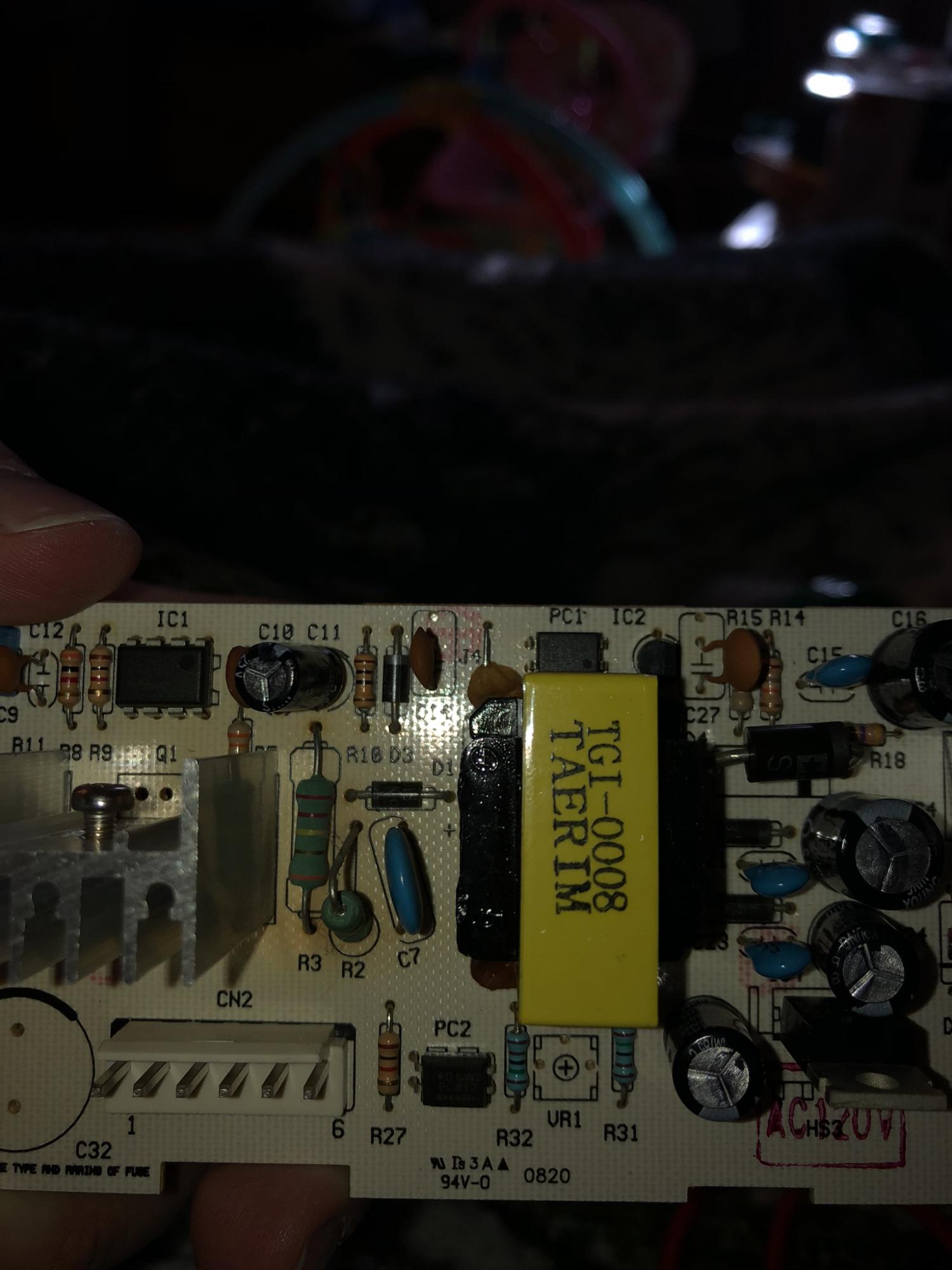

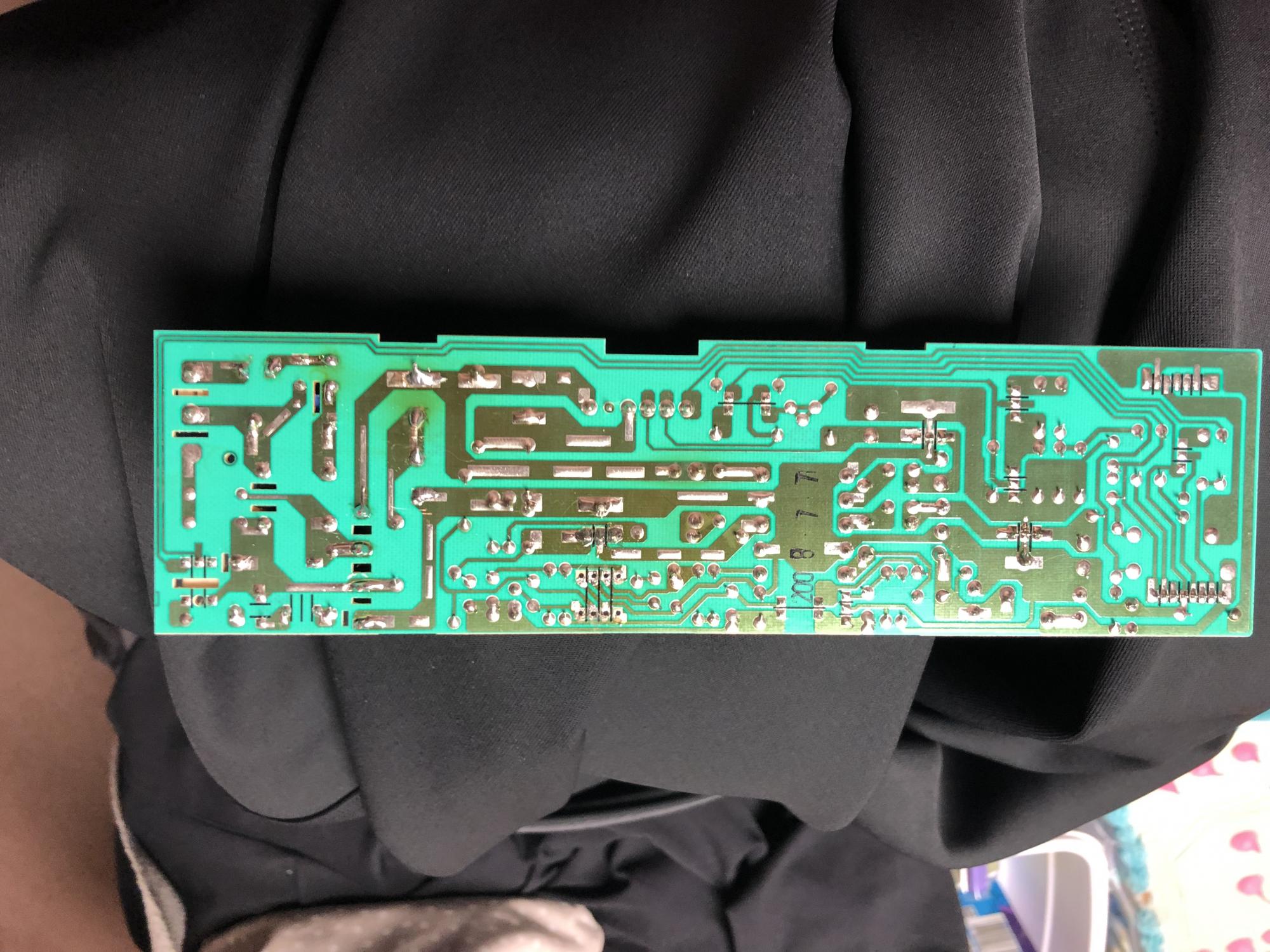

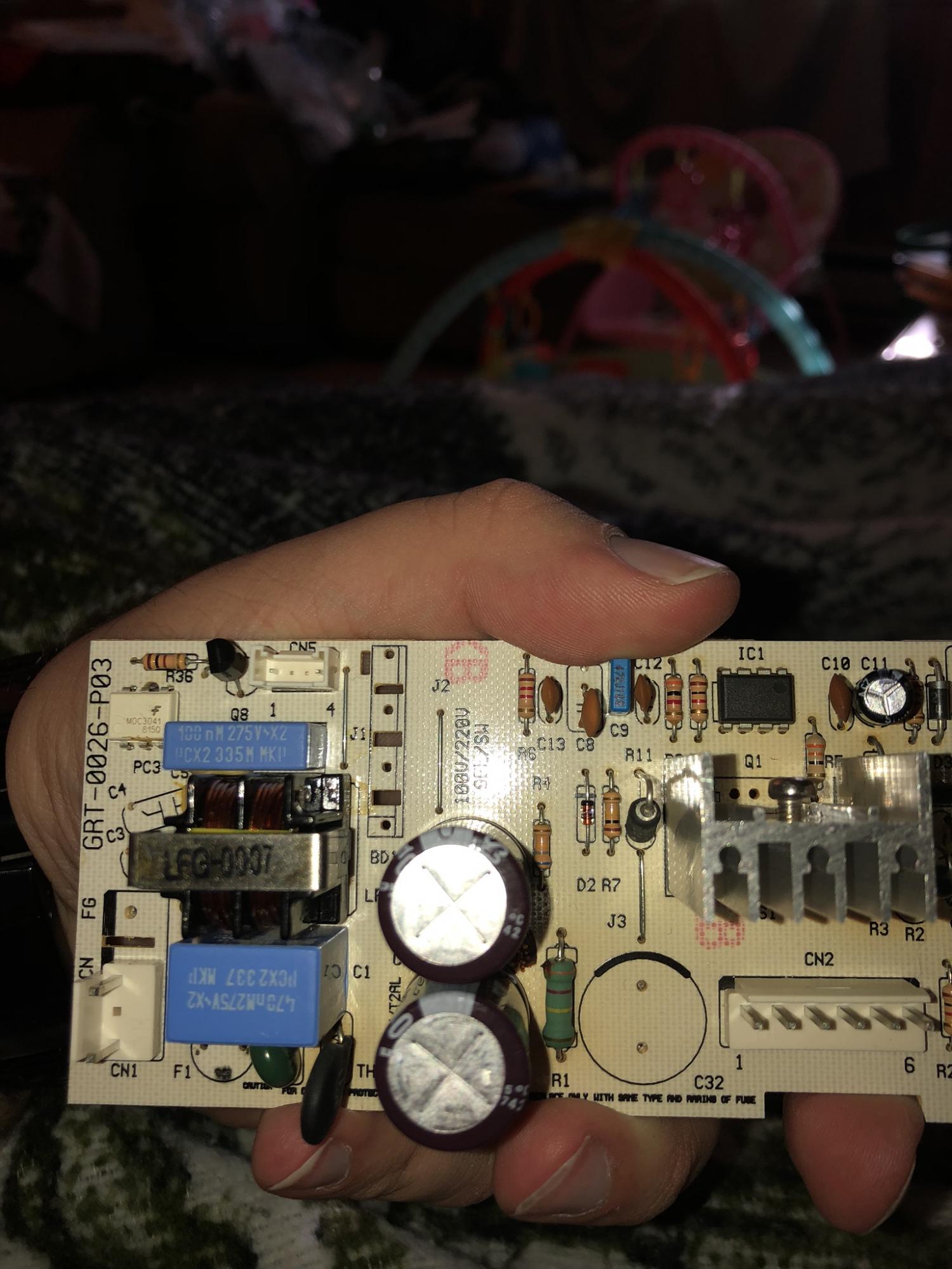

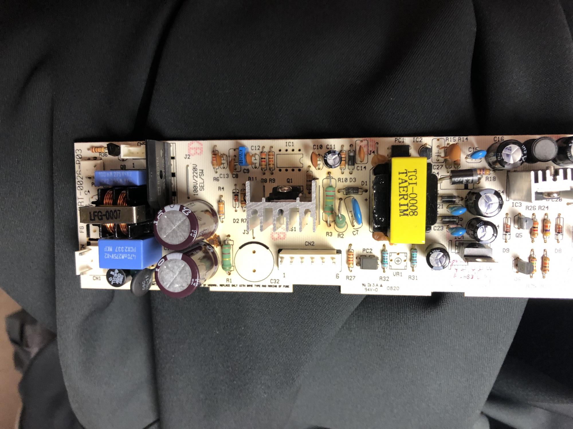

    I have a SMPS from a Winix WAC9500 that keeps blowing the fuse. It had some obvious bulging 200 uF 200V main filter caps that were replaced with 250v ones, but that obviously didn't solve the issue.
    The bridge rectifier was replaced (RS405M), the switching MOSFET was replaced (STP7NK80ZFP) and the fuse (a 2 amp slow blow fuse) is still blowing. It isn't taking anything out with it when it is blowing.
    The MOSFET is controlled by a KA3842 PWM controller. Taking that out of circuit stops the fuse from blowing, so the problem isn't in the primary filtering, or the rectifier.
    What the hell would cause the fuse to blow the way it did (it scorched the board) without taking another component as well. The MOSFET I took out was fine, I was just eliminating possibilities.
    Thanks.
    BD1 and Q1 were removed for testing, but they were fine (I still replaced anyways) thats why they are missing from the board. C32 was never populated.

                          Just want to confirm, this looks like a 3-output PSU as there are three diodes. And that it will blow fuses with the PSU disconnected with the rest of the unit?
                          Like most multiple output PSUs it's group regulated, and the main regulating channel is the "big fat" diode D4, ensure this is still working as a diode. Note the feedback circuitry appears to be IC2/PC1/R15/R14/R18 though you may need to test these individually out of circuit.
                          Having IC4 or IC3 short is unlikely, but do diligence and test. BTW, are you using a dim bulb tester, for these experiments, blowing fuses can get expensive!
                          There is no OVP crowbar that I can see, so that throws out that idea. I don't think I see the triac but if it's cut off from the picture, it appears to be in the low current section and probably not the problem.
                          For completeness, things that need to be checked:
                          - IC1 ... though this is probably checked by swapping.
                          - D4
                          - IC2
                          - PC1
                          - Transformer If this broke, probably game over.
                          - IC3 (78xx I think) and its D5 though this probably would more likely just get hot but not burn fuses
                          - IC4 (the other 78xx) and its D6 though this probably would more likely just get hot but not burn fuses
                          I haven't discerned the function of the other photocoupler yet, cross that bridge later...

                                Oh, now I see Q8 (TRIAC) and PC3 (ZCT isolator), which looks to be a remote control circuit / "relay" for CN5. I can't imagine how they would cause fuse overloads, the TRIAC shouldn't be able to pass more than an amp before frying. Again it would be interesting to know what was connected when testing this PSU, if the device CN5 is connected to is shorted and thus shorts the whole kaboodle with the fuse when the device is turned on. That device plus the PSU draw may be enough to also blow fuses.
                                I did notice a bit of heat discoloration by the thermistor? Or is it? Just as a sign of how much power this PSU had been passing, whether it was stressed from use or not...
                                Also when it blows the fuse (guess it's a slow blow?) is it instant blow or blow after several minutes?

                                  This air filter has a fan which I think is speed controlled by the little triac and opto.
                                  The HV DC bus goes off on CN2 pin 1 and 3 to I guess the ion generator
                                  OP are you running this with CN2 connected? If so, then that second "plasma" PSU might be shorted and actually the problem.
                                  I'd use a series light bulb and save some $ on fuses.
                                  Actually a UC3842 is OK but the circuit is different because the mosfet gate is AC coupled, hopefully to a nice square wave. Blowing fuses with the IC in, could check I_sense R11 for low value, but usually these fuse open.
                                  Unless the unit powers up and turns on the plasma PSU and then pops the fuse?
