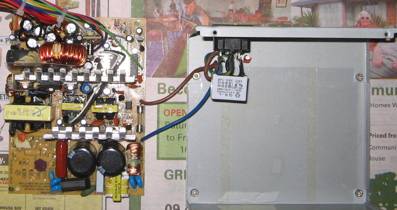

    I have this PSU I want to put new cap(s) in
    At the moment there is one bulging one but I hope to replace all once I can get some small enough!
    First, some photos so you can see what we're looking at..

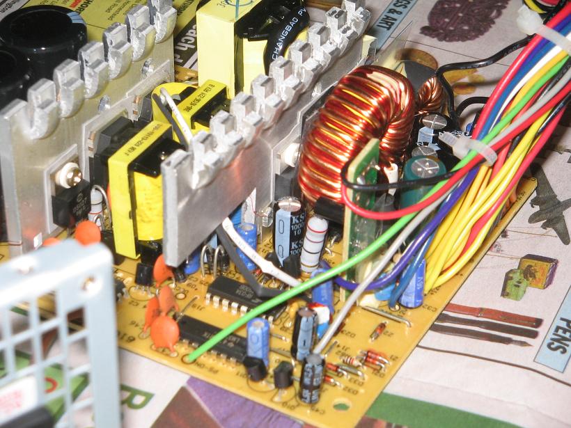

    The bulgy one is in the middle of the 2nd photo, marked KSC.. It's the only bulgy one in the whole PSU. I doubt the big huge resistor right next to it helps (maybe I'll turn it around so it's not as close to the cap??)
    There's another cap the same on other side of the heatsink, I want to replace both now.
    I have some LXZ I can replace them with but I want to know the origin of the original cap to make sure I'm not putting an unsuitable replacement..
    It says:
    GL
    VENT
    -40+105*C
    and on the other side
    KSC
    1000uF
    10v
    Does anyone know this capacitor?

    Re: Huntkey LW-6400H 1 bulging cap, can you help ID it?
    King-Sun GL series
    http://www.king-sun.com/doce/jsnycp1-y.htm
    Since their sheets are not available, I'll need the the caps dimensions in millimeters, diameter x height, to find a reasonable replacement.
    It looks like a 10mm cap. But even an 8mm is workable with Panasonic, Nichicon, or United Chemi-Con replacements.
        Decon is rat-killer, isn't it???
        BH & Decon are crap caps.
        Teapo is fairly common in PSU's and this is likely an SC series. 2200uF@16 in 10mm is a toughie. I'd opt for a Nichicon HN @ 1800uF there as its size is good, ripple is 3190, ESR is 9. If you think you can shoehorn a 12.5mm there, then there are more options in the same 3 brands I mentioned before.
        I'd replace all of these caps if you're so inclined.
        When you replace the blown one, try and move it farther away from that resistor next to it. Even making the leads a bit longer so you can bend it away from the resistor will help. Nothing like putting the can of gas next to a heater. Sooner or later...
