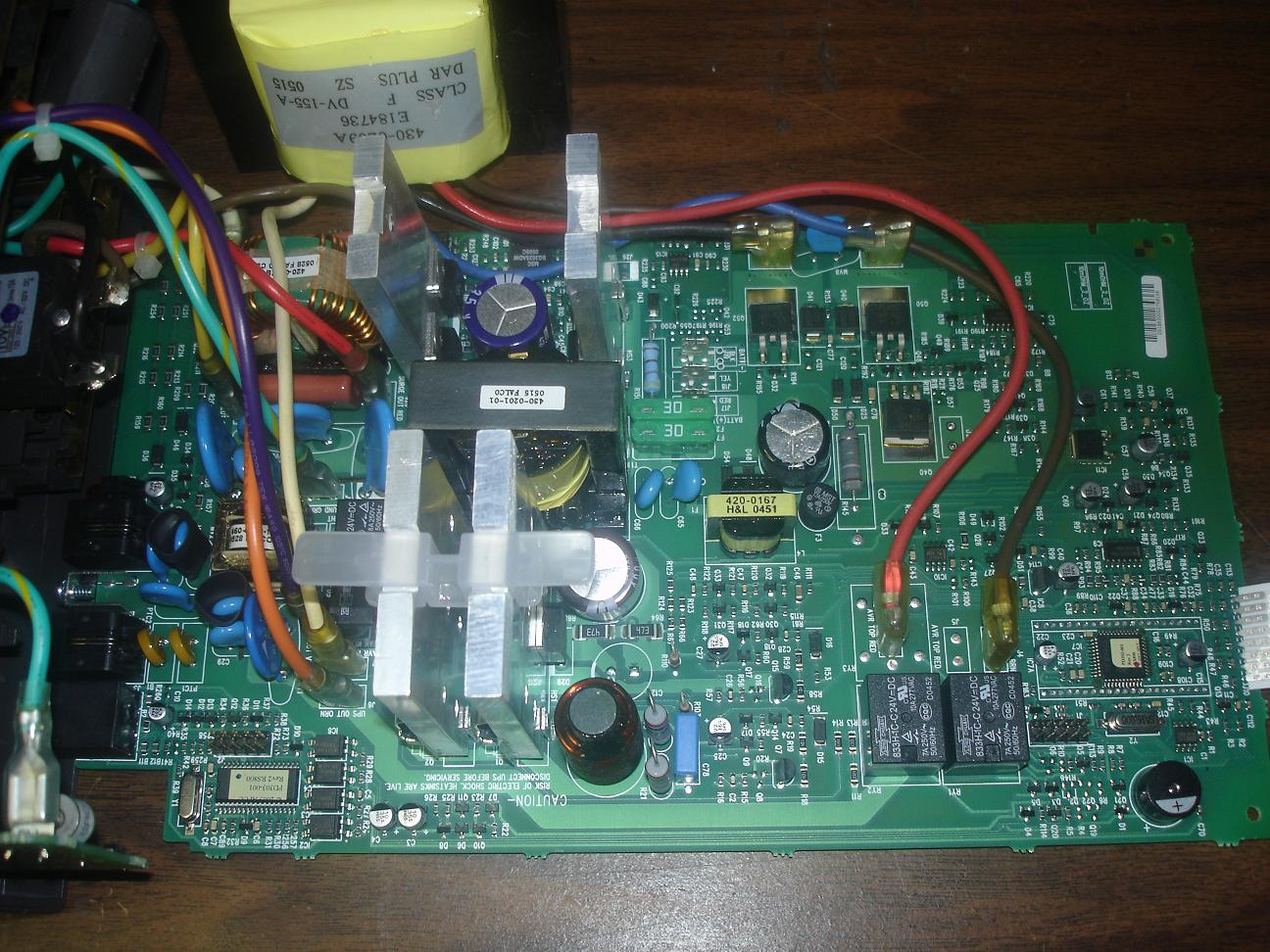

    I recently came across an APC RS 800 UPS. It's completely dead the surge outlets work (they are always on).
    However other than that there are no signs of life. There are no batteries connected but from what I've heard it should power up connect the backup outlets to AC and illuminate both the online and replace battery light in that case.
    Any idea what would cause a UPS to go completely belly up like this?
    No toasty components on the board either. All 3 fuses check out good too.

    I just checked this on an APC Smart-UPS 1250. If the batteries are bad (or disconnected) you won't get anything out of the backup outlets. This corresponds to what I have experienced on UPSs from both APC and other suppliers.
    PlainBill
      Re: APC RS 800 Completely Dead
      I confirm PB's statement. I have 4 APC units on my systems here, 1200-1500va. All do same thing with no batts.

        Doh the manual for my CS 500 says the unit will come with both the online and battery lights if the battery isn't connected.
        The RS 800 according to the manual flow chart WON'T come on without batteries connected as you guys said.
        Damn APC they should standarize on this stuff.
        I needed to order some new batts from Gruber Power anyways.
        They've supported my UPS's for years very good batteries.
        I guess I've had such annoying repair problems lately I'm not willing to look at the obvious .
          Wow in both manuals there is a contradiction in the troubleshooting table it says it won't come on without a battery and in the print section it says it will. With the online and replace battery lights lit. I read the print section and thought it would boot.
          I got this unit without batteries. I figured the transfer relay would at least connect them to line voltage.
          There we go I didn't misunderstand the guys at APC are idiots . They made the mistake in two different manuals no less.

                  ah ok, I had to use far more force then I thought to remove the front panel.
                  But still where are all the fuses?
                  I located F1 (just a pcb connection), F2 & F7 (Two green fuses similar to a car fuse) and F3 which is a brown round something.
                  So F4, F5 and F6 are missing.
                    Disassembly for those interested for the RS 800 was as follows I almost broke the casing disassembling it. Mainly because I couldn't figure out how to take it apart I eventually got it.
                    Remove the 4 screws on the back outlet panel pull it off. Remove the front panel pull it straight off. This will require some brute force it is retained by 4 snap clips that won't let go without a strong pull.
                    Just don't pull too hard you don't want to tear the ribbon cable for the front panel LED / Switch Assembly.
                    Remove the three screws under the front panel and the side cover will pull right up and off.
                    The PCB is snapped into the casing. You may have to insert a flat bladed screw driver near certain points at the PCB and twist it to expand the casing and pull the board up.
                      It's not uncommon for manufacturers to axe parts from the original design to save a few bucks I see it all the time.
                      The dual automotive fuses are probably protection for the two batteries.

                        some of these apc plastic units are on recall due to a fire hazzard.
                        might want to look it up.
                        that said i have seen several apc units where the 400v cap in the charger goes bad and kills the topswitch.no charging and soon a dead ups.the guts of these are identical to those cheap and nasty cyberpower units.
                        these things are junk!
                        not the same apc from back in the days.
                        and yes the double fuses are on the +batt.
                        a cheap way to get a 60a fuse.green=30a.

                          In my RS 800 the 400V charging cap was a Chemicon so I guess they learned their lesson.
                            Hi, Kraneshaft, after looking at your board picture, I have a XS 800 with exaltly the same PCB in it. Upon close examination I found the part number 640-0189D, which is the number on the schematics. You won't find the schematics on www.upsclub.org, they are all newer APC's except one from 1999 design. The schematics we are looking for would be 189D as labeled on that site. We may get somewhere with the board PWA number.
                            I checked it out and only found F3 blown, but exactly where is the F1 fuse(trace on board)? I found the batteries reading 4V total and no lights on front panel. But when I put good batteries it worked fine. But the unit will not come on or charge the drained batteries.
                            By the way the correct way to remove the front panel is put a screw driver in the slot on the bottom of the front panel and pry it off, it will unsnap but still requires almost breaking it off. I found the best price for the batteries at SLA batteries on www.ebay.com 12V 7.2AH but you have to buy in pairs but $21 for 2 plus $11 shipping. 4 for $40. it uses APC RBC32 pair, or buy 2 RBC2 batteries.
