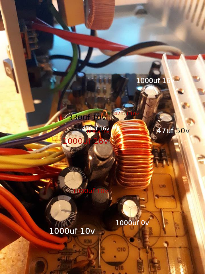

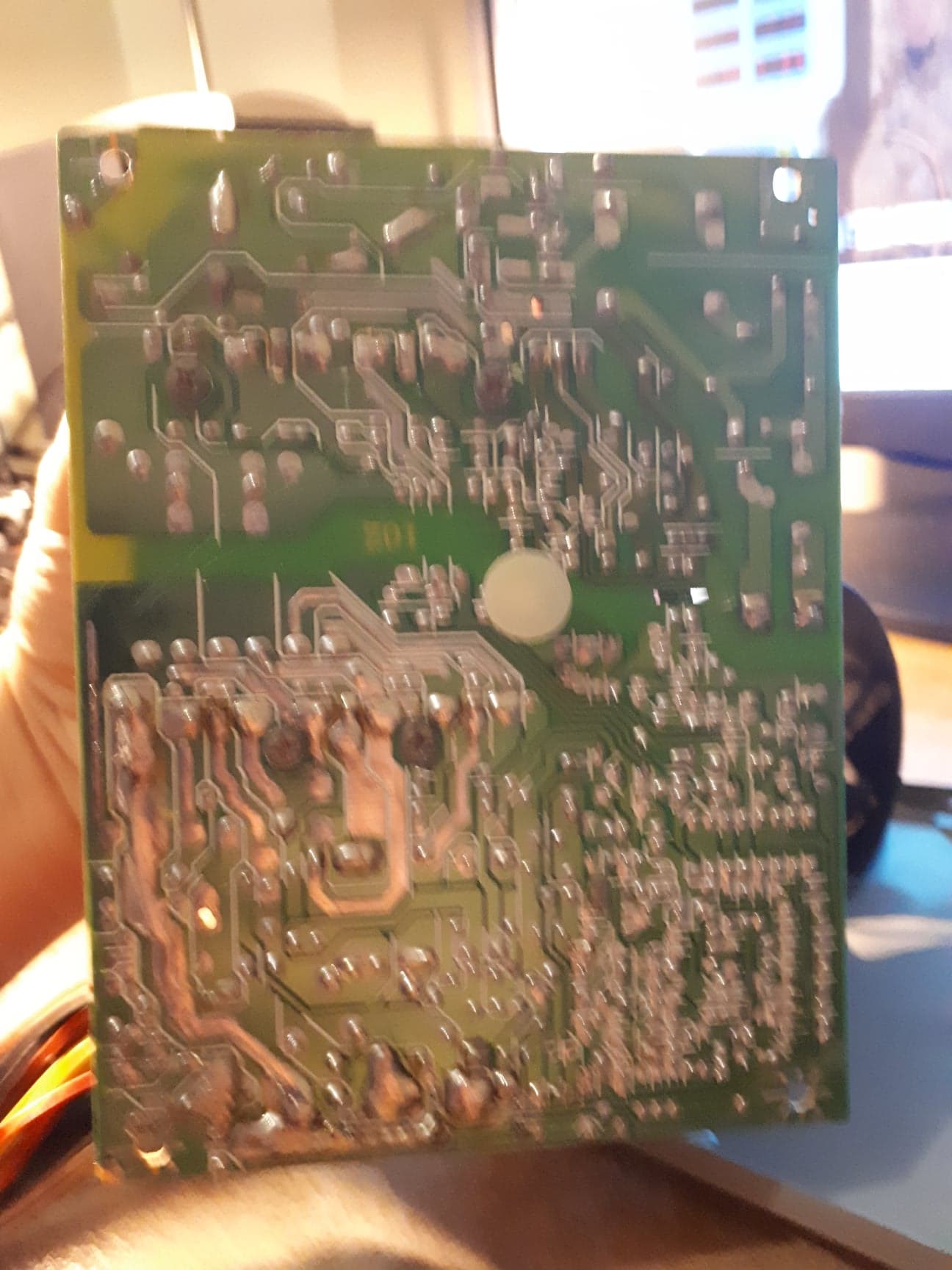

    Here is a Magna 300W ATX PSU, with plenty of bloated JEE and other caps:
    Primaries are HEC 330uf 200V (will change these when I get some other caps)
    Now I said on the other thread about the electronic clock kit I was waiting on some caps off my dad. Well here they are in action! and before I get roasted for bad repair work or it's dangerous etc, this is just a "Will it work?" project, using what I now have, which is Jamicon 85C caps, Fake Nichicons and Fake Panasonic FR caps!
    At least the values are a lot larger.
    The 470uf 16 cap is actually that value, I just wrote it in red underneath by mistake.
    Also the cap at the bottom right of the labeled image isn't "0v", it's "10v"

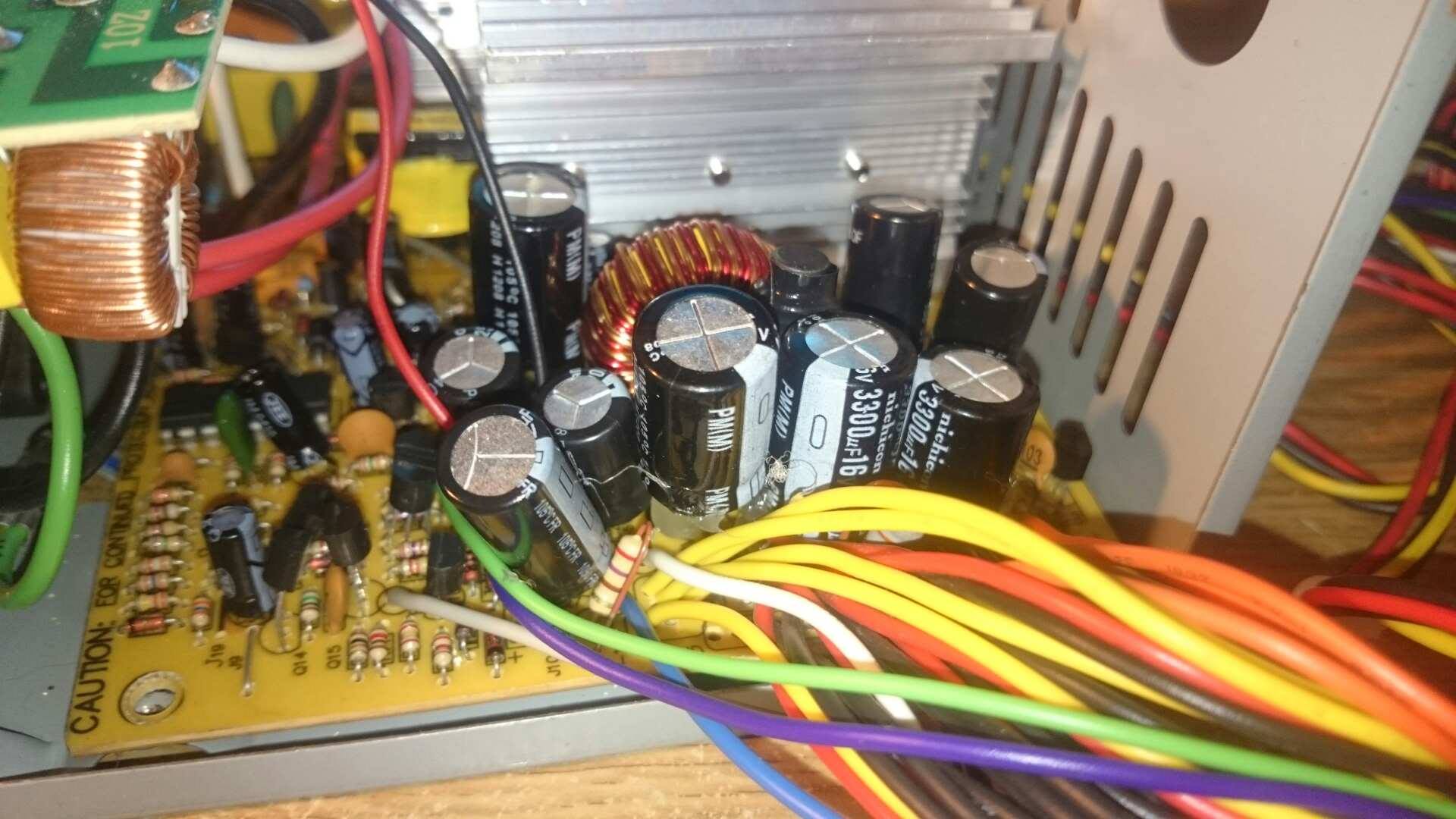

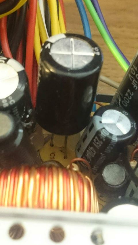

    The cap replacements are as follows:
    C10 (EMPTY) -> 2200uf 10V Fake Panny
    1000uf 10v UNITE -> 2200uf 10v fake Panny
    1000uf 10v UNITE -> 3300uf 16v fake Nichicon sitting off the board about 5mm!!!
    1000uf 16v JEE (bloated) -> 3300uf 16v fake Nichicon sitting off the board about 10mm!!!!!!
    470uf 16V UNITE -> 470uf 25V Jamicon 85C (Yeah, I know, it's 85C and General Purpose!) Sitting off the board about 3mm
    330uf 10V UNITE -> 2200uf 10v fake Panny
    470uf 10v UNITE -> Jamicon 470uf 25V Jamicon 85C (Yeah, I know, it's 85C and General Purpose!)
    1000uf 16V JEE (bloated, top right) -> 3300uf 16V fake Nichicon sticking off the board about 8mm!!!!!!!
    and finally...
    the worst offender of my recap....
    47uf 50V cap (bloated out the bottom) replaced with...
    Two Jamicon 100uf 25V in series for a combined 50uf 50V and probably way too much resistance!!!
    Again, this is NOT a lesson in how to recap a power supply.I know full well what I've done is ridiculous. This is more a "I've got this stuff, will it work?" Before I did this, the volts would be all over the place, as in, my cheap £2 multimeter would show the voltages actually moving on the display up and down as it ran (with a dead HDD for some load)
    Now it's stable.
    So this is probably "How to get yourself Killed" but I thought it amusing to share nonetheless.

    I';ve got a 35 size transformer here... Maybe I should see if i can solder it in and see if it goes POP?

    go to poundland and get a pair of safety glasses, or only run it covered - when a cap blows you DO NOT want it or it's contents to hit you in the face.
    and a lot of us - including me, have experienced caps blowing clean across the room multiple times.

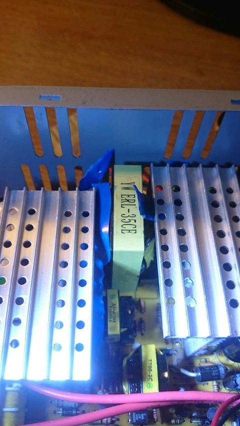

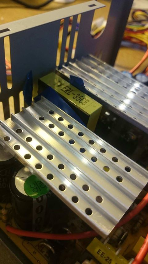

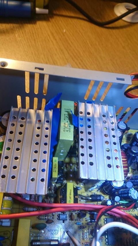

      I replaced with a 35 size transformer as in the images attached - and used electrical tape to separate from the heatsinks (as I assumed it's not a good idea if those make contact with the heatsink)
      PSU acts like it's dead except for 12V which produces 0.12V... I'm assuming the coil has too many windings as it's designed for a different PSU?
        You could use a hacksaw to cut notches in the heat sink to allow plenty of space for the transformer. For a 300 watt power supply, the heat sinks definitely look over rated!

            That would be a good idea everell. Any ideas why the "new" transformer doesn't play nicely with the unit?

              Changing transformers is a risky business. EXTREMELY DANGEROUS. When you decide to send a power supply to the junk box as not fixable, leave the transformer soldered to the original pc board. I know it takes up extra space, but you will be able to come back to it later and trace which transformer leads go to which circuits. Then you have a chance of getting something to work.
              Only once I tried changing a transformer randomly. It blew fuse, got very hot, and blasted several parts. If you want to learn how to fix these power supplies, and use salvaged transformers, LEARN to do it right. Transformer pins need to go to the right places. In your case, you were lucky. It simply did nothing. Once off the pc board it is very difficult to say for sure which winding is which.
                  I actually do PC PSU main transformer replacing and the worst to happen was it wouldn't turn on because of incompatible secondary pins.

                    OK, so I should probably work out how the transformer is wound and which pins go where before doing anything again. I'll probably cut this one in half to see how it goes together.

                          Sure, you can.
                          It's a matter of matching the transformer pins on both sides (AC and DC side) when installing the new one and making sure BOTH supplies are of the same topology and pinout.
                          Have successfully transplanted three big transformers from a failed Deer (burnt 220v side, transformers were okay) to another one that was working but had those skimpy "ERL-33 / ERL-19(TOP)/ ERL-16" transformers installed.

                                On that note, your "fake" Nichicon and Panasonic caps don't look bad for fakes at all. In particular, those fine "T" vents on the Panny's actually look quite genuine. Now how funny would it be if those caps turn out to be not fakes?

                                You can't just pop in any different transformer in there and expect things to work. At the very least, the transformer has to match the topology of the PSU (half-bridge, 1T-forward, 2T-forward, etc.) AND the pins for _all_ of the windings have to match to the original (i.e. 12V rail goes to 12V rail, and etc.)
