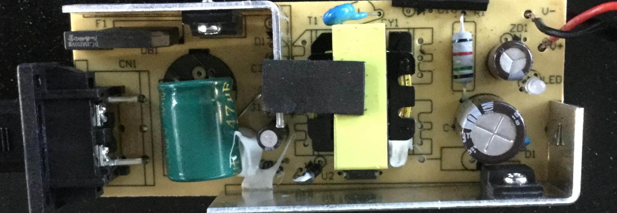

    Here is the inside of this switching power supply
    The voltage with no load 4.21 with a 860 mill amp 3.98 volts
    The switching power supply will start with a 12 volt 20 watt light bulb hook to it
    https://www.ebay.com/itm/Lithium-Ion...53.m2749.l2649
    Of coarse it had no name brand caps inside of it
    How well would you say this switching power supply is made

      looks like a generic laptop chager pcb.
      notice the holes for a bigger transformer.

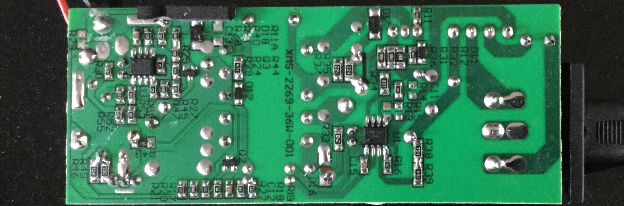

        What is the P/N of the charger controller IC on the cold side, if it is charger controller?
          M358 this is what I can make out
          I am thinking it is a LM358
